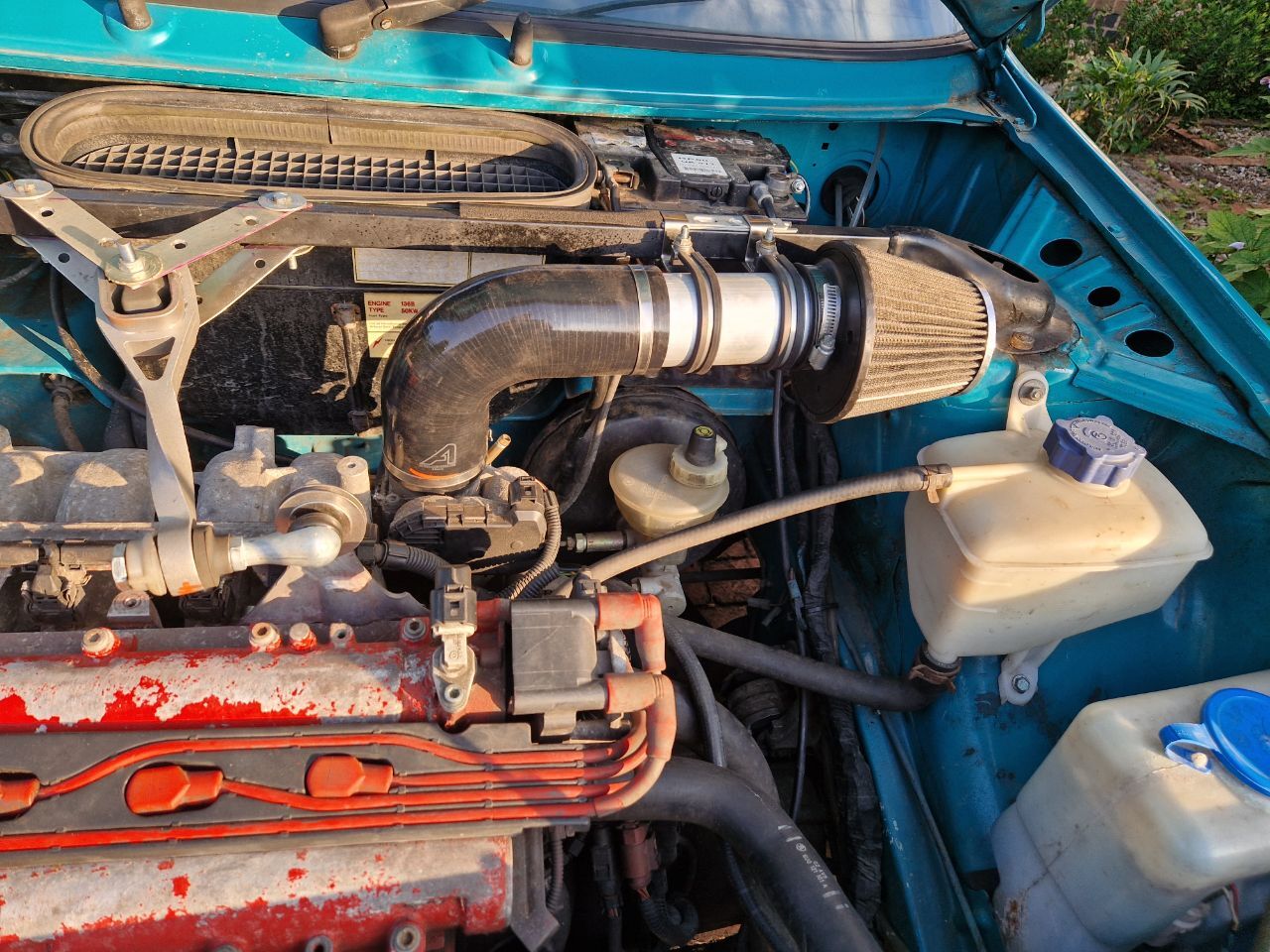

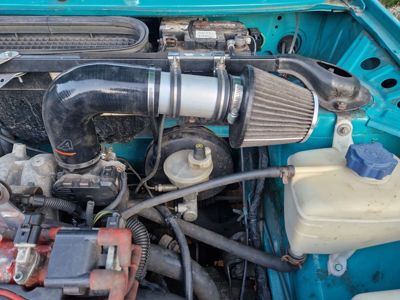

Finally got around to tackling the air  intake extension yesterday.
Yes, it's another collection of odds and sods, brackets and clips but there is method to the madness: the strut brace is supporting a couple of little rubber cotton reel things (like Mini gear shift mounts). These hold the clips around the aluminium pipe, and together with the silicone elbow the whole shebang can move and flex with the engine.
My first attempt was a bit wonky...20250708_205129.jpg.a9d8df3dd74b533acb600ab9ce93e44c.jpg
... so tonight I cut the elbow down an inch or so to level the pipe. 20250709_194439.jpg.57bc174eb65dc61caa4504042e292e49.jpg
Can't give you any dyno numbers but it feels a bit more lively.
Christ this thing is rapid, and it makes a proper race car bark at high revs. I drove it to swap over with the Maestro and it's stayed attached after some spirited driving, so I'm calling that a win.

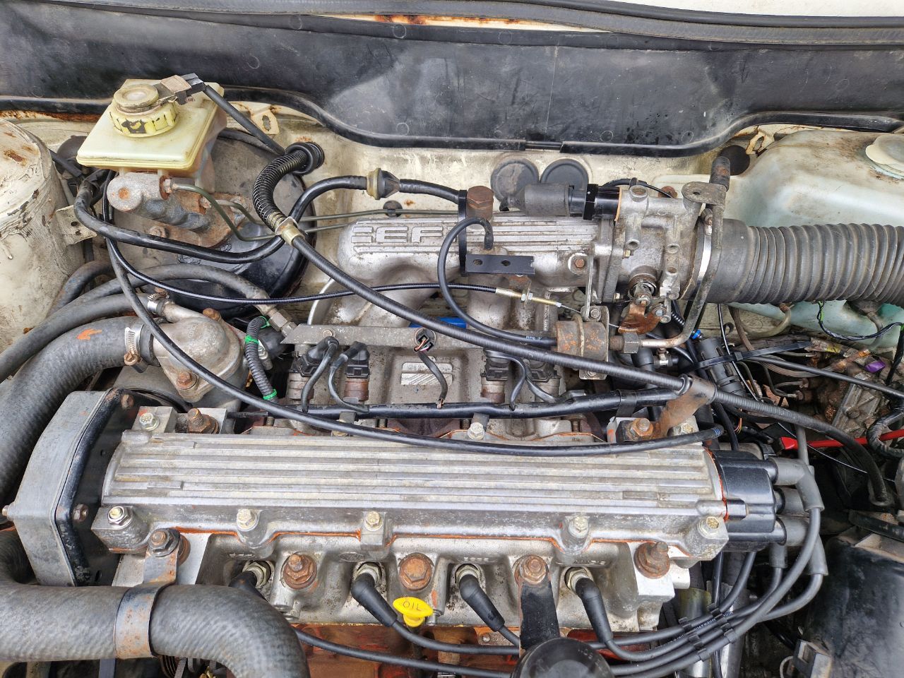

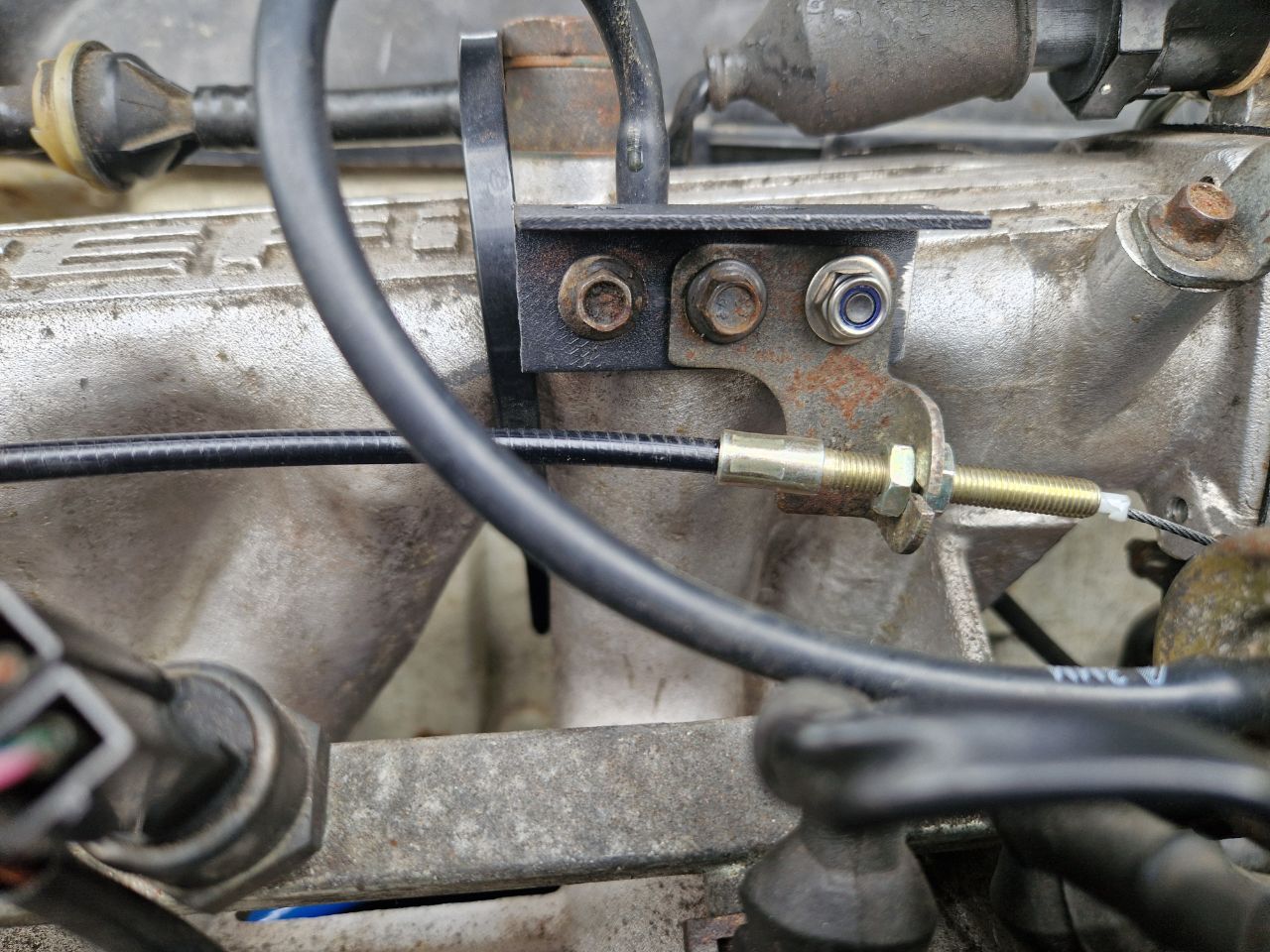

Like an idiot I started fitting a new throttle cable just before it got dark.
I've not been able to source a proper 2.0EFI cable anywhere so I bought a 1.6 cable which looked pretty similar.
On fitting it though, it became apparent why it's not suitable: it couldn't be adjusted to give the proper cable tension.
No matter, a little bodgeneering will fix that - a little bracket to shift the cable stop nearer to the throttle butterfly.20250717_140808.jpg.0149ac21494e50364cb70ee7144fe196.jpg
Can be easily un-bodged if I happen to find the right cable, but only a hardened rivet counter would spot anything amiss. After all, BLARG didn't really concentrate much on underbonnet appearance - it's a swamp of wires, pipes and castings.

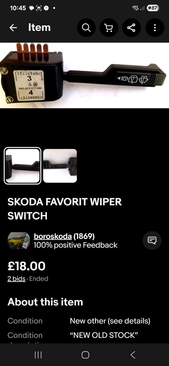

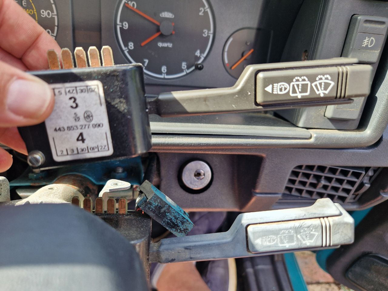

Skoda time. I'd noticed the wipers would switch on the washers on full "speed" and thought that was sub-optimal if I got caught in a downpour.
Picked this up for a reasonable price and it's NOS as well. Screenshot_20250720_104522_eBay.jpg.6d13e30bbf4603be81d1fe3f141120ce.jpg
Pretty easy to fit what with the Favorit interior being made out of Soviet Lego. Sadly it doesn't match the faded patina of the indicator stalk, but who cares? 20250719_163151.jpg.559e5e2020afb45586a3d6d228d754b8.jpg
After that I did a full lights check ahead of MoT next week... They're all working at the moment, which is nice.

Have you fitted that yet? It looks decidedly brown in the second picture which mean it's for a mk1. The picture from the listing does look black though.
The mk1 and 2 have slightly different features. The intermittent wipe on the mk1 is simple, one sweep every four seconds or so. The mk2 has this annoying adjustable timing whereby you flick it on, let it do one sweep then switch it off, wait until the required time then switch it on again and it will maintain that gap. But if you do a couple of individual wipes later on, without realising you have set the gap to about a minute and have to reset it again next time you use it. They carried this over to the Felicia too but I find it more annoying than useful. The fixed 4 second gap on the mk1 is much more user friendly.

It does look brown in the second pic, I think that's just weird lighting though as it's definitely black.
I didn't know about the user-friendly* intermittent wipe function.
The connections were all straight swap so I'm assuming it's the same as the one I took off, seems to work OK.
Polo 6N2: can't remember the last time I saw a GTI one, they are definitely rare now. It was nice of the donor car to give up its engine, tis a rabid little thing.
Well now you know you can have hours of endless fun trying to set it. It's fine if you're on a clear straight road but there aren't many of those in Southampton and I'm usually trying to indicate/change gear/negotiate a roundabout at the same time.

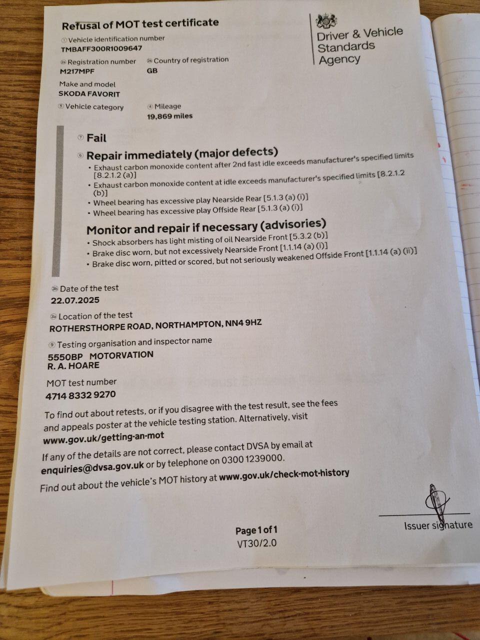

Skoda failed MoT on emissions... Bummer. 20250722_185002.jpg.a6185b2399245c1e1f4691b8f4d13ce3.jpg
Not worried about the rear wheel bearings, @Yoss says they're stock Favorit (or Felicia?) items and they're cheap as chips. I spotted the play when the car was on @Andyrew's lift and wondered if they were' in limits' or not.
The emissions is a bigger problem though. Looks like 2nd idle test was close but no cigar. 20250722_172755.jpg.8b0ee69ca6e788c31496919dba074a04.jpg
Should I:
1) Find a friendly tester. Suggestions on a postcard please, Northampton area.
2) Stick some Cataclean in, give it an Italian, present for test smoking hot. (CO looks too high for this option)
3) Buy a ghost MoT (believe it or not, this is my favoured option at the moment).
Tester reckons a new catalyst isn't going to fix it, and in fact suggested Option 3 as a "fix".
  • grogee changed the title to Grogee's spannering (Maestro, Avensis & Favorit). FAVORIT FAIL
If he is suggesting option 3 then surely he is more than willing to bring a sub off the bench for the emissions part.
I was lucky as I had option 1 available to me. I had shown him what I had done (I refitted the cat, it didn't have one when I bought it, a new temperature sensor, O2 sensor and cleaned out the K&N) so he decided to test it on the older regs.
It did occur to me afterwards that I assume it has a MAF sensor but I never replaced that. I don't even know where it is or what it looks like but it's something to think about.
Also the wheel bearings might just need adjusting. Do they rumble or is it just free play? I replaced the offside one a couple of years ago. I guess it's all a moot point until the emissions are sorted.
Just free play, I didn't know they could be adjusted... That's old school. And good as it means I could get an easy win

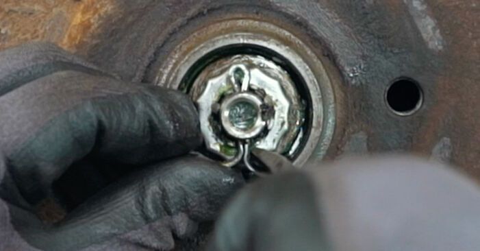

Take the little cap off the rear hub and you'll find something like this (this may not actually be a Favorit)
Remove the split pin. Take that tin cover off (don't know it's actual name). That holds the hub nut on and stops it from moving. As you can see it is twelve sided so you can do the hub nut up half a flat at a time. Or you could undo  completely it and stuff some more grease in there.
You sort of only have to do it up hand tight. If you use a spanner it'll probably be too tight. Or you can do it up until the hub stops turning then back it off by probably one flat. It's all a bit trial and error and you can only really tell once the wheel is back on and spin it so sometimes you have to take the wheel on and off a couple of times. It can be a bit time consuming because of this but it's not hard.

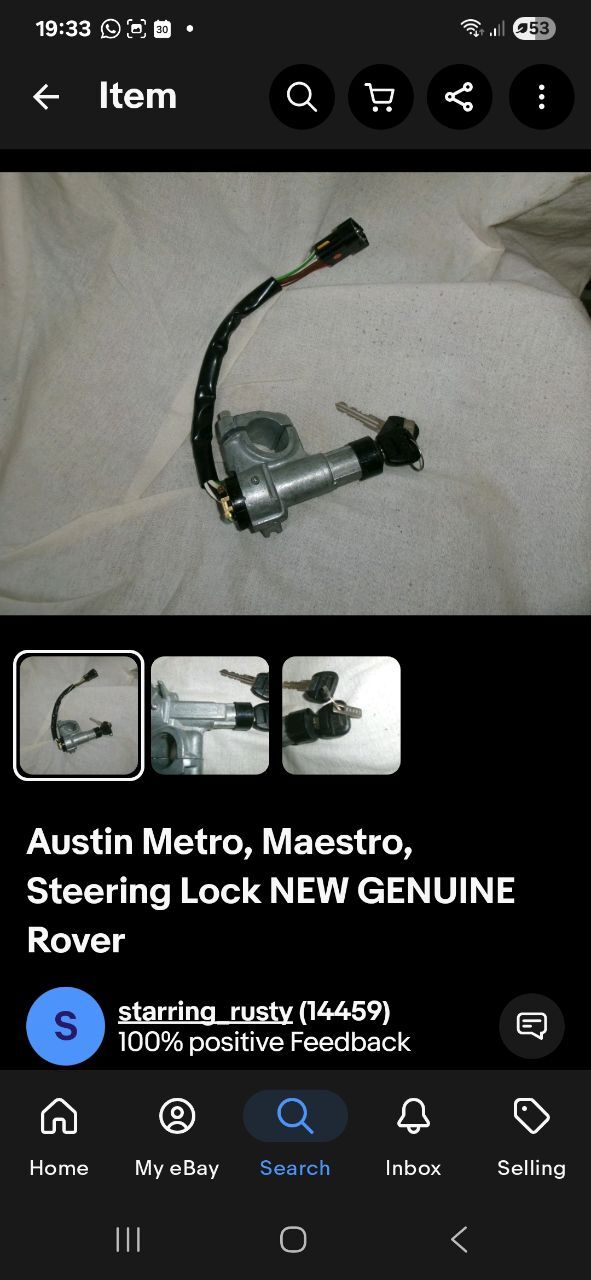

The Maestro has been pretty good but the occasional cutting out has happened again.
No eye deer what the cause is, all I know is that quickly switching ignition off then on again 'fixes' it.
When it happened yesterday the radio briefly switched off, which I noticed because it went back to its default-on volume. This has made me suspect the ignition switch.
Years ago I had a Triumph Acclaim that did something similar. In fact it died on the motorway but waggling the key got me to the service station, where I then hot wired it to get me home.
Could be same issue at play here, so I've bought an ignition switch + keys set to steal the switch from.
If that fails I'll try swapping the ECU (since I have a spare) then maybe fuel pump, after which I'm all out of ideas...
Yup, seems the likely culprit

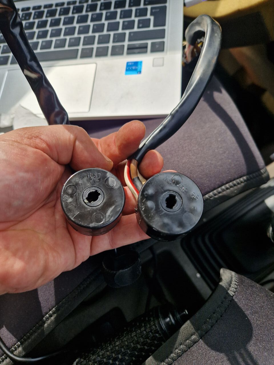

Anyway in a 'parts darts' attempt to fix it, I fitted a new ignition switch.
Slightly complicated by the fact I've fitted a security lock shield around the switch, but I've now pretty much memorised the process to disassemble the cowl and column.
Interesting* to note the differences between old switch (1988 date code) and new switch (1997 date code). The (presumably original) switch uses big fat wiring, even though the harness it plugs into uses thinner gauge wires. I wonder if it's a common part with some other old BL shite where it is wired directly to the solenoid? Mini perhaps?
Anyway it went back together OK and works, so that's something. But no proof it's fixed the problem yet.

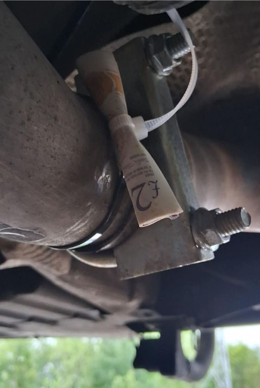

On 22/07/2025 at 22:25, Brigsy said:
Option 1 gets my vote. The solution below
I wouldn't attach it to the exhaust though!

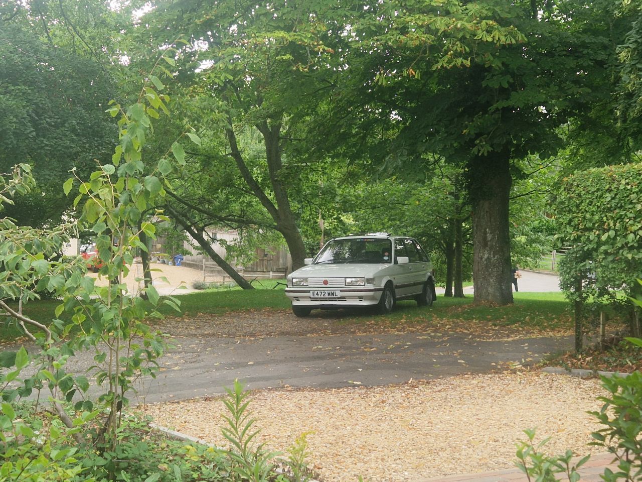

Have a picture of it nestled between some mordernz.
Looks like a toy car next to them. Good thing that road infrastructure kept up with the ever increasing sizes of ca…oh.
