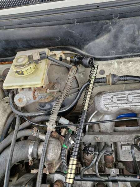

grogee Posted September 10, 2023 Author Posted September 10, 2023 A cursory look at the cable suggests this is a manuel adjust, with the clip thing being moved along the ribbed bit to take up slack. Ah well, at least I've been able to change this leaky seal using the time-honoured FUCKEN PUT WOODSCREWS IN THERE MATE. Gave it a bit of a spruce with some brake clean then tapped* in the new seal with the old bent one. The old one made by Angus apparently, not a name I'm familiar with. I've also been cleaning up the flywheel face and the clutch pressure plate face - although it was in waxy packaging it's old enough to have rusted a bit. Then, because Another Brick in the Wall was playing and I couldn't interrupt it, I applied some CV goop to the CV joint and put the retainer clip on. There's plenty of goop already in it so I've hopefully caught it early enough that there's no damage to the joint. Coprolalia, Dyslexic Viking, JMotor and 4 others 7

Noel Tidybeard Posted September 13, 2023 Posted September 13, 2023 On 9/10/2023 at 12:09 PM, grogee said: A cursory look at the cable suggests this is a manuel adjust, with the clip thing being moved along the ribbed bit to take up slack. no my old fruity that is in fact the correct self adjusting cable- the clip only goes in one place and all the slack is taken up by the spring the adjustment is done by the big black conical doofer that sits against the bulkhead
grogee Posted September 14, 2023 Author Posted September 14, 2023 12 hours ago, Noel Tidybeard said: no my old fruity that is in fact the correct self adjusting cable- the clip only goes in one place and all the slack is taken up by the spring the adjustment is done by the big black conical doofer that sits against the bulkhead Iranu indeed Mr Tidybeard. The cable was obviously self-adjusting with the efficiency and reliability I've come to expect from BLARG products. A new cable is going on once I've contorted myself under the clutch pedal to hook it in. I may take the driver's seat out and put a camping mat down to save my back. But first, gearbox back on using the Jack Fitting of Fright. Onward!

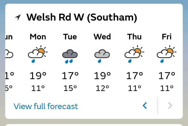

grogee Posted September 16, 2023 Author Posted September 16, 2023 With the weather closing in I've realised there's not a lot of time to get things buttoned back up before the Rains come. This is particularly irritating. It's been dry all week but I spent Mon-Thurs doing work that turned out to be a complete and utter waste of time, then frantically catching up yesterday and this weekend. So of course next to no time for spannering. Fuelled by instant coffee and porridge I leapt* outside to try and manhandle the gearbox back on. I have to say this jack attachment thing is pretty useful and it has an adjustable-angle platform which helps when lining things up. I think with two people we may have been able to grunt and thrutch it onto the splines, however I was working solo so I found some extra long M12 bolts to just keep things aligned. Then I slowly wound in nuts to pull it together. You're definitely not supposed to do this, damaged shaft blah blah blah. But by using common sense I could tell if it bound up, so I just tweaked it a bit at a time until there was room to fit the proper bolts. Work has been suspended while I take Master Grogee swimming, but I'm quite pleased with progress in the hour or so of fiddling this morning. Little bit worried I may not have room to get the rear mount in but with the box attached to the engine I should be able to jack it this way and that to gain access. grizgut, rainagain, High Jetter and 1 other 4

Noel Tidybeard Posted September 23, 2023 Posted September 23, 2023 take the horseshoe clip off cable so inner can go through a loooong way to hook on the pedal easier
Noel Tidybeard Posted September 23, 2023 Posted September 23, 2023 ...or are you suposed to do pedal 1st then clutch arm 2nd 🤔
Noel Tidybeard Posted September 23, 2023 Posted September 23, 2023 ah alook in haynes book 1067 says do both!
grogee Posted September 23, 2023 Author Posted September 23, 2023 Yeah @Noel Tidybeard pedal first then clutch arm. The pedal bit is a right fiddle, you can see it alright with the fuse cover off but there's not enough room for Actual Hands to twiddle the hook onto the, err, hook. Saying that it was a bit easier with the dashboard bottom cover panel thing removed. Then pull the cable through the actuation lever and fit the end fittings on. I did think I'd have to lever the arm up to get that on, but there's enough slack to get it on without a fight. Then last you push the spring back and fit the horseshoe clip. As I did so it made a satisfying farty noise as the gubbins did their self-adjusting. Made good progress this morning, gearbox selector is back on and splash shields repaired and fitted. Just need to finish fitting the air filter and coil bracket thing then connect up the hoses. I do need to investigate the fuel leak too, but I might save that for tomorrow. I'm hoping my friend JB Weld can assist here. grizgut, Rust Collector and Dyslexic Viking 3

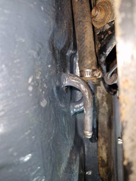

grogee Posted September 24, 2023 Author Posted September 24, 2023 So today I attempted to fix the pinhole leak around the fuel tank return line spigot with JB Weld. With the line removed I carefully cleaned it up with acetone then smeared some fresh epoxy all around the offending area. Unfortunately I underestimated how long it would take to cure and it's still pretty soft. No matter - how about I have a go testing the compression? @Cluffy kindly lent me his kit so I thought it would be useful info, at least so I can do a 'before and after' when I've fitted the new cylinder head. Shirley with the fuel pump relay removed, there shouldn't be any fuel flow so the removed return line shouldn't matter. Wrong! Big puddle under the car. Still can't work out how that happened with no power to fuel line, but anyway... More serious problems are afoot. When I turned the starter I just got a whizzing noise, it sounded like the starter wasn't engaging with the flywheel. Then for good measure, the starter kept whizzing even after I'd released the key. I should qualify this by stating that during the rebuild I fitted a 'new' (reconditioned) starter which I'd hoarded a while ago. I now suspect it's junk with a sticky solenoid. I've thrown the old one back on as that's a known good one. But not tried it yet due to aforementioned fuel shenanigans. Rust Collector 1

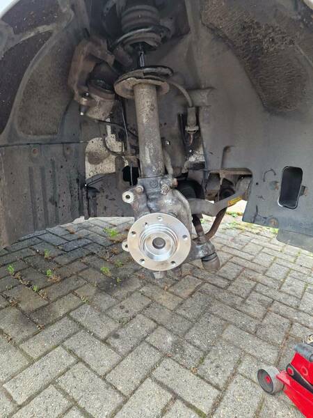

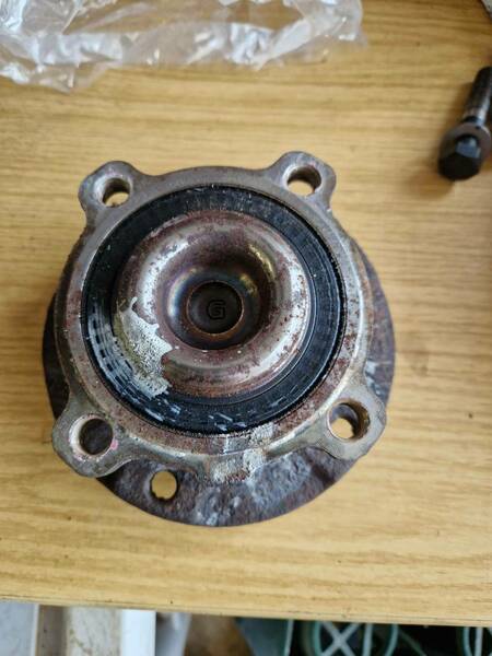

grogee Posted September 27, 2023 Author Posted September 27, 2023 5er front wheel bearings. I'm fitting the absolute cheapest bits possible based on the fact that we're near End of Life for the old frauline. I think the pair was £70. No, I don't value my life. It's a bolt-on part but many bits have to move to get access to the bolts. As expected I've found some more surprises* that will need dealing with at a Later Date. RHS track rod end knackered. Rear lower control arm ball joint knackered. RHS brake shield MIA. I've priced up parts and none of them are cheap... All part of the Ultimate Driving Machine experience I suppose. While in the RHS I had a go at sorting out the front bumper which has had a prang at some point. The usual combination of cable ties and new spire nuts and screws has restored some semblance of alignment. Anyway I've done one side and turned the car round for Part Deux. That can wait for tomorrow, I can't be arsed with any more today. Cluffy, JMotor, Rust Collector and 1 other 4
grogee Posted September 28, 2023 Author Posted September 28, 2023 The other side BMW wheel bearing is done too, and there were more joys awaiting discovery. I did the usual ballache removal of the track rod end, where despite wire-wheeling everything the nut wouldn't come off the TRE thread because the torx fitting to hold it steady was wank and not up to the job. I got a slitting disc and slit through the nut, trying not to damage the threads in the process. I got it off in the end with only superficial* damage to the TRE threads. On this right-hand side, the ball joints seem OK but the front control arm front bush is splitting and it's easily spotted by the MoT man. This is the most expensive control arm on the front suspension but luckily there is a press-in bush available for £20ish, so being quite skint I've ordered that along with the parts required for LHS. Still £140ish in total plus I've bitten the bullet on new Khumo's for the rear at £100 each. I've been searching for ages for a tyre deal I can stomach and nearly pulled the trigger on some Kormorans, but decided to search Asda tyres and found these Khumo's within budget. 'Big name' brands were £120+ which I couldn't justify. At some point I'm going to have to get the LHS track rod end off the track rod. I had a go at bashing the locknut off with an open ended 22mm spanner but the fucker wouldn't budge. My next effort will involve the blowtorch I think, I hope it gets the desired results. On the plus side, I've managed to straighten the front bumper so it's not poking out from the wings and looks slightly less borked. mercedade and Rust Collector 2

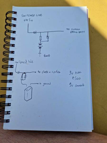

grogee Posted October 1, 2023 Author Posted October 1, 2023 This morning I spent an hour or two in the garage making a battery backup for the Maestro clock and radio. This is because I'm going to fit a remote earth relay that cuts the battery when the car is parked, for two reasons: 1) For some reason I can't be bothered to investigate, the ECU isn't switching the main relay to earth with the ignition on. This means I've got a bodged 'always on' relay fitted but it drains the battery after about a day. 2) There's no security measures in this car other than a crook lock and handbrake/gear lever lock which I don't bother fitting when I just pop to the shops. It would take someone under a minute to break in and hotwire it. At least with a (hidden) earth relay I've added another layer of complication to thieves looking to drive it away. The remote relay comes with two remote control key rings, and apparently only draws 20 micro amps in standby. Unfortunately I didn't have any beefy black battery cable in the correct gauge, but I do have red. I've sleeved it in that corrugated plastic sheath which is black and I'll label it too. My kingdom for a 70s Dymo. High Jetter, AnnoyingPentium, Marina door handles and 4 others 7
