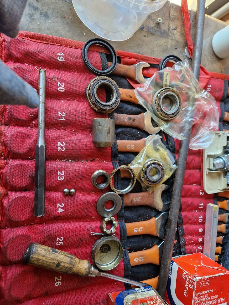

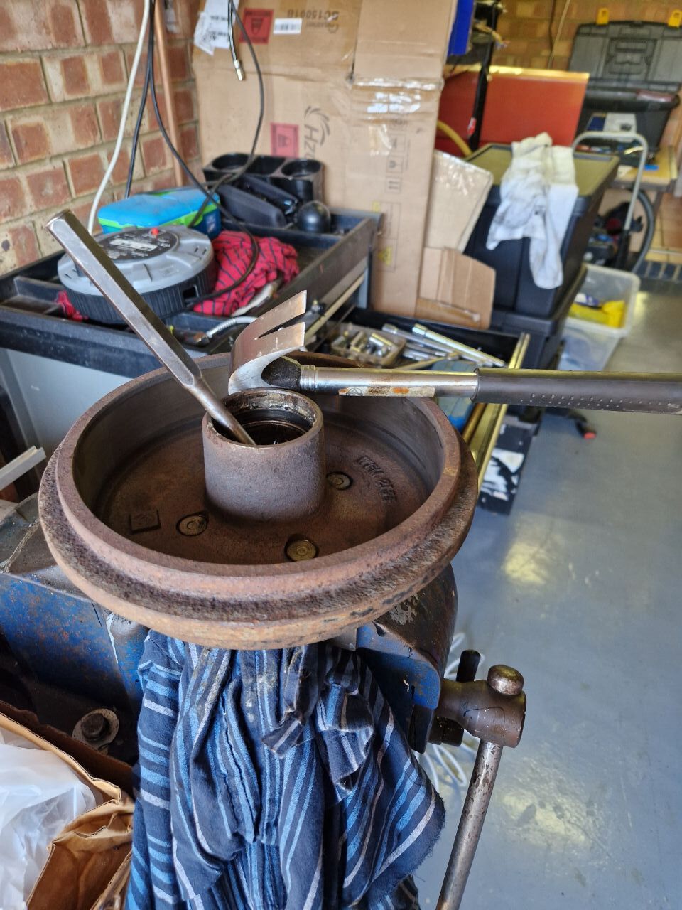

Today's job was rear wheel bearings on the 'Stro. That meant going to my storage lockup an hour away to get parts. But I'm kind of glad I did because my next-door container neighbour was there and he was getting a VW camper out of his container.
For some reason I assumed that storing cars in the containers was no-go, but it looks to be absolutely fine M8. That's good to know because if I sorted out all my container shite and put it at the back, there would easily be room for a car.
I do need to think about some ramps - container neighbour had knocked up some metal ones using a scaffold pole - but I think I'd be able to use or bodge my blue metal ramps which I never use anyway.
Anyway I got the bearings and spare ECUs (for the cutting out issue). Then got to work.

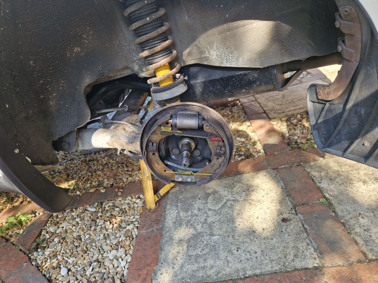

I'm pretty sure the last time I did a drum wheel bearing was when I worked part time in a garage as a spotty youth. Fittingly, today on 6music was 90s rave day so the whole soundtrack was nostalgia laden. 20250808_174354.jpg.56c3676b7ed2fb52a7fe3f446e340c5d.jpg
It's not a difficult job really, it's nice working on old stuff like this that doesn't need yet another special tool to repair. Basically all you need is a hammer, a drift, some sockets and a bit of patience. 20250808_174314.jpg.7e6ba2480631ef04b52fb758266d8669.jpg
Of course it was all going too well, and I opened the second box to find it didn't fucking fit even though the box was handwritten with 'MAESTRO / MONTEGO'. So the offside rear has a new outer bearing and I cleaned and regreased the inner one. 20250808_181626.jpg.4d00c349784fbe79d7d9f5388e51a027.jpg
Anyway there's no play now, so should be good for another few decades hopefully. 20250808_170808.jpg.74ac2abaa74440626d7659d4130cdeec.jpg
I've swapped out the ECU as well, in case that's the cause of my cutting out issue. 20250808_183856.jpg.1166125219a2b7b1fa4b6a8ba400f27c.jpg

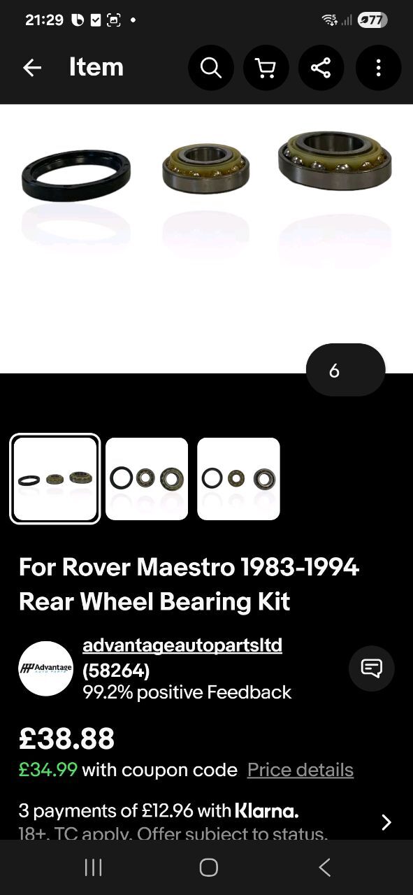

Easy to fit, hard to find. I found one set during my regular ebay trawls, then a year later the outer bearing only.
Front bearings seem easy to come by but rears are like hen's teeth.
I do wonder if some/all of the assembly is shared with other BL FWD shite, need our resident Unipart catalogue lickers to help with this.
Edit: found one, £38 mind
