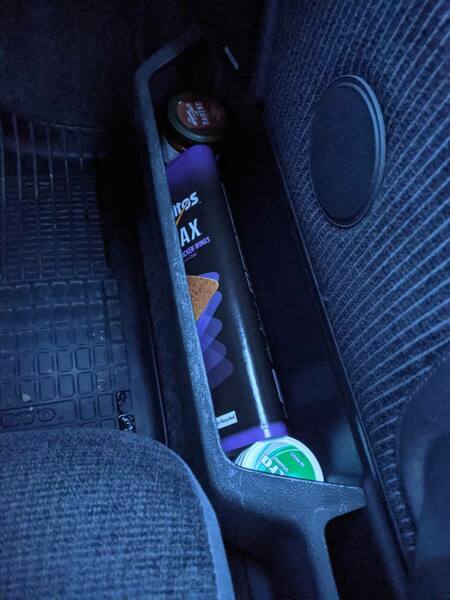

As a bonus - the side pockets are well sized for reduced Tesco finds. The ultimate chewing gum, pringles knockoff and tahini paste transport vessel.

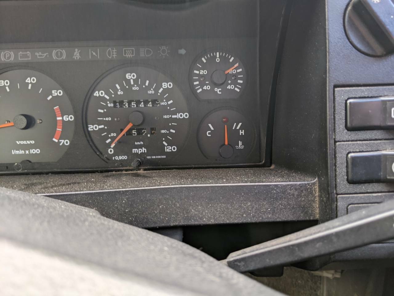

The Volvo has been fine - but driving it and seeing it not get up to temperature was annoying me. As well as it not driving as well as it should because it was cold all the time, lumpy and tappy. When I went to work on Friday it was 1C and I got there and it read -0.5C (I took the posh car as I was tired) - I figure it's not going to get any warmer for a while.
After driving to Halifax and back last week and using more fuel than it should because it was stone cold and being a little bit of a pig in traffic - it was wearing fast.

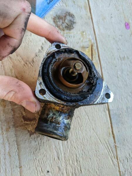

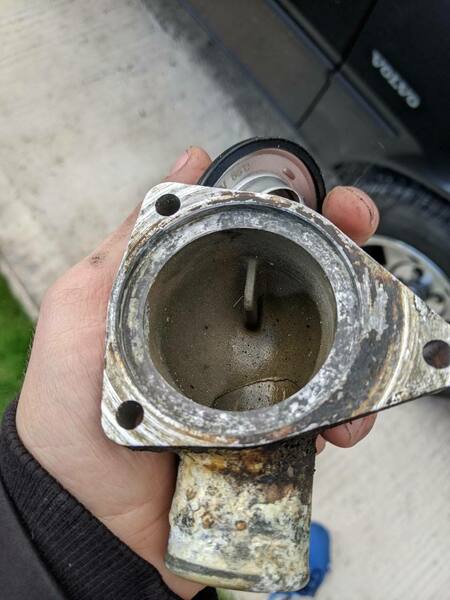

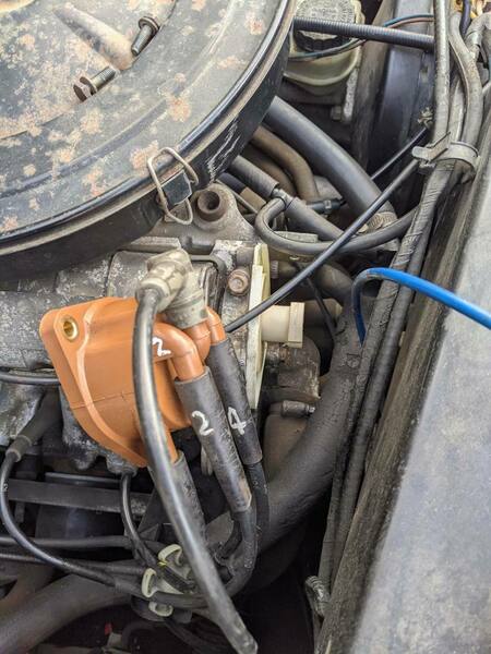

Set about getting the old one out - back of the engine being the 1.7, a bit awkward to get to so I removed the dizzy cap for access (after I'd drained it via taking the bottom rad hose off - saving the coolant of course) - took it off easy enough.
Housing off - thermostat looking a little worse for wear:
Took it out:
Yep - that's stuck open alright - just as suspected.

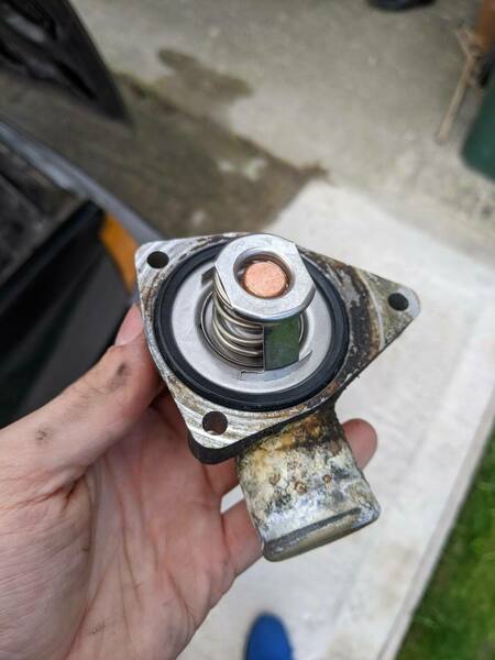

Time to bust out the new one!
Old vs new:

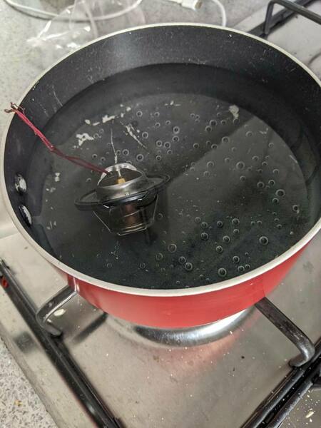

Testing the new one just to  be sure it opens:
And it did!
Cleaned up the housing and scraped off the old gasket that was stuck to it, flathead screwdriver, steady hand and some meth spirits works wonders:
(what was left is just discoloration)
New one in:
Much nicer.

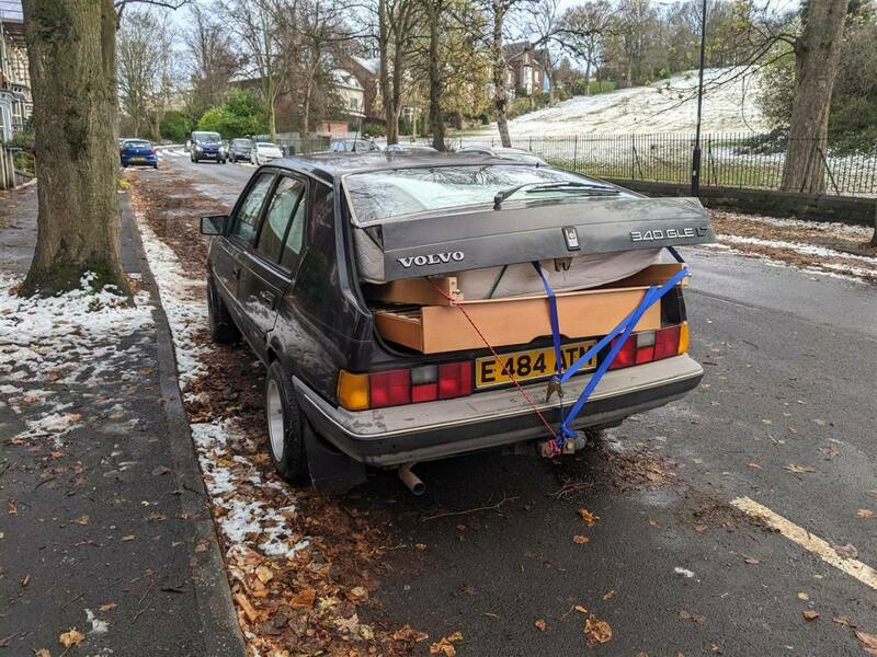

So, the question I know you've all been dying to know the answer to for years - can you fit two single beds and their mattresses in a Volvo 340?
Without a passenger seat, almost:
But more importantly, can you do it without getting cramp in your leg because the seat is too far forward, sitting 2CM from the window and gassing yourself with exhaust fumes?
No. No you cannot.
