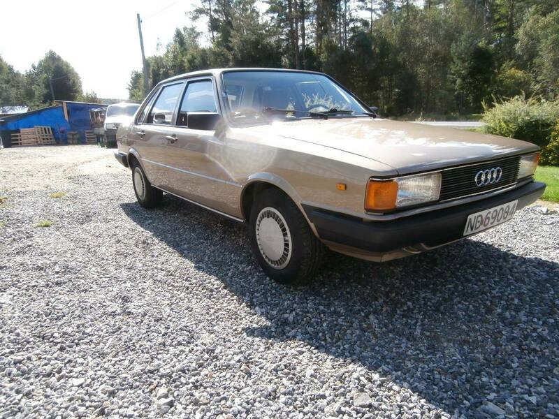

Just to start with and say that writing and pictures is not something I am good at but will do my best. Now I finally became the owner of an older car again. Was difficult to choose when I had several cars to choose from but chose this Audi 80 as I have always liked these and this was a good buy by Norwegian standard a Volvo 240 would easily cost twice as much in the same condition. So this is a 1982 Audi 80 CL so cheapest version with 1.6 petrol engine and 5 speed manual transmission. And has only 117,000 km (about 72,000 miles) on him and has known history the first owner was an older couple when they passed away, the son became the new owner and he passed away in 2018. When his widow was to buy his tombstone, she mentioned to the seller about the car and he bought it and I bought it from him. So it has lived its whole life until now in the town of Kragerø.
Now some pictures and I like the color of this fits the car well.
The dealer in Kragerø who sold the car new.

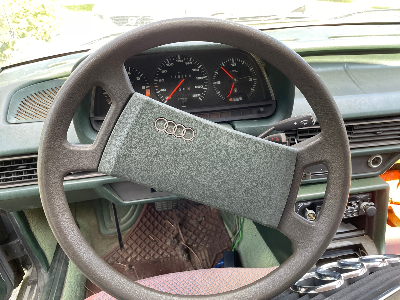

And the interior has a wonderful green color. And I said in the ebay thread about this that I liked the facelift version its dash board better but and having seen this in reality I like it very much.

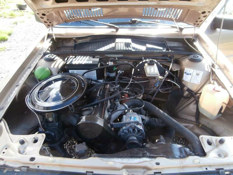

And the engine compartment is incredibly nice still for the age.
So my plans for this one are just to take care of it and use it in the summer. and the car will be kept as original as possible.

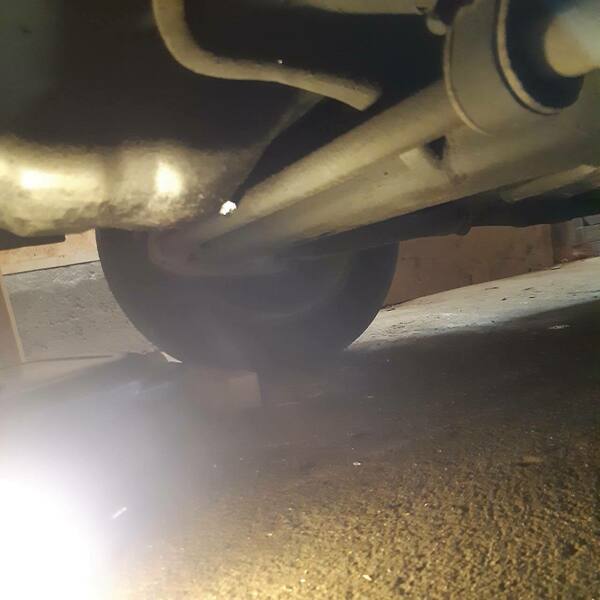

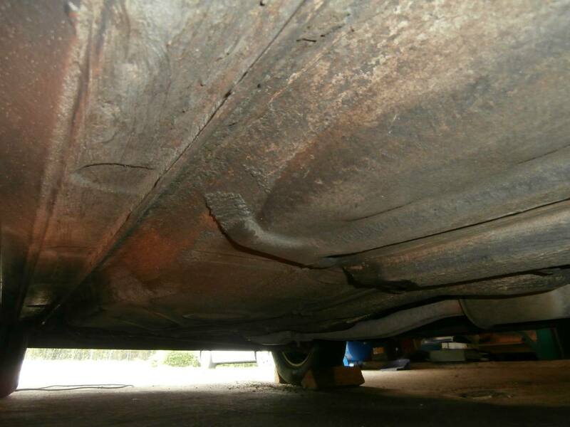

Today I had to wash the car properly underneath as it had a lot of mud in the wheel arches so it was necessary. This accessory for my high pressure washer is very nice.
And is not really that bad considering that the car is 39 years old.

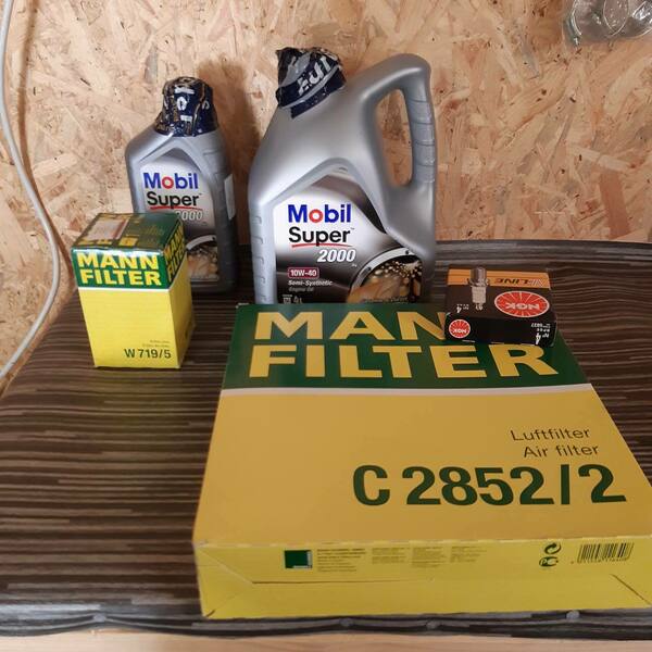

Knew when I bought the car that it needed a service so today I got the service parts in the mail.
New engine oil and oil filter air filter and spark plugs.

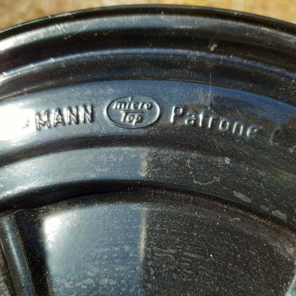

One thing that turned out was that the Mann filter brand was original to the car. The air filter lid is marked with Mann filter and part number and was exactly this filter I had bought.

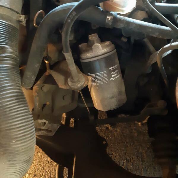

The service was easy and did not take long as everything is easily accessible even the bottom drain plug was easy to get to and did not need to jack up the car or anything else for access.
The oil filter. Was a little disappointing that this and the air filter were cheap low quality filters.

The engine drain plug is easy to access.
So not the most exciting update but am happy to get this done and am very happy with how service friendly this car is

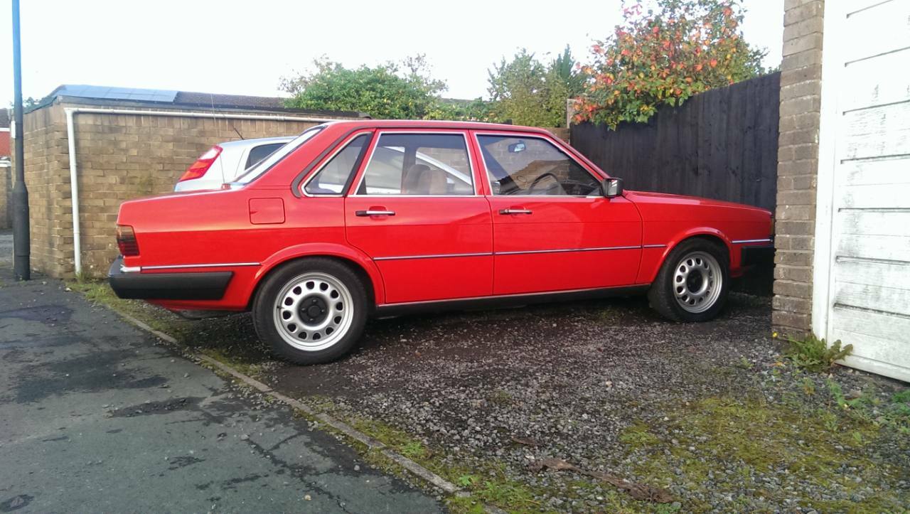

Very nice. 1600 CL same as mine was. Enjoy as they are a  nice car.
Be very careful with the vapour trap when you replace the pipes. NLA and only fitted for a year or so.  Also make sure you really check the rear of the sills and around the rear axle trailing arm(?) mounts to the body they hide the rust in this area very well.  Look through 'Dodgey Bastards' posts on here. If I remember correctly the B2 he had broke there whilst on the motorway :-o. An acquaintance of his now owns mine  Last I heard it was stripped ready for another engine but have not heard of it since. That was a couple of years ago. A picture of it polished to oblivion. Rust was just starting to take hold and It looked better at 10 feet.
Let me know if you need spares. I have some bits left lurking in the garage that I was going to sell but never got around to. Some alternators starter motors and distributors. Shipping will be very expensive though :-(
Thanks! The one you had looks nice in the picture and what rims are they? And mine seems good for rust but when you say that I will check that area carefully so thanks for the tip. And with vapor trap is then a little unsure which do you mean? And thank you for the offer of parts but probably also think that the shipping will be too expensive unfortunately. But if it should be relevant then will get in touch.
Wheels are commonly referred to as golf g60 wheels. Those are 15". The car is sat on lowered springs and had the arches rolled as well. All done before I bought it ;-)

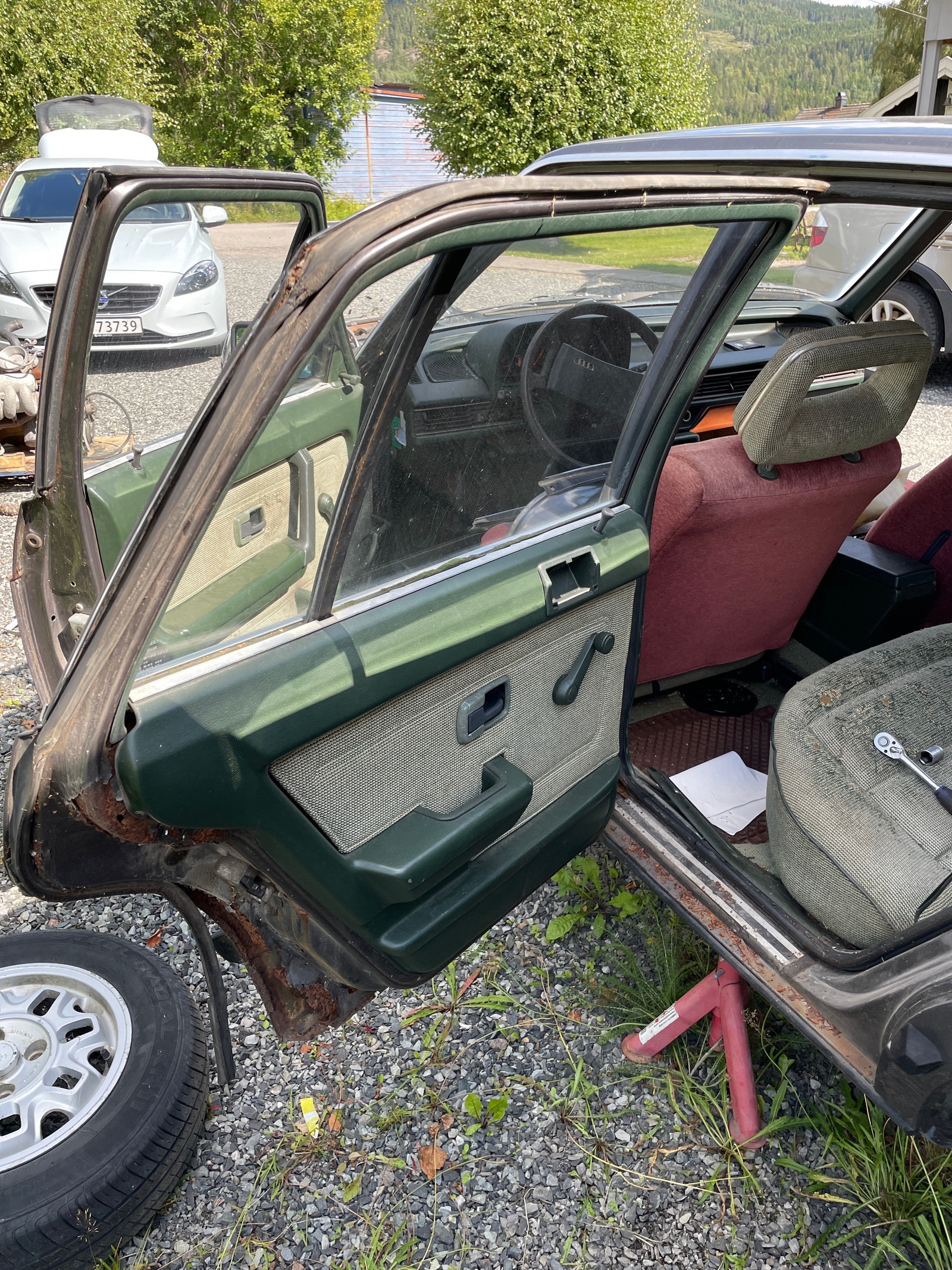

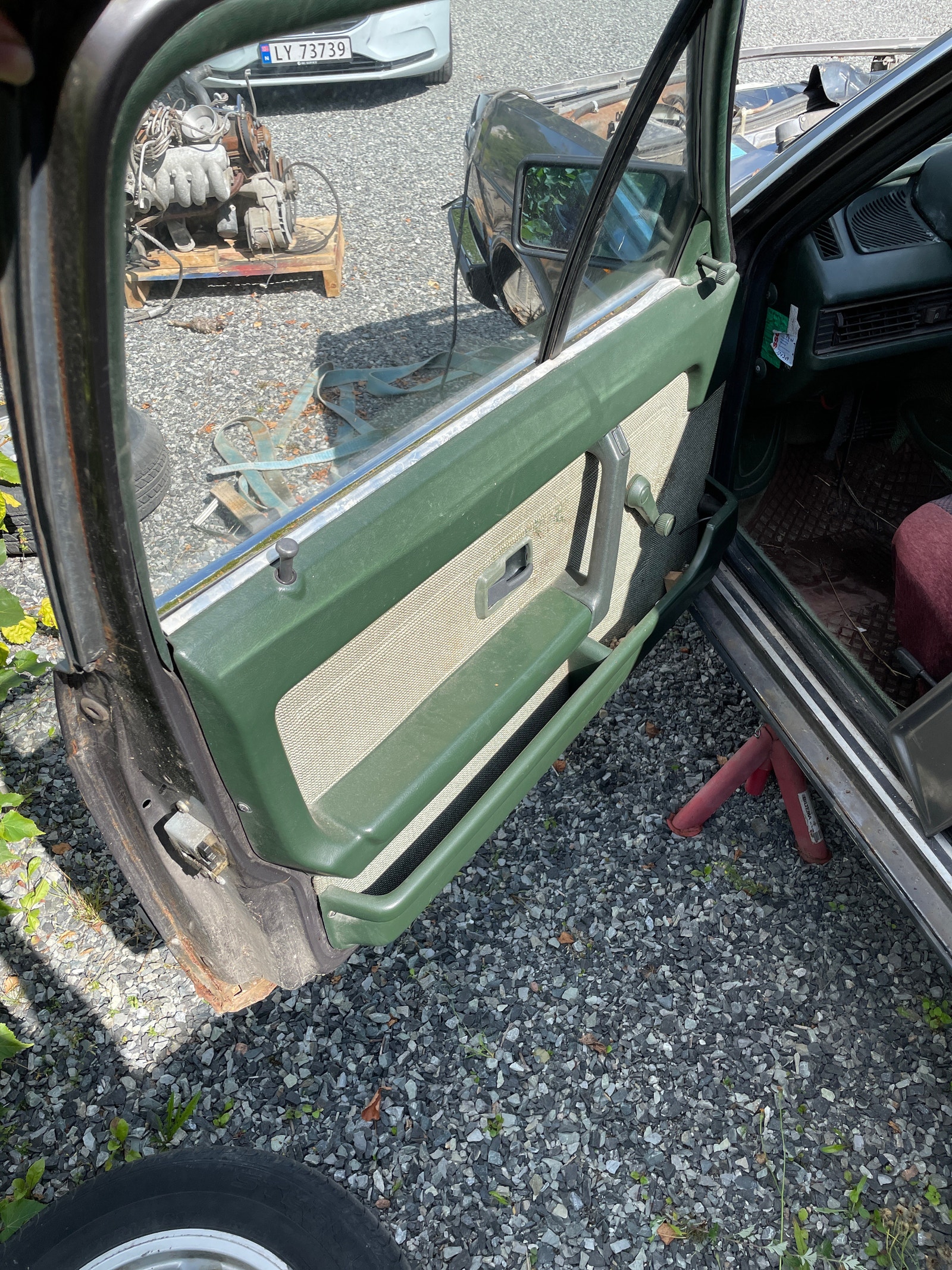

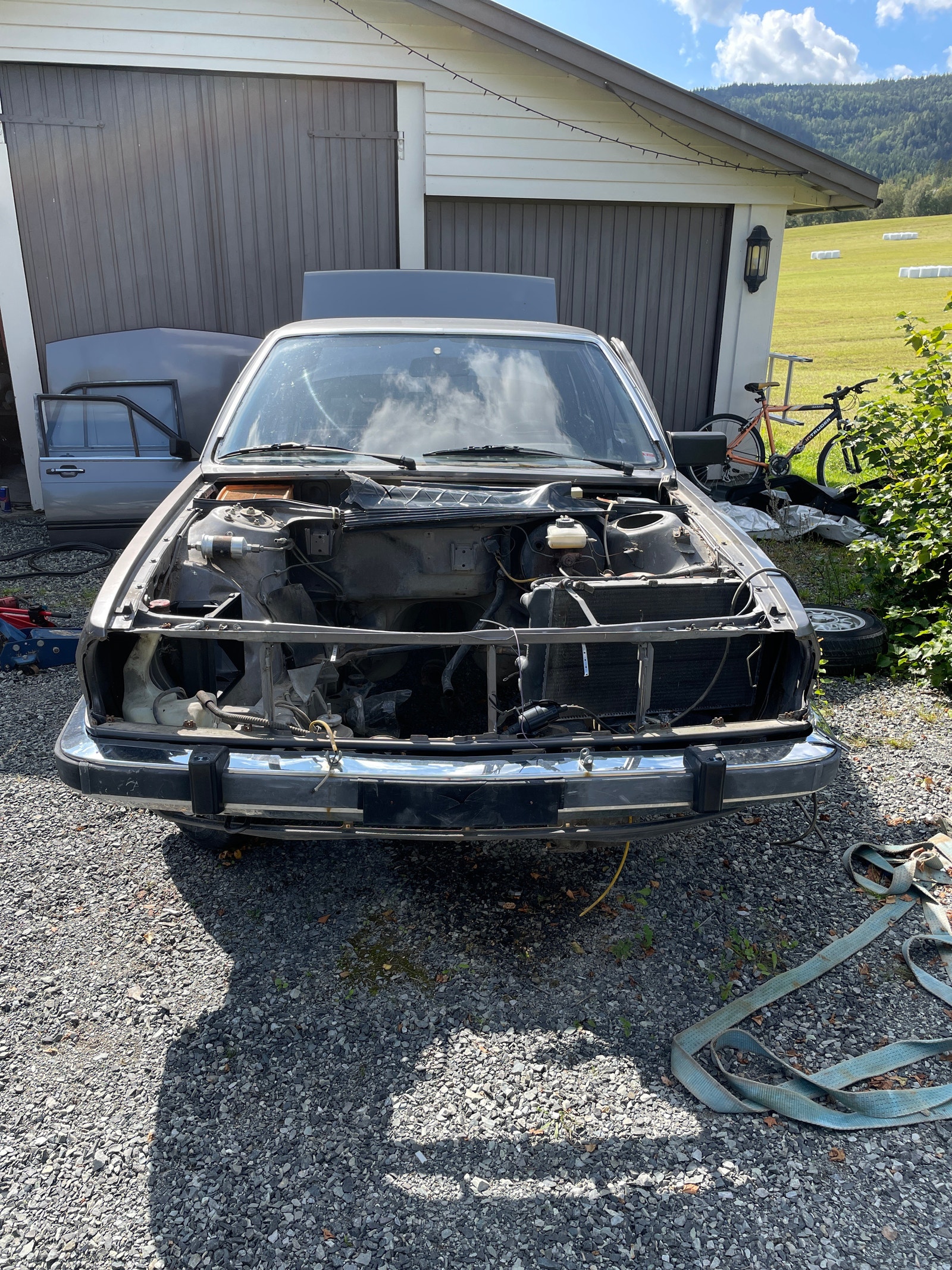

There is one selling a 1982 Audi 100 in parts here. These have a lot of similarities with 80 but do not know how much fits between these are especially things like seats I think of then. Would think that those in a 100CS are better than those in an 80CL? Also do not know if I would have done it and there is over 4 hours of driving and pick up some parts from this. But I'm thinking about it. Galleribilde
Galleribilde
Galleribilde
Galleribilde
Steering wheel, seats, and probably wheels are common or can be exchanged between the B2 and C2. Also some of the smaller parts in the engine bay such as the brake fluid reservoir, but I think that's about it.
That's good to know. Then the only question is are the seats in a 100CS better than an 80CL? Because if I were to do this, the seats in the parts car should be in good condition and more comfortable than the ones I have to be worth it. But the seats in the car now are not bad but if I could get some who is even better then it is something I will consider.
The seats themselves may be slightly wider, but you should be able to use the same sliding bases. If in doubt, try a C2 seat on a B2 base first.
I actually liked the C2s, especially in 100 5E or 200 5T form. The Dovercourt dealership in St.John's Wood, London offered the 200 5T for £13,000 at launch, and my parents took me to see it as they were looking at the possibility of buying a new Polo.
I have to think a little about this. I will probably never get the opportunity to buy green interior parts from a 100 again. But it is also a problem to get them as I have to borrow a van. So maybe I should contact the seller and hear about the condition of everything before I do anything more.

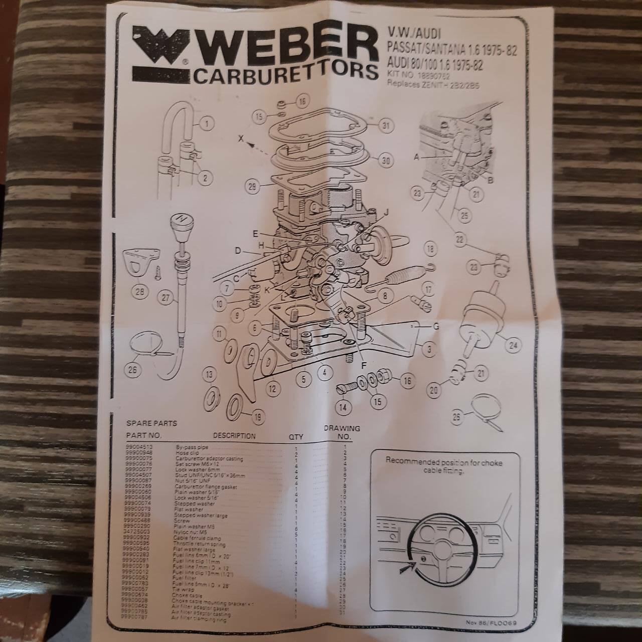

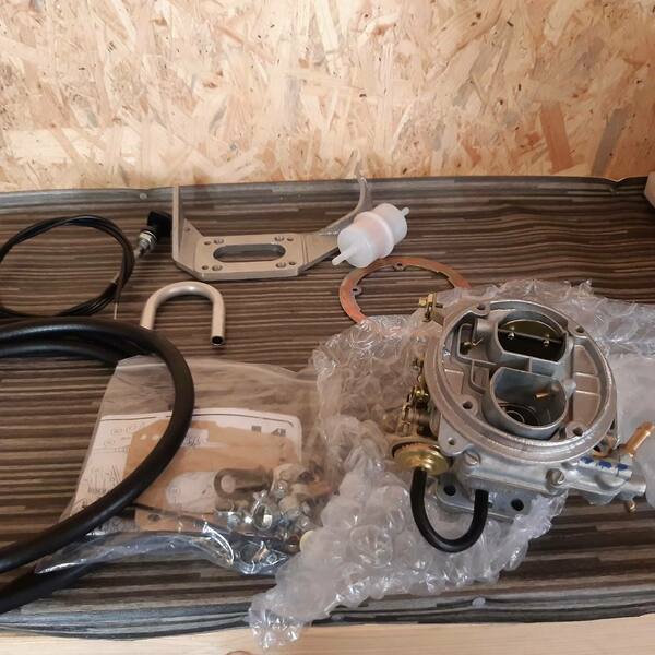

So the Audi gets a new carburetor.
This was something I knew I was going to have to do sooner or later. Since the original carburetors in these are unnecessarily complicated and known for problems. And this became necessary now when the old carburetor started leaking gasoline. So this is a complete set for conversion to Weber carburetor for this car.
I am missing the rubber part under the carburetor so I have to wait and mount it until I get that part. But I took today and mounted the Choke cable and was lucky it comes with the Choke cable in the set but I ordered with a longer one to be sure and was the long one I had to use. And during assembly I had to disassemble the dashboard a bit.
And was very pleased with the Choke cable fitted this looks original to the car.
So then I just have to wait until I have the part I need and the carburetor will be replaced. And I bought the Weber kit from https://classiccarbs.co.uk/  if anyone was wondering.
