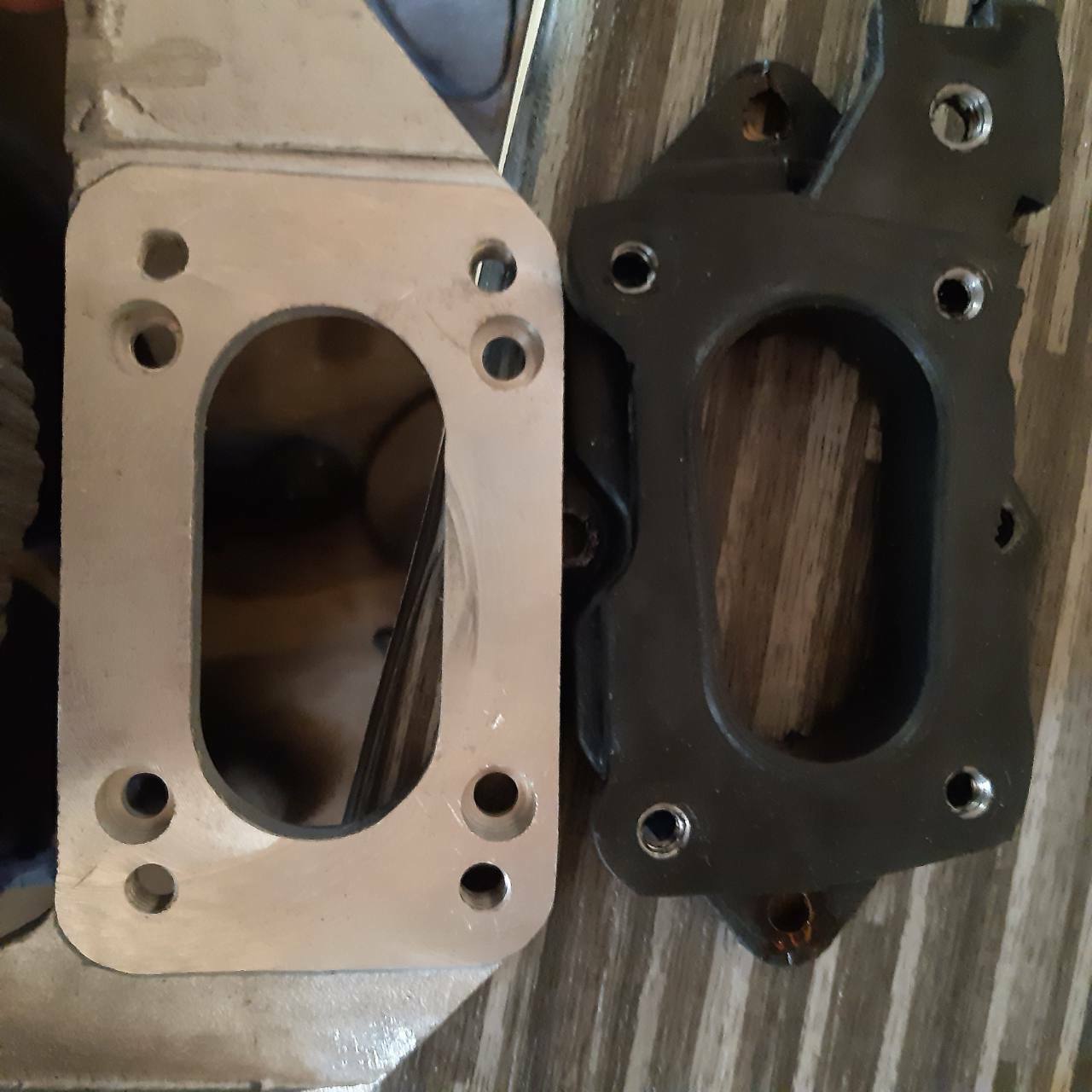

Another possibility is this abdapter in the picture below but again is intended for the larger carburetors but possible it could work but to connect wires and hoses with this will be difficult I am afraid

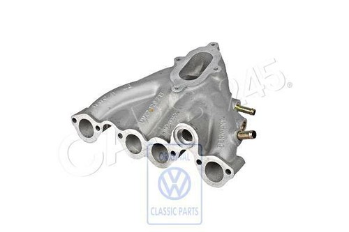

Genuine Volkswagen Intake Connection NOS Jetta Quantum 027129711B
My intake looks like this against the engine so obviously not the same.

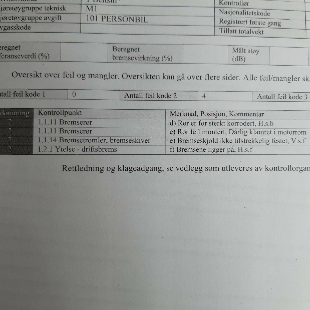

It did not pass. The faults are 1 brake pipe at the rear must be replaced, a brake pipe front is poorly attached, a brake shield left front is loose it can be removed, And the brakes hang on the right front. So I'm very happy with this. The car will be in again with them on Thursday next week and they will fix the brake pipes and possibly the other but I will try and fix the hanging brake before that. I was also told that the front brake discs are almost worn out, so I will replace them this winter.

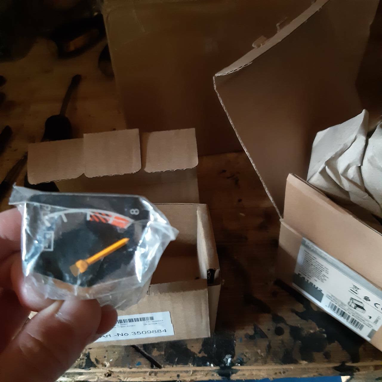

Another thing that happen is that I bought a Pierburg 1B carburetor like the one I have but with manual choke from Germany on ebay. And when the package arrived, it turned out that the seller had sent me a gauge instead.
This gauge is not worth as much as the carburetor and the seller does not answer me anymore so I think I have been screwed over. I have been shopping on ebay for a long time and this is the first time I have experienced this.
  • Sad 3
Strange things have happened now with the carburettor i bought. Was called yesterday by a Norwegian who had got my carburetor also it turned out that the gauge I had got he had ordered. So then the only big question was where does he live? Arendal, ARENDAL? It's less than an hour's drive from me. So we met halfway today and exchanged packages. What is the chance that something like this can happen? So now I got the carburetor but it unfortunately lacked the choke parts I hoped it had. And seller, I have not heard anything from.

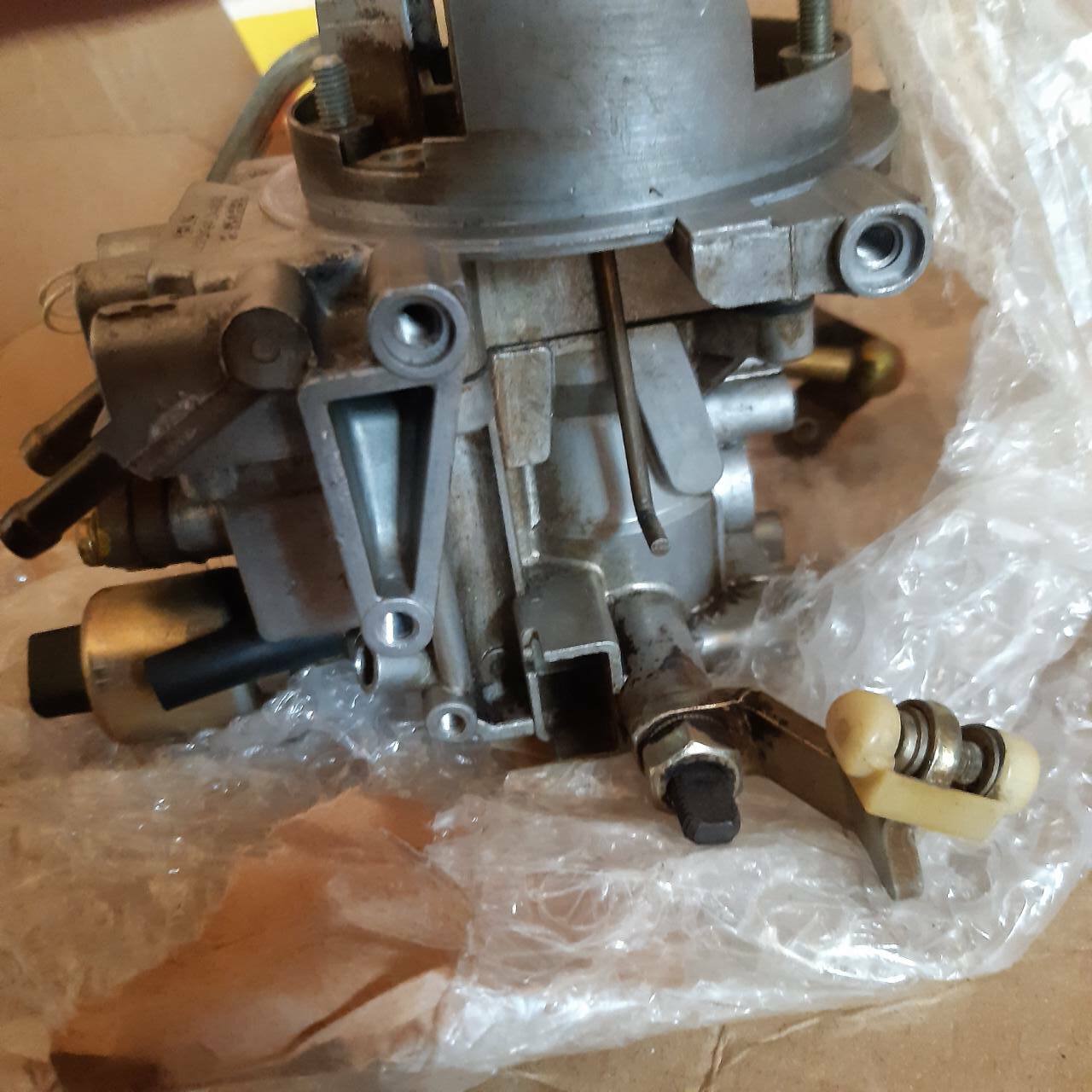

Have today looked a bit at the carburetor I got this weekend and it is clear that it lacks choke parts it must have it is a bit annoying but that's how it is. The rod  that hangs from top to bottom is for the choke.
But I got a carburetor adapter today. Which is from 1 barrel to 2 barrel. And was positively surprised by this it looks like decent quality for the price.
And tested this against the Weber carburetor and this can work the only thing is if this goes clear of the hood as I am afraid it will be too high.
