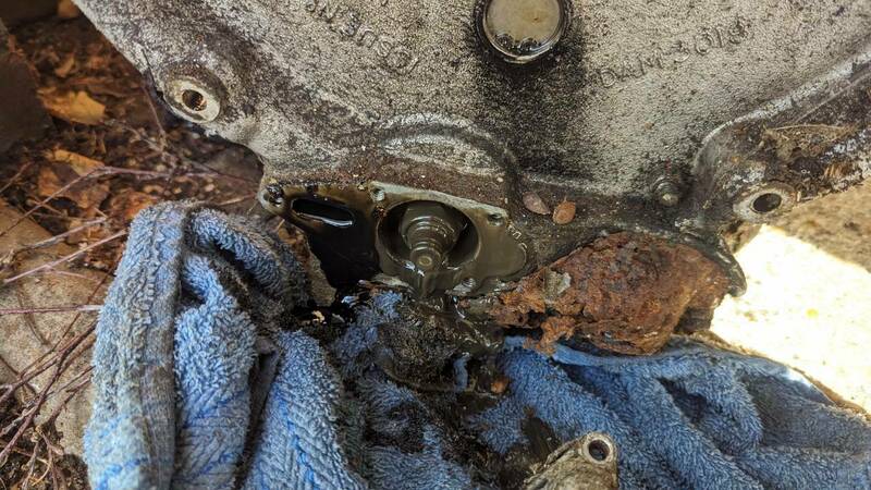

I then set about removing the transfer case. Thankfully the engine was full of oil and water which pissed all over my garage floor. My fault for not assuming it was empty...

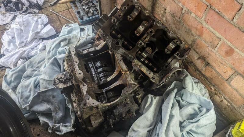

I split the block and box and made even more of a mess
Then started to remove the crank. I had to undo the main caps and move the crank about to get at all the rod caps as the pistons were seized in such a position that I couldn't get at all the rod bolts. Thankfully i could once I had the caps off.
And then finally one very clean looking crank. There's no burrs or grooves in this one and it measures within tolerance so it's going straight into my manual engine. Saves me paying for a crankshaft grind. I'll still use new bearings in it though. The rest of the engine was collected by the scrap man that day. Block and box were scrap from water damage and I have no need for auto parts.

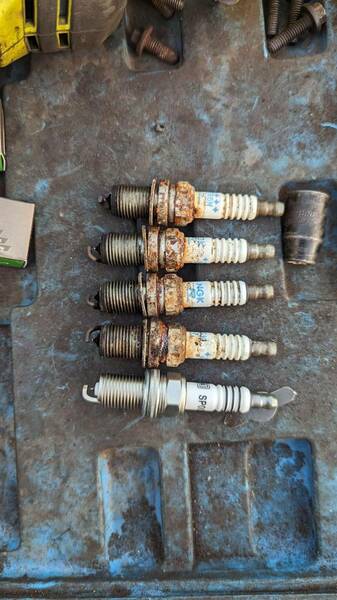

I also took the MGF for an emissions test on Friday and it passed after I fitted new spark plugs and coils. The plugs were pretty bad.
