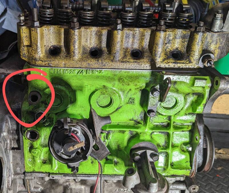

I also fitted the oil pump. It's important to prime them and lube the gasket. It doesn't need sealant. That's a real risk to blocking up the oil pump and I've seen a destroyed engine from someone using sealant to seal the pump up and it jamming up the oil pump. I drown the gasket in oil, fill the pump with oil, then fit the pump. Later I'll back fill the oil pump too to make sure the engine makes pressure as soon as possible when it starts.
Blimey - you made that look easy! :)
Interested in the "Later I'll back fill the oil pump" bit - how d'you do that?
Just wondering as there's a slim chance that this summer I might get to work on my Park Lane that's been sitting unrun for a couple of years; I'd like it to build pressure ASAP if I do.
Remove the oil transfer pipe where my circle is. Pour oil down this hole. Rotate the engine backwards to get the pump full of oil. Then rotate it forward to suck oil out the sump.
