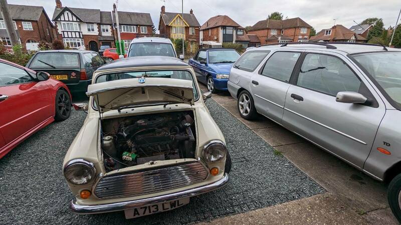

Its Tuesday morning and we're ready for the real off from Nottingham. The cars are lined up and were about to set off for the first stop which is Dunfermline north of Edinburgh. Should be about 5.5-6 hours which will be more than enough for me 😅

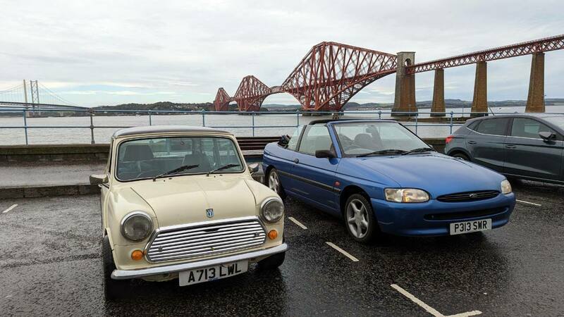

We have made it to a big red bridge

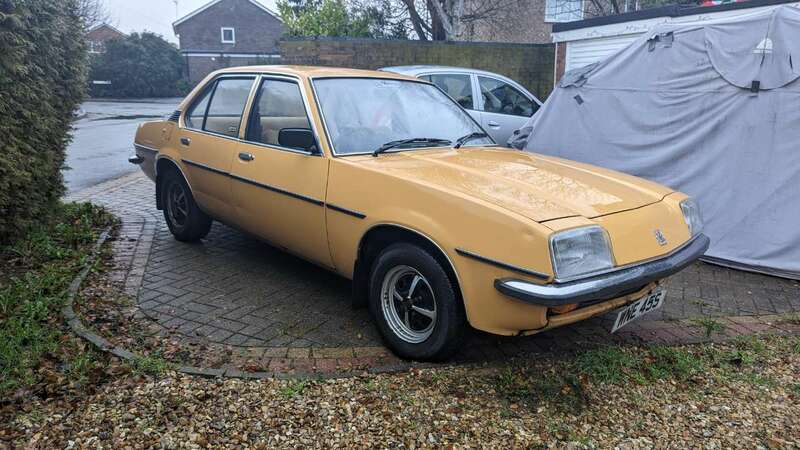

I done bought a thing. It's in good hands and will see the road again in the next few weeks/months! My first foray into Vauxhall's having been a Ford man growing up!
