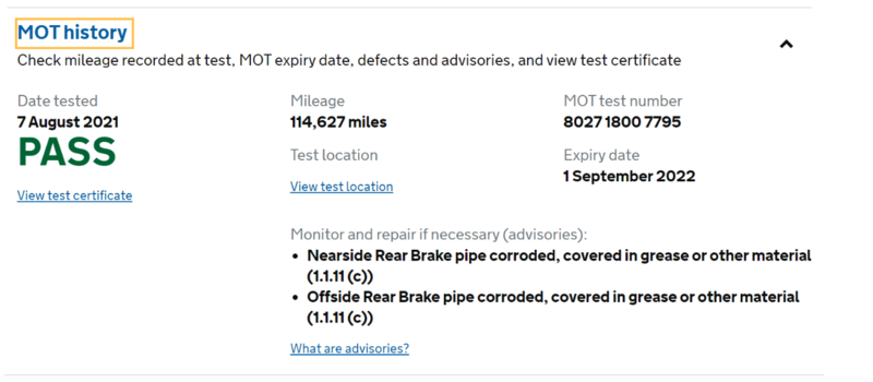

AndyIggs Posted August 7, 2021 Author Posted August 7, 2021 After a fail on both front CV boots we've got a pass! Couple of advisories on rear brake pipes but they don't look that bad to me so will get around to them over the next 12 months. Next up is an oil change, I've not got a record on previous services but I'll be dropping the sump this time and fitting a new pick up pipe. These engines can be a ticking time bomb if left on its original as they can get blocked which can lead to oil starvation and would definitely write the car off. Seeing as I've recently done the rocker cover gasket and replaced the fragile PCV pipe from the crankcase it makes sense as I reckon there will be a few rogue bits in there! Lacquer Peel and Matty 2

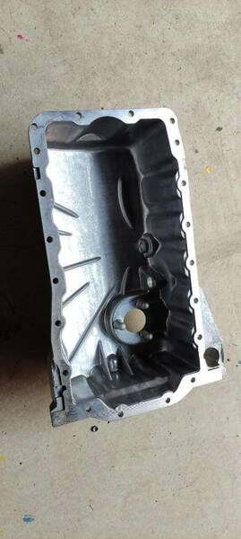

AndyIggs Posted May 15, 2022 Author Posted May 15, 2022 Old sump off, out of 23 bolts there's always "that one" that makes life a little difficult. Looking in the pan its probably a good thing I originally planned to do the oil pickup pipe (prior to the sump plug issue above). The pipe itself wasn't too blocked but got replaced anyway: Filters changed, new sump on and back on the road for hopefully a trouble free summer. Alloy refurb next. FakeConcern, Dick Cheeseburger, theshadow and 5 others 8

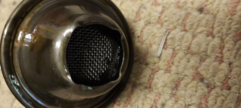

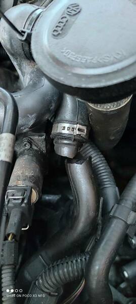

AndyIggs Posted December 6, 2022 Author Posted December 6, 2022 Been a while but a small update! Just coming up to 118k now on the silver dream machine. MAF sensor taken off, cleaned but still seeing idle issues. The only thing I did find on another check is the "hockey puck" section of the PCV has a slight weep to the valve with some lovely oily contents, so off it came and replaced with a new one: Whilst in a productive mood and to be 100% sure, I replaced the remaining 3 coilpacks: Ruck of pipework connected to the block also checked with no damage or splits seen, and assembled back together (again). The only good thing about doing this is I'm relatively quick at taking all this off and back on again the amount of times I've done this now! Unfortunately this has still made no difference to the missfire. Already pumped a fair few £ into this now and don't fancy any further games of "part darts" so I've given in and its booked into the garage next week for a smoke/compression test. Fingers crossed nothing major comes out the woodwork as I really do enjoy running around in this thing and it makes a perfect winter shed. CreepingJesus, Coprolalia and N Dentressangle 3
