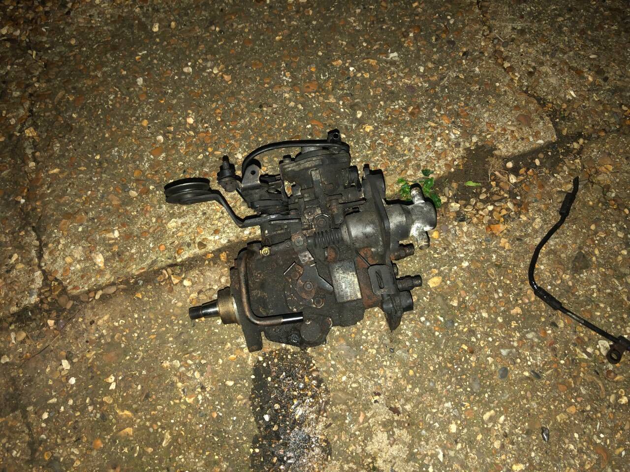

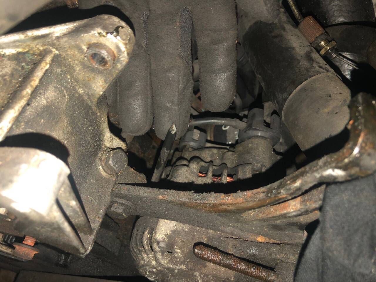

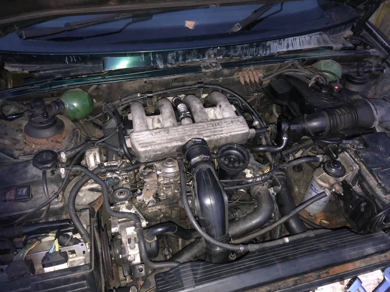

Rust Collector Posted April 16 Author Share Posted April 16 I’ve been back on the case with the fuel pump tonight. The main job was to disconnect the last of the hoses, fuel lines etc. That’s the only goal I set myself tonight, but the kids were in bed and felt motivated so I carried on. A while back I bent a 45 degree angle in a spanner by mistake, and made a shit joke about it undoing bolts around corners. Anyway, it turns out they’re actually a thing and they’re needed for this job: You can’t really get the four nuts holding the pump on any other way. Getting leverage on the rear nut is not easy, so once again my copper tube fetish came into play Whilst undoing those nuts I was alarmed to find a severed hard line under the LHM pump as I yoinked it out Likewise, the goo inside this waxstat thing appears to be fucking off and doing it’s own thing. The spare pump is the same. Proof that I somehow managed to avoid losing the woodruff key for a second time: Theres a tool for getting the pump shaft free from the sprocket. I don’t own that tool, and I promise I absolutely didn’t use a club hammer on the spare pump and a pry bar on the one in the car. To be fair, there isn’t much force needed to release the pump at all. I reckon you could do it by hand if you were patient enough. Success: I didn’t expect to get the pump pulled out this eve, so I’m pleased to have done that. I’m now indoors enjoying a gin and tonic and knuckles bruised like I’ve been on a night out in Newhaven. I now need to decide what to do about that PCV hose. I can get a replacement from Europe for £20 which will arrive fuck knows when. I can get a length of the same diameter oil hose from CBS by Thursday for a tenner, but I’ll have to bend it to shape and hope it can manage the radius needed. Choices, choices… Also, does anyone know if I should be worried about the orange goo escaping the waxstats? JMotor, Dyslexic Viking, Stinkwheel and 8 others 11 Link to comment Share on other sites More sharing options...
Rust Collector Posted April 16 Author Share Posted April 16 Oh, and I forgot to mention RE that severed hardline: it was cut at both ends and was clipped to the block. I’ve removed it now, does anyone have any ideas as to what that was and if it was needed? It looks like it would have carried LHM but there’s no obvious places that don’t have a line connected to them. Link to comment Share on other sites More sharing options...

Rust Collector Posted April 17 Author Share Posted April 17 2 hours ago, Stinkwheel said: Once upon a time I knew what that cut off metal pipe was for, but that was about 2014 and I’ve forgotten a lot of stuff since then. It can't be anything too important as there's no fluid pissing out anywhere. I'll have a look on a parts diagram later just out of curiosity. On the subject of non-working parts, a browse of some Citroen forums has revealed that I don't need to worry about the waxstat thing. It's designed to reduce cold start emissions by advancing ignition timing, but is of no detriment to reliable operation when it fails and apparently TADTS. Tickman and Stinkwheel 2 Link to comment Share on other sites More sharing options...
Stinkwheel Posted April 17 Share Posted April 17 2 minutes ago, Rust Collector said: It can't be anything too important as there's no fluid pissing out anywhere. I'll have a look on a parts diagram later just out of curiosity. On the subject of non-working parts, a browse of some Citroen forums has revealed that I don't need to worry about the waxstat thing. It's designed to reduce cold start emissions by advancing ignition timing, but is of no detriment to reliable operation when it fails and apparently TADTS. TADTS a phrase so often used about big hydraulic Citroen's, it really isnt funny (But is) Rust Collector 1 Link to comment Share on other sites More sharing options...
Rust Collector Posted April 17 Author Share Posted April 17 3 minutes ago, Stinkwheel said: TADTS a phrase so often used about big hydraulic Citroen's, it really isnt funny (But is) It's amazing how many things can break and yet they still just keep going undeterred. I'm just thinking, has the car had the LHM pump swapped out at some point? I think there were 2 different types of pumps depending if the car was a sinker or not, which could explain a redundant hard line near the LHM pump that goes off in the direction of the accumulator. Link to comment Share on other sites More sharing options...
Stinkwheel Posted April 17 Share Posted April 17 13 minutes ago, Rust Collector said: It's amazing how many things can break and yet they still just keep going undeterred. I'm just thinking, has the car had the LHM pump swapped out at some point? I think there were 2 different types of pumps depending if the car was a sinker or not, which could explain a redundant hard line near the LHM pump that goes off in the direction of the accumulator. Its quite likely. Not sure if i ever said, but that car used to be a loan/pool/thing for Medway Citroen who used to be a specialist garage down in Maidstone. Been closed up a few years now, but i used to know the people that owned/ran it quite well. I (well my ex) bought it from them when they closed up. Its probably had quite a lot done over time with regard to bodging* Ive also just remembered, you might want to flush the radiator or something at some point, if you drove it as 100 ish for a 5 minutes it would start to get a bit warm as the cooling couldnt quite cope, fine all day long at 80 though, sorry   *Inventive repairs Rust Collector 1 Link to comment Share on other sites More sharing options...

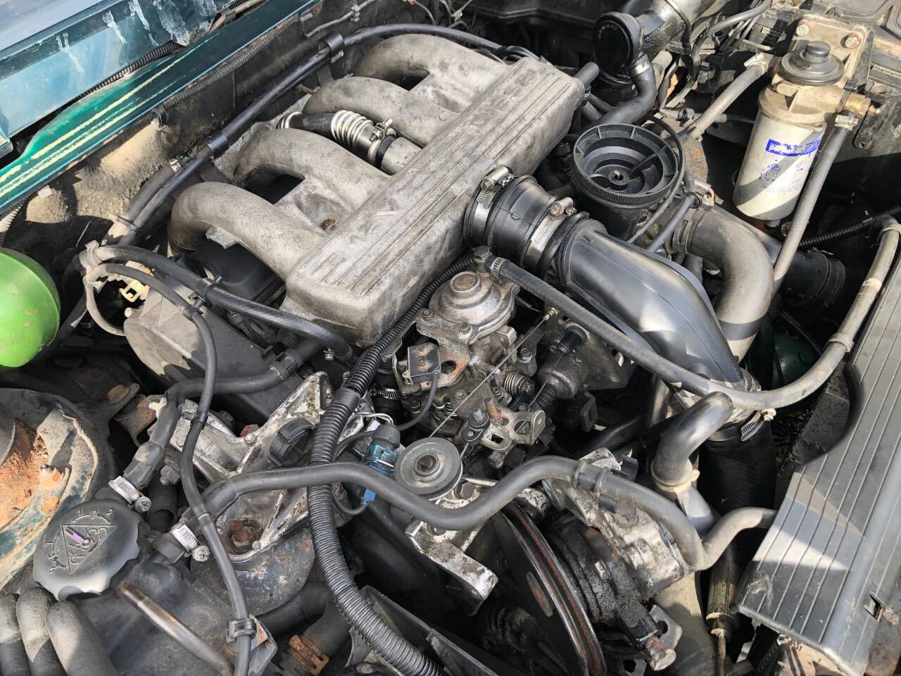

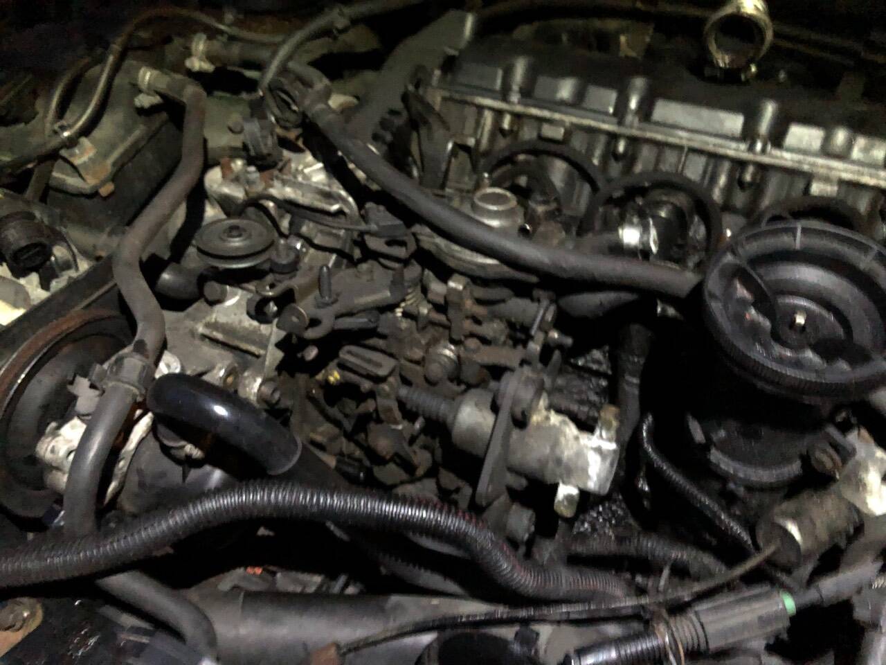

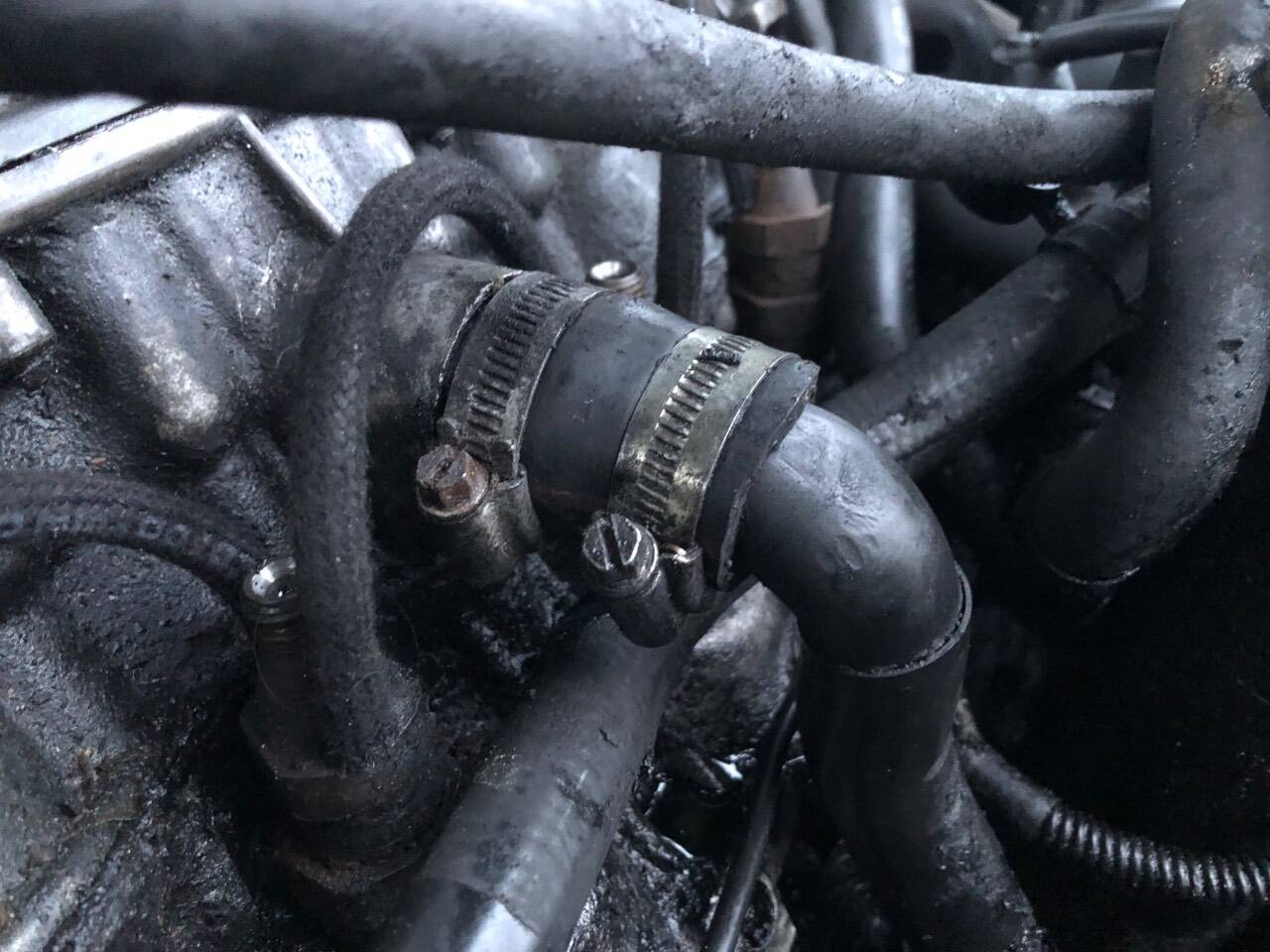

Rust Collector Posted April 18 Author Share Posted April 18 I managed to make a bit more time for tinkering this eve. Not many photos I’m afraid as I just wanted to crack on. First up was that breather hose. The part listings online had the specs for it as an 18mm id. I did not bother removing one and measuring the hose tail. I lived to regret this. It turns out the ends of the hose are a larger ID than the main body of it, so the 19mm oil hose I ordered didn’t fit. I don’t want to wait for Autodoc to deliver a proper hose, and all the spares on eBay etc. are also located in Europe. I had a scout around the garage and I discovered that my manual shite water pump that I keep handy in case of small floods has the perfect sized oil rated hose attached to it. Bodge time: It’s better than it was at least. The original pipe had cracked around about 75% of its circumference, and fell off in my hand. I’ve just cut it back to make it fit into a sleeve I cut from my hand pump. Job jobbed. Then after some fucking around, swearing and pulled back muscles, I managed to get the spare pump in place. Im really bloody hoping that woodruff key is located properly. It’s all gone into place so I’m hoping that the key is still there and hasn’t been mangled. Once it’s all back together I’ll leave the timing cover off temporarily and bar it over first. Im hoping to finish up tomorrow, all being well. mercedade, chodweaver, brownnova and 10 others 13 Link to comment Share on other sites More sharing options...
Rust Collector Posted April 19 Author Share Posted April 19 Before I finished off last night I spent a few minutes pumping furiously on the driveway. My thought process being that if I primed the fuel system before going to bed then when I woke up in the morning I would be able to check that everything was still hard. I gave it a few pumps and it still felt fairly rigid which is encouraging. Hopefully I’ll get this all wrapped up tonight and have her running. If I can get her starting reliably I will be well chuffed, as the laboured starting and not knowing if it would actually start was really spoiling what’s otherwise a pretty decent car (I hope). Provided she starts and runs ok then I’ll do the ABS sensor on the off side rear, give her a quick once over for any obvious faults, give her a wash and then get her in for a ticket. I’d quite like to try the nearby* ‘no pass no fee’ place, @grizz is this who you use? https://www.thetestcentre.co.uk Dyslexic Viking, grizz, Datsuncog and 5 others 8 Link to comment Share on other sites More sharing options...

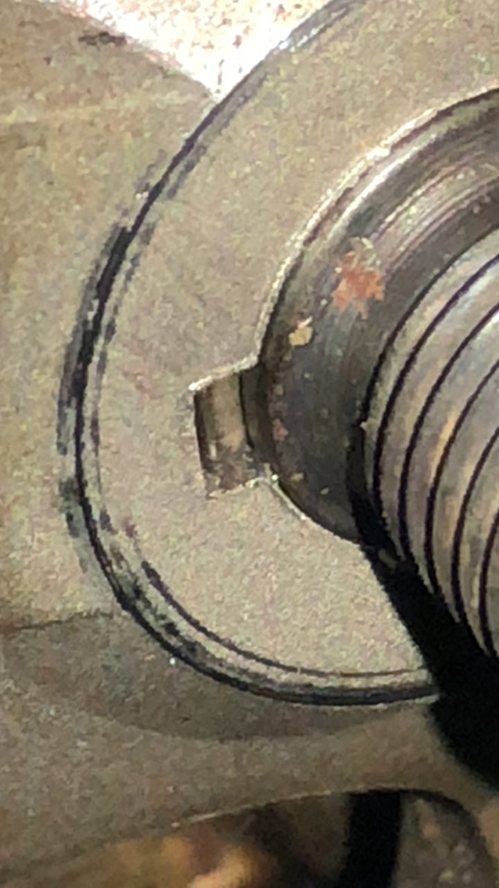

Rust Collector Posted April 19 Author Share Posted April 19 I got the last of the shite hooked up to the pump this evening: I think the kick down cable is a bit slack so I may tweak that, but otherwise I’m 97% certain everything is as it should be. I was still a bit unsure about the pump shaft and sprocket so I marked it (badly). Time to throw all the other junk on: The good news is that when turning the engine over, the sprocket and shaft stay aligned. The bad news is I’m a twat and I forgot to bleed the fuel lines. The engine won’t run on air, sadly. I’ve also managed to get diesel in my mouth again and everything tastes sour. Inlet manifold back off then. Cracked the injectors open, cranked it, one line primed and then the battery went flat. Probably for the best as it was getting late. Battery on charge and we will resume play tomorrow! Unfortunately it won’t be until later in the day though as I need to swap the carb on my mower and then go replace some lights for my parents. Bums. mercedade, Dave_Q, Tickman and 5 others 7 1 Link to comment Share on other sites More sharing options...

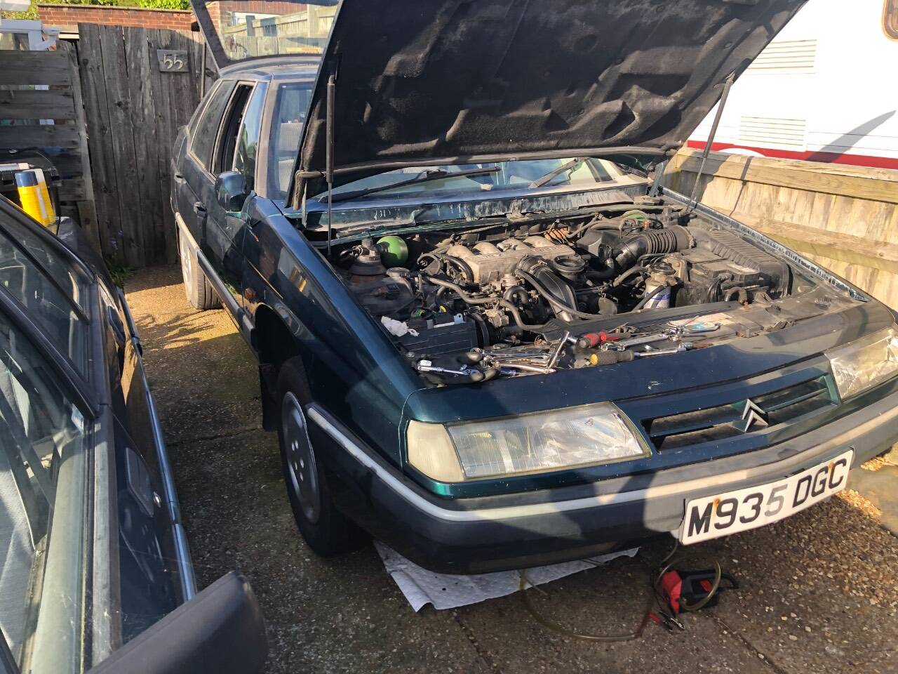

Rust Collector Posted April 20 Author Share Posted April 20 Weeeeeeeellllll… I bled the injectors this morning. I found using a power probe easiest as this meant I could watch the injectors whilst cranking. I then put it back together, started it, and… It runs away as soon as you turn it on, sits at 3k rpms, chucks out smoke, bogs down and dies. Ive spent some time checking the adjustments on the pump, and I’ve come to the conclusion that something inside the ‘new’ pump is seized. I think the best way forwards now is to just crack on and rebuild the original pump then use that. A bit of a disappointing end to the time I’ve put into it so far, but you don’t win them all. On the plus side, I did some other stuff today. I swapped out the carb and some service bits on my mower, and that works beautifully now: Every time I mow the lawn, I think how lucky we are to have such a nice outdoor space. Even if the dogs and our son do litter it with their toys. I also finally fixed the three broken taps in the house: You know you’ve been lax with sorting things when it feels like a luxury to now be able to turn any tap in the house and have it both work and not leak. Then I went to the shops to grab some gin, and on the way back the dusk sky over the sea caught my eye so I stopped in the Pontiac to enjoy it for a bit. Things like this remind me why I love living in this part of the country. So all in all not a bad day, even if the XM work didn’t pan out as expected. rob88h, Oi_Oi_Savaloy, mercedade and 9 others 10 2 Link to comment Share on other sites More sharing options...

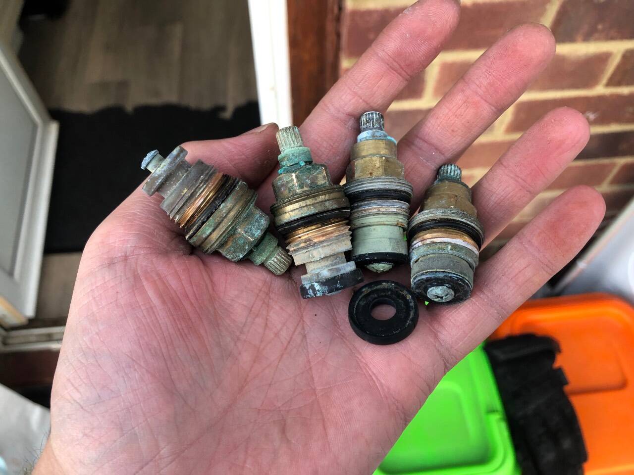

Oi_Oi_Savaloy Posted April 21 Share Posted April 21 The taps thing. It's a small thing (turning on, no leaking) but it's remarkable what all these small wins add up to. And love the fact you stopped and actually admired things - good to do that. Rust Collector 1 Link to comment Share on other sites More sharing options...

Rust Collector Posted May 5 Author Share Posted May 5 Goal for the bank holiday was to get the XM running properly again. Righto then, best crack on. I will update the related ask a shiter thread in due course, but to close off on the ‘marinade it in ATF, whack it with rubber mallets’ plan; this did not work sadly. Time to go topless then as I’m not taking the pump off again before the MOT. Hopefully. To recap, the fault was that the car would immediately rev up to about 3k rpm when started and my money was on the ring/collar that the fulcrum moves being stuck in the ‘wide open throttle’ position. Getting in wasn’t too tragic. Basically a case of remove bits that are blocking the four cover bolts. Then remove the cover. Give yourself 10 points if you can see the problem already. I had to do some poking and prodding to understand the issue. I pumped out the delicious pink juice and saved it to drink later. Here you can see the issue. The weights on the governor were stuck in place and the shaft presumably wasn’t moving out. This must have allowed the hot/cold idle spring to raise the revs too high. The weights freed up when moved by hand, as did the shaft. The surface rust isn’t ideal but it’s barely perceptible to touch so I’m hoping the surfaces in the pump aren’t too fucked. If you’re storing one of these I reckon it’s worth filling it with oil or something as they obviously don’t like being open to atmosphere. The one that came off the car originally is much cleaner inside. This is the old pump, and maybe this shows how the governor and fulcrum interact. From what I can see the throttle linkage, idle spring, boost compensator, fuelling screw, shut off lever and governor all act on the top half. The bottom half moves a sliding collar up and down the main shaft which controls the volume of fuel that can enter the metering head. Things that raise the revs pull the top of the fulcrum left, things that reduce the revs pull it to the right. The fulcrum has three sections that can move semi-independently allowing fine movement for idle control and then larger movement for fuelling and throttle control. All these things act in equilibrium at idle and the point at which all the forces balance sets the idle speed. It’s apparent the governor shaft plays a big role in this, which I hadn’t realised. Brain now throbbing after prolonged thinking, I put the pump back together. Let me just say, fuck the throttle linkage on these things. What a wanker to get back together. Anyway, it did go back in the end when I realised I had to move the fuelling screw out a bit. I must have taken this inlet manifold on and off about 10 or 15 times today in the course of making adjustments and realising bits I forgot. And this idler is a fucking bastard to refit. One of my 13mm spanners is still in a chassis leg somewhere beneath it (hopefully), but it finally went back on. We have something resembling a complete engine bay again: Moment of truth then… I honestly didn’t expect it to work. It doesn’t fire up as quickly as I’d like, but seeing as this pump was firing instantly at first I reckon I can dial it in to sort that. I tightened the belts and let it have a stretch After some Citroebics I took it for a drive around the block. The fuel pump behaved and that’s good enough for me. I need to chuck some coolant in, then tomorrow I’ll have a bash at the rear ABS sensor that needs sorting. After that, it’ll hopefully be MOT time. It then will need a new home, as I need a clear out! Lacquer Peel, Tickman, rob88h and 20 others 23 Link to comment Share on other sites More sharing options...
