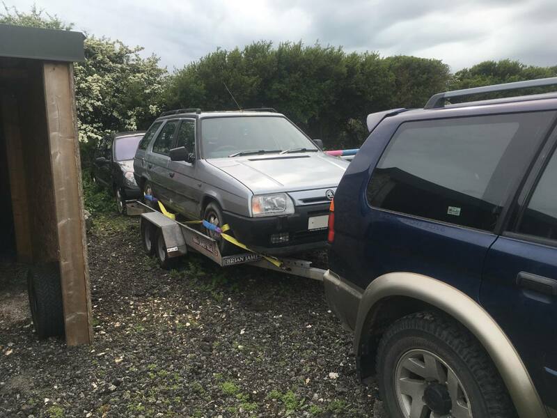

I did see those, but I think they came up slightly after my one - mine came from Salisbury, but I did find it through the Facebook page. I keep meaning to update my post keeping track of the work, but Facebook is a bit crap for chronicling projects so I keep putting it off...

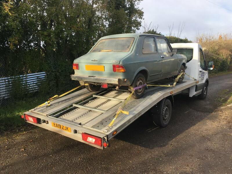

16 hours ago, Rust Collector said:
1988 Zastava 311 - A bit of a random one, but I've always wanted a Zastava just for the obscurity. This one came up in January, and had been sat in barns since 1996 apparently.  It didn't run when I got it, but I've slowly replaced pretty much everything in the engine bay, along with all the brake components and lines, and she runs now. Just the welding left to do, and she's ready for MOT. I have been fairly productive with this project, up until several cars within my family broke at the same time and I ended up working on those in my spare time instead of my toys. Only one family car left to fix and I'll be back on my projects again hopefully.
picture?
2 minutes ago, stuboy said:
what happened to that lot?
I don't know. the bloke who runs the Yugo Facebook group was looking to find people to take them on but I never heard what happened to them all

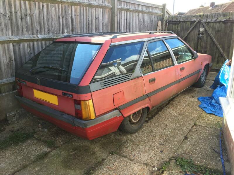

Back at the tail end of 2020 (my camera roll suggests October) a friend of mine who had a BX learned of a BX estate going for free. Knowing that I am a car hoarder, plus a lover of angles and long roofs, he put me in touch with the chap who was getting rid of it. The story was that he had owned many BX's, using them for his work as a welder. This particular one let him down one winter when the heater matrix let go, and combined with some of the holes opening up in the arches it was put to one side and left to come back to. This didn't happen, and after a couple of years of sitting he decided to let her go. The stars lined up, as I actually already had a truck booked to drop a car 10 miles down the road from the BX, and so I went down laden with a Legacy wagon and came back with the BX Break. Here she is being loaded onto the transporter, complete with action shot of my partner begrudgingly helping out with loading.
We enjoyed a short stop in Poole afterwards in order to appease my partner, and then barreled back to East Sussex in order to unload the BX and get the rental truck back. Having driven a few pikey Transit recovery trucks in the past, despite my disdain for modern vehicles I have to admit the new Transits are fantastic to drive.
'But wait!' you cry, 'did the car not settle on the bed as you drove?!'. Erm, well...
Luckily it doesn't seem to have damaged anything underneath significantly, but yeah I did notice later in the journey that the load on the back started to feel a bit weird. Probably should have stopped and raised it, but we were down to the wire on time and well, once it's done it's done anyway 😅
Back home and on the driveway, it was time to inspect what 2 years spent hiding in a hedge had resulted in;
It even came with free food!
Obligatory Lab inspection:
So there we have it, one very crusty BX sat on the driveway.

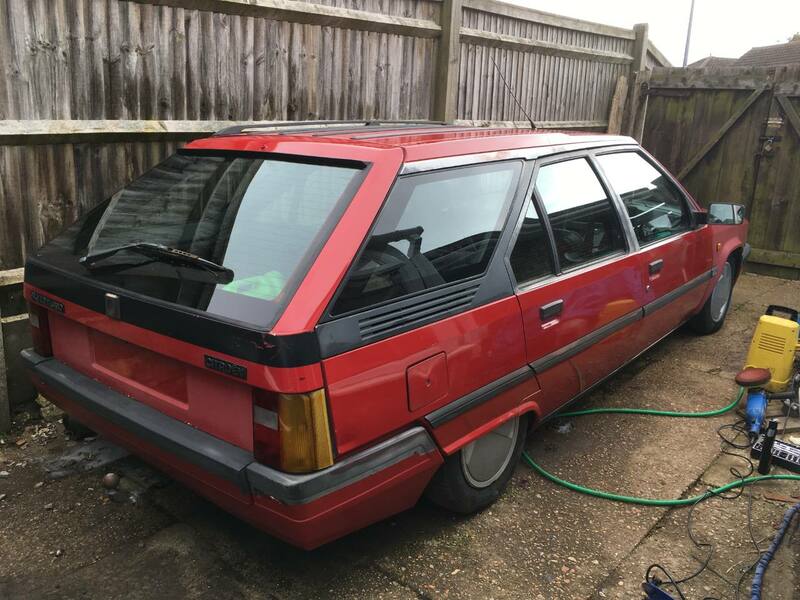

Right, subsequent work on the BX that has been done to avoid the more horrible jobs...
Bonnet liner clips flipped round to hold the parts of the liner that aren't ripped, and liner replaced
The chap who gave the car to me also left me a set of alloys in the boot, so of course the first thing I did was try to fit tyres on them to see what they looked like. They came off the steelies fine...
No photos of me fighting the alloys with my manual changer, but after much cursing and breaking things I realised they were metric and I didn't stand a hope on hell of stretching the 14's on with a manual machine. I've put that idea on the back burner now until I modify the machine a bit.

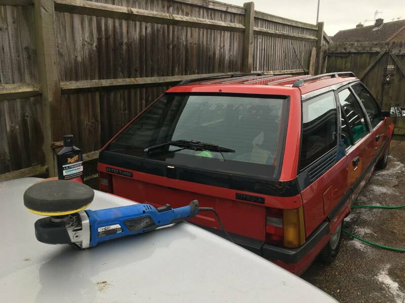

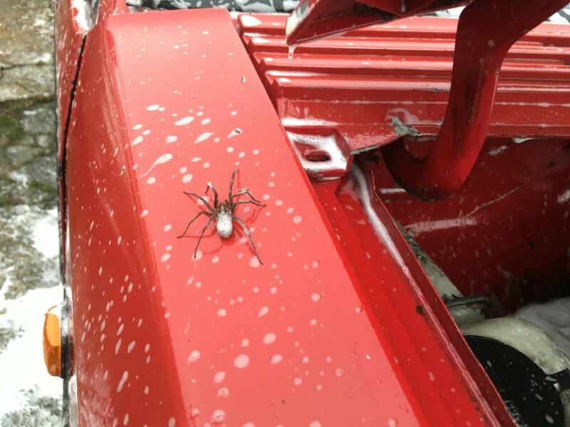

Next up was washing the car to get all the greenery off, it also drove the spiders out of the bodywork which for an arachnophobe such as myself was an absolutely horrifying experience. One bastard actually dropped down the front of my fleece when I opened the tailgate, which resulted in me doing the spider dance on the driveway whilst swearing at the top of my voice... Not much fun, but the neighbours don't seem to talk to me much anymore which is great. Skip ahead if you don't like spiders!
I blasted as much grease out of the engine bay as possible, as it normally makes life better later down the line when you're getting stuck in. I'm sure there's a good bit left in there mind...
And then the view from the utility room, doesn't she look great with a bit of water over the top of her. Best only drive it in the rain 😅

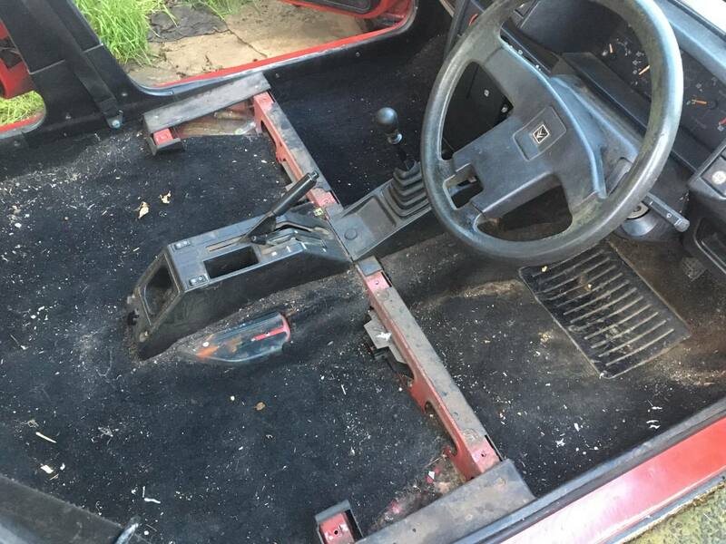

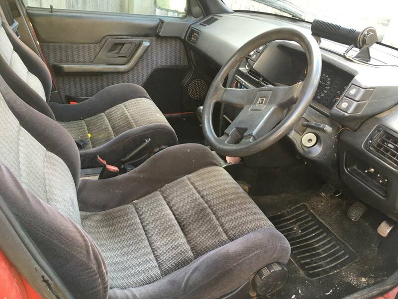

Next the interior came out for a bit to do some cleaning and hoover up more spiders
The bolts holding the back rests of the rear bench in are crap... they're made of cheese with an allen socket head, and the hole they're threaded into is exposed to the elements from underneath. I snapped a few of these in frustration, drilled some others, and had to come back a few weeks later with a fresh head to weld nuts on the studs and remove them.
I threw some new bolts in and it was much better. Shampooed the carpet and seats next, before throwing the back in;
The boot cards were feeling a bit sad so I glued them back together before more hoover and shampoo action
This needs welding a plate over and a rivnut to be fitted before I can put the boot back together, I need to clean the carpet too as it's still rolled into a tube in the garage, ensuring it will never lay flat again...

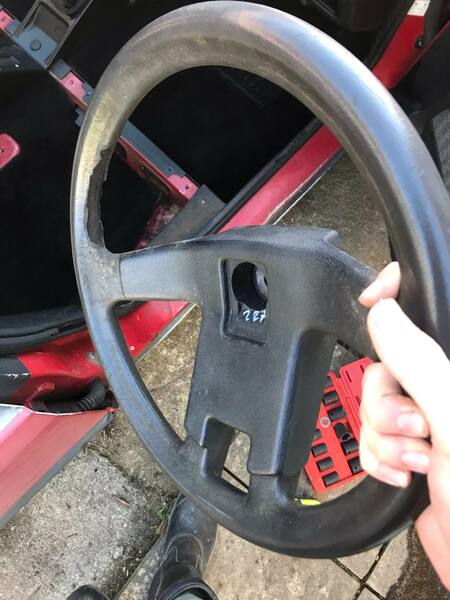

I got a cheap replacement 16v steering wheel off of eBay, so put that in to replace the somewhat chewed one that was in there. Cleaned up the console and some of the other plastics too.

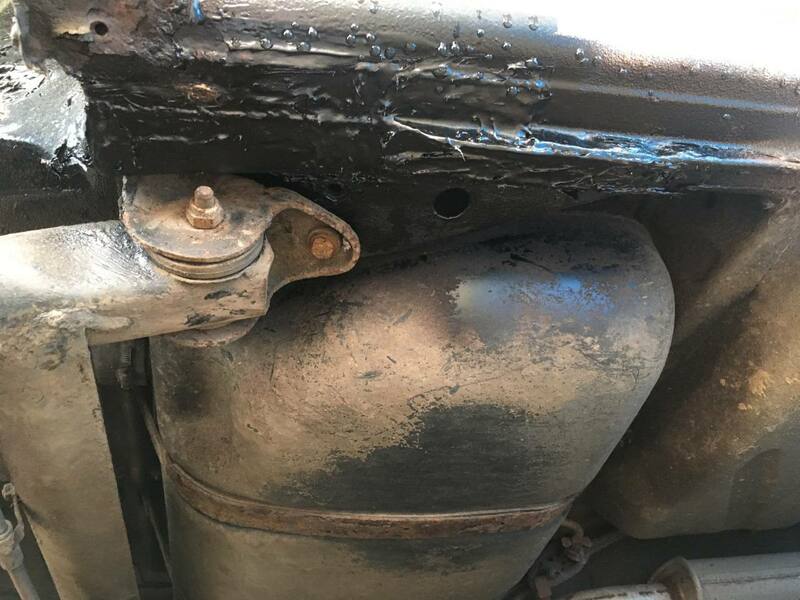

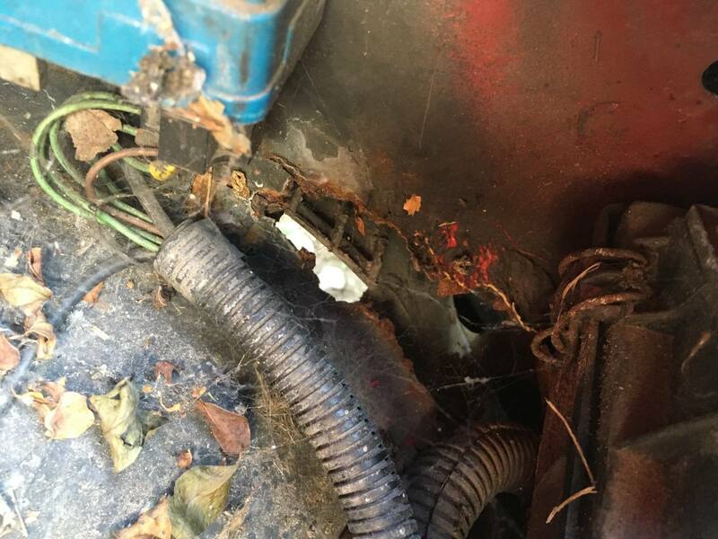

So, rust it is then;
I should think there's a very good chance I will be removing the rear beam and doing a fair amount of work at the back here.  The above pic is the chassis rail running under the boot, the right side of the photo is the front of the o/s/r wheel well. Below is a photo looking back from the rear axle towards the o/s/r corner of the boot floor. Sorry for the crap photo, but my phone is rubbish in the dark. Both sides are like this, along with the outer edges of the rear bumper beam.
When I had all the carpets out I didn't find anything bad in the actual floor pan, and the boot floor seems good too. Most of the stuff that has rotted out is flat and square in shape which is handy, so I'm not too concerned about the fabrication of replacement sections, but I can't say I'm looking forward to removing the rear beam... I can imagine the hydropneumatic kit makes that a ball ache of a job.
Up front, both strut mounts need attention, along with the seam along the inner wing. There's a gaping hole at the back of the n/s/f wheel well also, and seeing as the plates where the check straps mount to the A pillars is flexing and crunching like mad as you move the doors I suspect I will be removing the dashboard to rectify the holes in the front properly. My o/s B pillar has a hole too, but I'll just patch that - she's not destined to be concourse, I just want functional and clean enough that the neighbours don't get scared. A recap of the shitty parts up front
There's more holes, but I gave up photographing them in the end 😅

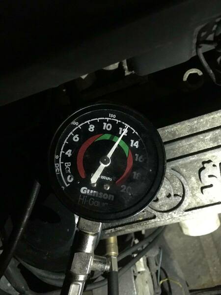

Whilst looking through my photos to write up the progress on the head gasket, I realised I forgot a small episode in the recent history of the Favorit...
I was on a short run seeing how the lowered suspension impacted the ride, and the car cut out on me. I could get it to start again, but if I pressed the throttle then the rev counter would drop to zero, and shortly after the engine would struggle and cut out. After a bit of a chat with a mate who had experienced and resolved similar issues on his Favorit, we decided that the crank sensor was probably suspect.
Lo and behold, my 'it'll be alright' application of RTV on the thermostat housing when I replaced the thermostat (and realised the thermostat didn't come with a gasket...) was not alright, and the sensor was having a bath. I wouldn't have thought a bit of liquid could cock it up that bad, so it may be coincidence and it's just at end of life anyway, but either way it's not right.
Part number for reference:
The original part isn't available, so you have to detach part of the wiring loom to reach the shorter Felica sensor that you can still source and use

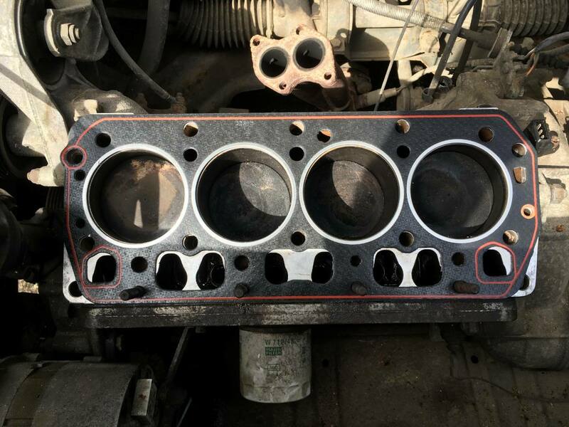

I left it to marinade for a bit, then brought it down to the hard standing where surgery is normally performed. Photo for the benefit of letting you see my merc and my brother's Celica.
Better do some work then

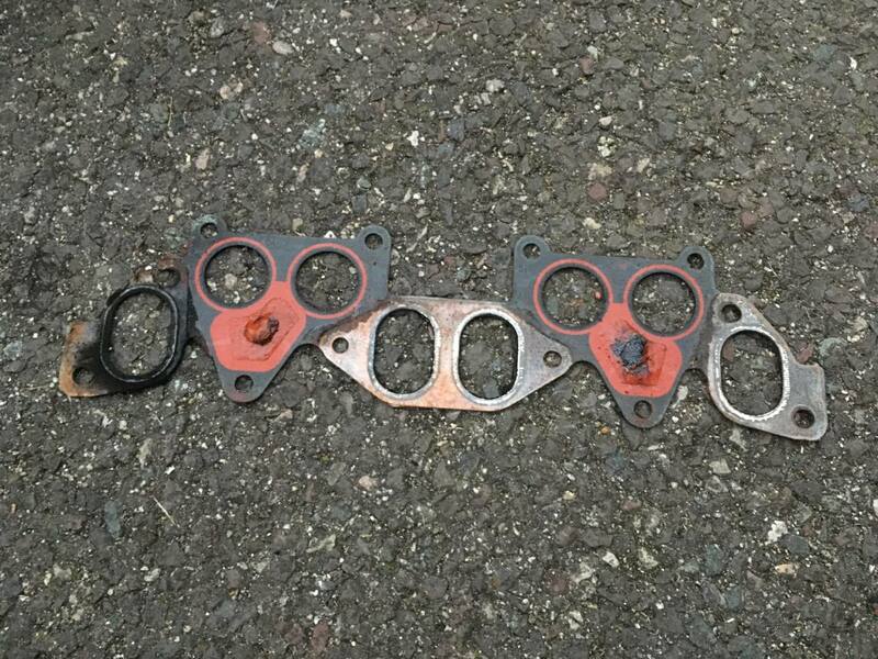

Found my engine bay exhaust leak...
Push rods for dummies...

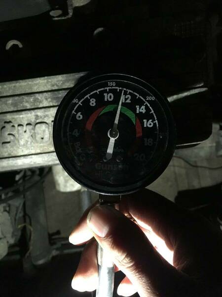

Head off, not too bad not too great... Was expecting a more drastic failure
Cleaned the block up
Then cleaned the tops of the wet liners, got the disappointer out and measured the liner heights. I reckon they're all ok, they seem to measure about 0.08-0.10mm each.
Gave the head a quick clean to inspect it, there's some very mild pitting in 2 places but it should skim out and still be within the service limit. It's with the machine shop now, should get it back in a week or so as they've just been forced out of their unit and their kit is spread over a few sites now. Other places further afield could do it further, but I'd rather use a local chap and also I like to work as slowly as possible anyway 😅
More on the Skoda once I get the head back and put her back together. Hopefully it all goes ok, but it's obviously playing on my mind as just this morning I was woken up by a dream where I was driving the Skoda home from work after repairing it and the temp gauge was fluctuating wildly 😆

A trip in a recovery truck to Salisbury later, and here she was waiting for me - barn fresh!
Loading up was no drama, although all 4 brakes were in the boot so I did stop and check my straps a mile down the road just to make sure she wasn't going anywhere!
Once home I had a poke and a prod around to see what I was dealing with, lots of photos taken at this point
The brakes are in here apparently!
Luckily the vehicle has already been quality checked, so presumably I don't need to check anything...
Spiders and mouse food galore. As previously mentioned, I cannot stand spiders!

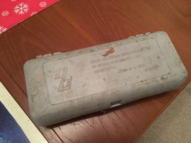

All the tools you should ever need to repair a Zastava

From inspecting the car, from memory the basic priorities were get it cleaned up, get it started, install the brakes, service it and try for an MOT. This is a gross oversimplification of course 😆

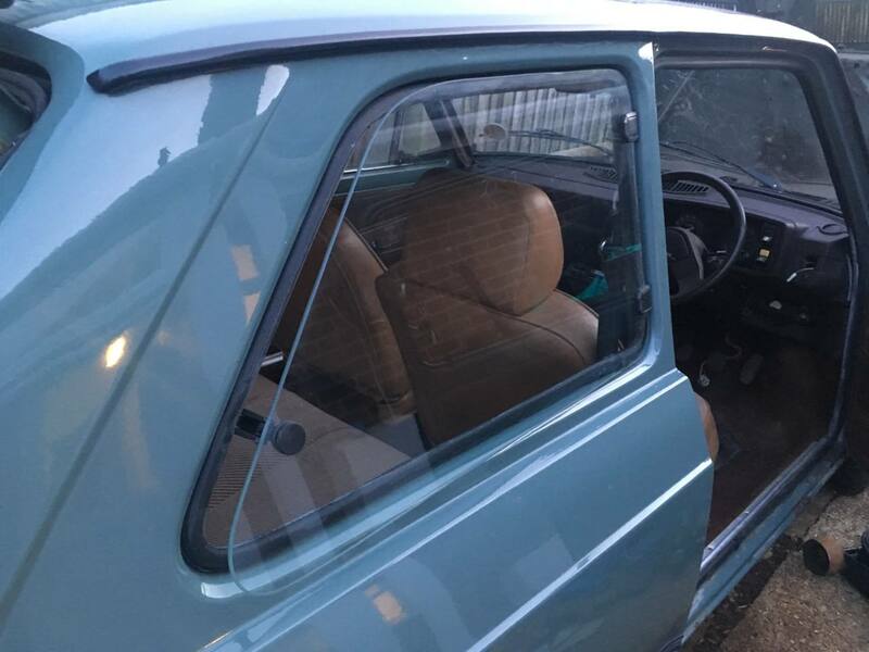

First job on the Zastava was to clean the mould and spiders out so that I could work in there without constantly being worried about getting touched by a spider or mould.
Carpets weren't too bad (in relative terms, not accounting for style or good taste), if you ignore the mouse skeleton
RIP mouse. The car will be much cleaner now you're gone.
A shampoo of the fabrics on the seats and carpets should bring it all up nicely, however it was cold damp weather at the time of the first clean so it wasn't practical to bust out the Bissell back then. I keep meaning to dab some vinyl cleaner on the sides and rears too! I can't find any decent pictures taken during daylight, but I also went over all the hard surfaces with some APC and a microfiber clothe, before dressing it with 303 Aerospace - I bought some after watching a valeter on youtube rave about it, and it's actually pretty decent stuff. It's brought up the plastics in the 311 and BX brilliantly, without making them greasy or too shiny.
On to the outside, it was time to get the rotary paint fucker out again. Disclaimer, I have no idea what I'm doing with one of these, so view at your own discretion. I've got some in progress shots just because I personally find it satisfying seeing the oxidation getting cut back!
A little bit of glass cleaner on the clear bits (I love pop out windows, not sure why 😁)
All done to the best of my limited ability:
And then how about a grille for a final touch?
Much better!!

Well I've been busy procrastinating instead of posting progress. In an effort to avoid remembering/writing up Zastava work, here's a quick return back to the present.
I took a week off work so that I could crack on with a couple of bits, namely finishing the head gasket on the Favorit and finally putting the engine back in the SLK320. The cylinder head had returned from the machine shop and was still well within the service limit which was good. Here we see the mating face of the head whilst it's on the bench in the clean room 😅
Whilst the head was off I replaced the valve stem seals using the appropriate tools...
I don't have a parts washer, so I fixed that by purchasing a secondhand dishwasher for £20. I had to temporarily put it on the driveway by the hose/kitchen drain as there's no suitable points to hook it up elsewhere, it really adds to the decor along with the 2 spare engines, alloy wheels, unfinished project cars.... Luckily the section of driveway I work on is inside of a courtyard area between my front garden and rear garden and I have privacy gates and fence all the way around so that the neighbours aren't able to see anything that might upset them 😅 I did put the dishwasher away neatly in the garage afterwards in order to appease my other half though.
For anyone who needs to know, the thread for a garden tap hose adapter is the same as the thread for an appliance hose...
New head gasket offered up, not the best template used at manufacture imo but the holes were where they needed to be and although you may be surprised by this after seeing the clean room and all the specialist tools at our disposal, we aren't quite working to F1 engineering tolerances 😅 So I thought about trying to get a better gasket, imagined that it would be difficult to find one locally that I could inspect first, and pressed on with the one I had.
I then bolted everything back in. Couldn't find my angle gauge for the life of me, so the final 2 stages on the head bolts were done with a calibrated marker pen and laser guided eyeball. When I picked up the service manual for the valve clearances, I discovered that although I put them back in the order they came out the engine, somebody working on the car prior to me had muddled them up. Some of the Favorit engines have a mix of steel and ally push rods, and in these engines it's important that the right rods are put in the right place due to the thermal expansion characteristics of the different metals. Mine had the ally ones on the exhaust valves which was wrong, the exhaust valves should only ever use steel rods whereas the inlet valves can have either a steel rod or ally rod and there is a different tolerance depending on the material.
And finally all back together again. I had some new coolant hoses that I bought a while back so they went in as well. I gave the engine bay a quick wash as it was pretty dirty, excuse the monstrosity that is the remains of my bonnet liner...
She started and ran, so she was rewarded with a bath.
After a bit of gentle local testing, her first real challenge was to deliver us to the beach on Sunday. Despite living by the beach, we decided to go for a run to Camber. We left early to beat the traffic... which still ended up with us queuing for an hour and a half in sweltering heat!!
I think we can say the job was a success though, as this was the hottest it got!!
So we can file this one in the 'fixed' pile for now. In the near future I will need to do a bit of repair work to the roof (there is a hole where the antenna mounts, which the last owner filled with what feels like polyfilla) and I reckon some new top mounts and spring seats wouldn't be a bad idea as I've got some clunks here an there when turning the wheels at low speed.
