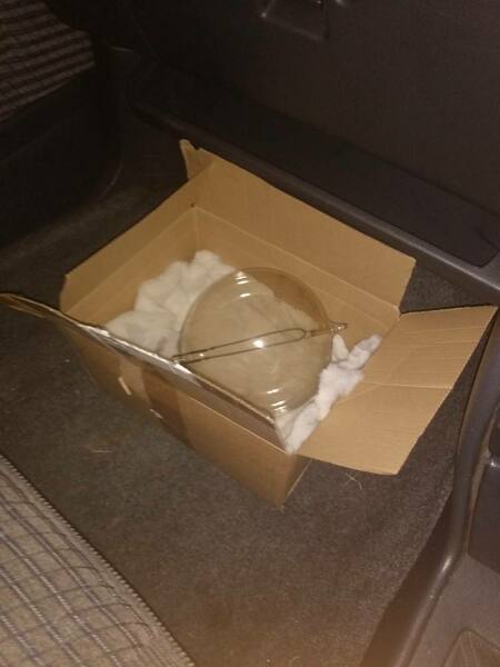

I know what they say about 2CVs, ploughed fields, and eggs; but what about Carinas, Dorset, and one of @LightBulbFun 's lightbulbs?
They've ploughed Dorset now? Must get myself a Carina 2CV edition.
