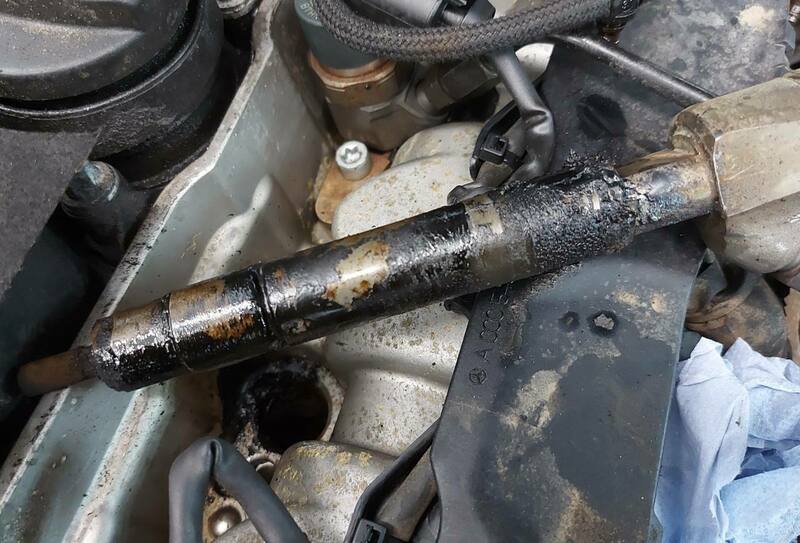

Leaky injector seal on cylinder No.2 fixed, the rest will have to wait as the rear suspension decided to go Cheech and Chong low rider today.
Had it on the ramp and snooped all the joints I could see and I suspect the right air spring as the left is following by equalisation.
Mot Saturday morning so I will lay it up until then and pull the system apart. At 178k I suspect wear and tear so nothing to loose looking.

So thats what the stink of diesel was!!
Yes, I should have investigated a bit deeper last year as I had a couple of whiffs of diesel on occasion but decided to wait until the service was done as there were no visible leaks and nothing untoward when I did the fuel filter. Mot tomorrow morning, I am currently investigating  the self leveling rear suspension with a view to ripping it apart tomorrow.

Mot passed this morning, whatever is leaking now goes down quite quickly as it dropped sat on the Mot ramp. I have a repair kit on order for the pump so I will start there and work my way through the connections and assorted gubbins.

 Does the 5 cylinder suffer with the injector seals problem?
It does, and so does the four cylinder version. I've done quite a few now in various cars
