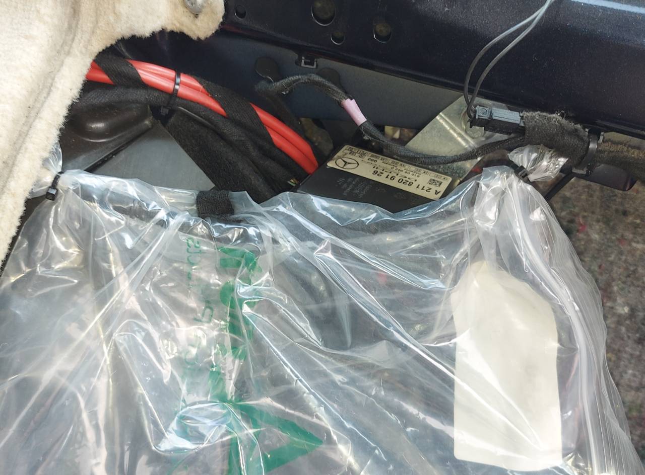

A bit of soldering was order of the day swapping the ATA tilt sensor black box over as the original has suffered being sprayed with washer fluid from the bidet hose joint popping.(Added the anti-bidet-joint-spray colostomy bag for peace of mind.)

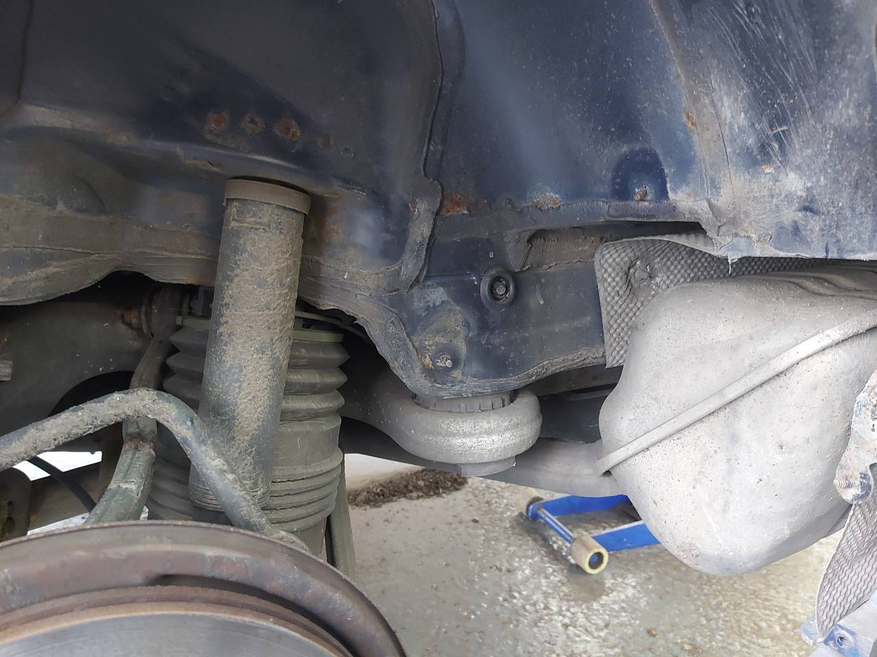

Late evening out of the heat I removed the rear dampers off the old car to transfer over.  I did plan to do this on Sunday with the rear air springs and front dampers to transfer over at work on Monday and recheck the tracking.  The heat sapped my enthusiasm!

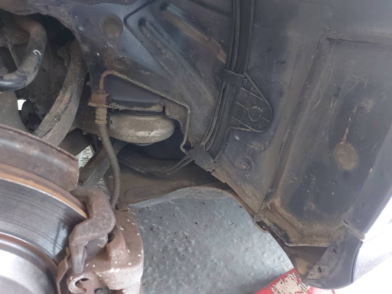

Did the same last night with the front suspension, a little easier as no special tools or interior requires removal. Loaded up and intended to fit the next day if the weather cooler. Walked out this morning and for the first time in a month on the road the rear end was sitting low so I now need to rape the old car for the Arnott air springs I fitted, I'm not taking all that trim out twice to remove the dampers. I'm in work Saturday with the apprentice and he has a set of Bilstein dampers on order for his W211 so if they turn up, Saturday afternoon may be a Bilstein party.

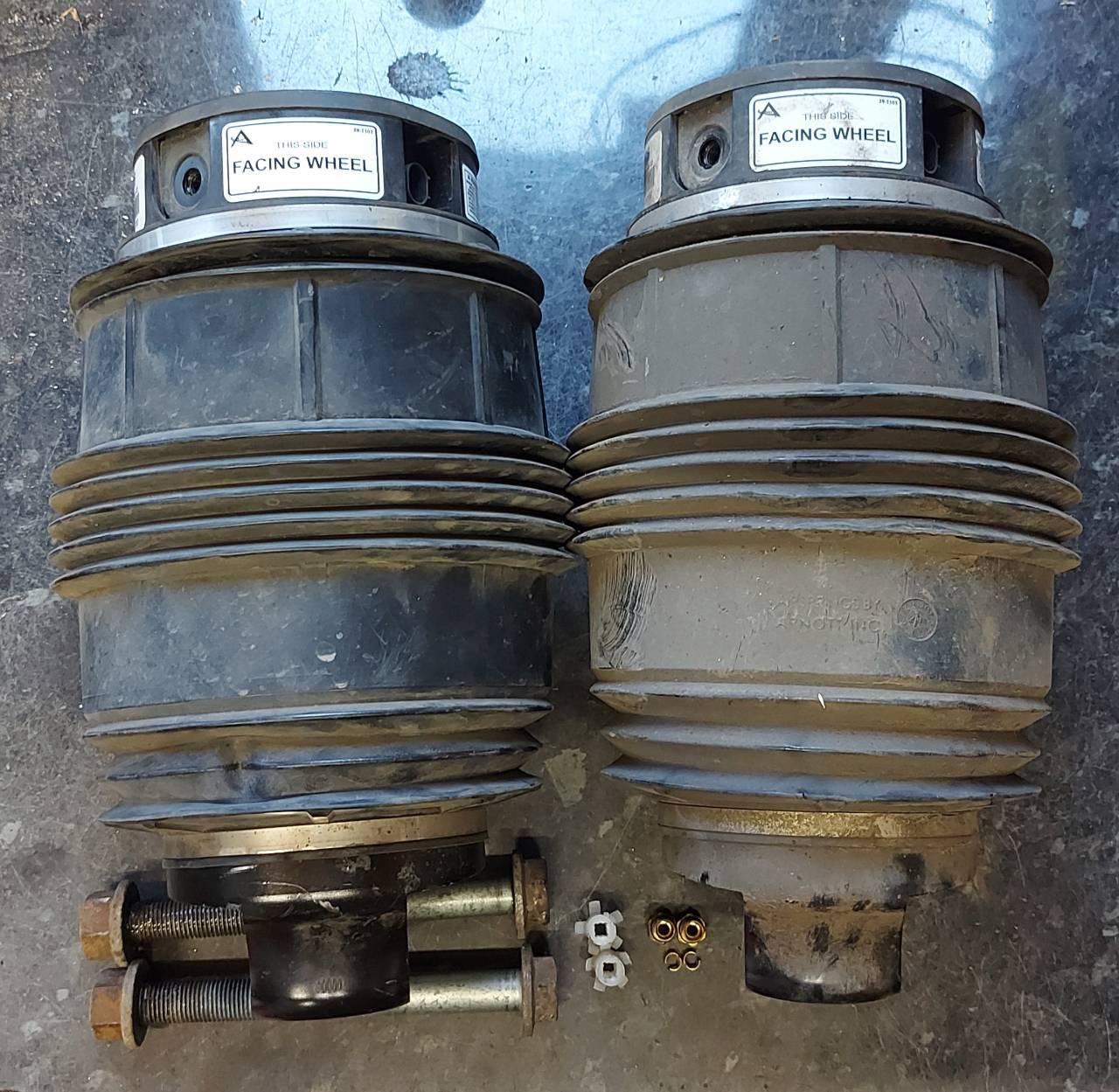

I removed the Arnott air springs from the old S211 and managed to save the barbed clips along with the hose fittings to reuse. Also took the additional Stebel "Nautilus Truck" horn and wiring off, all boxed up and in the car with the old dampers and springs.
I'm now on the hunt for a large box of enthusiasm to fit them as I used the last box on helping the apprentice fit 4 Bilstein dampers to his W211 on Saturday. Couldn't face working on my car after that and a diff swap on the bosses race Mustang.
I removed the outer bellows off one of the air springs once removed as it was not sitting parallel. Connected back up to the cars power I was able to manipulate the bladder back to shape. Nice to find out the bladders are made by Continental.
Front dampers and springs swapped over this evening, sitting better now. The compressor doesn't sound great so I will harvest the one out of the other car this evening.
