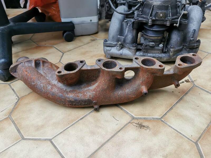

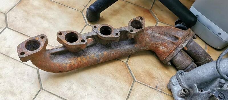

I'm quite curious to get some set rpm samples from the W123.  Unlike the van where the exhaust just sort of did whatever it did, the system on this has clearly been more more thought out.
Manifold has cylinders 1/4 and 2/3 paired, and they don't merge into a single pipe until a good three or four feet along the system.
Thought I had a photo of the spare manifold off the car, but apparently not.
This car has a VERY pronounced difference in the exhaust note depending where in the rev band you are.  It's very muted at the bottom end but has a really hard edged growl to it that comes in just under 4000 rpm, so I suspect there are some very distinct resonance effects going on there.

Just made a point of snapping a couple of photos of the spare manifold.
It's actually in the first exhaust box that the two separate branches merge.
The downpipes themselves are missing in this image.
