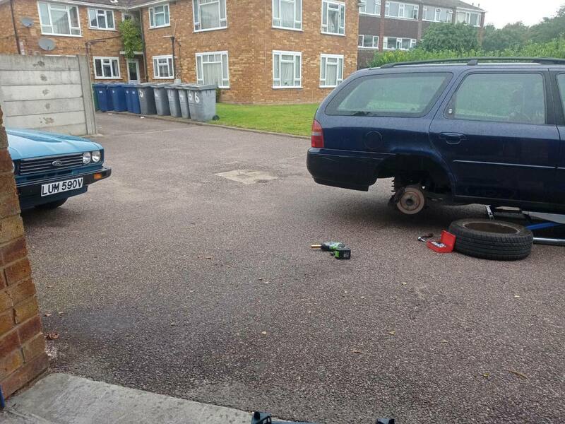

Discs and pads on the rear of the Mondeo today. There's something cathartic about fitting shiny new parts. Left the other side for tomorrow, I know otherwise I'd have rushed and messed something up being tired/hangry etc.
As in my other thread, the N/S caliper bracket wasn't for coming off... this infernal bolt, a torx head inset into a section, grr!
Persuasive techniques had to be deployed.
I've ordered a new caliper carrier from a seller on ebay which I hope is the right one - it looks it - but we shall see, cheap enough and should be here Monday. In the meantime, I've taken advantage of enforced layup to replace the bolts on the towbar (I put it on with M10s as the original M12s were a bit knackered, new M12s on now). I should really wire it up too - it shouldn't be too difficult, I don't think there's any need for extra relays etc, although I've read that it's advisable to add a buzzer to the indicators. May be a solder-athon ahead then! I still have no specific need to tow anything, just a silly desire to have it there In Case It Ever Comes In Handy.

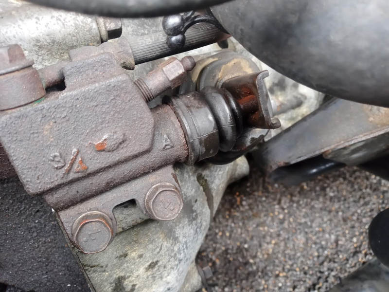

Back at home I thought I'd move the Bluebird somewhere more convenient. Uh-oh, clutch pedal drops right to the floor, and it's in possibly the worst parking spot. I wonder what's going on. Oh, we seem to have no hydraulic fluid... ah, the slave cylinder is buggered.
I found both a rebuild kit and a whole new unit for sale online, so bought both, as you do. Will probably stick the new one on, then rebuild the old one at my leisure*. Hopefully I can shove the car round the corner to a slightly less awkward place to work on it.
37 minutes ago, N19 said:
..... Tetraboost I have never tried, primarily because they only seem to sell it in huge cartons....
You can get individual cans from Demon Tweeks. About £37 for 945ml.
On disassembly, it looks like the clutch fork isn't returning properly either. Spring? Whether that would have caused the slave cylinder to go I don't know, but odd that it should happen at home parked up.

The new slave cylinder turned up today. The attachments are for a later bluebird - mine has a banjo style connection. Nevertheless, it provided a replacement for the perished seal which was the killer. Assembled, bled, perfect.

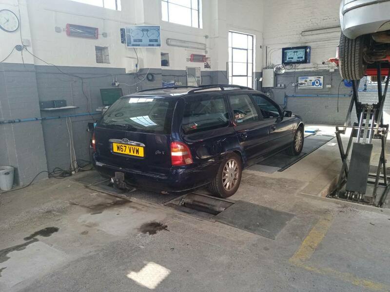

The terrifying moment :-
Phew. Emissions ok, handbrake could be better but passed fine. Advisory on corrosion to sills, and some brake hoses which are being done anyway. In the meantime, the air con compressor has been fitted... Just not charged as the garages machine is on the blink. Hopefully will have nice chilled air just in time for winter.
The rad is starting to collapse from underneath by the looks of it. New ones listed at 45 quid so not too bad and may be worth it.
5k miles in the year, although in fairness it hasn't done any long long trips in the last MOT year.

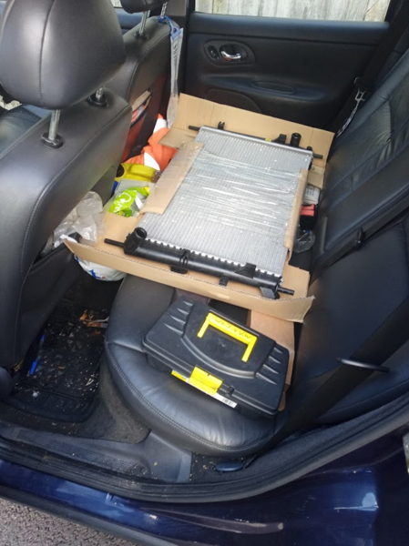

Radiator excitement.
See, I'm my own worst enemy. The radiator could wait a bit, for sure the original one in there is falling apart, but me being me I'm suddenly up for replacing it in the next couple of days despite being busy with work. Looks reasonably simple if cramped, drain coolant, remove electric fan, tie a/c condenser out the way, drop rad, clean up, offer up new rad, reattach everything and refill. Going to pick up the tools and bits required from the lockup tomorrow and do it before work on Friday.
This is one thing where the lack of parking down at the lockup is a ballache. The Mondeo doesn't fit inside the lockup, which is also the Capri's insurance storage place anyway. I can't get started on any job down there on another car unless I'm 110% sure it'll be finished in one visit, any delay for parts etc leaves me a bit snookered. So jobs like that end up being done at the back of my flats, but that then means I don't have all my tools etc to hand.
  • N19 changed the title to N19's fleet - radiating excitement
Lower hose clip is a pain to get off. Hate those bloody things. I've ordered up one of those contraptions which has the grips on the end of a bauden cable. Meanwhile, fan off and half coolant drained...
