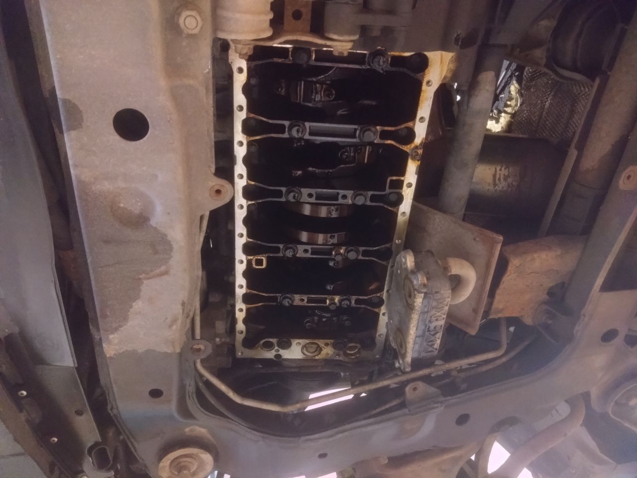

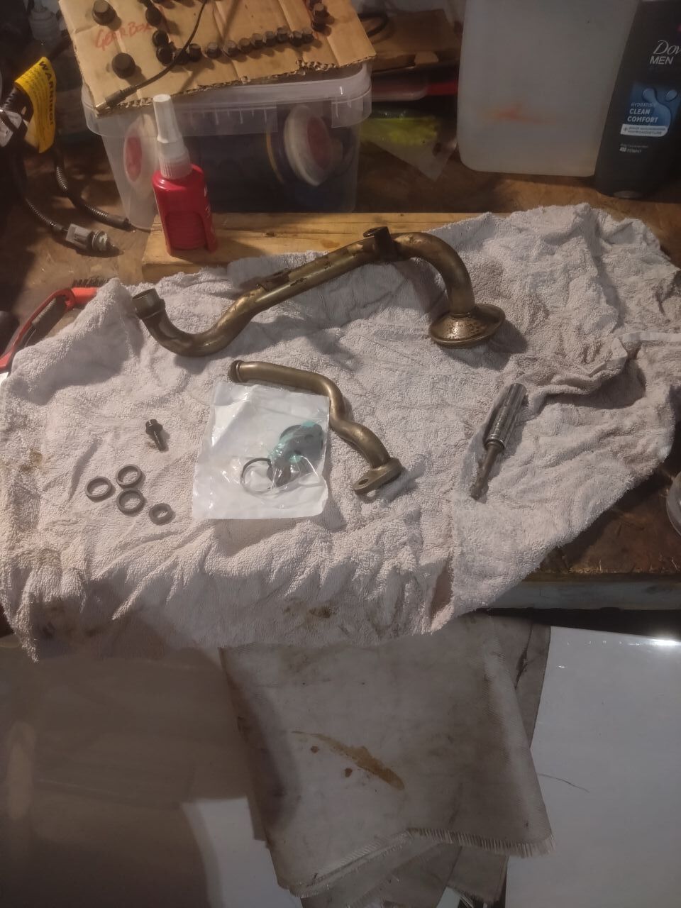

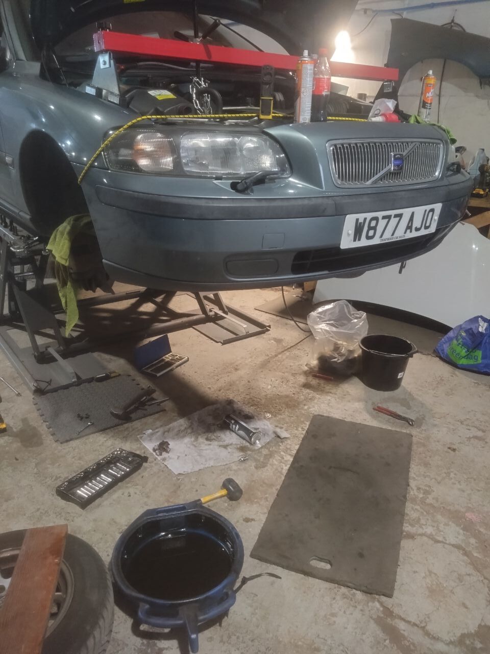

Dropped the sump off the V70 to clean any gunk out. Like the Saabs, these suffer with a blocked pick up pipe from lack of oil changes. I think the o-rings can go bad inside the sump as well?
My thinking was it can't hurt to do the job anyway. As I don't have the time to be starting all over again with another car.
Anything removable has been pulled off and cleaned. The sump itself needs another cleaning session. Think I'll have it ready to put back by next weekend. Was slowed down a touch as stupid me hurt my knee.

Dropped the sump off the V70. My reasoning being i'd rather do this job than start all over again with another car because the engine shat it. I think the o-rings can go bad inside the sump as well?
Not stuck for a car. As I got the Toyota back on the road. Which takes a little stress off.
How bad a job was getting the sump off?
Not terribly bad at all.
One engine mount and some power steering pipes are in the road. Nowt bad.
Oh and I popped the bolts I took out into some cardboard in sequence of how I took them out.
It does get caught on the pick up pipe. But some swear words and wiggling, it does eventually see sense and come out.
I think the refit will be an equally awkward barsteward to do.

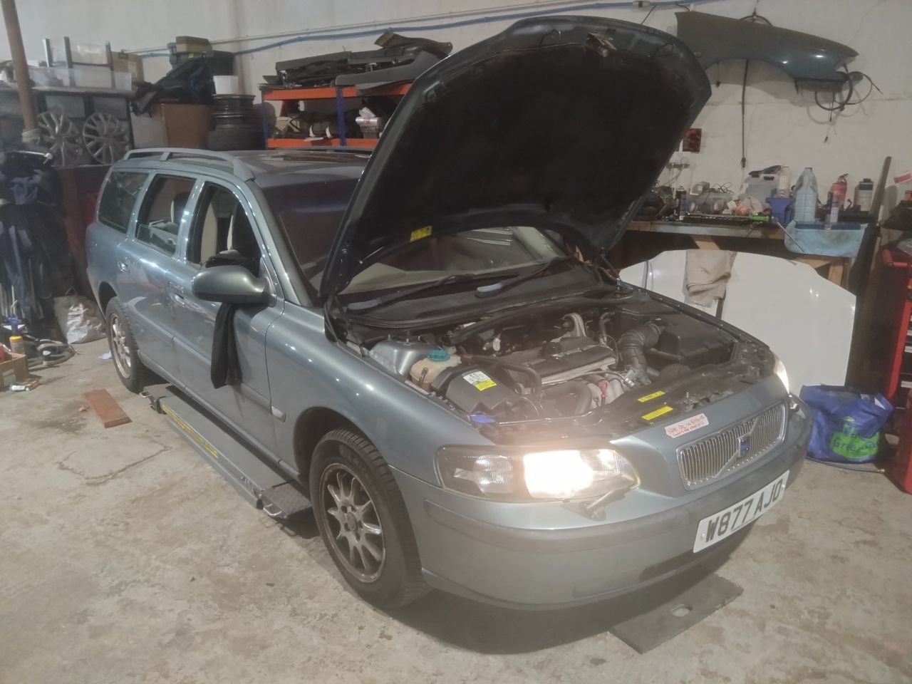

Back at it with the V70.
Sump got a good clean out and resealed. Refitting the sump was more fiddly than difficult. Whacked in a cheap oil filter and some leftover oil I had sat to act as a flush. Probably imagining it, but the car seemed to run smoother after all this work.
Left the car to run to be sure there was no leaks caused by me.

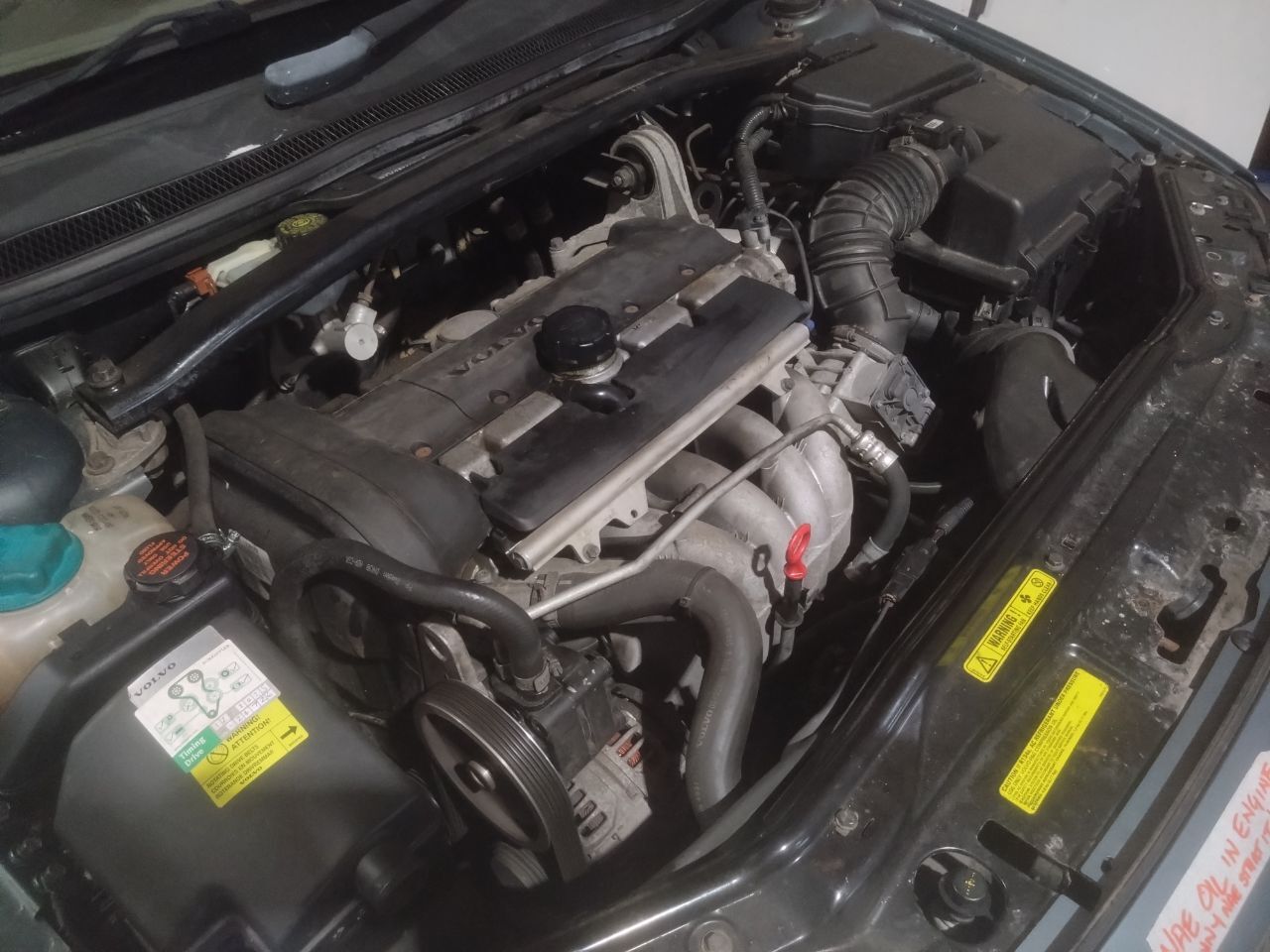

Nipped another job up. Car was leaking it's power steering oil. Another common problem. The reservoir was split around the seam and weeping out oil.
New bottle fitted. As CHF isn't cheap per litre and knowing me I'd let the level go down too far it'll end up buggering the pump and/or steering rack.
Just to run it for a few miles. Then change the oil again. Even bought a GENUINE Volvo filter and I might even get some big name brand oil too! Spoiling it much!? 🤣

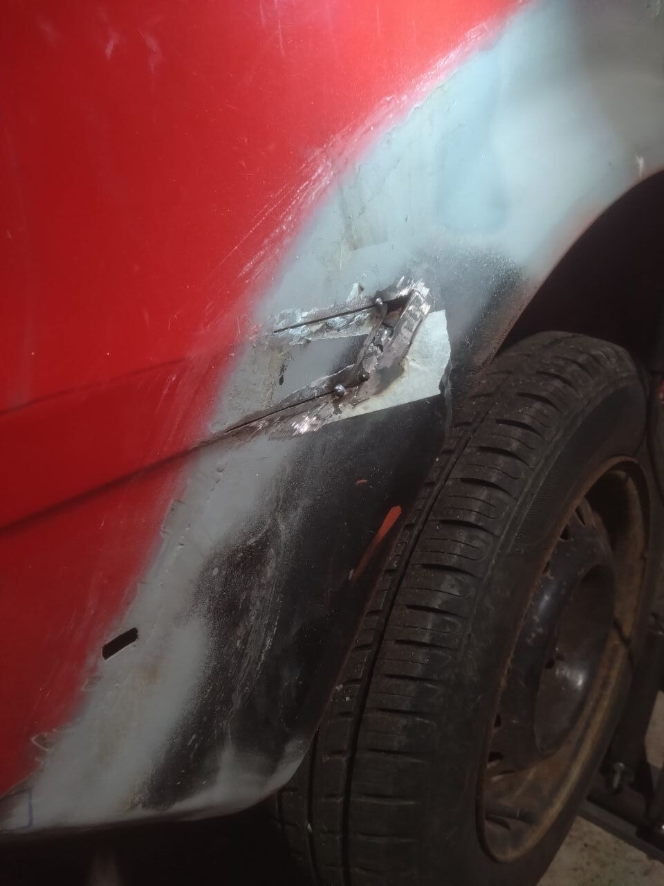

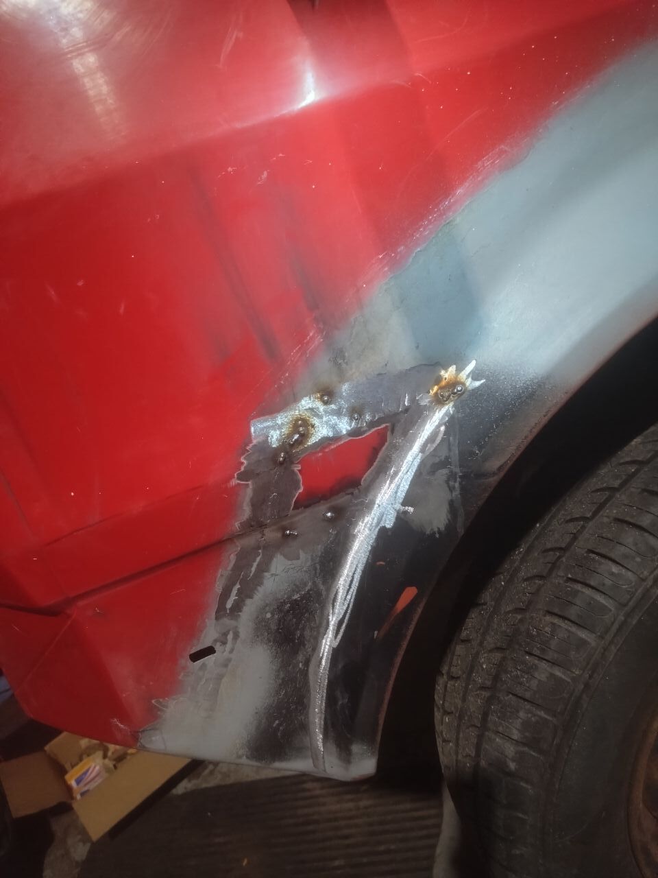

Maestro gets it's time back in the ramp.
Finicky metalwork jobs.
The swage lines here on the back half of the rear wheel arch wasn't great. Due to a not so great pressing of the new arch. Well frankly it was shite! But ya work with what ya got and make do.
Tried to reshape it and flatten the panel back a touch.
This was kinda successful. Well....
It wasn't actually. I made it look worse after welding it.
Plan B.
Find that section I cut off when I replaced the panel ages ago. Chopped my shitty effort out and welded that in.
This is how I should of done it. Looks less shit.
The filler is gonna be putting the work in to smooth this off!
Still some fettling to carry out, like pin holes missed bits and that. It's forward progress now.
Plan B.
