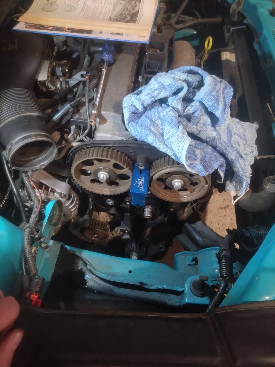

Today's job.
Cambelt replacement.
Strip down was quite quick. As my aux belt only drives the alternator. No removal of engine mounts or any shite in my road.
That's a surprising amount of room. It was more than the donor car had without half the hassle too.
This is the second belt I've done on this engine. I only did at a push 5k on this after the first one I fitted. So replacing it could be seen as a waste, except I did this four years ago. Long enough to want to at least have a nose at the belt and pullies.
That's when I noticed the bearings were leaking grease. Maybe not a big issue. But I wanted to play it safe.
The kit was less than £40 too. Cheap enough to just replace the lot. Water pump was fine, so left it. I replaced it on the last belt job anyway.
Span the engine over a few times, then reset the belt tensioner as per the HBOL. Started and ran with no issues.
Oil change tomorrow and some fannying about with making bumpers and arch trims fit better.

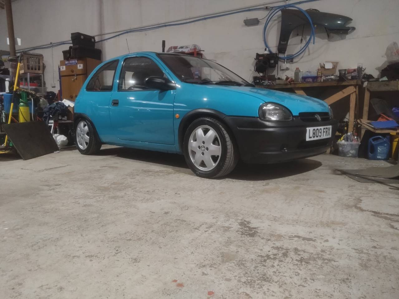

Friend suggested about heading out for a drive and some photo taking.
Need to put miles on this anyway.
Car drove mint. Bar the temp gauge would sit at just over mid way. Strange. Should sit bang in the middle. Ach no loss of power or any other issues.
Stopped the car when I got back. Started up again, misfire when you blip the throttle. Fudge! That'll be an new issue to fix. Fuel pump is noticeably noisy too. So that'll not help either.
Still have time, just hope it's plenty of time before my trip down south to have it fixed.

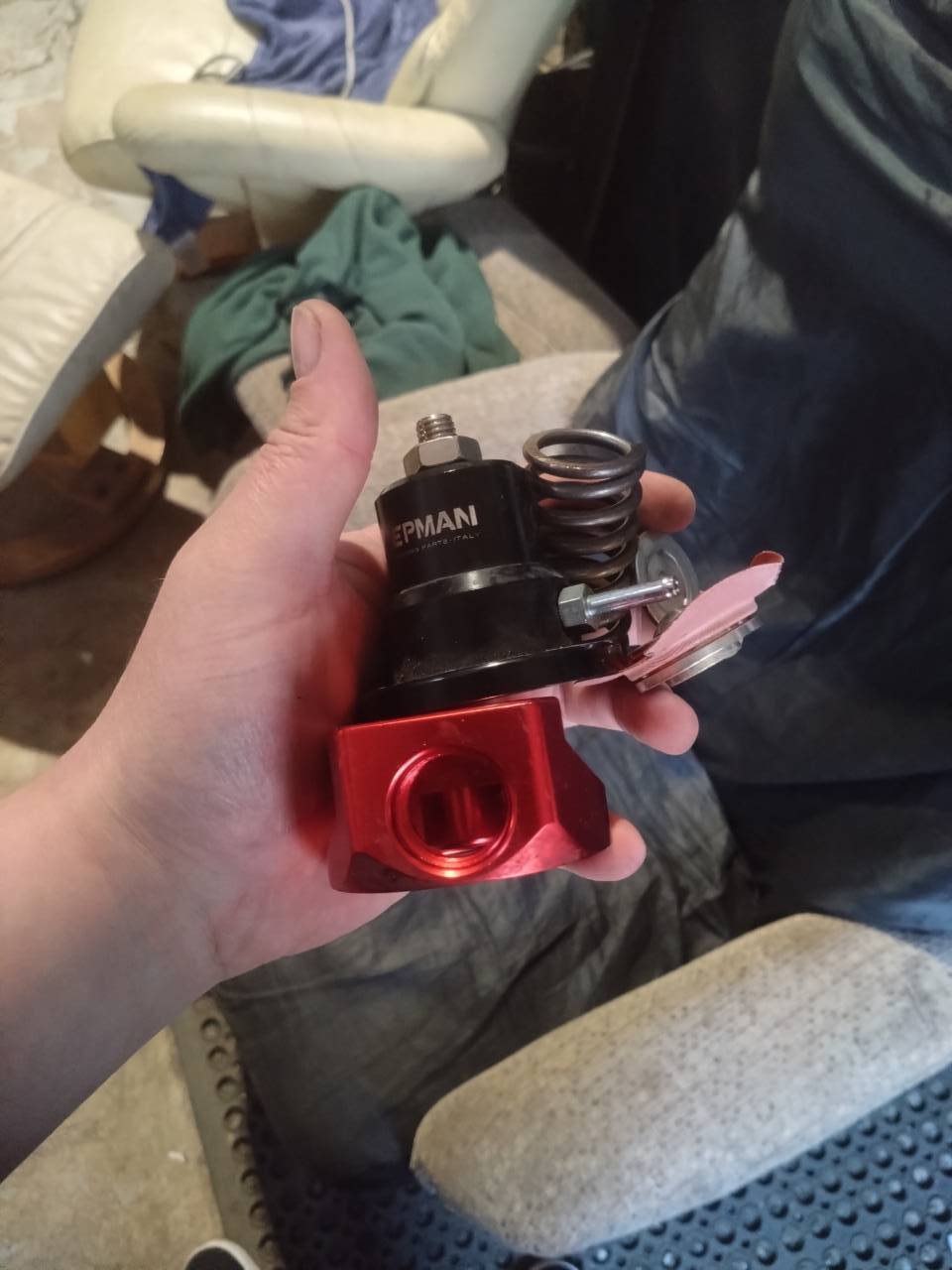

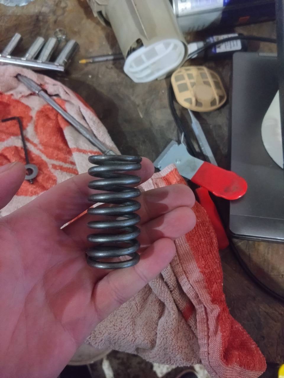

Dug more into this weird fuel pump and running issue.
Swapped pumps for the one from my Spares Corsa. I used the exact same pump set up as the the spares car. Long story short, it's up to the job. No worries there.
Still the same weird noise out of mine. Spares car is silent as before.
Time to pull the fuel reg apart. It's an EFi bypass one to over come the deadhead system the 1800 uses. Fuel can return to the tank.
It's not bad for an eBay special. But not fantastic either.
Then I found what spring they fitted in it. Well it nearly fucked the top of the reg off down the workshop!
That's some spring there! No wonder I couldn't adjust it at all. The screw was doing nothing. Too heavy of a spring and far too long.
No expert. But I wonder if the pump was surging due to the fact it couldn't bleed off the excess via the return?
Threw the thing in the bin and have another name brand reg coming.

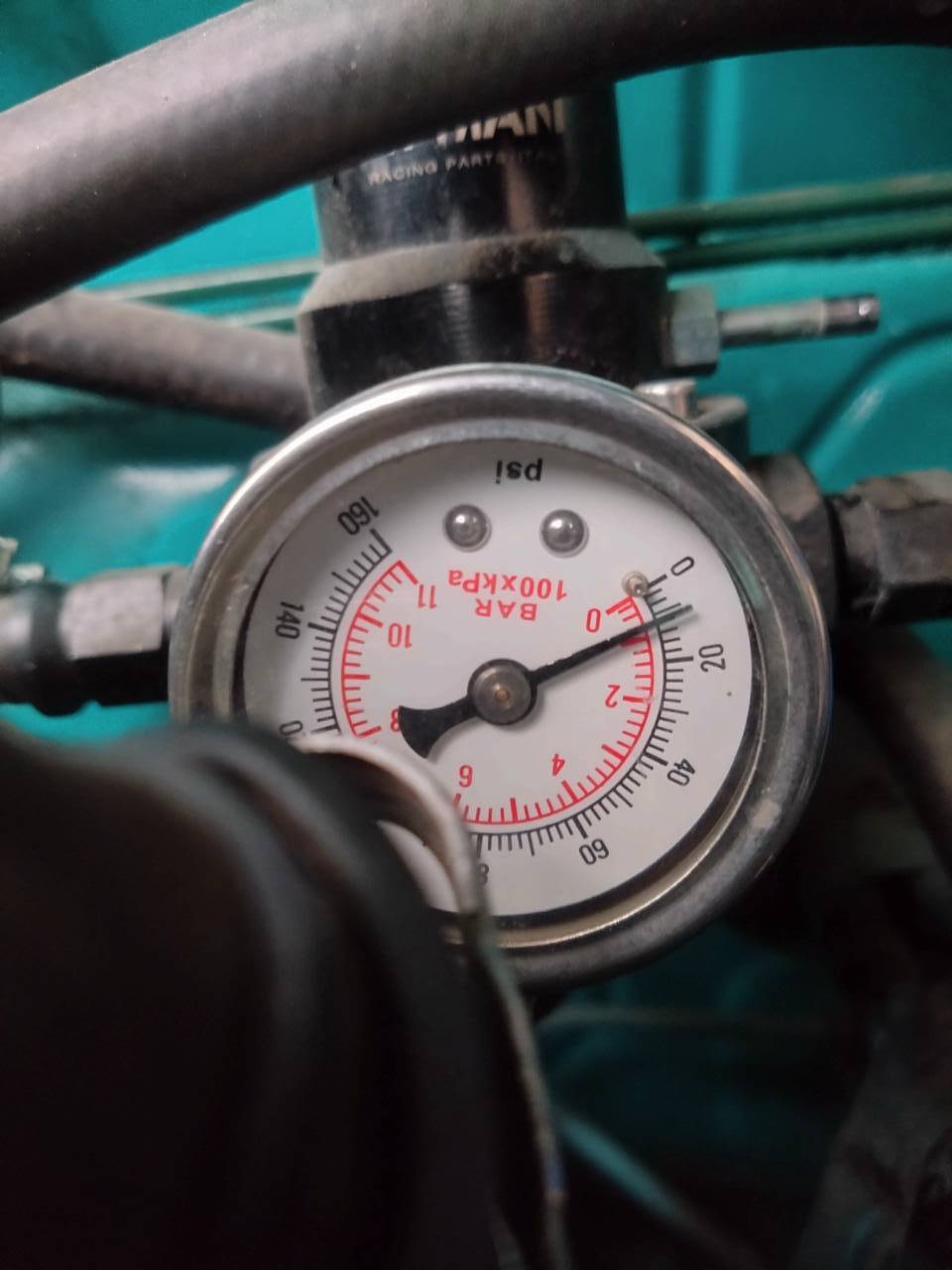

Had the new fuel regulator delivered to me.
An AEM brand one. Night and day difference in the quality. The pressure spring inside was nowhere near the same size as the valve spring they used in the last one.
Both regs use -6 AN fittings (finer machined JIC hydraulic fittings), made the swap over easy without the need to change the fuel lines. Picture shows how the reg is plumbed in for a deadhead system. So this serves as my return to tank too.
I'll need to knock up a bracket for mounting this to the car. Nothing fancy required.
For testing purposes. I plumbed it up set the pressure to the stock pressure of 3.8 bar. Started it up and it's running at idle quite happy. The racket from the fuel pump has gone. Really glad it's worked to solve a few issues at once.
Did have one major issue. It's an American brand, so it's all imperial hardware. Had to borrow some imperial Allen keys to set the pressure screw 😆. Have bought a set now.

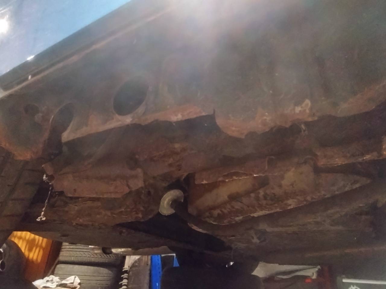

Now the Corsa is mostly done. I wanted to look towards another car I have
This is my Astra Saloon. Have owned this car for 11 years. I plan to start working on it soon.
It's been off the road for nine years, because of this.
Surprisingly that's the worst bit I've found (so far).
I have a combination of genuine and aftermarket new old stock with some good second hand panels to repair this.
I'm not going to mess about with the sills. Both will be replaced with genuine ones. Inner sill is another genuine panel.
It's gonna be an interesting project for sure.

One was the exhaust. Yes I've posted this picture twice already. But I was chuffed I managed to do this.
Not sure why. But the back box had been messed with. The tail pipe had been cut short for some stupid reason and a crappy chrome tailpipe bolted on! The box hanger was a bodged mess too.  Made a new tailpipe and found a hanger to weld back on.
Strong plan of getting another MOT on it and then sell it. I'm not using it now, no point hanging on it.

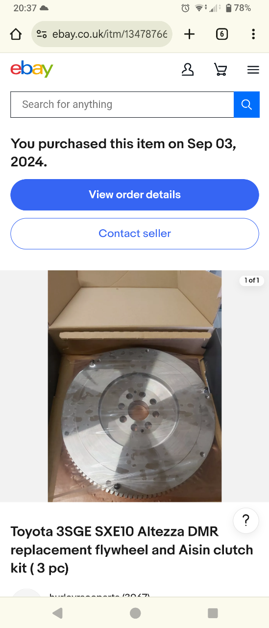

The Altezza threw up an issue. Well an ignored issue that can't be ignored any longer.
The clutch release bearing isnae too happy now.
New clutch time before something more expensive buggers up. It would be an ideal time to upgrade something else while I'm in there.
The dual mass is getting replaced. This is an known mod for these 5th Gen BEAMS enjins. Even TRD offered a solid flywheel for the RS200 cars. It's also roughly half the weight of the standard unit too.
Was going to buy some fancy pants JAAAAYYDEEEEMMM clutch kit. But it was going to be savage money by the time I paid all the fees and taxes.
Hurley race engineering in the UK who specialise in the BEAMS engine sell this set up. Flywheel is made by TTV so it'll be a decent unit.
Next update here hopefully will be me making an utter balls of installing these parts.
