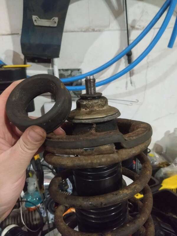

Been dicking about with the top mounts on the Maestro.
I'd like to put this here as someone may find this useful info for theirs.
Later MK3 Golf ones DO NOT fit. Even after sanding the utter crap out of it. So gave up on that idea.
The 6N Polo ones that came with the car also don't fit without modification. Plus the top caps just sit on top. So they don't clamp down to hold the top of the shock and the top of the struts move about when the car is jacked up. No bueno pal.

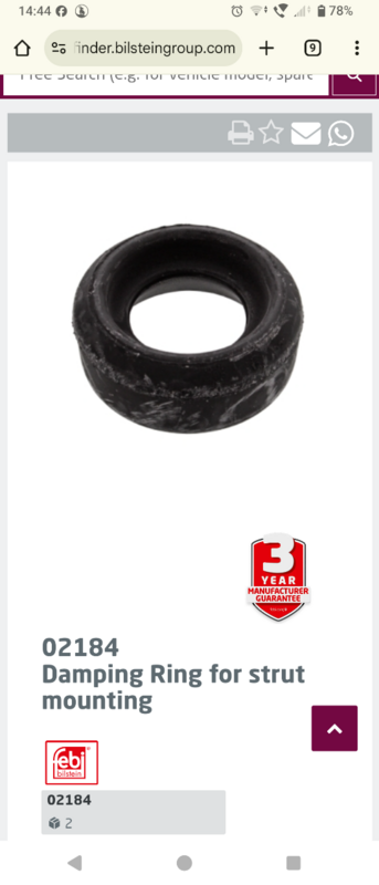

Looking at MK2 Polo ones. They look damn close to fitting according to the Febi Bilstein catalogue.
Yes the joke is bolting VAG parts on. Yet again. That's the only choice now.
This is starting to annoy me. As I have other projects I desperately want to get cracked on with. So I will finish this, as it annoys me more I'm being beaten by something daft.
I have a winner.
A pal messaged me to say he found a VW top mount donut thingy.
That and an M14 washer. The donut fits perfectly into the strut tower.
Gone from this gap when it's on the floor with 6N top mounts.
To this.
Just need to buy two and that's it done. Nice!
No probs.
These can be bought for about £7 each. It was superceded to this mount which will also work if you ditch that plate with the bearing in it. This mount has the bearing and plate all as one. About £12 for those off eBay.

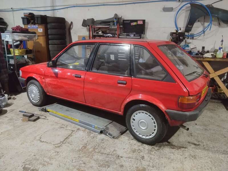

Ach. The car is now sorted and working. Took it to work yesterday for a run.
Pretty happy with the ride height now, looks level.
