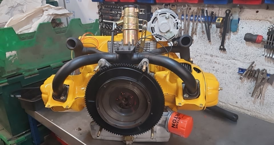

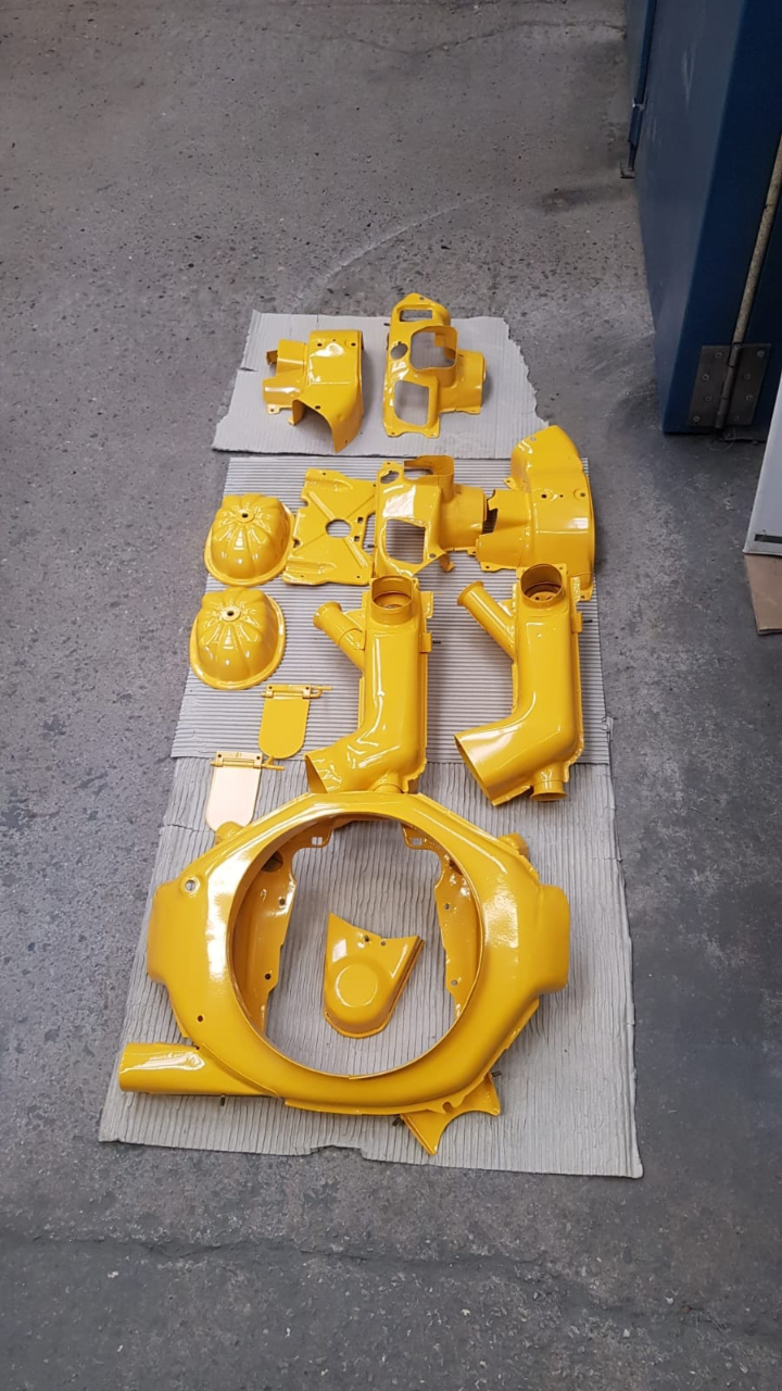

chaseracer Posted July 3, 2021 Author Posted July 3, 2021 IT'S OFFICIAL: the 720 is in-build at Sparrow Central! The Visa Solex is in a bucket of petrol and the new tinware is off to the powder-coaters this week. Tickman, loserone, brownnova and 4 others 6 1
St.Jude Posted July 3, 2021 Posted July 3, 2021 1 minute ago, chaseracer said: IT'S OFFICIAL: the 720 is in-build at Sparrow Central! The Visa Solex is in a bucket of petrol and the new tinware is off to the powder-coaters this week. Surely the petrol is meant to go in the carb? Not the carb in the petrol? LightBulbFun 1
chaseracer Posted July 3, 2021 Author Posted July 3, 2021 I thought the fuel consumption was a bit heavy... 😁 Deep cleaning, pre-vapour blasting. When it arrived, it was complete/all good but proper clagged up. No more. Stanky, St.Jude, CaptainBoom and 1 other 3 1

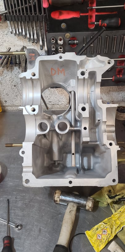

chaseracer Posted July 16, 2021 Author Posted July 16, 2021 CGSB, Floatylight, Coprolalia and 15 others 18

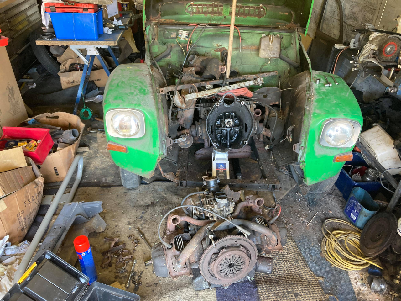

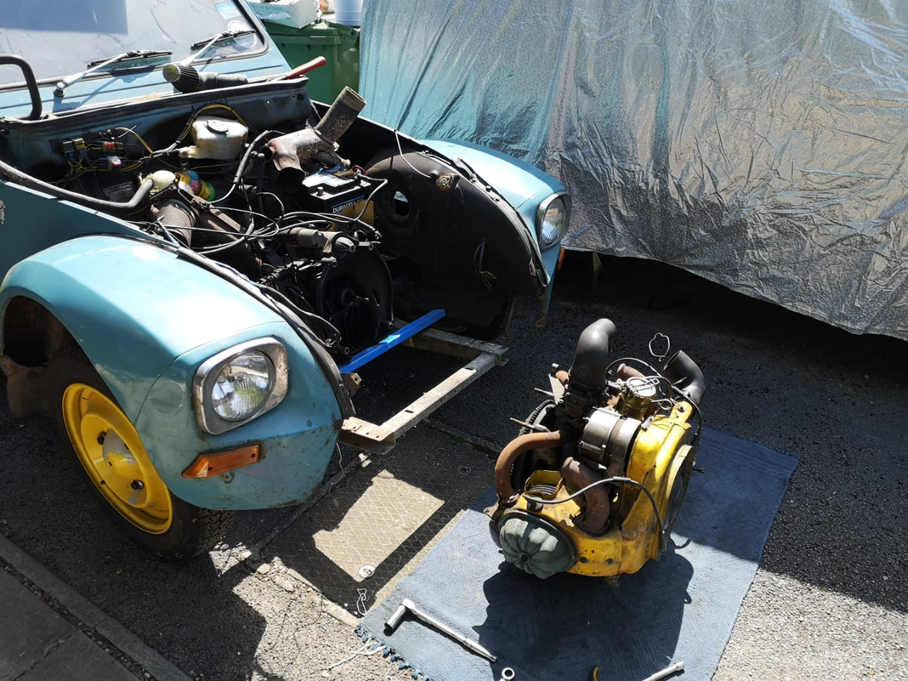

chaseracer Posted July 18, 2021 Author Posted July 18, 2021 In other local Dyane news, Laurence is a glutton for punishment, it seems! This moved under its own power yesterday, for the first time in 20+ years. The engine came out of the original racer circa 1995, and was used in at least one 24-hour race; it will have a check/light rebuild then go back in. EDIT: Further prodding has revealed a considerable amount of bran flakes where large areas of the chassis used to be. I think we've found our winter project... LightBulbFun, richardmorris, Dyslexic Viking and 3 others 6
richardmorris Posted July 18, 2021 Posted July 18, 2021 Is it a dyane engine then? Remind us oh mighty one the exact compression differences!

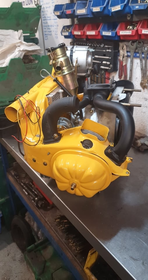

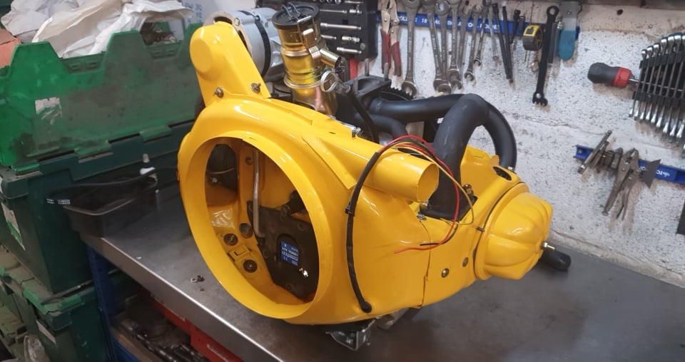

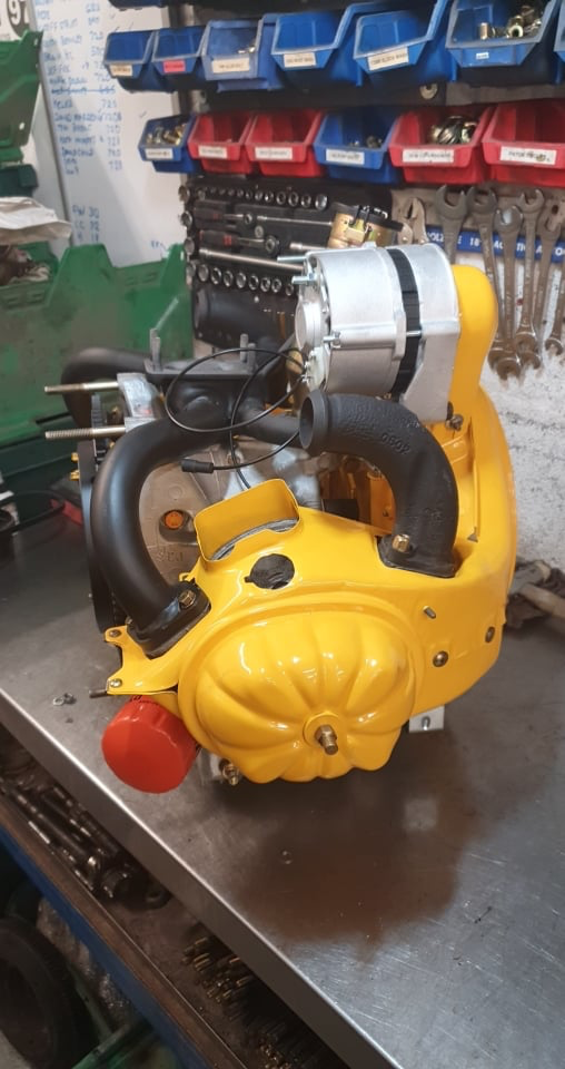

chaseracer Posted July 18, 2021 Author Posted July 18, 2021 Yes - 9:1 pistons for racing, so Dyane motors were always favourite before the right parts became more easily available to rebuild a 2CV engine to the higher spec. 2CV 602 - CR=8.5:1 (29bhp) Dyane/Ami8 602 - CR=9:1, with assisted induction from the fan via the tube on the top of the shroud (33/35bhp, depending what you're reading) Sparrow 720 - block machined to accept larger steel barrels, so CR may be slightly higher; 48bhp running the standard twin-choke carb and cone filter, will be a few more with assisted induction through the Visa 652 Solex. We'll know more when it's been tested on the rolling road. richardmorris, Six-cylinder, mat_the_cat and 3 others 6
wuvvum Posted July 18, 2021 Posted July 18, 2021 Never knew the Dyane engine was supercharged... chaseracer 1
dollywobbler Posted July 19, 2021 Posted July 19, 2021 7 hours ago, wuvvum said: Never knew the Dyane engine was supercharged... Only in a very loose term. A supercharger actually compresses the air rather than just blowing it around a bit. This is more just a fancy cold air feed. chaseracer 1
catsinthewelder Posted July 20, 2021 Posted July 20, 2021 Kind of trickle charged 😉 LightBulbFun, Asimo, chaseracer and 3 others 6

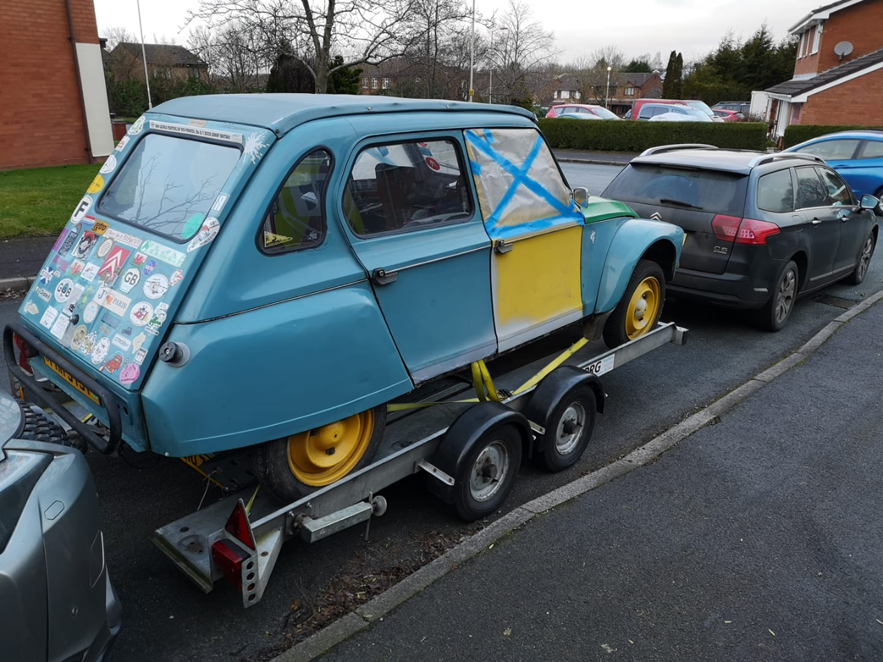

chaseracer Posted January 29, 2022 Author Posted January 29, 2022 On 23/12/2021 at 17:51, chaseracer said: The car itself will go to Hereford in the new year... And so it went, earlier today... 😎 AnnoyingPentium, Floatylight, Surface Rust and 6 others 9
chaseracer Posted January 30, 2022 Author Posted January 30, 2022 The new engine has been run on the test rig - I saw it yesterday - so now Pete will fit it to the car, complete a fairly short job list (front windows/seals, new shocks, E10 fuel line, sort rear lights) then get a ticket and shake it down for a couple of hundred miles. sdkrc, AnnoyingPentium, puddlethumper and 8 others 11

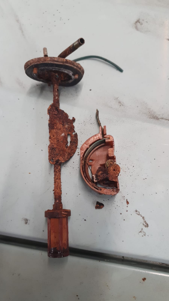

chaseracer Posted February 1, 2022 Author Posted February 1, 2022 Military strategists will tell you: no battle plan survives first contact. And so it is with work on old cars... Actually, it ain't that bad. The new engine's in, but a few small issues have been discovered by Mr Sparrow and his crack team. A rear wheel bearing was a bit noisy, so has been replaced. The gearbox had something in it that might once have been EP80; it now has the excellent lube Pete uses in his race car, as well as a new breather. The big one is this: That used to be the sender unit in the top of the fuel tank, which is also full of gunky shit. Might* explain some* of the running issues. Replacing tank/sender with new: "do it once, do it right". Tickman, LightBulbFun, groovylee and 8 others 11
richardmorris Posted February 1, 2022 Posted February 1, 2022 Can I pinch the last two pics please Dave? I desperately need something to put in the next issue. chaseracer 1
