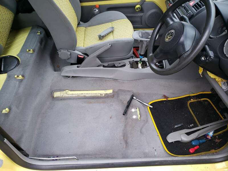

Today was finally warm and un-wet enough to try and sort the handbrake.
I thought I was going to have to take the carpet out, at least from the rear far enough forward to access things, so seat came out
Looking closer I could now access the handbrake and more importantly the plate it bolts too. Handbrake itself is easily removed - hopefully you can see at least 4 spot welds have come apart
20221221_101654.thumb.jpg.c2f195e2f685a1cbec501173a57a377f.jpg20221221_101714.thumb.jpg.8870d2a075b40e0a074034ad4a09c69b.jpg
I forgot to take any more pics but decided that at least for now, the easiest course of action was to persuade the plate back down as much as possible, then use 3 sizeable screws and washers to secure it to the tunnel. It's not perfect as there's not a lot of spare space and I couldn't go through the weld locations as the metal underneath is torn.
it is now firm and when the weather improves I can go back and ideally weld the plate back in place. Good enough for the imminent MoT though
