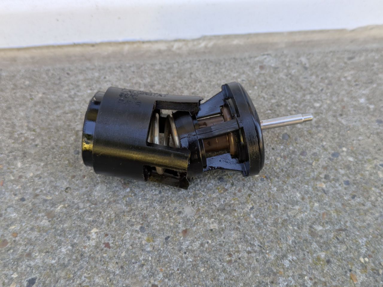

Lupo continues to do car stuff, but I've always known it needs a thermostat as it doesn't get up to 90, especially on motorway runs. Around town it seemed to get up to temp and stay there.
Anyway, now it's warm weather and doesn't matter so much, I got around to changing it

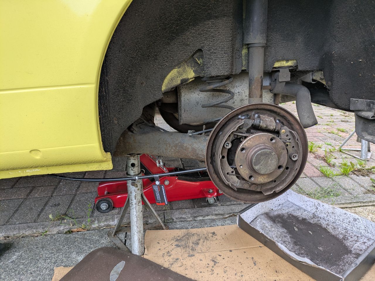

The N/S handbrake cable on this one snapped last weekend, while in normal use, and definitely not while I was trying to do a cheeky handbrake turn on the grass at the boot sale.

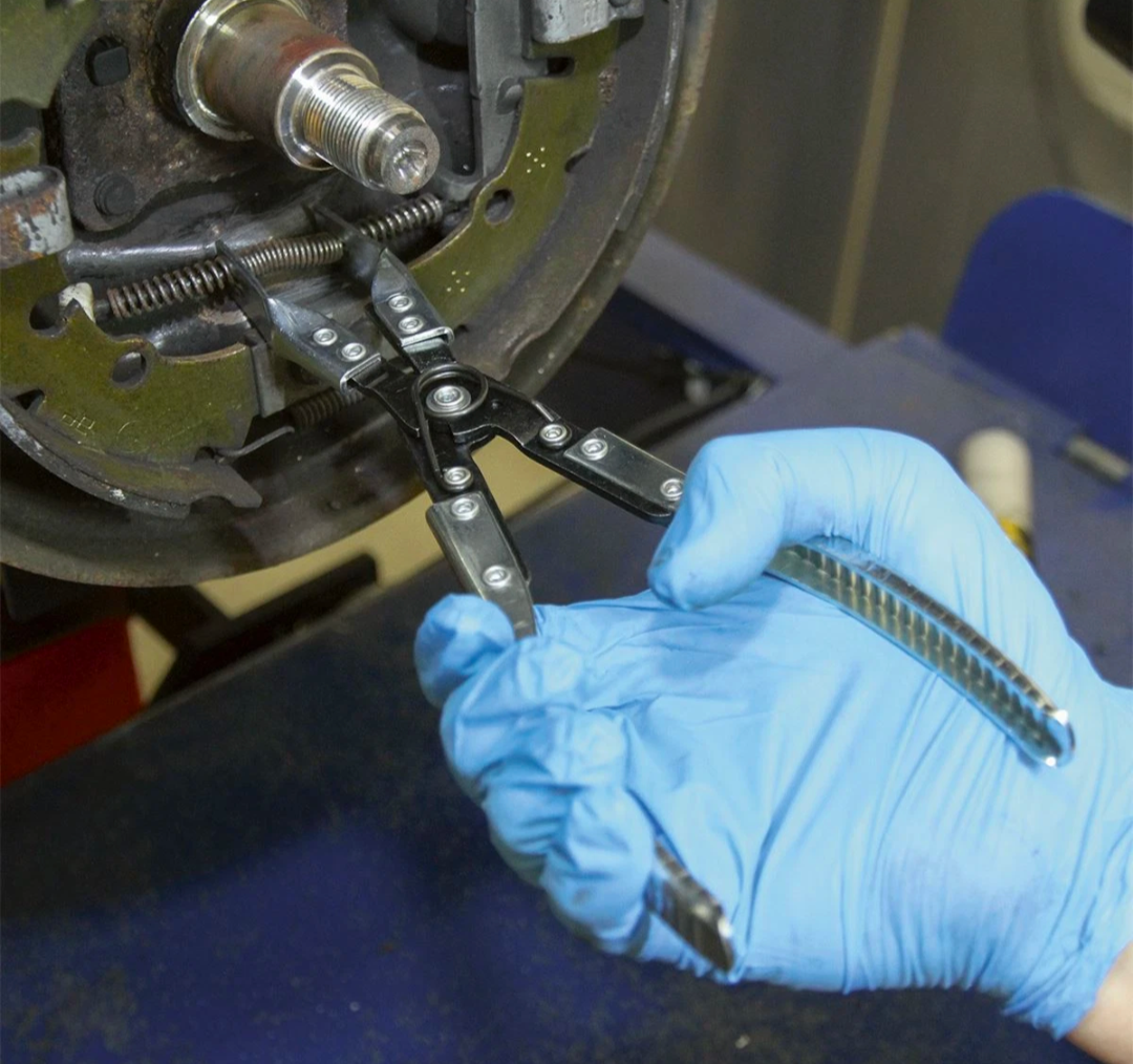

Replacement isn't too terrible, it feeds into a guide tube just above the exhaust, so one corner of the heat shield has to come down, a couple of fiddly retaining clips on the axle and body, and then the really fun part of attaching it back onto the brake shoe. I'm sure there's a proper tool to compress the spring on the outside of the tube, but I don't have one. You can take the shoes off and attach the cable easily enough, but then you can't get them back on past the hub. A good 45 mins of inventing new swearwords eventually got it done, after re- releasing the retaining clips to give myself a bit of extra room. Then just the fun* job of getting those bastard springs back into the shoes, only one fired off into the distance and was quickly found again, so I'll take that as a win
Here's the tool I need
