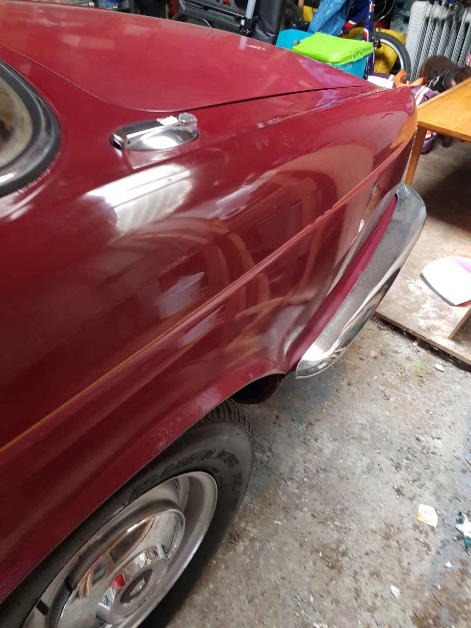

I used it Wednesday and it was  A1 and lovely till I repeated the door scraping  I gave the Jag 15 months ago   ironically trying to be  super careful to avoid hitting the Jag as I put the Rover in  the carport.
Nothing horrendous, the stainless trim took a bit of a hit  but a  few  taps with a hammer and flat screwdriver  had is kinda straight. It will do for now and bits for these  are plentiful and fairly cheap. I'd also smoothly peeled the Cameron green paint off - these doors came from a red car once upon a time as that's the  original paint.  Though I'd know this since the 2nd day I owned it and peeled the waffled door cards off.   Oh and I broke a plastic clip - repairsd with a  cut down screw.
 Tbh I'm not totally miffed, the paint is a so-so respray done  well over a decade if not 20 years ago so I've just got to match the colour and  take my time with a rattle can.   It'll probbaly be more faff getting  a match for the paint.    You can see some lovely microblistering  that was hidden by the stainless trim strip  - along with  tons of dirt, leaves and little twigs.  The vauge plan is/was to sort out the various small bodywork issues and repaint it  next year after giving  it a through mechanical refresh this year .

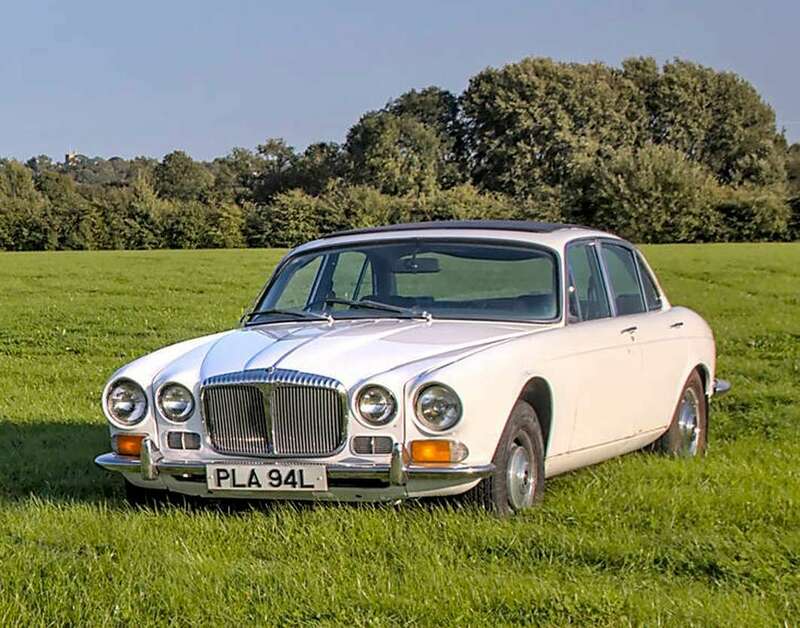

And a segue from one British institution to another. The car that got me back into cars  for real fun..
So  2019 I had cash, had been through a thoroughly really shitty extended period  of my life and had some cash to burn  and a complete lack of physical ability and fitness to pursue my previous interests and hobbies.  Csrs were the answer,  if it was broke I could st least  sit in it and go brrrmmm brrrrmm.....
I'd looked at various kinds and types of cars including  a dalliance  with owning a 8-10 year old quattroporte  -because noise. Tho I baulked  becaus the 2 different gearboxes each had an interesting and expansive failure point.   So I meandered down the older maybe classic  route of maybe less modern and more characterful and for an ish modest budget you could get so much interesting and  broken or about to break stuff.  I fancied a Mk2 but I wanted a better ride  so migrated to an S type - there was a black one in Bristol with a red interior that looked ok in pictures but utterly dire at 50 feet and got worse the closer you got.   Natch. And then I remembered the XJ6 and   this gem turned up about 50 miles from where I lived in that there London at the time.
Not too shabby but also  something that hadnt been overly cared for either. The owner was a mechanic and CSR restorer who'd bought it 10 years prior, gone to town kn it mechanically and  used it as a sparing reliable daily for 10 years and out 20k on it.  The paint was bird shit crazed and it had a little (lot ) of patina going on and the seats were utterly crispy bar the drivers  but it started right up and  pretty much everything worked - bar the German clock and the us AC delco scourced front passenger electric window. I said yes gave a deposit and  it was mine min eminem....
I hadn't even test driven it... WCPGW..

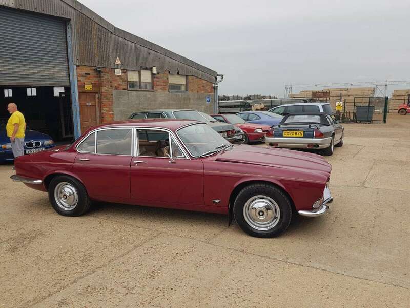

It looks good, really good. Till about 15 feet or so.
But the paint was utterly crazed, the front valance below the bumper was 30% speed holes, the rear arches were bubbling and  crusty and the scuttle below the rear window was just starting to show rust.  The interior was utterly shot, all ther but shot, crispy and  fragile if the leather didnt snap the stitching did.  Mechanically it was  great, there were invoices for parts for almost what I'd paid for it and it had been gone over and the engine rebuilt so  there was no lack of go or stop.
It got used for a glorious summer and 1500 miles, to the beach, outings my sister 60 miles away and it did it all reliably and in style.   Bar cutting out coming back from the coast one really hot day, just cruising along and it went quiet and we started slowing.. imperceptibly  at first.   Shit , stop and utterly no go.. crap,  but maybe.. what if I switch tanks..  and yes a fuel pump had packed up or more accursly would pack up after  half an hours use, 30 seconds and we were on our way home.

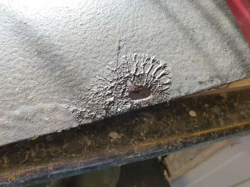

So I decided I'd do some restoration remove rust repaint and  try and sort the interior and at the start of Dec I stripped it all down and  it went off to the painters.
I could have fudged  it and thown rust converter on but I wanted to keep it a while so doing it properly was the way apparantly. The rust wasn't bad but would have been an issue sooner rather than later, tho structurally it was good.

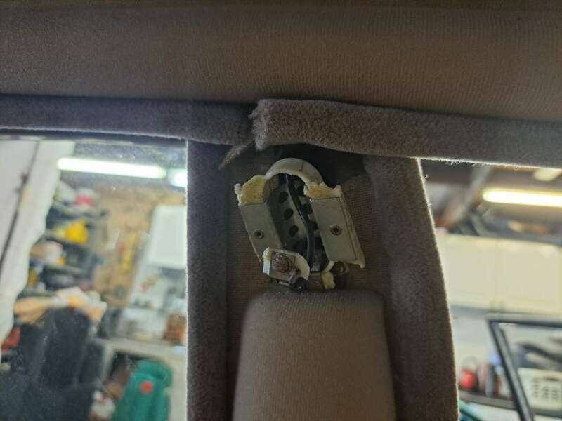

Go through the parts catalogue and find the 20 or so missing imperial screws for the sun visor, RV mirror, console etc to replace the random incorrect or plain missing ones.

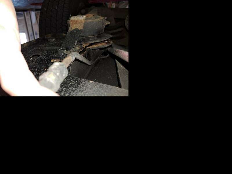

As for the jag. After the  tanke leak and exhaust jangle  I was ready for the poor starting and rough running issue. Except.. I wasn't.  Contunuesd window down good weather motoring  in June  still left me hearing odd jingly type noises still.  Back under and copious shoving of 4he exhaust and anything made no real difference left me stumped.. till I looked at the radius arm mount..  ahhh
The jacking point was also crysty.. and had been repaired before th the rust wasn't horrendous. I can only guess that it was jacked up on the radius arm kount at soem point in the last 3-4 years and this crunched it and aided the demise of it.20230607_100555.thumb.jpg.9bd6ac3b3d2552ee640bff093b9e8760.jpg
It had been repaired and plated before ad I could have bodged it ut I cut it all out and  put on3 repair panel in insert of stitching together previous repairs.
 NaNaturally had given the FIL his welder back a week before discoveri gthis so i had to wheedli 5i back and get on with it.  It was not horrendous a job but whe I lined it up - carful to make sure the original slot welds lined upp.. they didn't so thr mount had to come off again and be rewelded for about 4mm of my error.  Hence no pics of the  job in progress as I was fucked off a tad. I still need to order 3 imperial screw/bolts to put the outer jacking playe/locator back on but it's done and no jingly noises of slowly flexing and tearing metal and rust hitting the ground. Granted it took me nearly 8nweeks if fitting it in with life, school 4uns and getting the enthusiasm  up for it.

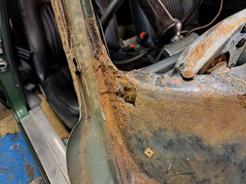

The reason for  this was that id noticed some nasty flakes of rust at the bottom of the A pillar on both sides. Quite big chunks.  At some point the Rover had been  gone  dicked around with and I would guess the screen and lower screen seal  /demist vent rubber had been  badly fitted.
Going by the  speed holes yes- a crud trap, lashing of sealant and  water holding foam all met in a joyous celebration of rust.20230916_114230.thumb.jpg.b669933797e18e726d8b6d3517890ea3.jpg
The passengers side was worse
and while it wasnt brilliant it could have ben far worse and there was enough of the  structure left for me to  put in small patches and rebuild it.
a judicuous clean up and  smaki g
