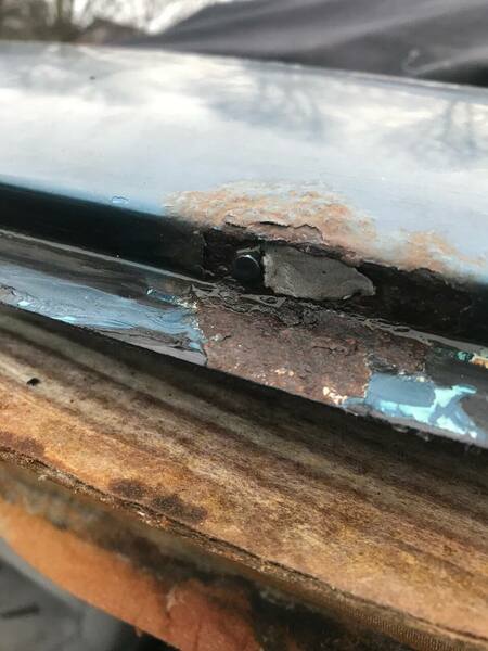

I woke up this morning and it appeared fairly dry out so decided to crack on with doing somthing about the corrosion around the windscreen aperture/seating
I quickly sanded the area back and using this stuff applied a very thick coat of it on the corrosion.
Within minutes I could already see a noticeable difference.
I applied another thick coat and thought I’d address the holes while waiting for the gel to do its thing. I plugged both holes with quick steel but it wasn’t as easy to use as I’d anticipated. Mainly due to the fact that even with the headliner and wiring removed I couldn’t get proper access to the roof cavity.
Now that the two holes are filled with quick steel I will probs sand it back and  reenforce it with more once it’s set. I then turned my attention back to the corrosion around the windscreen but by this time it had started raining 🤬

Look how well it’s cleaned up!!! Windscreen aperture is now free from corrosion and fairly clean and smooth despite taking a hammering at some stage. Currently awaiting new windscreen which is getting fitted on the 4th. Then it’s new brakes new belts and interior refitting before it’s off for an MOT. 🤞😁

Probably too late now but unless you cut the rot out and weld new steel in, that screen surround is just going to rot out again. Requiring the removal on a bonded in screen and they rarely come out intact. Depends how long you're keeping the car and how long it's supposed to last.
The screen hasn't been fitted yet but i totally agree long term it needs welding but unfortunately i cannot weld nor do i own a welder. All focus is currently on getting the car running (which has been accomplished) and getting the car secure and sealed from the elements. At a later date at the cost of another windscreen il have the aperture welded but first the car needs to proof itself by taking me from A to B for a few months with little to no problems.

have you thought about cutting that bit of grot out with a dremel and aralditing a small patch of metal in.  Then finishing off with a bit of filler.
I used this approach on a wing above a headlamp once.  It was only a 2p hole.  The repair has lasted 30+ years.
whilst it still isn’t a welded repair, it might mean the screen won’t have to come out again.
once I had shaped the metal with a bit of a step to fit behind the edges of the hole, I spread some araldite on polythene, Laid on the patch, more araldite on top, then pushed it into place and worked the polythene to seal the edges of the patch with araldite.
it was all non structural and it sets rock hard and is impervious to moisture.  You also avoid all the heat of the weld.

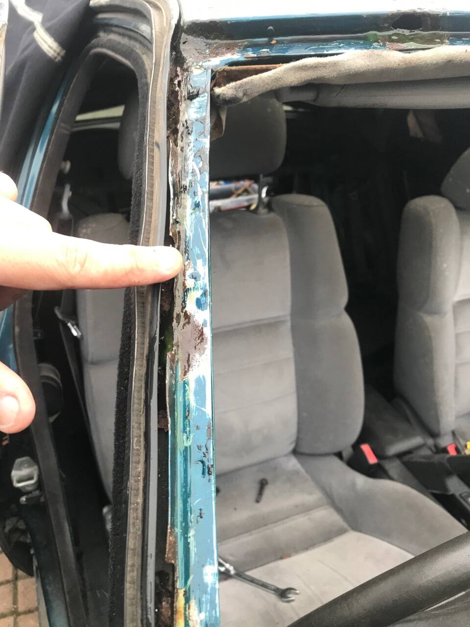

Have you got any pictures of the affected area since you cleaned off the corrosion? Looking at some of the earlier pictures it looks pretty grotty and I’m just a bit concerned the job could escalate and then it’d have to be rushed. Only having 1 day of limited daylight in the winter outside isn’t the best time to be doing welding!
I haven’t but I will say although iam not a welder it looks worse than what it actually is. The holes are currently plugged with quick steel and although it’s a bodge  job seems to have done the trick for the time being.
The holes were/are  no bigger than a thumb nail so I doubt it would take a whole day but again am not a welder.
You could very easily weld in a small piece it doesn’t matter how it looks as it won’t be seen behind the windscreen and trim. Aslong as it doesn’t obstruct the windscreen being fitted I would be more than happy.  I was tempted to fill it myself with a piece of metal from an old maccano set 😆

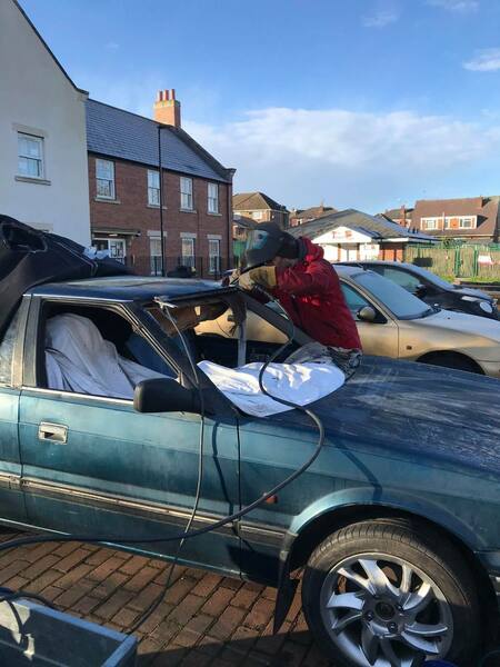

Huge thanks to @Ian_Fearn who came out to weld the holes in the windscreen aperture today.
Despite the bitterly cold weather and the metalwork being stupidly thin it didn't phase him one bit.  Ian has done an amazing job and given the car a bigger chance of survival.
Thank you again kind sir your a truly a legend amongst us!

@Motown that’s no bother mate. Was a pleasure to meet you and am pleased I got the chance to throw my limited skills into the ring to get this back on the road.
Regarding the more serious rot in the passenger side roof line, I was thinking...... If you can get this back on the road with an MOT, once my wife has been vaccinated and Covid is a bit calmer, why don’t you bring it down to Derby for a long day? I’ll show you how I would go about the repair, give you some welding practice and we can work together to get that area sorted.
