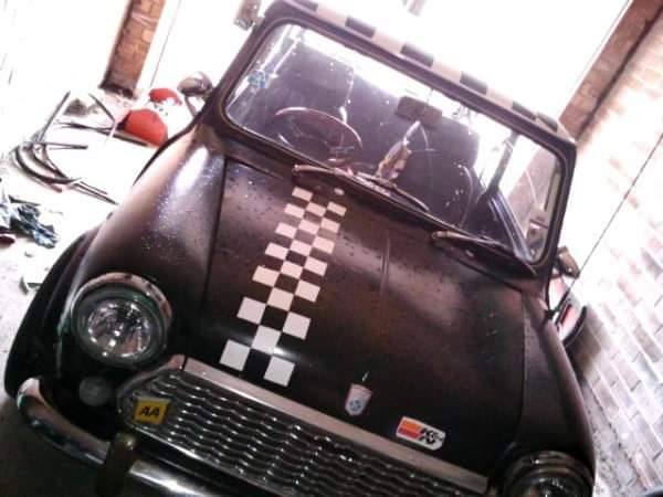

My Intentions a year ago were to get it quick enough to auto test, so I ended up giving her a roll cage, rally lighting, foot rests, cheap timing equipment etc...
Hence the rally style look at the minute.

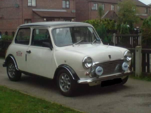

In the six years I've owner her she's been a plethora of colours. Using a £20 can of synthetic enamel paint and a roller haha!  The white is the original colour. And satin black pound shop rattle cans was not my proudest moment

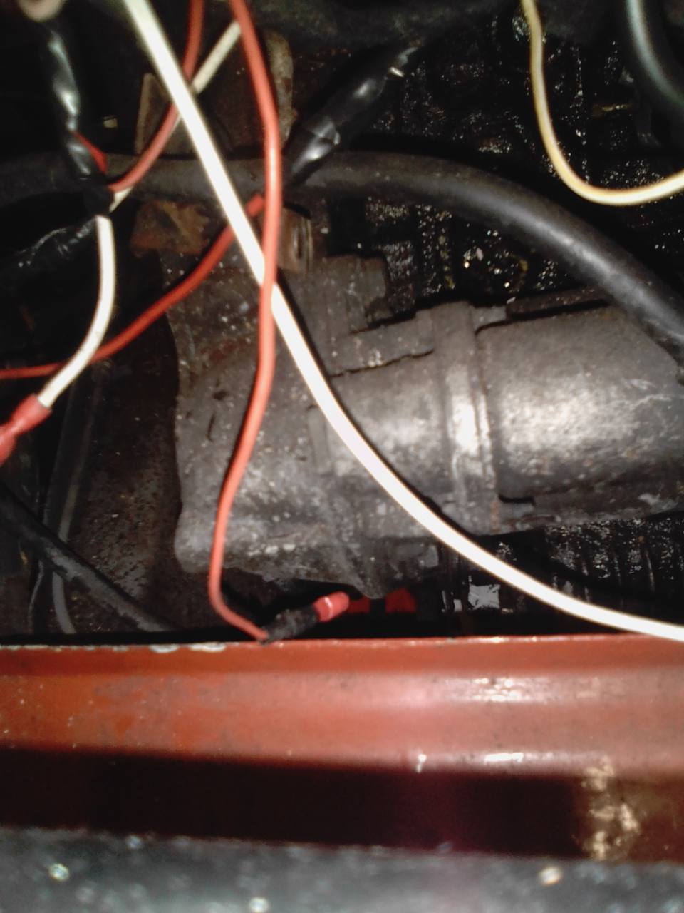

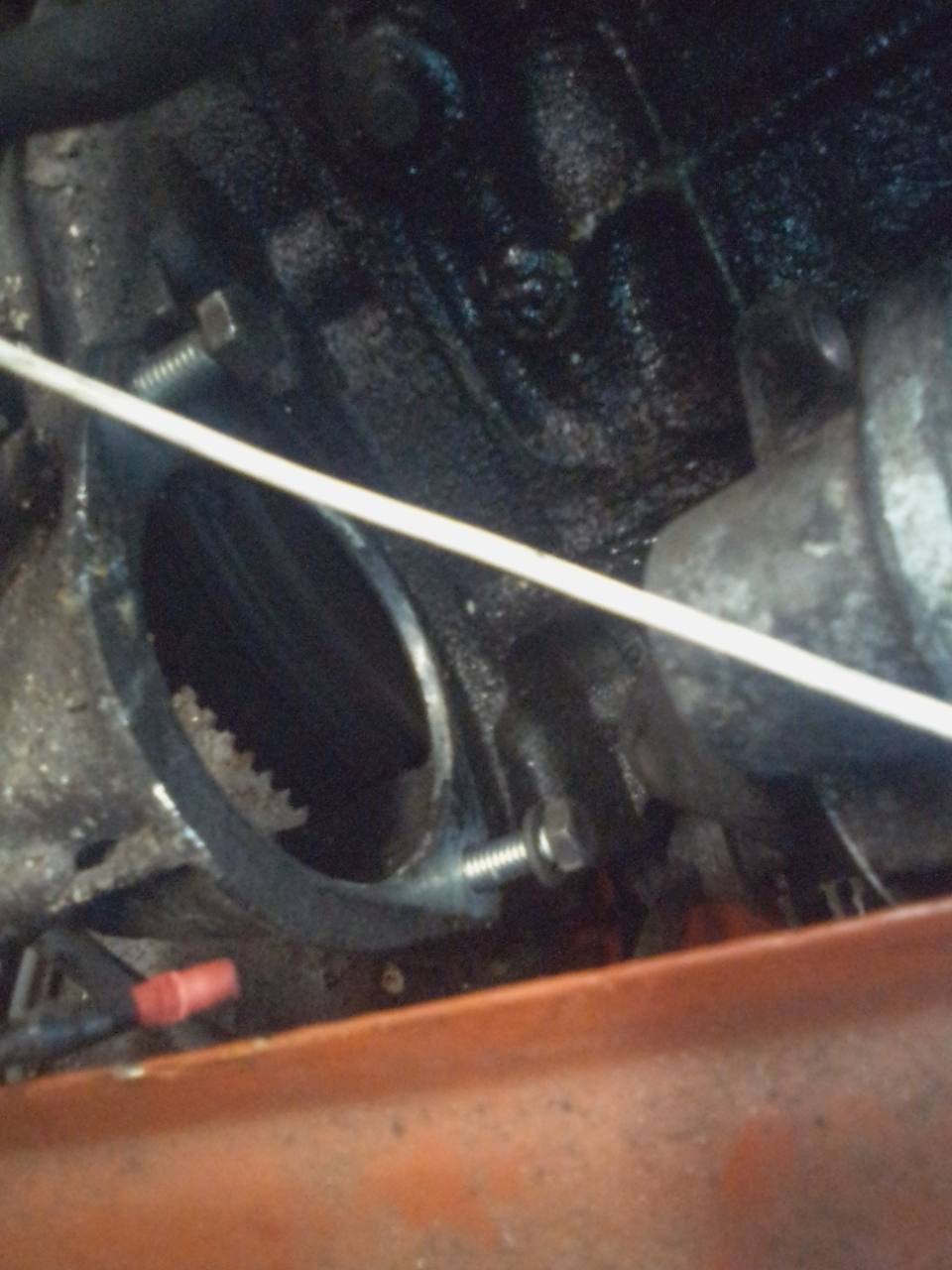

As it stands the clutch housing is off awaiting the new clutch, tonight's job (when the Mrs and kids are in bed) is to take off the starter motor , to allow me to lock the flywheel In place and remove it, revealing the clutch
I also need to clean the subframe from above so no contamination gets inside
Not a great deal of progress today, only had 20 mins in the garage so managed to whip the starter off. This way I can bolt a Flywheel lock in place! I aren't taking the skin off my knuckles if the chisel , or what ever other bodge I'd probably otherwise use slipped.

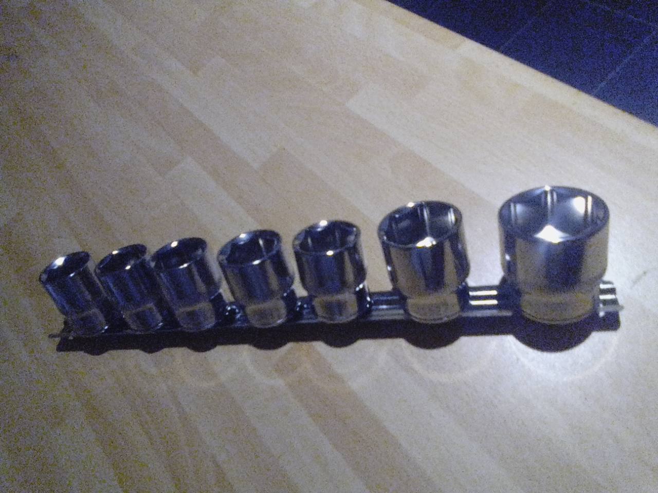

Not much progress today, however look at this bargain set of sockets. I somehow misplaced my 30mm socket... Unless I never had one... Anyway I grabbed these for £13, 20mm-30mm set
The flywheel still isnt off despite heat and a good smack with a lump hammer. Bought a shitty flywheel puller from machine mart and it's just bending like a banana. Dunno whether I should return it, it's obviously not fit for purpose.

Absolutely! Although sometimes I think that's half the fun.  Thanks for your advice as soon as I get another puller I will give it a whirl! You get to really know the car inside and out doing jobs like this don't ya. It seems like they never make tools like they used to before now just seems to be rubbish Chinese crap. I have noticed they have started to remanufacture the Churchill pullers on eBay does it look like this by any chance because I might invest: https://www.ebay.co.uk/itm/Classic-Mini-Metro-Allegro-ADO16-FLYWHEEL-Puller-18G1381-BMC-Leyland/284026498350?_mwBanner=1&ul_ref=https%3A%2F%2Frover.ebay.com%2Frover%2F0%2Fe11051.m43.l1123%2F7%3Feuid%3Dff1859ecf91047c3811d6e39ea43de55%26bu%3D43486690020%26segname%3D11051%26crd%3D20201201035433%26osub%3D-1~1%26ch%3Dosgood%26loc%3Dhttps%3A%2F%2Fwww.ebay.co.uk%2Fulk%2Fitm%2F284026498350%26sojTags%3Dbu%3Dbu%2Cch%3Dch%2Csegname%3Dsegname%2Ccrd%3Dcrd%2Curl%3Dloc%2Cosub%3Dosub%26srcrot%3De11051.m43.l1123%26rvr_id%3D0%26rvr_ts%3D381e2bd91760aad375d7466cfffdacaa&ul_noapp=true&pageci=1371dd2d-9ee9-4f3c-9279-84e46f1b7d33
Tbf I'd use the one you bought as a pattern (if it fits properly) and make your own. That way you can get something that can take a bit of punishment  and get the job done. I wouldn't buy another even if it claims to be the Churchill one re-manned cos it could be just as shite as the one you have 👍
I've not seen that one before but it looks very good for the money.  My original one looks like something you'd find on a blacksmith's floor!  Yours should come off with the Clarke puller (and persistence!), but you might have to leave it on there a week!

I vaguely remember something about a washer or a key that sometimes gets forgotten when trying to remove the flywheel, which then makes it impossible to remove. Might be misremembering though...
Yea your right,it's the little keyway washer that sits under the bolt :) I double checked to make sure
Yep, I forgot to remove this and gave myself hell before I realised.
Popped off easily afterwards.
Ahh I've already returned the puller this morning, tbh though it ended up that twisted that there was no wayyyy I could have made a pattern from it. Good idea though!!
They can be shit to get off. I made a puller from some 12mm boiler plate (and have just remembered my mate still has it, bugger). Patience, a big hammer and shock and unlock type spray is your friend here. Just remembered that I have a brand new ultralight flywheel from minisport sat in the sat. I could sell it, or use it as an excuse to buy another mini.
I used a 12mm plate with just the 3 x 3/8 bolts. no centre hole.
Take big washer off flywheel bolt, screw flywheel bolt back in but not quite up to flywheel. It may bottom, I forget.
Fit plate, tighten 3/8" bolts as hard as you dare so plate is pressed hard on flywheel bolt head.
 Hit plate in middle of the bolt heads with lump hammer. Re tighten 3/8" bolts and hit plate again.
I have been known to drill a big hole through the inner wing and stick a long bar through to hit as a last resort.

Thanks mate, I've bought another puller but will give these ideas a try ! Hoping it comes off before Christmas haha
Success!! The flywheel finally came off, using a range of techniques aforementioned by you guys. I was trying for quite a while before I decided to pull the puller back on and then crank down on it as hard as I could, I was forcing the breaker bar down with my knee when I made a massive bang. I honestly thought I'd just snapped the extension bar as it wouldn't be the first time, but low and behold it released the flywheel. I bought the "Churchill" remanufactured puller and it is absolutely fantastic for the money. I honestly didn't expect it to be so good. Not doubting the seller, but at that price point, I didn't think it possible to make such good quality for so cheap. Here's a couple of pictures that don't do it justice really. Oh and the clutch plate, that looks fairly worn to me so I'm confident that caused the slipping. Not seen any oil from the clutch oil seal either. IMG-20201210-WA0001.thumb.jpeg.54ad1faafb4149164cf4783011952177.jpeg
