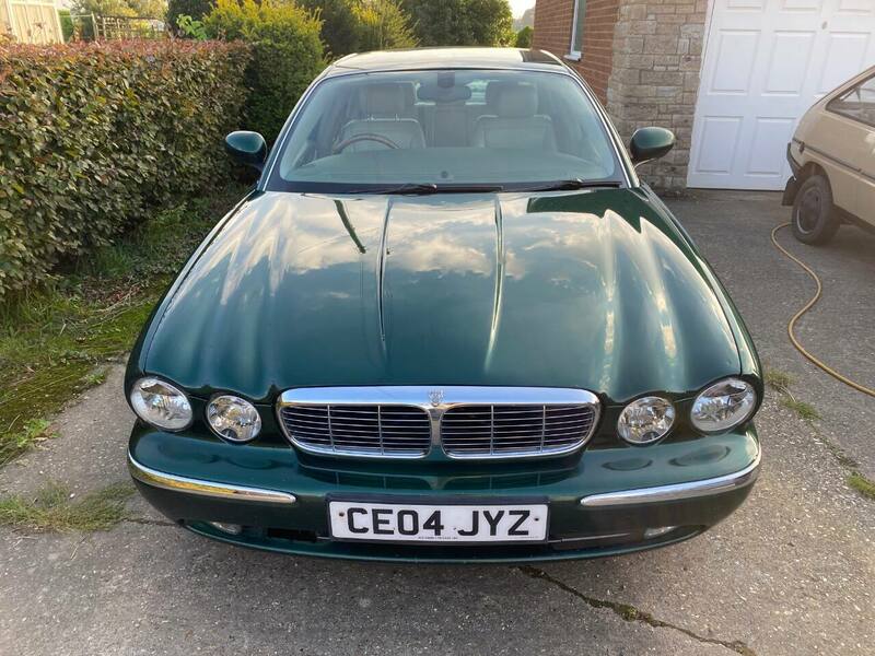

Jag washer pumps, "fail" on a regular basis and ironically when they have been lavished with loads of screenwash additive.  I snip the pipe near the bulkhead (to make it convenient) and using a dinky tyre compressor blow down the pipe until the air is spinning the motor. (I then blow the other way to clear the jets).  Join the pipes with a joiner from Amazon or your friendly aquarium shop and that normally does the trick.

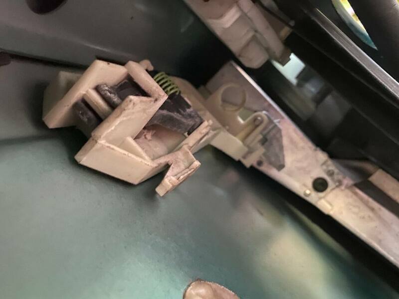

Today’s job: fixing the door lock.
Solution? The spring in the interior door handle is broken. Replace handle or spring.
Still doesn’t answer why the total closure isn’t working on that door but maybe it needs the switch pack connecting. It does lock and unlock on the remote now.
Also good grief that trim did NOT want to come off.

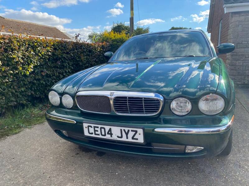

If I don't take it for an MOT or do any more work, £1350 takes it (MOT is up in a month or so); it's just got an XJ6 3.0 SE grille and XJ6 badge, I'm waiting for new tension springs for the inside door handle so the door trim is off, and I'll pop a new washer motor in it if I can't get that unclogged. Will still need the brakes servicing (they stick on a bit after a bit of driving, so the sliding pins need cleaning and greasing and TBH the discs could be nicer anyway), but I think it would pass a reasonable MOT as long as the front undertray is secured.

Annoyingly due to moving house, Jags are no longer an option.
Too long for the garage, and also my parking space. (Overhangs into single track road used by residents to reach their own space)
Please someone buy this as it looks a beauty and can confirm they drive fantastic.

No pictures because I was working with a spring, but the springs from China arrived and remarkably, I managed to trim one of them to the right length, apply the right bend to the end of it, and fit it.
It needs rather more force to open than I expected despite being the same number of winds and a similar diameter of coil, the only issue being that the angle of the torsion points was quite different so it's under torque rather than at rest. Either that will eventually kill the door handle frame or the spring will calm down.
Either way, the door handle won't be popping loose out anymore. And may surprise any future drivers as to how much force is needed to get out of the car 😕

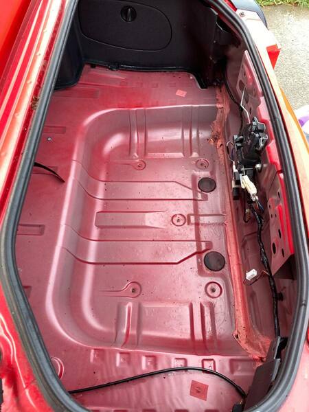

21 minutes ago, Broadsword said:
Be very careful with rust on the NCs. From what I've seen they might look perfect on top, but underneath they can hide absolutely horrendous rot.
Well, if it's hiding some, it's hiding it well. See news 24 for pics underneath... It does have that thick Mazda rubber sealant that traps nastiness though. Also not a single advisory for rust in MOT history. Also cost rather less than most (not all) I've seen advertised...
Link to comment
Share on other sites

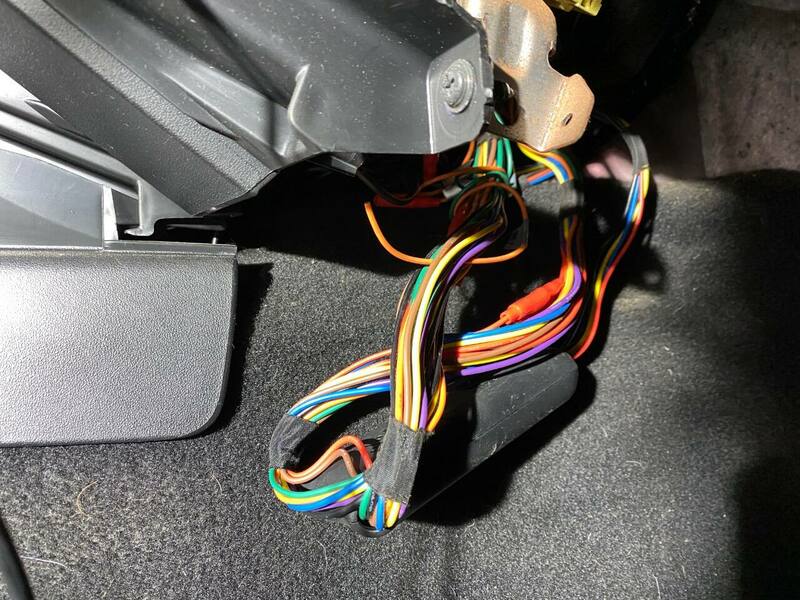

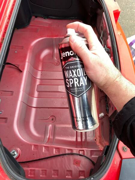

Cursed objects: Early 2000s “professional” hands free kits. Removed without drama though I suspect there’s still a rats’ nest of ISO loom adaptors in there. The iPod adaptor kit appears to be Mazda branded and sort of fell out of the glovebox; I shall tidy that wiring (I reckon I can feed the iPod connector to the rear cubby) when it’s not raining.

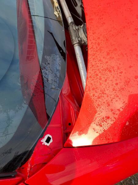

Had a more exploratory feel of the rear arches inside the plastic cover. Feels like a solid clean unscabby edge.
Needs a wash in there and obviously I’m about to use this thing in winter/salted roads so many washes and rinses then jenolite/waxoyl.

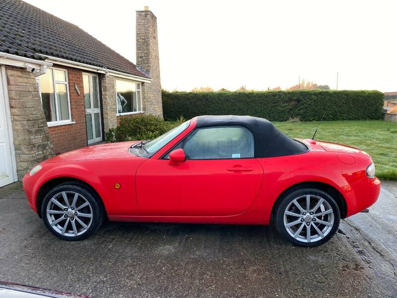

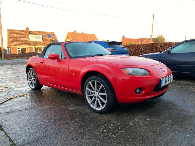

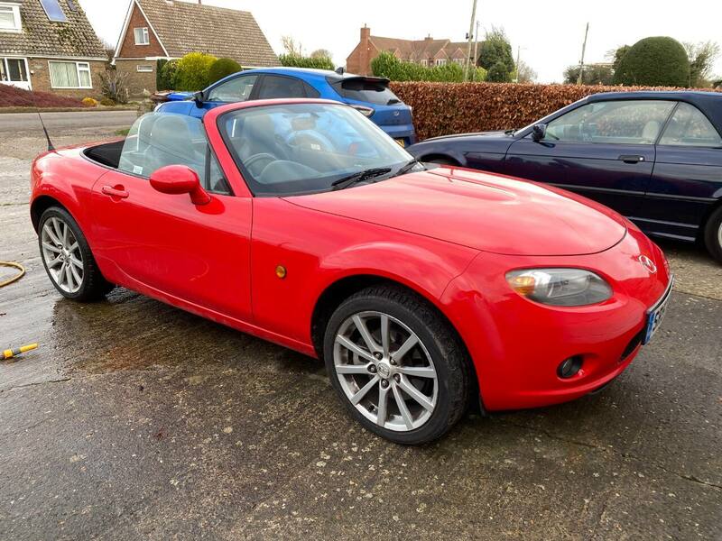

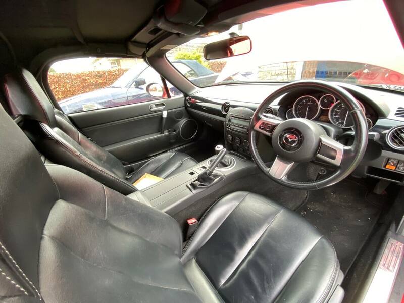

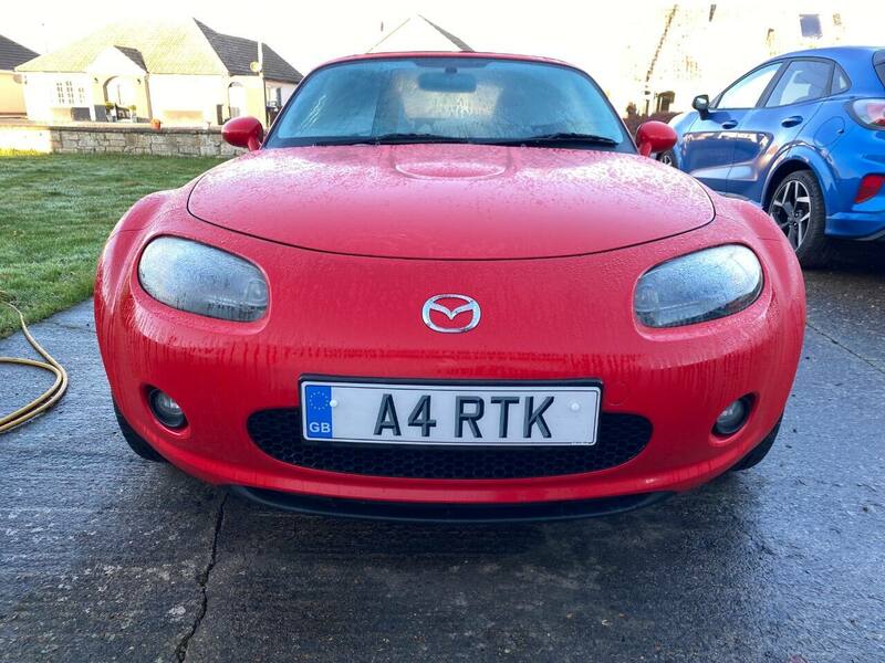

So, the MX-5 is mine - I've been fishing for one for a while, including a couple on the forum, and generally fixated on NAs for the pop-up lights - NA prices are batshit though for my budget - £1500 for non-roadworthy projects, the knowledge they rust and have had time to do so, and they're kinda cramped and unrefined.
Doesn't stop me loving the shape. But a colleague recently started a family and his wife's NC MX-5 had been sat in the company car park for months getting damp and flat battery sad. We were chatting about them and he mentioned possibly selling it, so a few weeks of faff and I finally went over to jump start and try it.
Now it's mine the Jag needs to go because of it, and the BMW 323i might, but what is my NC like? I think of these as being 'the forgotten MX-5s', and didn't like how they looked when new -  a bit soapy, a bit like a 100NX.
It's got a whack of history, is a Berkshire/Sussex car, has 103K on the clock, is a 2.0 Sport with six-speed, LSD, no A/C and a manual roof. 3 owners - Penny/Alan from around 2018 (and only sold becaue they have a new baby), Sophie L-R from 2010 to 2018, and a previous owner for three years before. It was bought as an approved-used Mazda for the second owner.
Bad paint from a door/handle repair (documented) is the only downside. I've removed a Bury bluetooth kit but kept the iPod KA-300 adaptor until I get the car a double-DIN kit.
It's been given a quick clean as it had been used a lot and then parked up at the office since around June. Only issue I have with it is a noise from the back that sounds like a wheelbearing, but the car drives far too well - there are suggestions on some forum posts that the noise can be down to road noise and trim and drain holes, and it definitely gets louder with the roof up and there's a loose fabric arch liner edge.
But if it is a wheelbearing so what, it's a 100,000 mile car. It's allowed a wheelbearing. Oddly enough MX-5 specialists seem to be utterly visible on all the forums so finding one who won't screw me over on a repair seems very likely.
So far I like the NC more than the NA from behind the wheel. I do like pop-ups but this is far more comfortable.

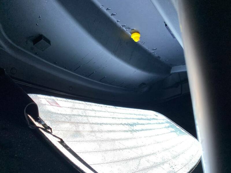

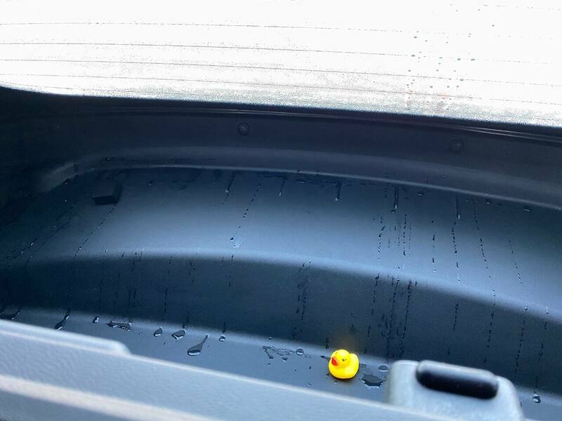

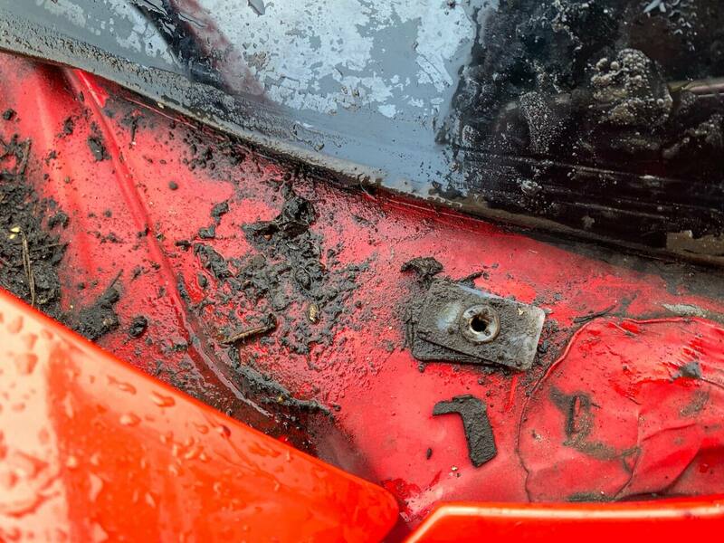

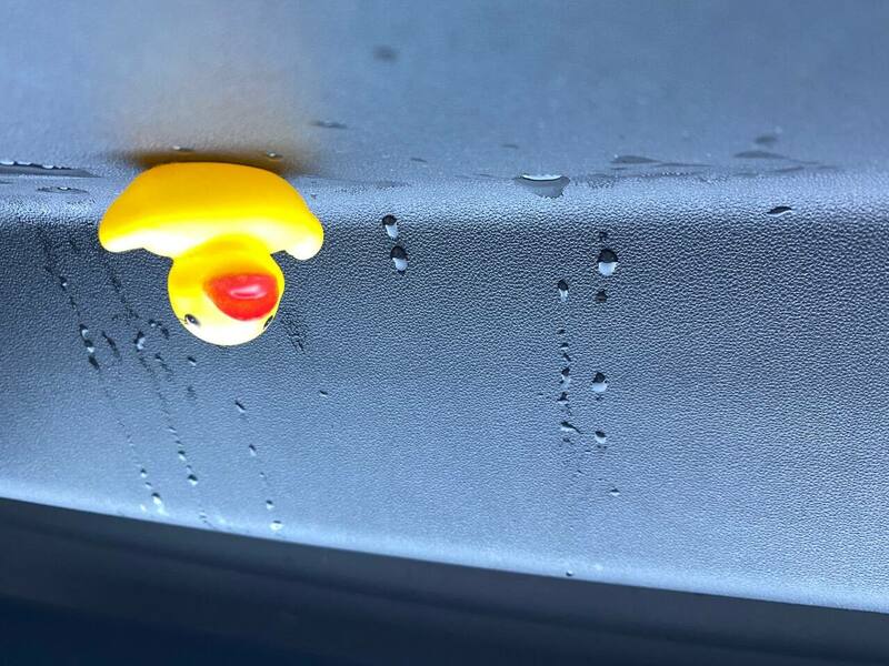

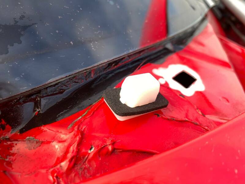

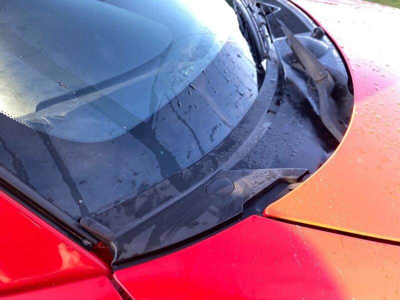

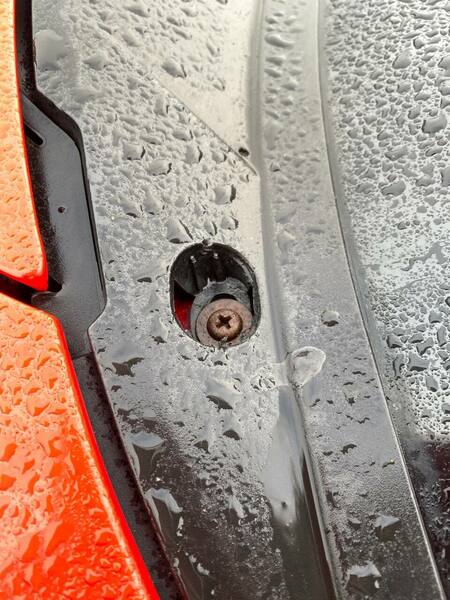

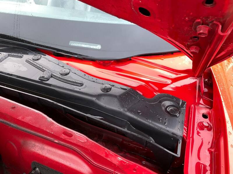

This bugged me:
So:
Jenolite where there are small paint chips:
Make sure where it drains is very clear:
And done.
Just trying it on:
Link to comment
