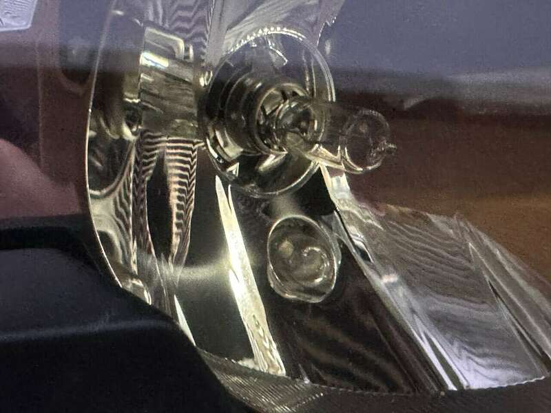

So LED H9 bulb replacements are crap. They're actually H11s, they don't usually rotate in the mount for adjustment, and H9s are designed for high beam so are assumed to be any orientation to suit (I'd question that, and R75 lights are crap anyway which may be down to choices like "we don't care which way the bulb ends up as long as it fits in the offset hole with its bulky connector on").

Instructions for changing a blown headlight on an MG ZT.
Start engine
Turn steering
Remove cover in wheel arch
Reach in and twist bayonet
Lose orientation of bulb
Try to refit
Cut hands 16 times
Take match
Burn car
Hey, it's much brighter now!
Who the hell designs these things?!
