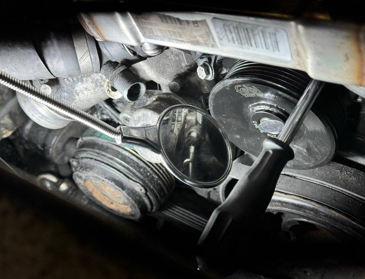

This is a bastard of a job. The EGR cooler just sits in the way of water pump removal and it seemingly /has/ to be removed no matter how cunning you can be 😕
Coolant drained, bolts out, thermostat bolts mostly out in case the thermostat had to come off after all, but nope. Water pump is staying put.
Sick of oil-soaked hands and swearing at BMW's otherwise good engineering - I swear they do this just to make it hard to DIY them.

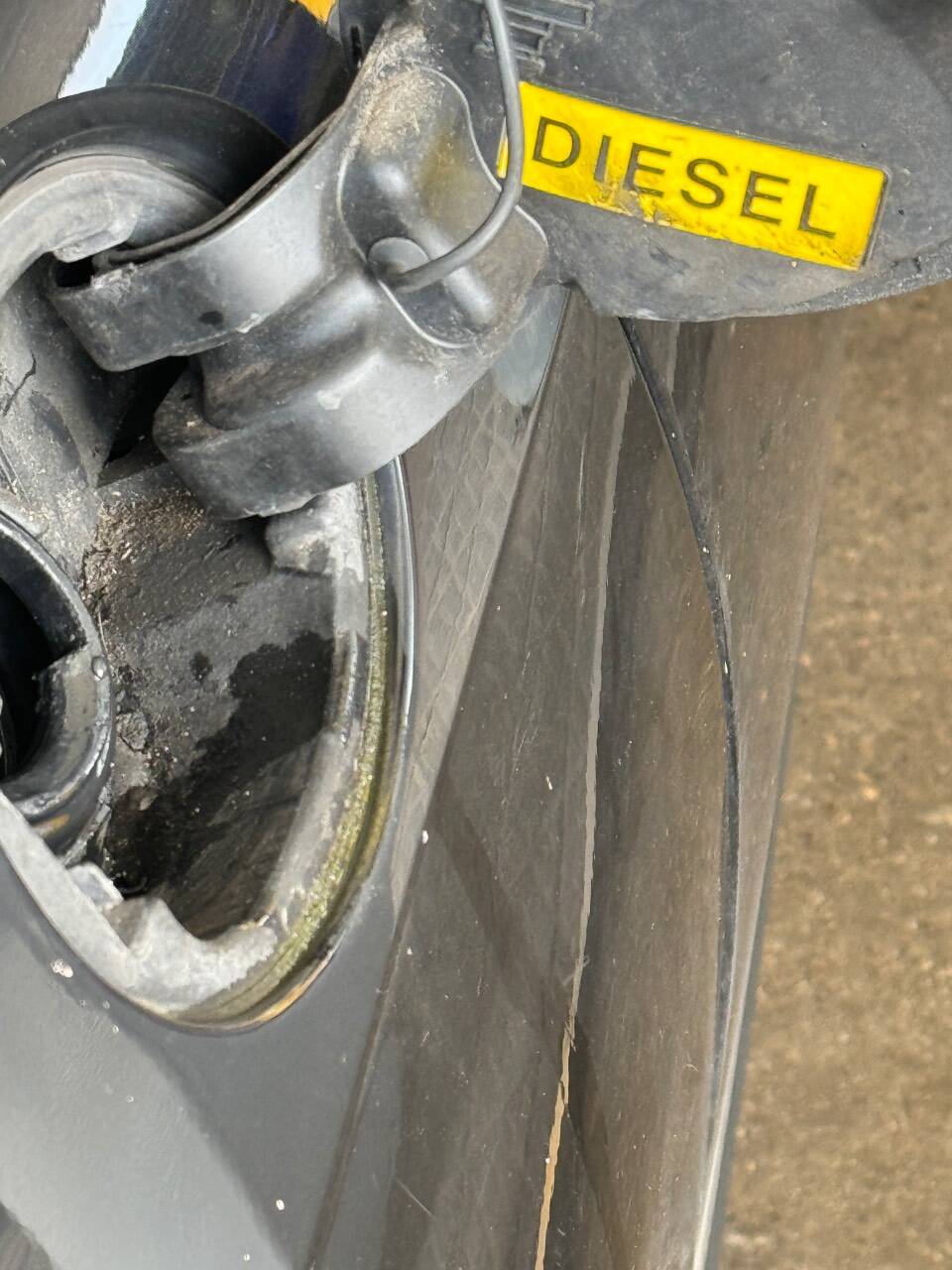

Nearly all the parts here - another supplier let me down so I still have no new fuel flap lock, have resorted to a secondhand one as it's the piece stopping me assembling the boot trim.
I hate this pipe:
It's solid and goes around the side of the engine so more removal is even more of a pain in the arse but it is in the way of pump or thermostat.
Making that annoying is that one bolt on the 'stat is blocked by the EGR cooler so I wanted to install pre-assembled and can't.
And the EGR cooler also makes lining the gasket up (no chance of holding bolts in and installing, it always finds a thing to snag on) also difficult, blocking tools and torches alike.

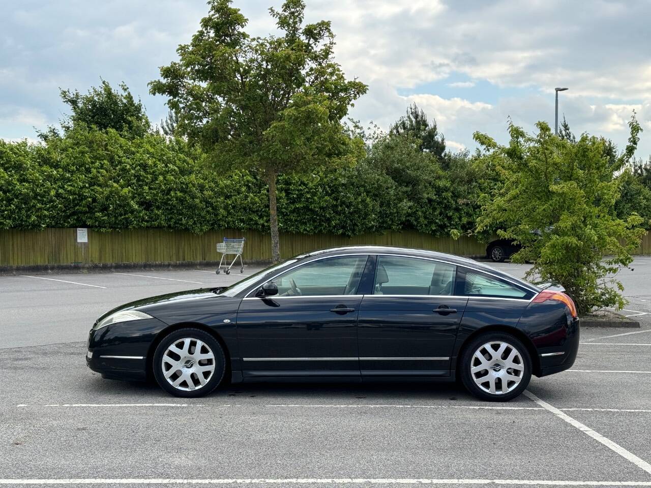

The collection thread that never happened - talk about 'fate lining things up'! Obviously I've joked a few times about the car I hate (but clearly remain interested in) getting so cheap I'm tempted on @GeordieInExile's thread (why not the silver one? Because my first C6 was supposed to be black and cream Exclusive with lounge pack, and because the offside front window would annoy me far more than a duff handbrake or EML - though I did scout about for a replacement window out of curiosity). The downward spiral of price, plus knowing how much effort had gone into trying to get the car to behave and the shared experience of 'specialists are mostly shit once you need their specialist skills rather than getting an oil change at a garage with your car brand on the door' meant it finally found a level I could not resist.
At the same time, the car that motivated this sales promotion was with the excellent @ruffgeezer who I haven't seen for ages, and it turns out, had bought a car 10 minutes up the road from me.
No trains. No shenanigans. Just drive from Point A to Point B and collect car!
Since @GeordieInExile is the one holding the baby (literally), I'm happy to do the hours on the road. A beautiful Volvo XC70 (a car I have always found appealing) arrives, and in it. an esteemed AS'er with a Lexia/Diagbox cable! Tea is consumed, then we go to collect the XC70's replacement. Which is, of course, an XC70. One that had I not bought the BMW X3, I'd probably have wanted myself.
I have to rush - hurry up and wait into 30 minute M1 delays it turns out - but stick some V-Power diesel in the Volvo and make my way north. The five-pot sounds lovely and yeah, I had a few moments of wondering if I should have bought something like this instead of the X3 or a C6. The trip computer's claimed 53mpg after a reset and a motorway run is impressive, but so was the 39mpg showing beforehand.
Make it tantalisingly close to a Spanish City, meet @GeordieInExile. pet a cat, wake a baby, insure a C6. Get rained on. Point C6 towards home but forget to set the phone for nav and there's no nav disc in the car (the roads would have changed anyway). Manage to miss the sensible route and instead get stuck for an hour in Newcastle. Bonus moment - the last trips I did in my first C6 were as a sparkling happy professional photographer doing events with the MPA, such as the annual awards in Gateshead, and this C6 made me see those views again.
The sun came out and the lovely caribbean beach under blue skies that is why I am obsessed with the cream interior came to life. The unknown old cheap car in a traffic jam made me nervous for a while (is that whiff of antifreeze mine?!) but damn, the double glazing and refinement is just as good as it was 16 years ago. The suspension has a bit of wear at the front, but it floats down the A1 - if anything the worn nature feels more like the CXs I'm used to.

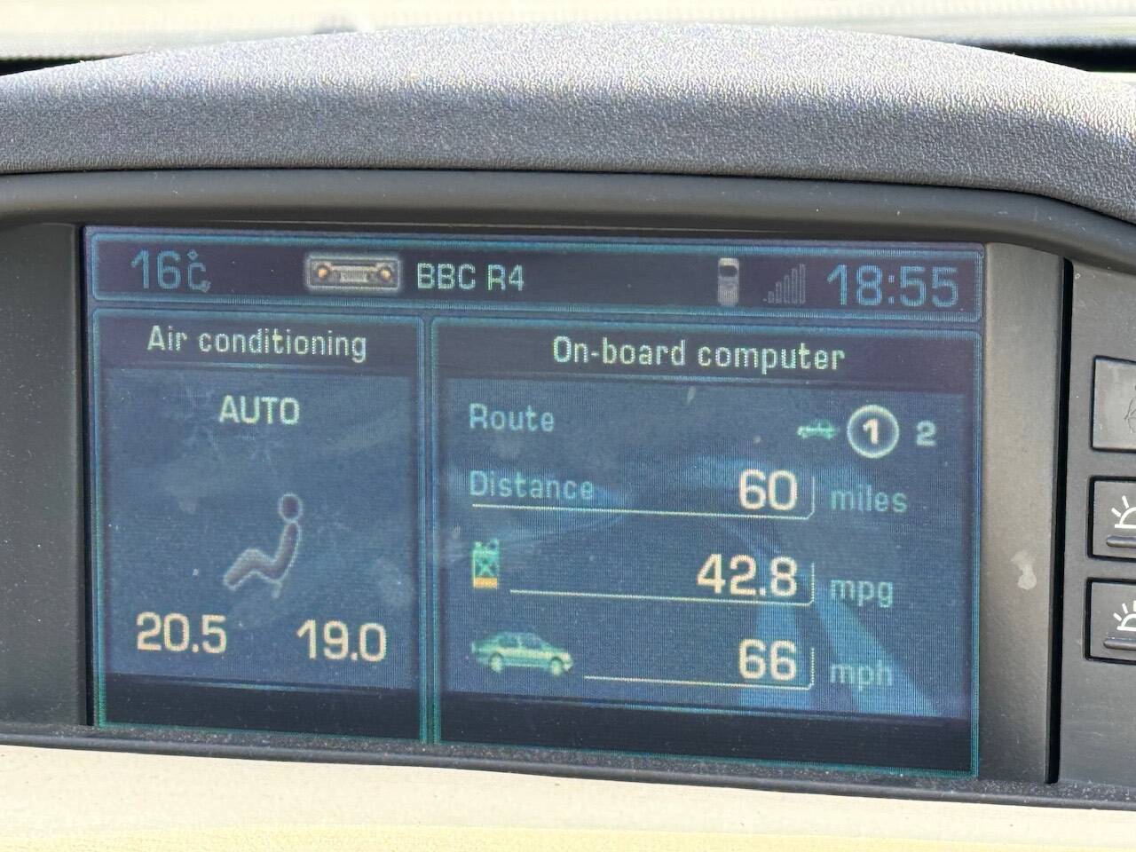

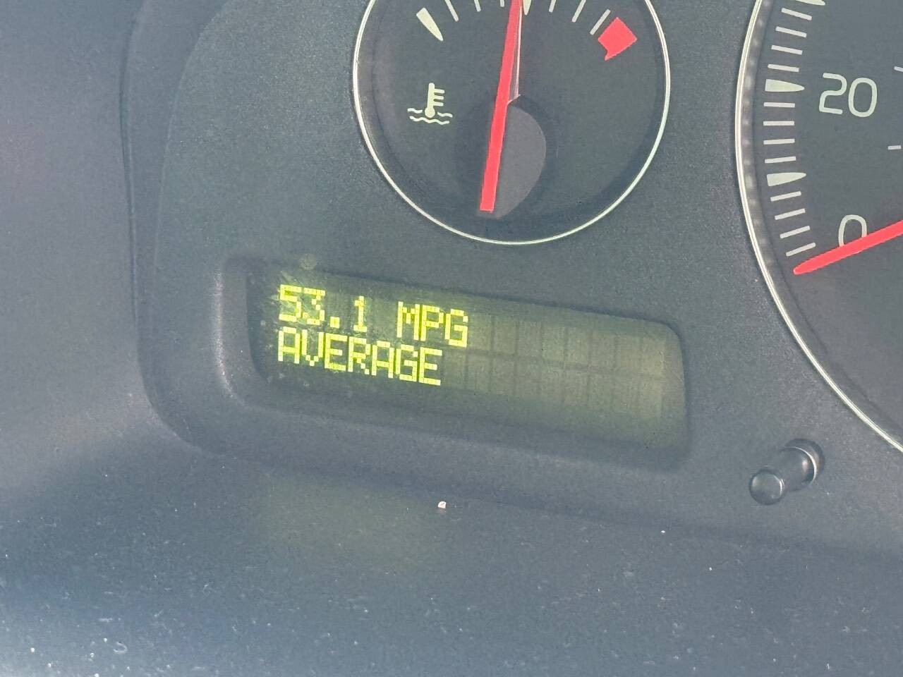

Overtake something. Giggle at the spoiler playing oeek-a-boo in the rear view mirror. Reset the trip computer at Washington services. It's doing 42 ish mpg; my brand-new one returned 43.5 on proper tyres and less than 20,000 miles of wear. The engine sounds a little muted, slightly off-beat compared with my memory of it, but pulls well and doesn't make any noises that sound too scary. I wonder if the Eolys bottle needs refilling to wake up a DPF regen or something. In heavy traffic the gearbox seemed to remain happy, no clunks or weirdness, which is reassuring.
No lane warning, no cruise control, and of course a mad flashing angry handbrake sign. But i have a Lexia cable, so let's see what I can find out when I get the software working.
It took longer to get home than it ever should have, but I still felt relaxed and in a good mood. This is what I liked about my old C6. I can see that while it's a bit dirty (black cars) and wearing 160,000 miles, it's still a pretty straight old bus. Except that bumper trim. I have no idea what lies beneath, and perhaps it's best not to care too much - just enjoy it as-is for a while.

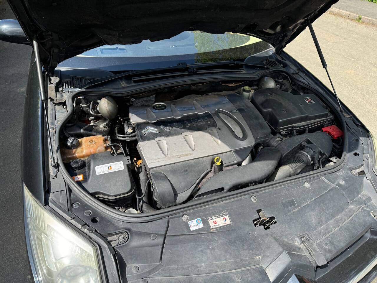

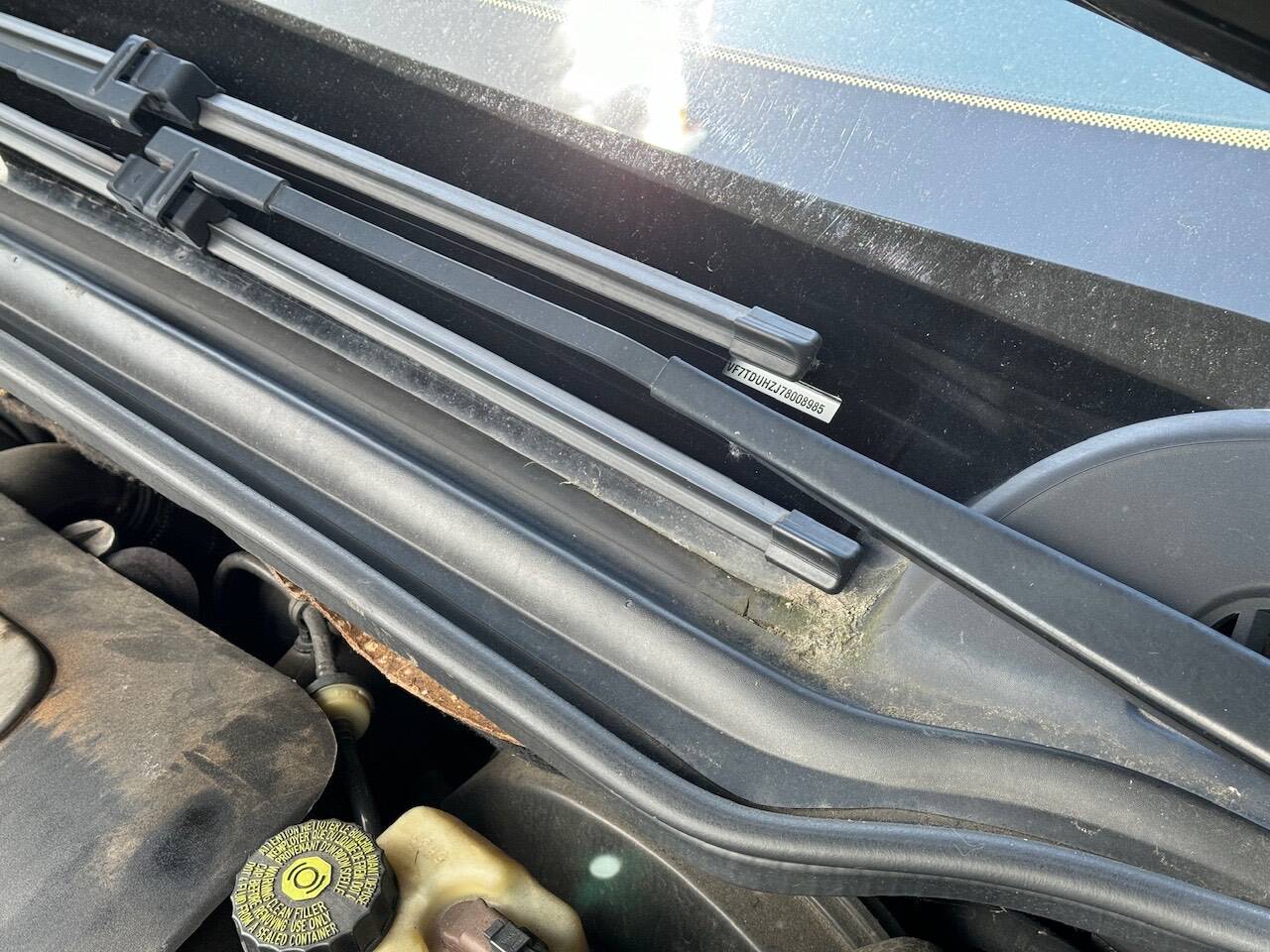

A bit grim under here
A nest of wipers

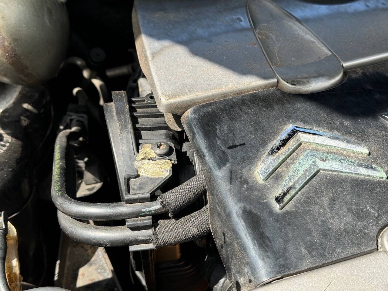

1.50 part with unsightly glue because PSA probably bought from the OEM 1 more than they made cars, and burned the blueprints 0.001 seconds after the tenth anniversary of the last car being made...
Just count yourself lucky I replaced the borked coolant pipe and thermostat housing that were also being held together with that same glue.
How on earth did they manage that? Why?!
