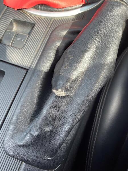

Next: retrim an armrest in...
Cork.
I am not sure how best to achieve this but I want to bring in an element from modern Mazdas that recalls a bit of Mazda's history and origin as a cork manufacturer... MX-30s and CX-60s have little bits of cork detail on the consoles and dashboard, it's sealed in a kind of resin.

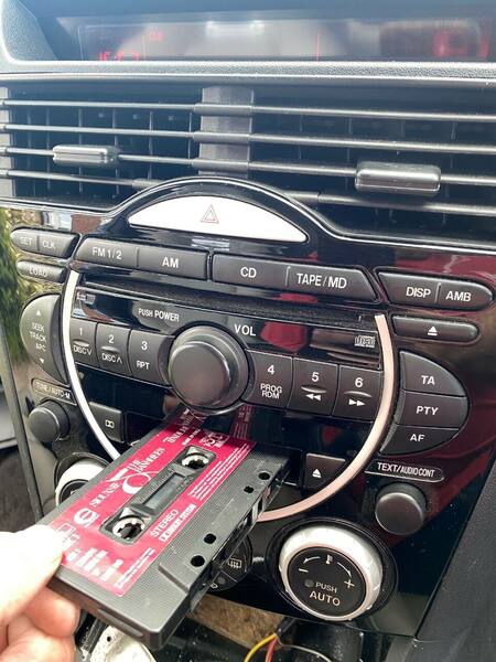

And the radio appeared:
Yeay!
Still not fully reassembled because the ashtray was foul - an unused-looking replacement on the way then I can click it all back together.

This would be an interesting one.
I'm guessing you must be able to buy cork in thin sheets which could be cut to shape and bonded down to the carrier... but how on earth do you stop it breaking up around the corners of the trim?

Well, that's what I wondered when Mazda announced cork as a trim on the MX-30. What they've done is made it into a sealed and bonded lacquered veneer, it doesn't have the same texture as unfinished cork. Assuming you can get lacquers that remain flexible that's my first port of call.
I'm also thinking I can simplify this by sticking to say, a stripe on the armrest rather than a full armrest...

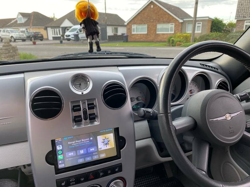

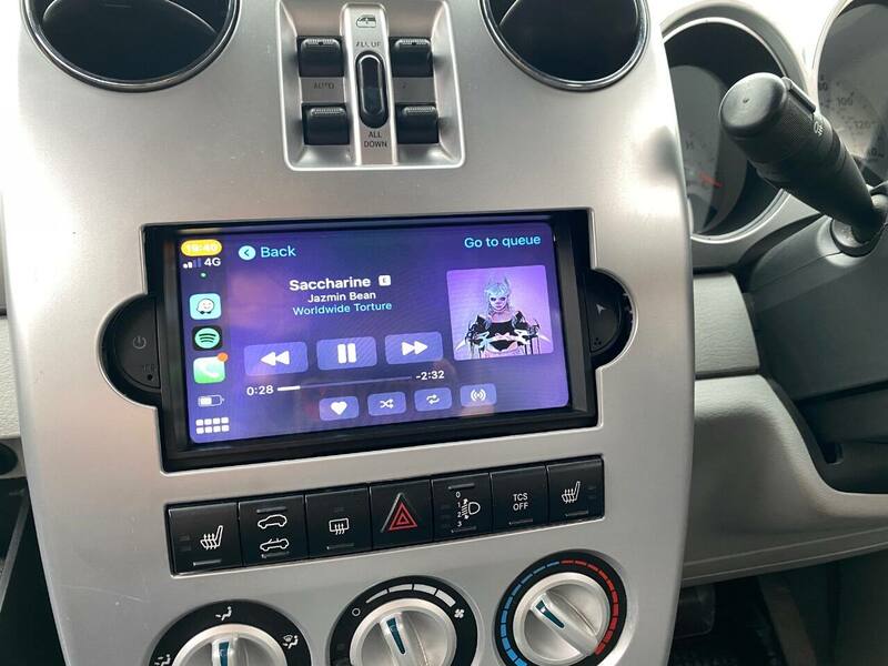

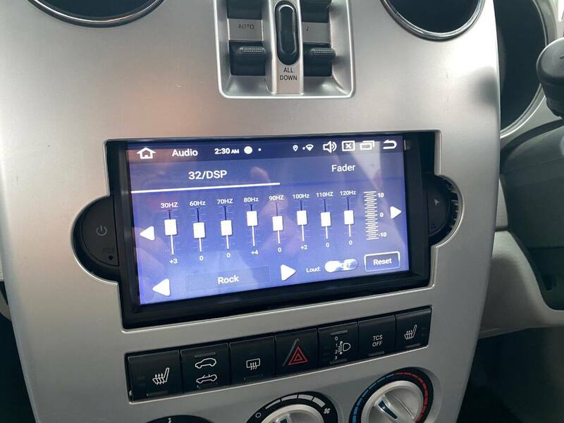

Ever wondered if those Android head units are any good?
It seems alright so far but one speaker on the car is duff and there was no adaptor for the antenna, so I had to order one and wait to reassemble the dash.
Wireless CarPlay! And it worked first time.
I've yet to investigate fitting a reverse camera, but the hookup is CANbus and the first thing it did was tell me the door was open...

Radio went back - it crashed and powered off whenever reverse was selected, coming back on with a thump - that, and the lack of hardware/physical volume buttons spoiled the otherwise impressive first impressions 😕
  • Sad 1
They can be a bit hit and miss. I've got an Xtrons one and an Eonon one. The latter is much slicker and bigger/better display but sometimes cuts out sound.

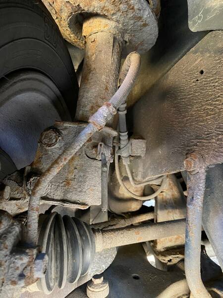

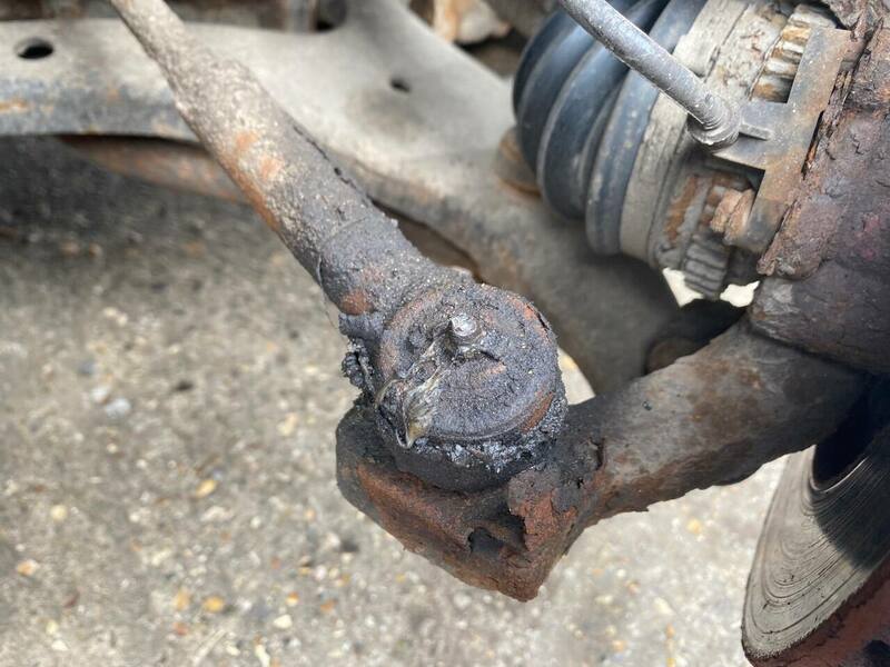

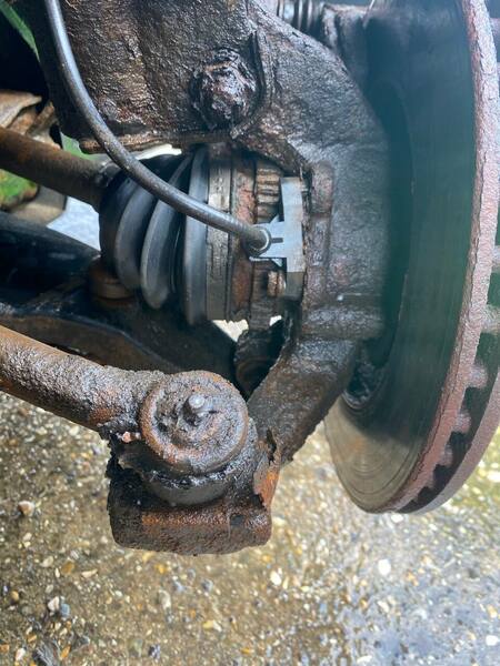

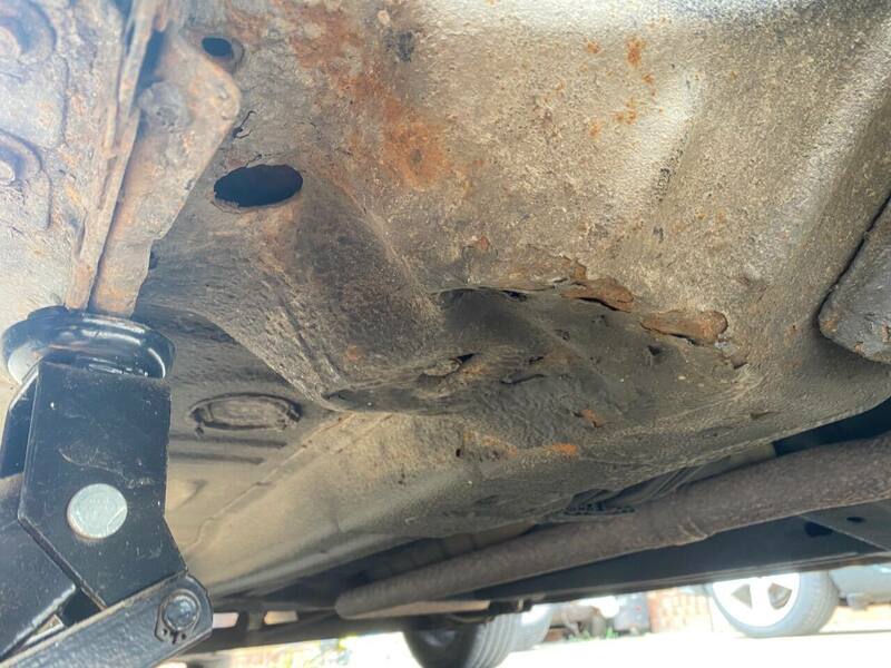

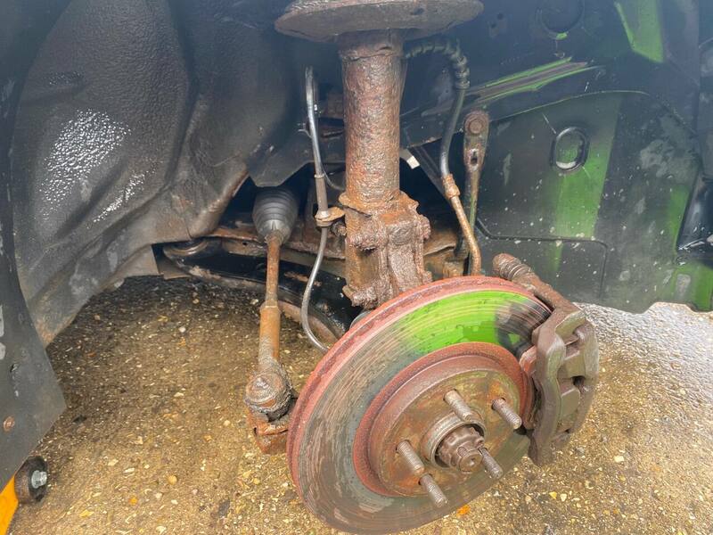

The state of it. I think hammering the rust and crap off the caliper has helped but this isn't pretty.
And what is it with people not jacking cars up properly, and then doing nothing to remedy the damage?! I hate the state of the motor trade in this country.

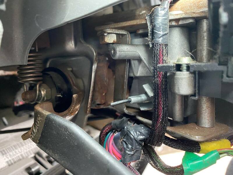

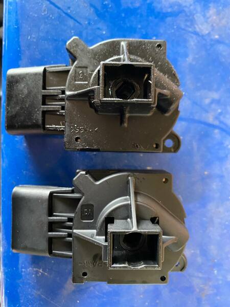

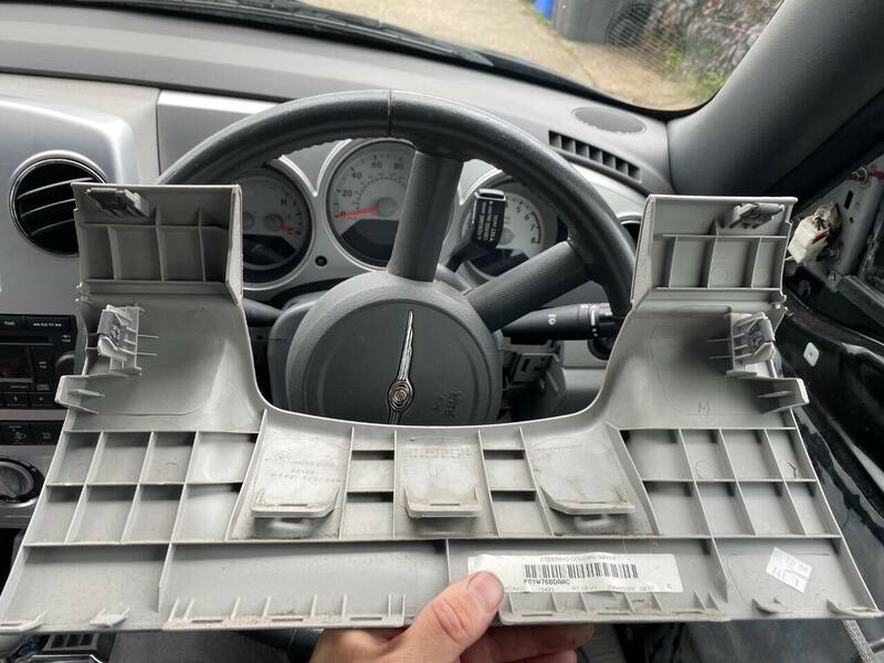

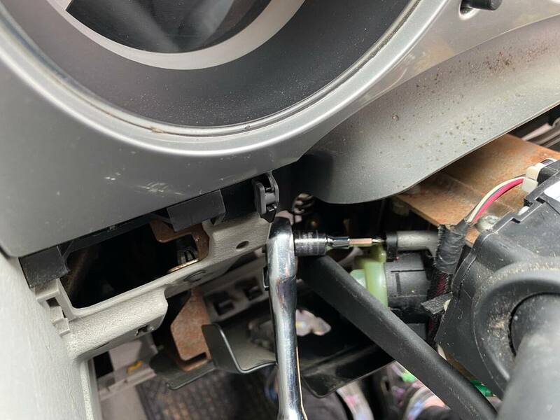

Ignition switch. I actually did this quickly once I'd sussed out the dash panel. The wheel adjustment lever blocks the switch, the attempt to fit the new one with the ridiculous access snapped the extension stick which activates the key-in chime.
Upside. No more relentless chime when door is open, it still chimes if ignition is on.

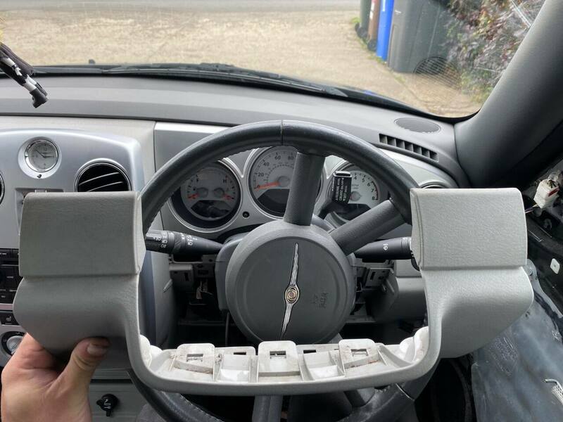

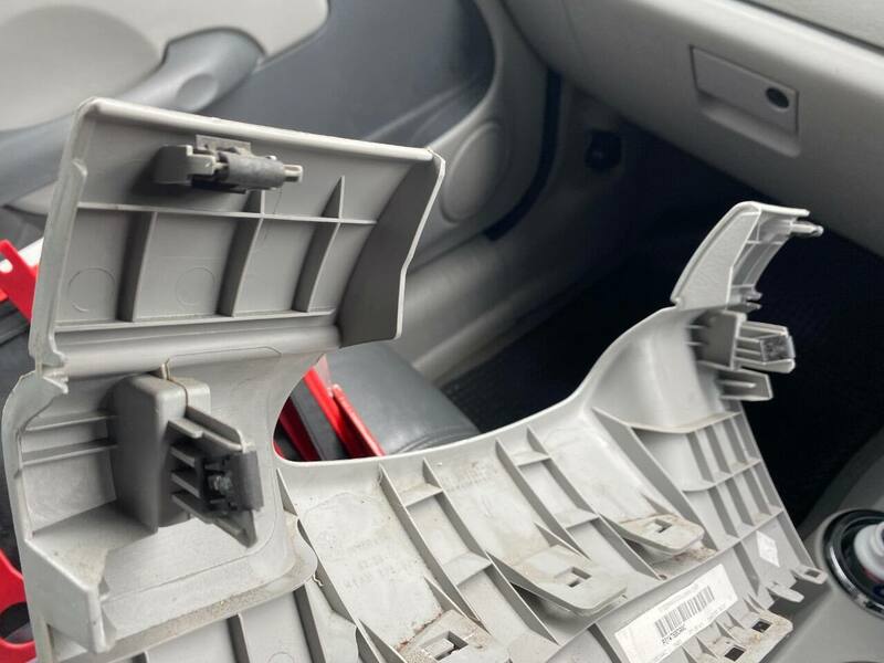

This panel is a bastard.
To remove the lower driver's side dash panel on a Mk 2 PT Cruiser...
Pull forward at the top to disengage these four metal clips below the instruments and either side of the column.
Reach through the steering column space and push the three plastic tabs in the middle down to disengage the panel.
Then remove the column shroud and you have clearance for a T2.0 security bit and some means of turning it...
Then pull the switch away. The stick poking out of the actuator is the key in lock chime pokey-bit. It snaps off easily.
Old and new switches but you can't see the worn old one.

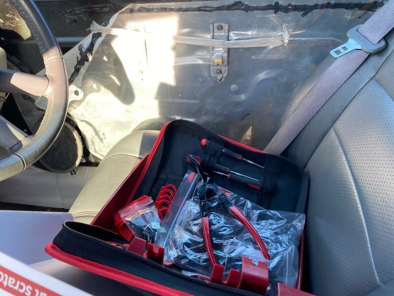

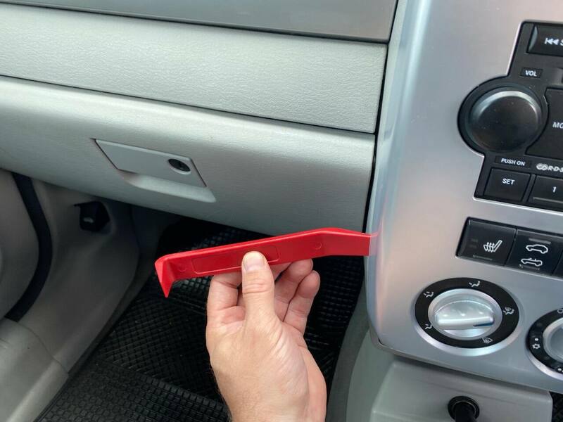

Trim removal tools are useful.

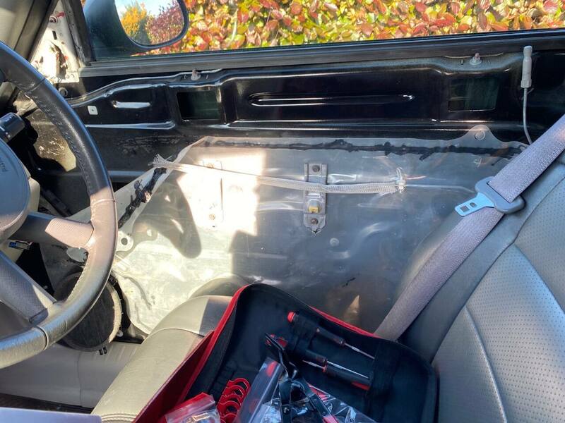

Window rattle: worn guides, worn weatherseal. Nowt I can do. But the speaker's bust on this side.

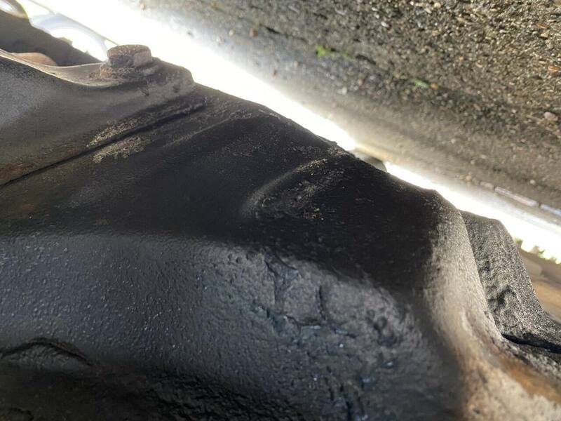

Washed, brushed, jenolited, Hammerite undersealed over the bit where some asshat jacked the wrong part.

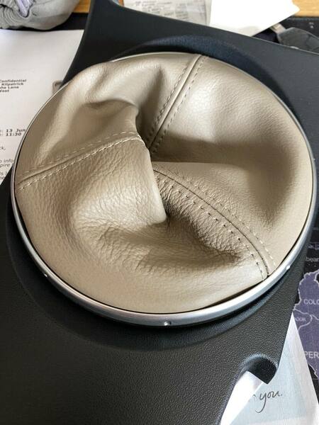

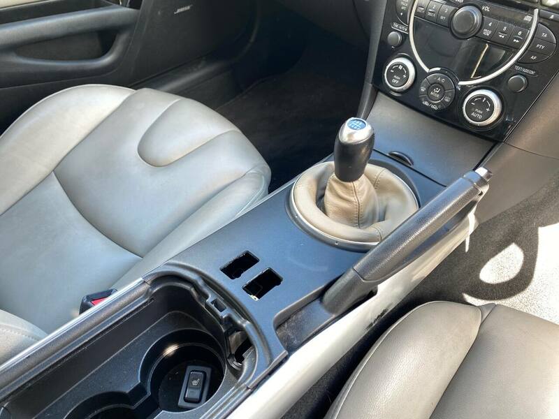

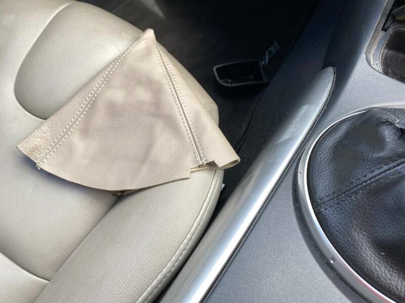

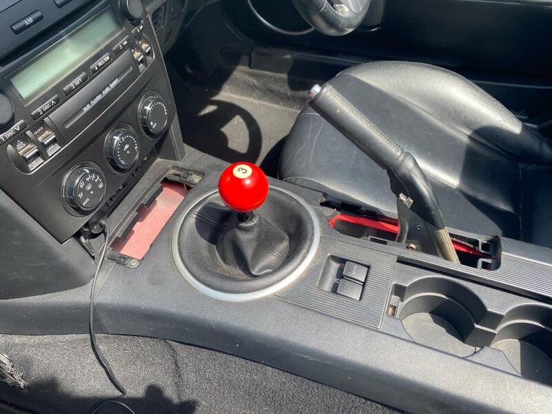

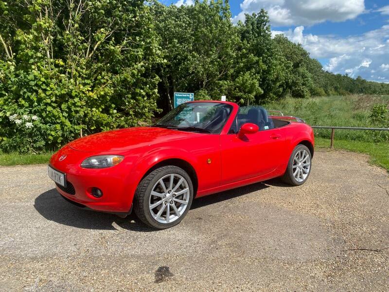

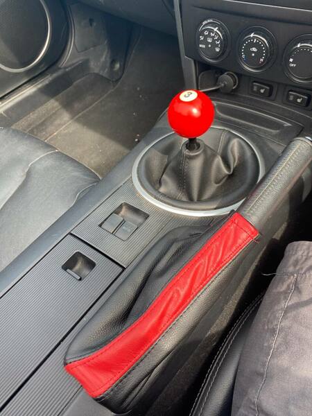

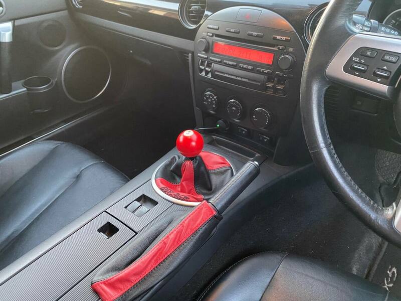

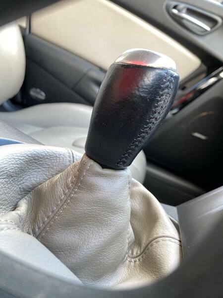

Need to drive this more:

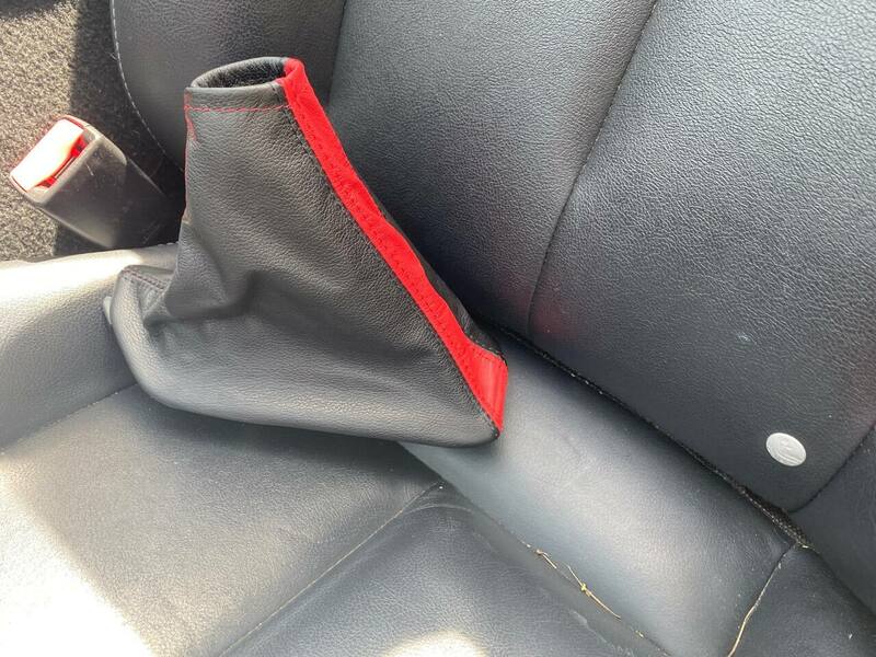

The cream gaiter really does complement the look.

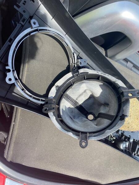

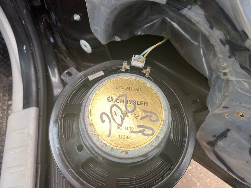

Android head unit returned, blown speaker discovered (actually rusted solid). Tried some £29 Kenwood 16.5cm (6 3/4") components, sounded /awful/... so got creative on the eBay searches based on adaptor ring compatibility lists.
A replacement from a Jeep Cherokee rear door!
But look!
Cor! Infinity! Bought the matching side for the passenger door. Bass is better but I think the crossover for the dash tweeter is the wrong spec so I'll probably end up replacing the dash speakers with infinity ones as well.
Then discover the rears can be upgraded with Jeep front 6x9s or similar hilarity, but they're a pig to get to.

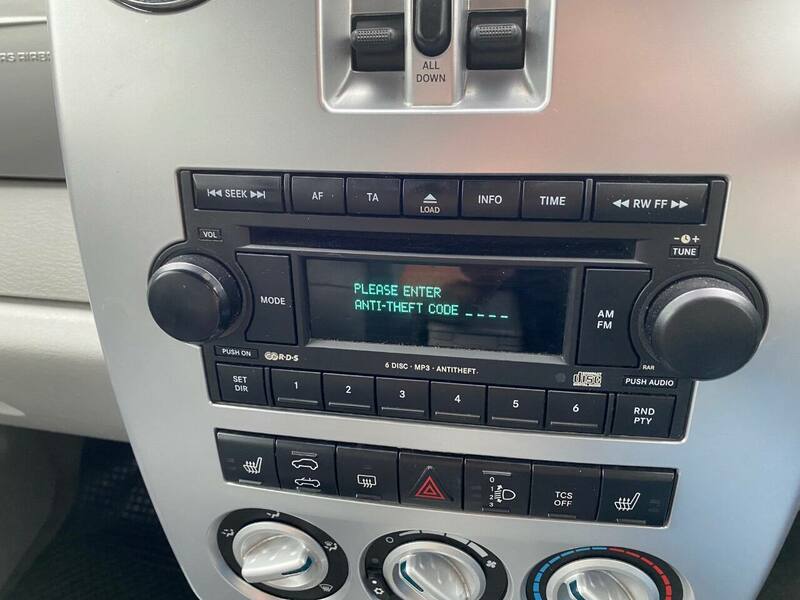

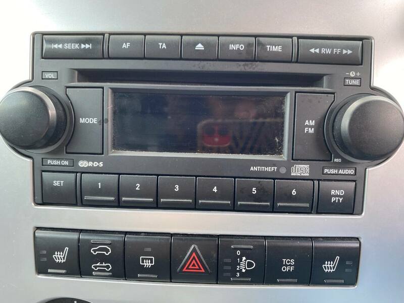

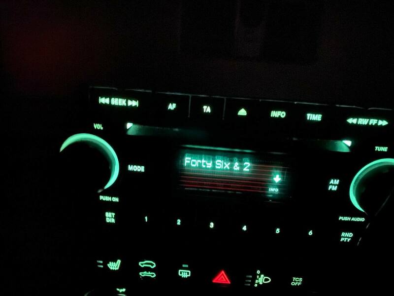

While searching - Cruisers didn't have many radio options. You got this:
Or a shitty satnav.
Jeeps use that shape of radio.
Small hitch. But it'll be worth it!
The CD changer made many noises when I powered it up. Wonder if the previous owner of the donor car left any music in it...

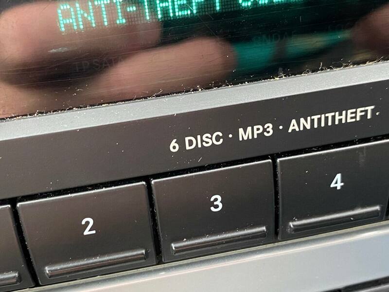

New head unit - six MP3 discs of glory!

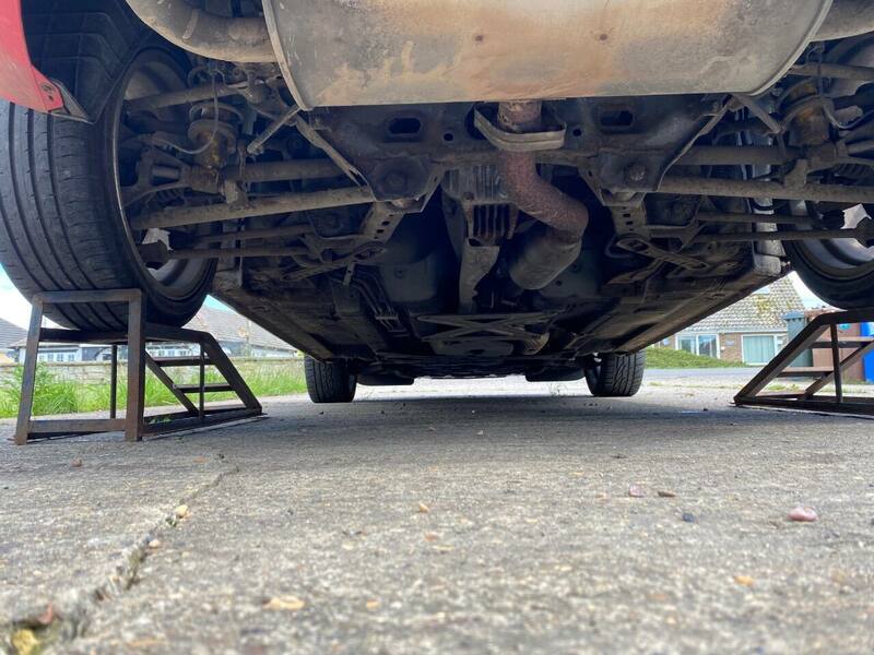

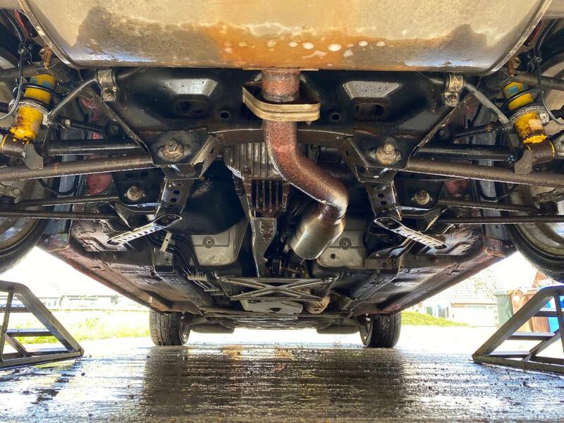

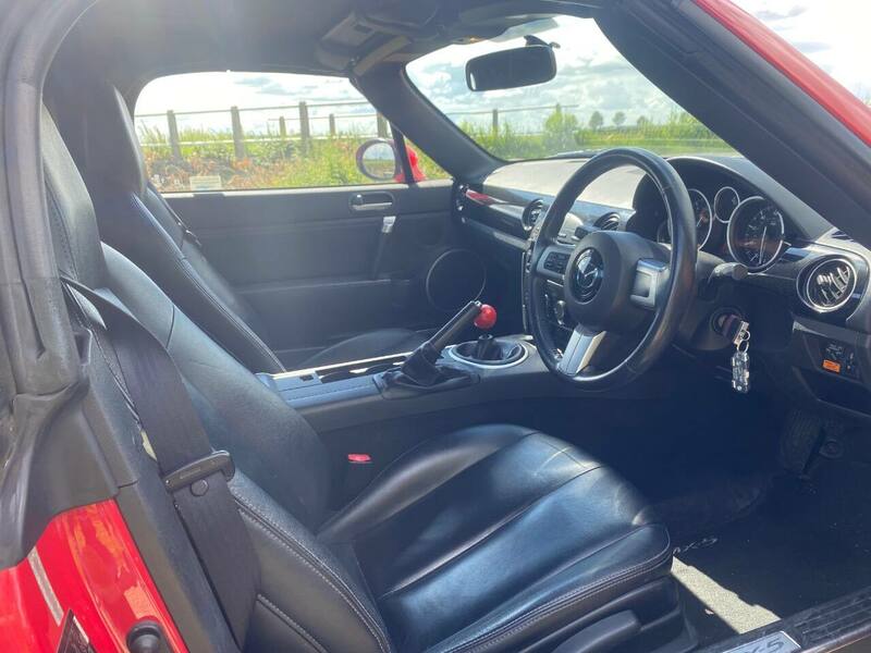

Now. How good /is/ my MX-5?
Before:
After:
That's a fair bit of dirt gone before the bike chain wax on the suspension treatment.

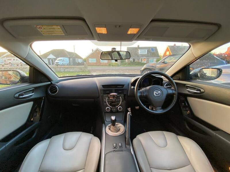

Stupid surgery. But I need it so, actually, hopeful I've less pain and will still be able to enjoy the RX-8.

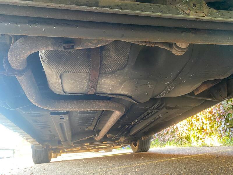

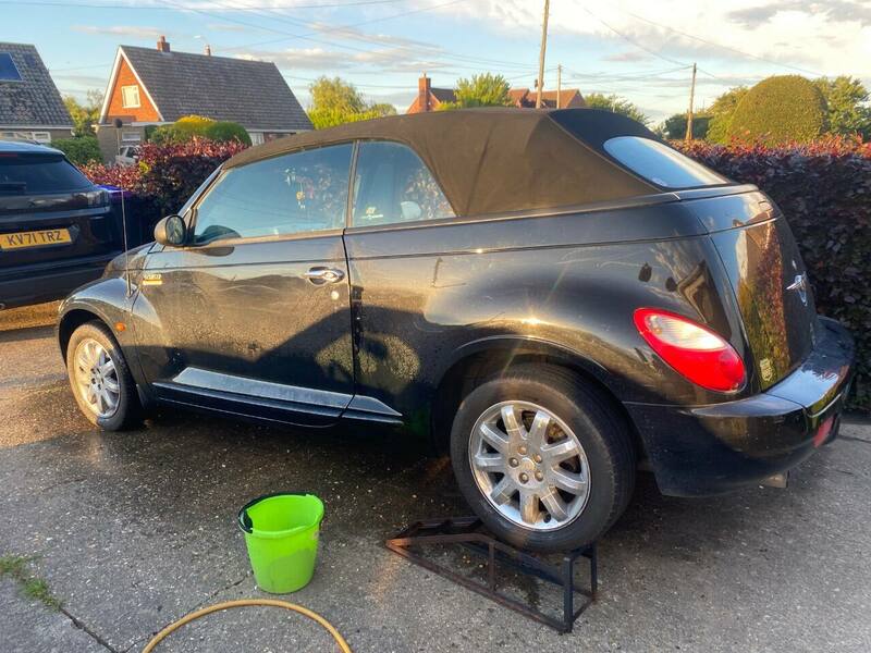

Since I'm playing with ramps, let's clean under the Cruiser.
It's not THAT bad, though I am pretty sure it's had a trip into a verge. Cracked bumper visible now the black wax has worn off, alignment out, damage to NS sill (shallow), damage to OS floor (bad jacking).
My instinct is the shitty garage repairs to free the sticking brake (smear copper grease ON THE BRAKE DISC) caused the car to pull violently to one side and that spooked the owner for the final time.
Same age as the MX-5. Definitely not the same condition.

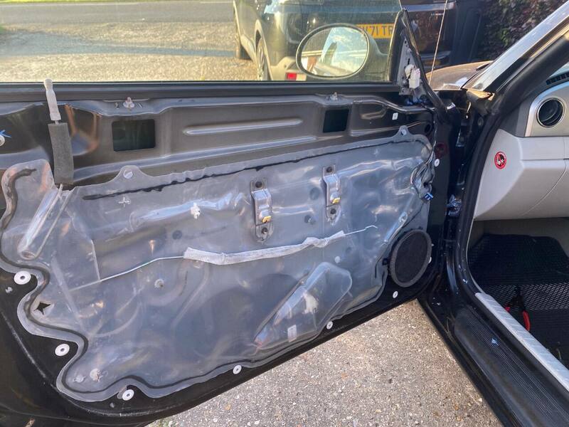

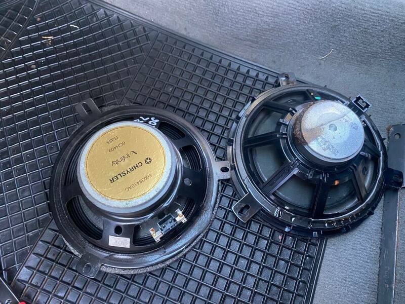

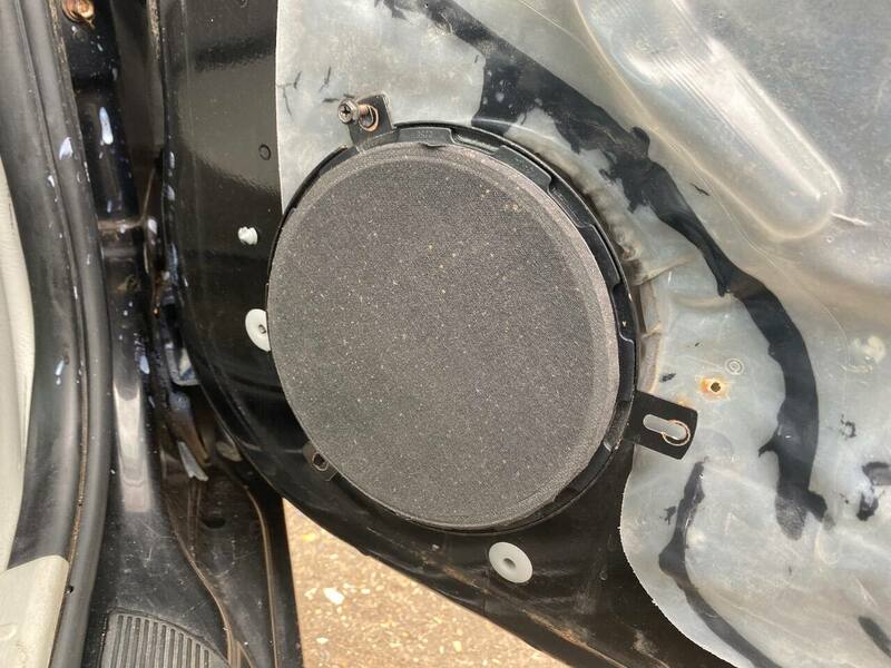

The other speaker showed up. Door trim off, 2 minutes.
Okay, not just a metal basket, there are A FEW differences. Look at the size of the magnet!
It's not dynamatted or owt and the rear speakers are now comedically bad, but actually a pretty worthwhile upgrade.

We're missing a resident there, and it does get occasional poking. The Tavria's going to go, as will the MX-5, but the RX-8 remains in the hope that I do make a proper recovery from surgery. RX-8 now = Capri when I was 27. Ford should always have made a new Capri based on the RX-8 platform with MX-5 engine.

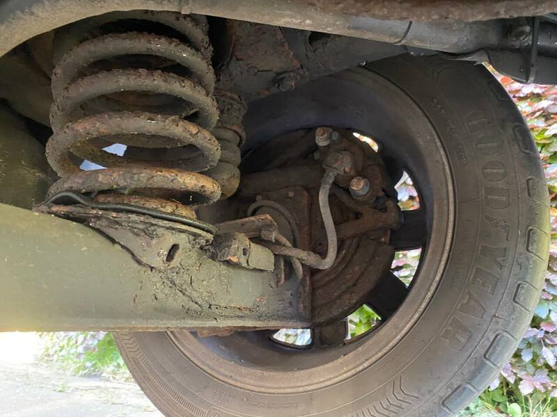

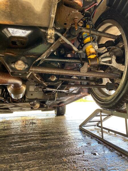

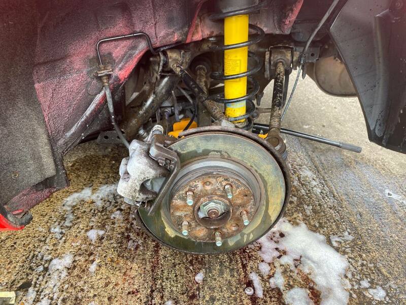

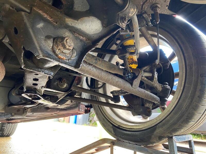

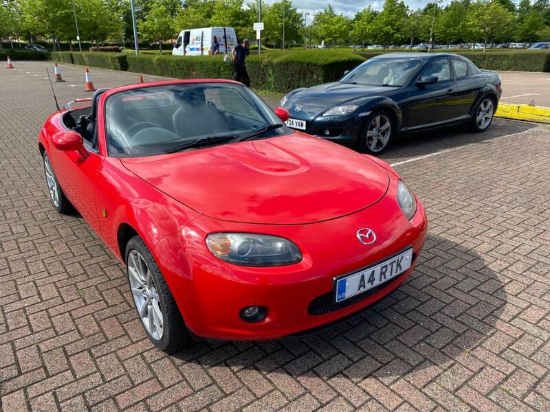

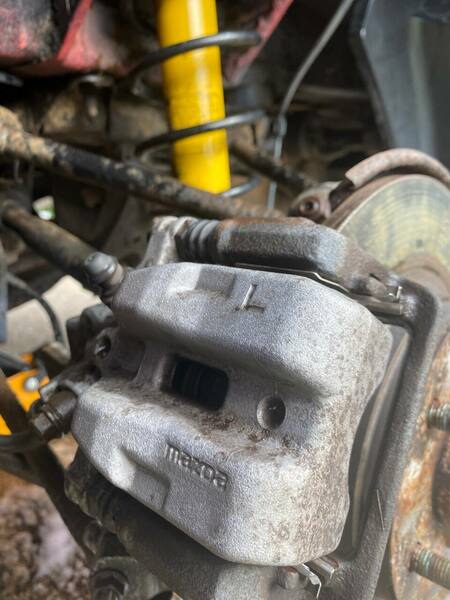

Last weekend enjoying this, so spent the afternoon messing about with it after investigating the state of the rear knuckle/hub carrier.
It's weird seeing springs/dampers - original Bilstein as this is a Sport - looking like this after 104,700 miles.
I seem to remember the brakes being a recent job in the history.

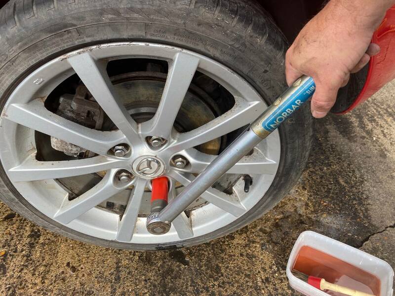

Cleaned the back of the wheel with the Bilt Hamber purple smelly spray and wheel back on, trusty torque wrench and a new 21mm wheel nut socket 'cause it turns out I only had 17 and 19 and I don't like incomplete sets (plus it was on sale).
