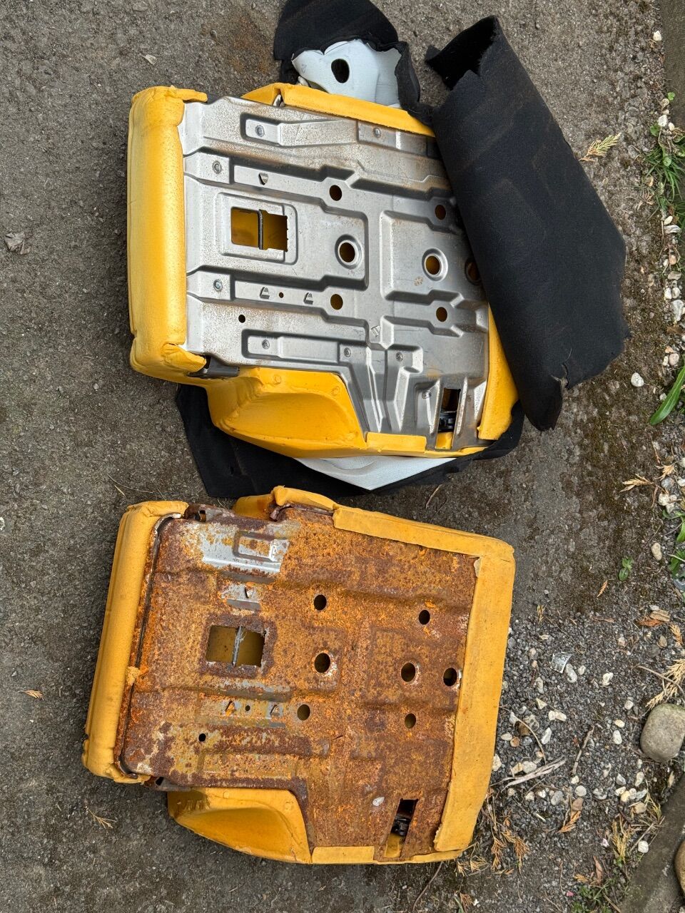

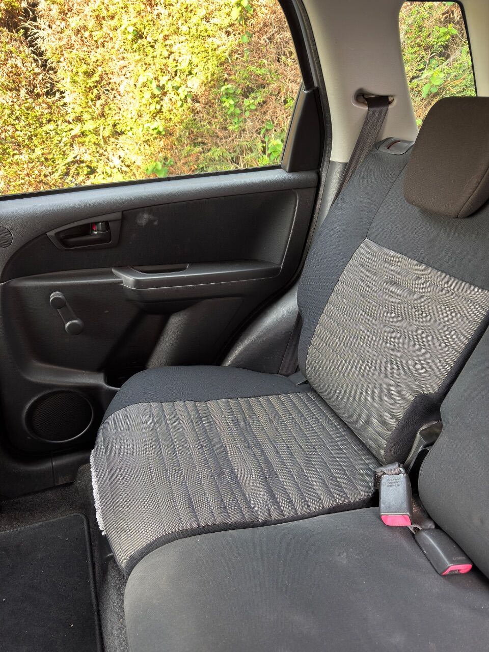

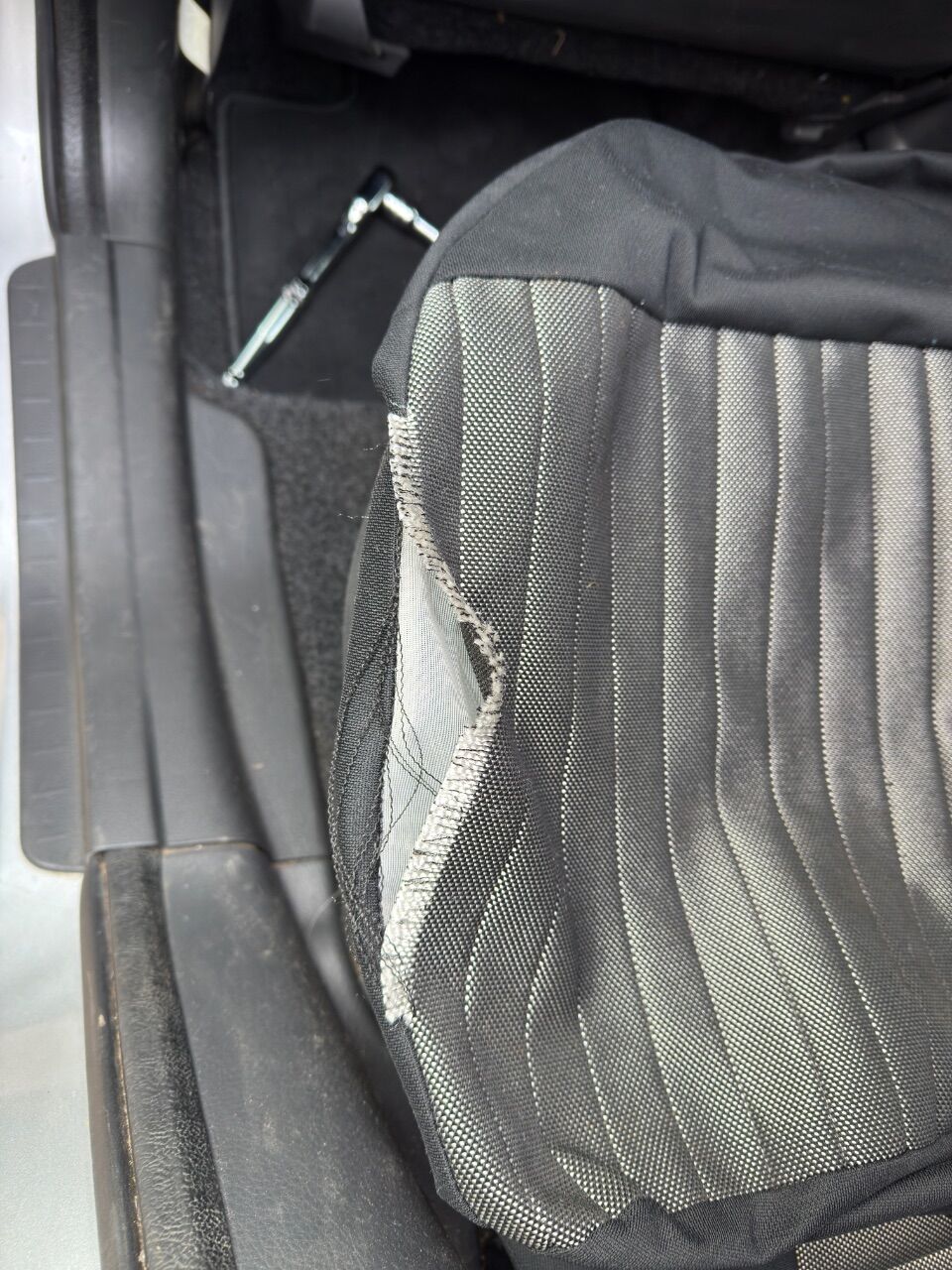

I couldn't refit that seat back - it's disgustingly rusted - so I've stripped the cover to wash, and dismantled all the plastics and things to effectively retrim the original seat frame.
Really can't believe this guy got the seats from the car he's breaking and just decided to keep the money and sell them instead of saying they were no good.

Seriously, replacing four seat covers base and back, rebuilding frames, everything involved. Ugh.

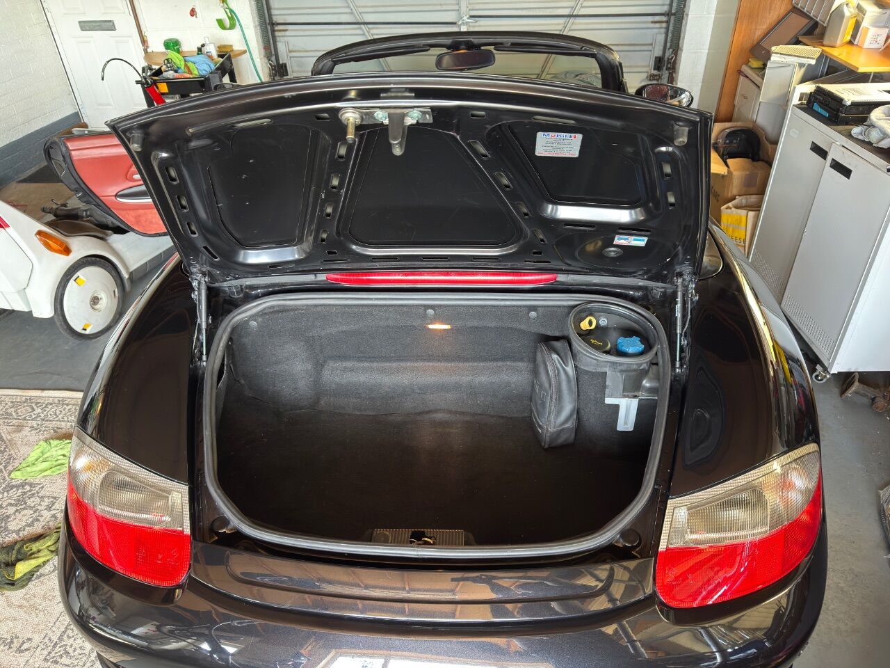

And finally vacuum the boot
It is such a nice shape
And that interior
Does make quite a difference.

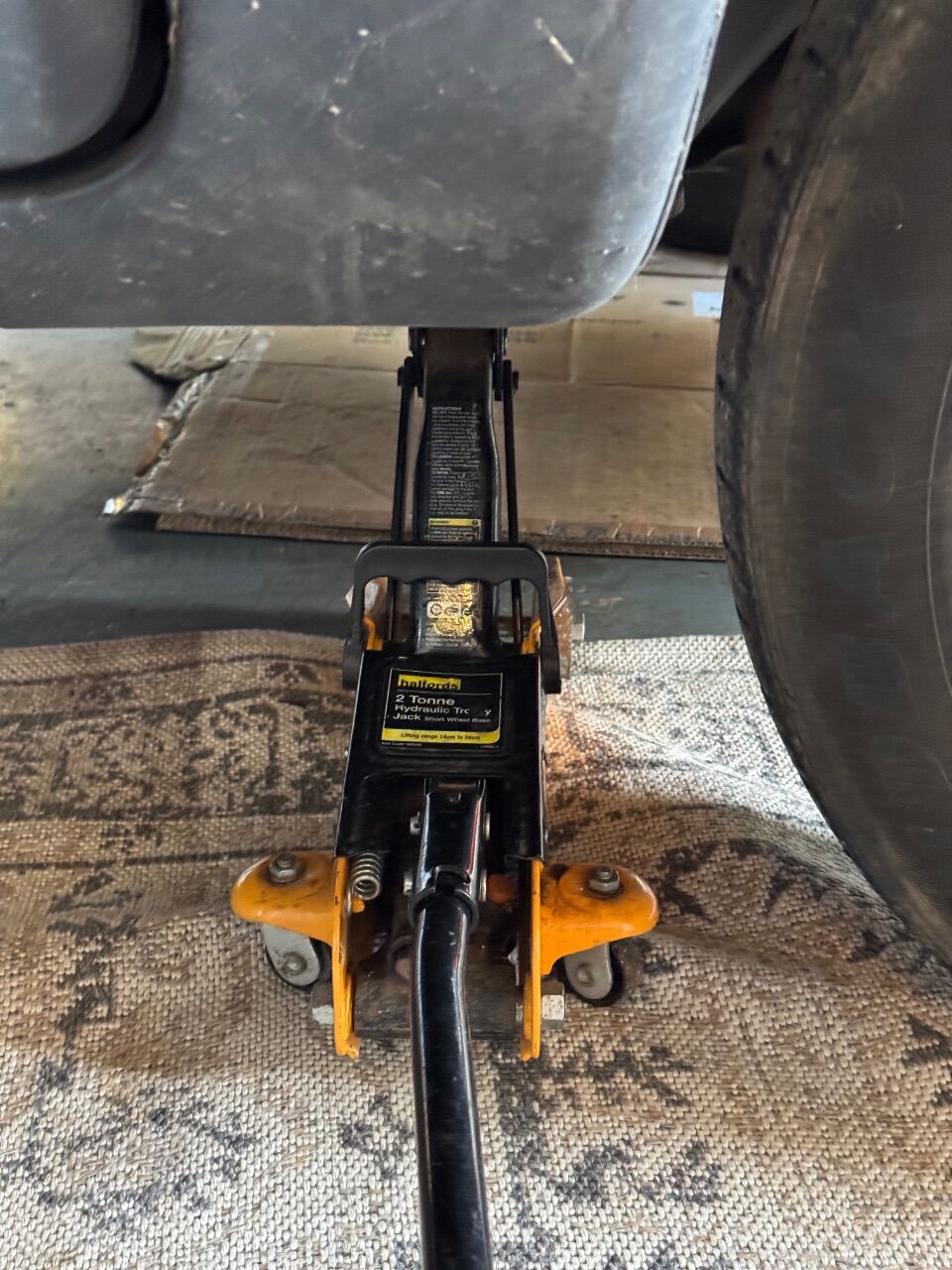

Which is currently the garage since I need A Tool to deal with the wheelbearings.

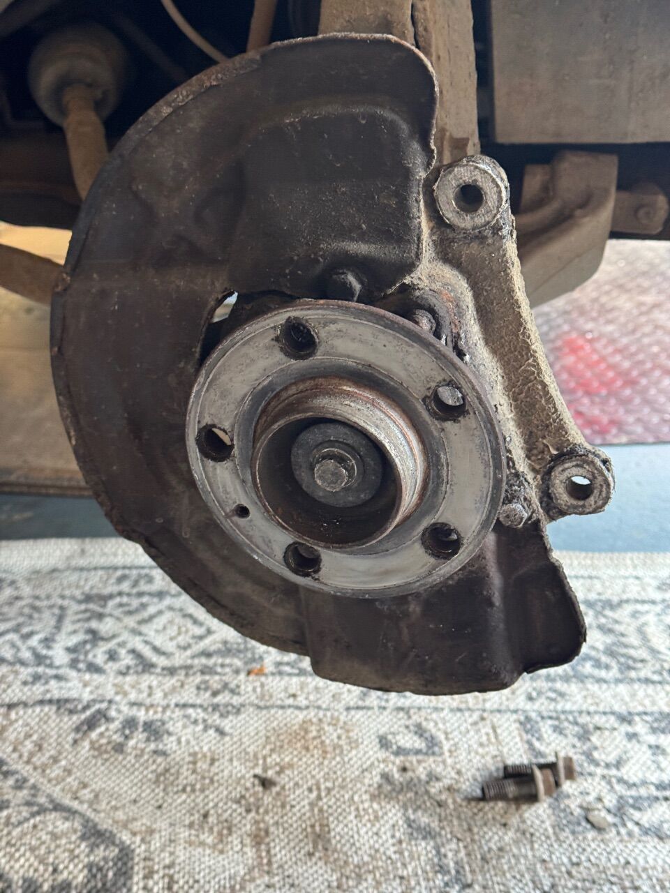

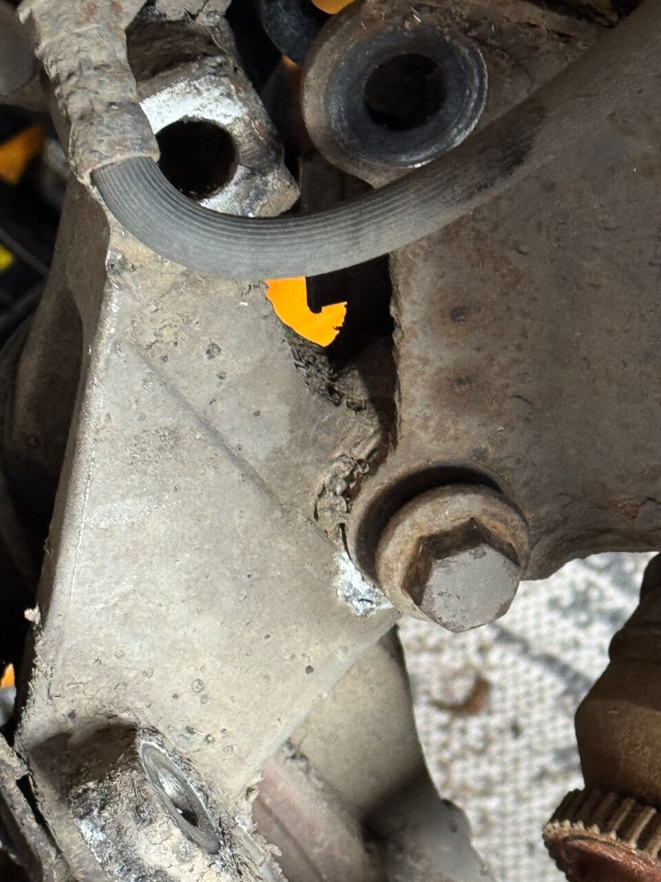

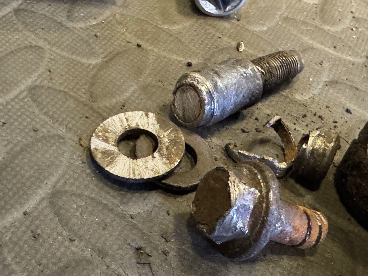

Right, so, Volvo XC70 P2 front wheel bearing. It's a module one so doesn't need a press or other shenanigans to change, but that doesn't mean Volvo want it to be easy.
Removing the caliper and disc is straightforward enough - I just undid the two caliper bolts and tied it up on the coil spring. But the bolts securing the hub unit are fed from behind and recessed/obscured by the driveshaft, so the driveshaft has to come out.

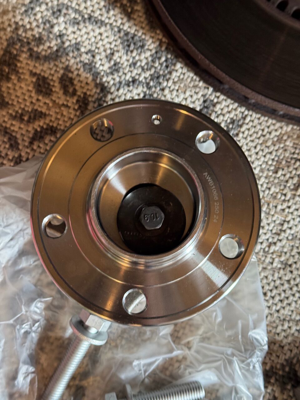

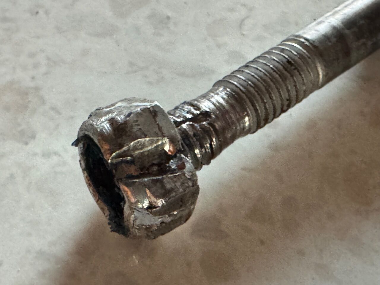

The new unit came with new stretch bolt for this task, and it has 13mm. 13mm didn't fit the original, but when I put the 14mm on the impact driver, I got a chewed up bolt in return. I should have persevered with the 13mm perhaps.
The chewed up bolt was dealt with by ordering this from Amazon: Thinkwork 32-piece impact bolt extractor set (£45.99)
There are cheaper sets with fewer sizes, obviously I only needed one... but I like to be ready.
I already had the steering angled right to do the right wheel - since I was fairly sure this would help with driveshafts. It did. Undoing both strut bolts on @ruffgeezer's recommendation over undoing the balljoint a lot of places suggest, removing the upper bolt and letting the knuckle swing down and back on the steering link and lower bolt kept everything connected but allowed enough travel and flex in the driveshaft to push it out and angle it out of the way.
Which meant I could get the socket and impact gun on a short extension and spin out the four bolts. Removing the hub did not require a puller - I tried the clever approach of leaving the bolts in loose and hitting them with a hammer, then missed and hit my hand with the hammer, at which point I got annoyed and smacked the disc side of the hub outwards with said tool.
That broke the rusty bond and then it removed easily. Note that attaching a slide hammer to it did NOT achieve this, it needed a direct impact. PITA. Or hand. I've yet to managed to miss something I'm hitting with a hammer and hit my own arse with a mallet.
Yes, I wirebrushed outside and cleaned up inside the carrier before fitting the new bearing. Lots of rust flakes and lots of dirt got released during this process, a marked contrast from the engine bay.
The hero. You only buy tools like this when you REALLY need them, at which point you need them to work, and damn it, it worked. Once I got the old driveshaft bolt out it's clear it will work again, too, rather than having chewed up itself and become useless with one job. And yes, you need the impact gun, it's sort of pointless trying to turn it with a ratchet.
Reassembly is the reverse, as the HBOL says. Put wheel hub in, fit the four bolts, torque to 20Nm, then 45Nm + 60 degrees, refit the driveshaft (I cleaned the splines, I wonder if I should have put some grease on but there didn't appear to be any when I took them off), fit the driveshaft bolt, torque to 35Nm + 90 degrees. I couldn't transfer the washer over, but I'm not convinced the new washer has any rubber compound - it felt like just a thick washer. Refit the two strut bolts, torque to 105Nm + 90 degrees.
Fit brake disc, fit caliper (100Nm for the two bolts to hub carrier), put wheel back on, marvel at the number of creaking noises the car makes as the suspension settles,
A quick test drive suggests that the epic amount of wheelbearing noise was almost entirely down to this offside front one, so I'm not sure I need to do the nearside front after all - might do it anyway.

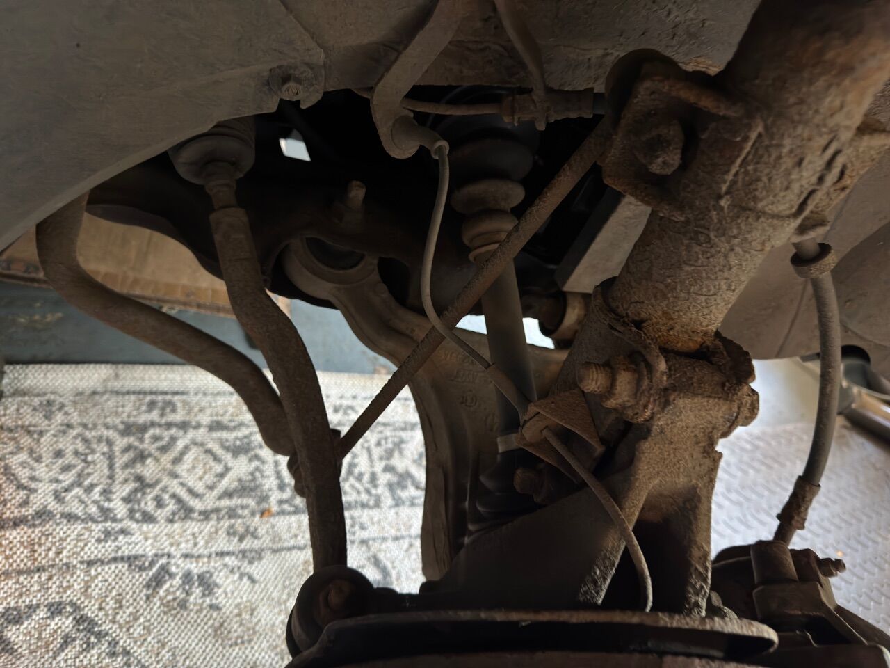

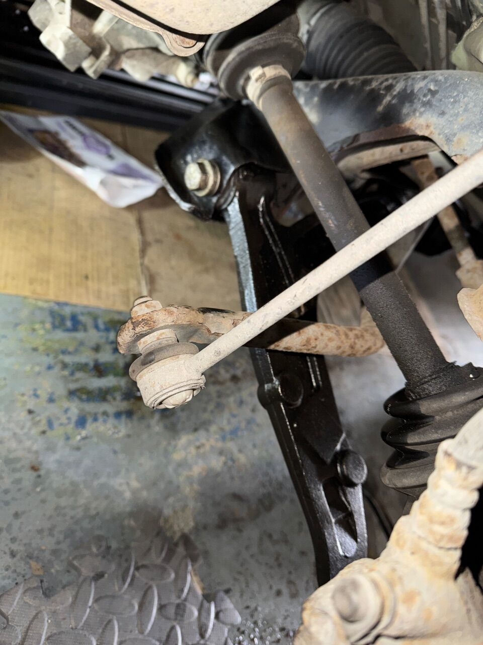

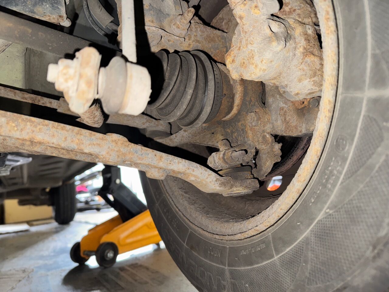

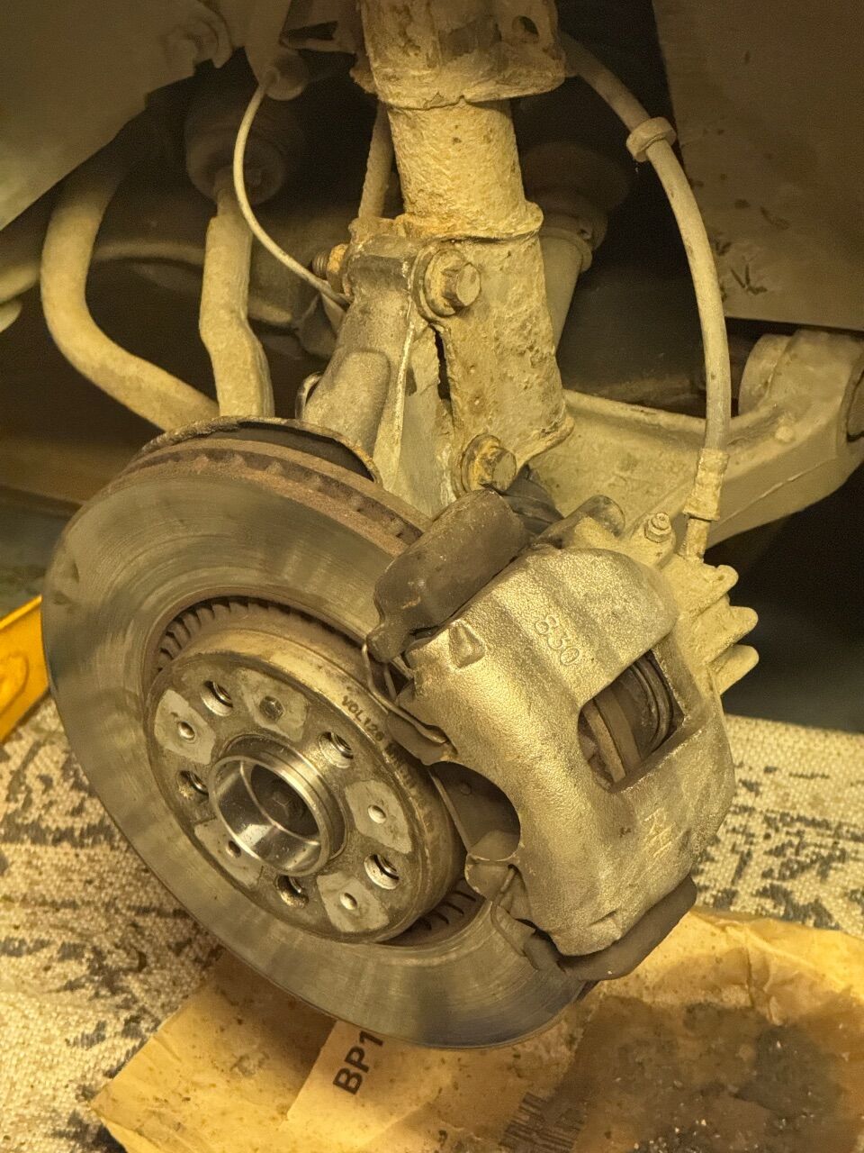

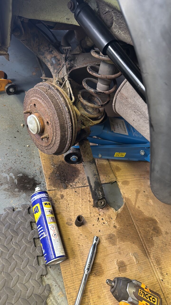

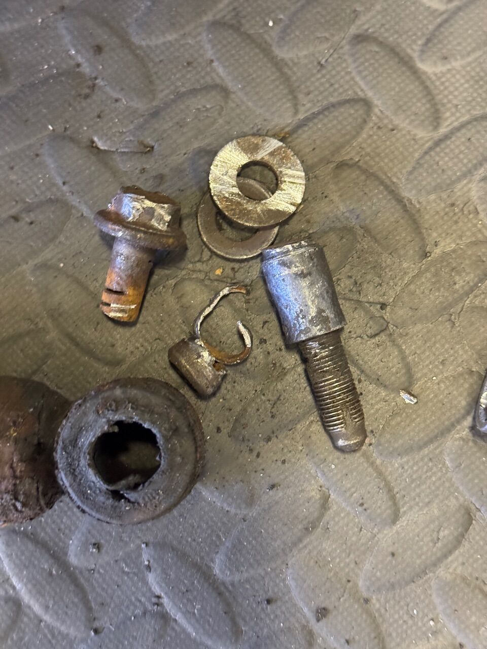

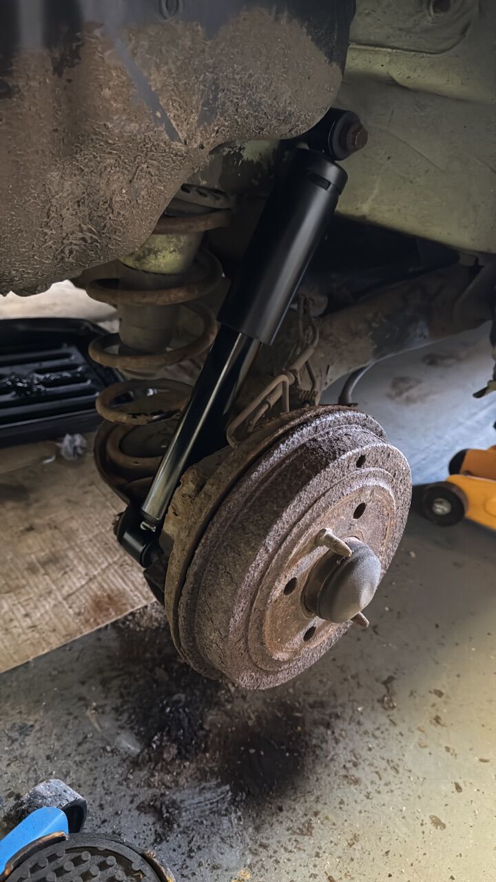

"Can you take it for MOT?"
Fails: rear shock, handbrake, front balljoint.

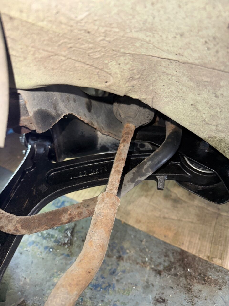

Shock - replace pair.
Bad one...
Easy.
Next!

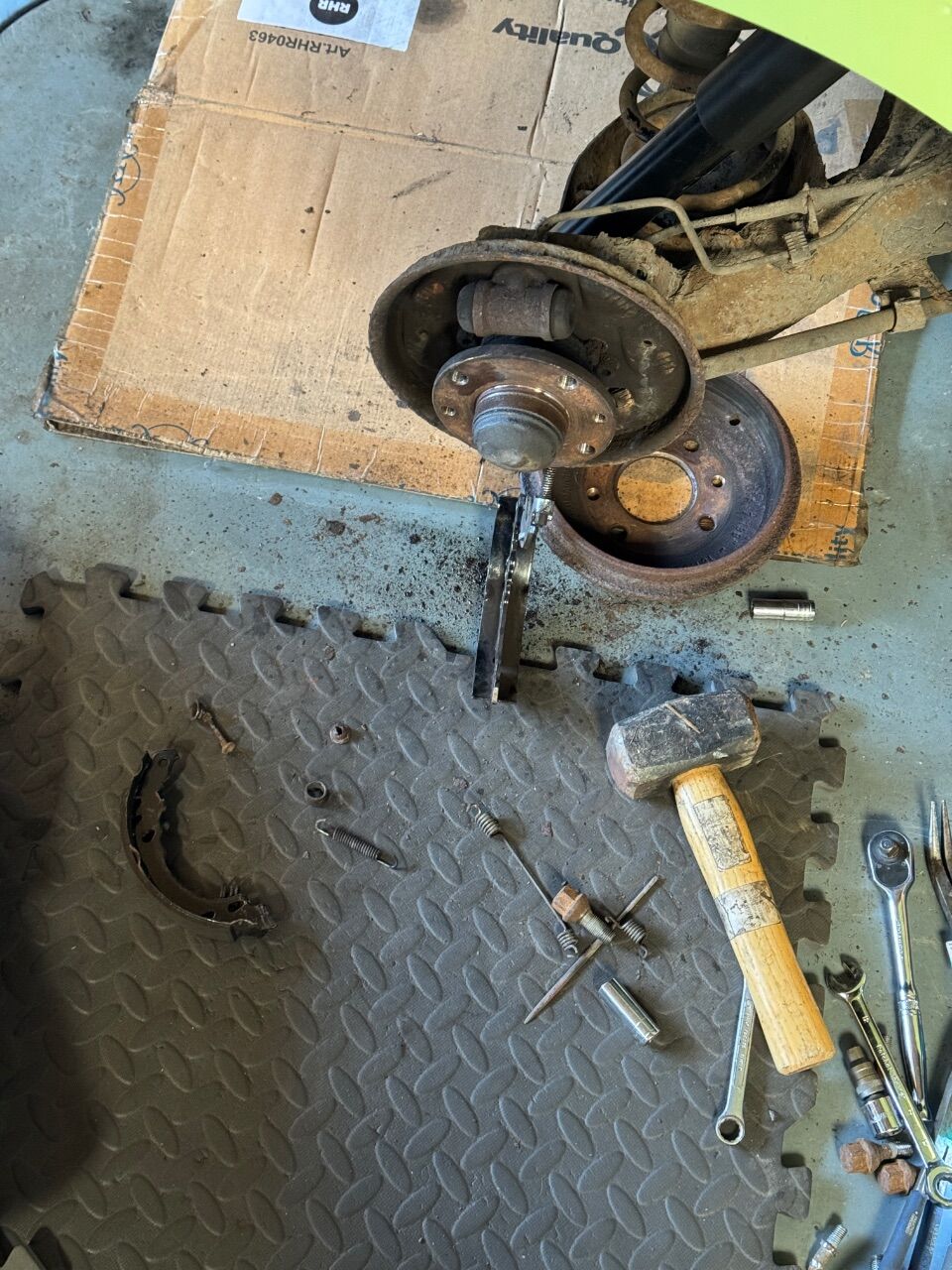

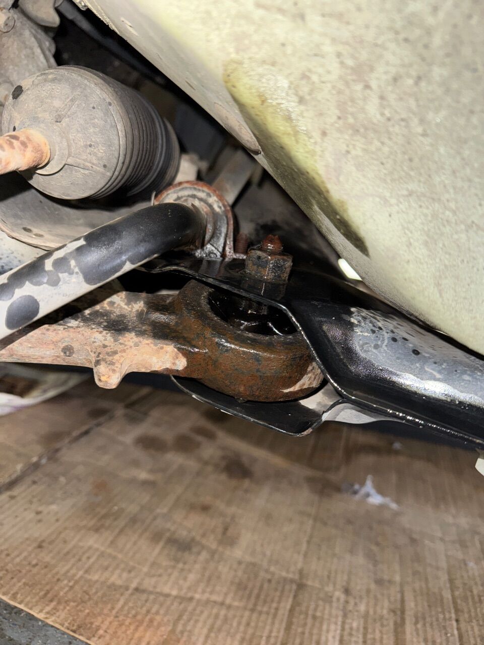

Sleeve rusted to lower bolt. FFS. I don't have angle grinder that can fit and operate safely.
Much swearing and hacksawing later.
Bastard.

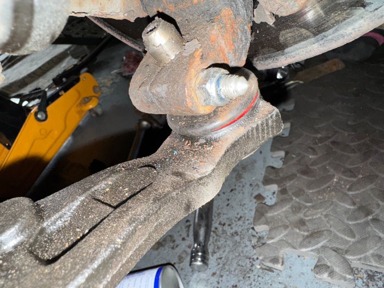

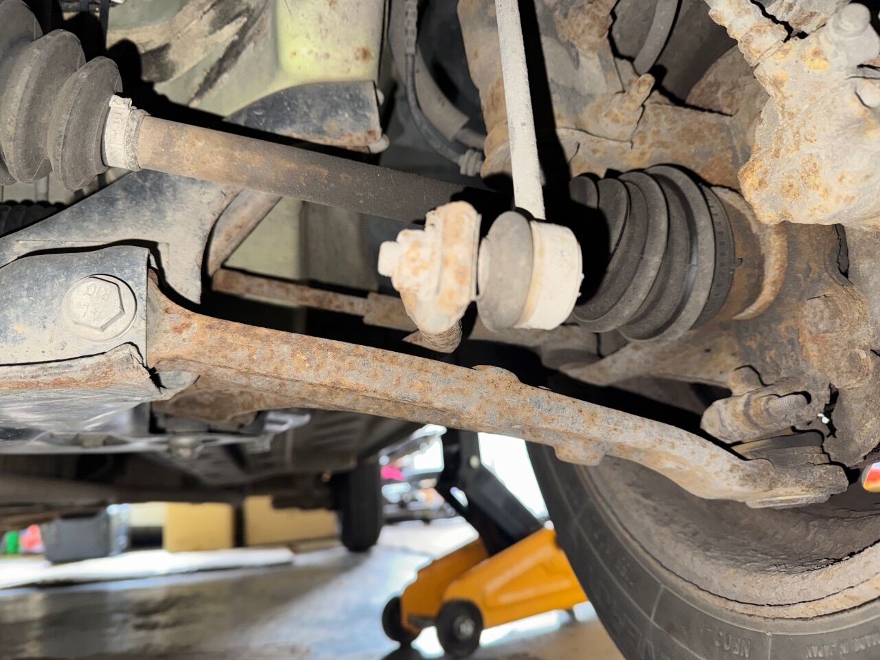

Okay. Balljoint. Now I have fear.
Hmm.
Wait. That doesn't look too rusty.
Prep.
Done! 20 minutes! Now to torque up the balljoint clamp.
Why is it not getting beyond a few torques?
Why won't it...
FFS...
Much swearing later. The new screw just stripped the threads with barely any torque. This is a Febi part, too!
Handbrake
I hate drum brakes.
Easy to fix though. The tab for the self adjuster was just... missing.
Phew.

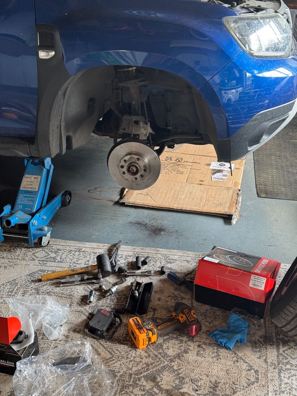

New discs and pads on a friend's Duster.
Easy except...

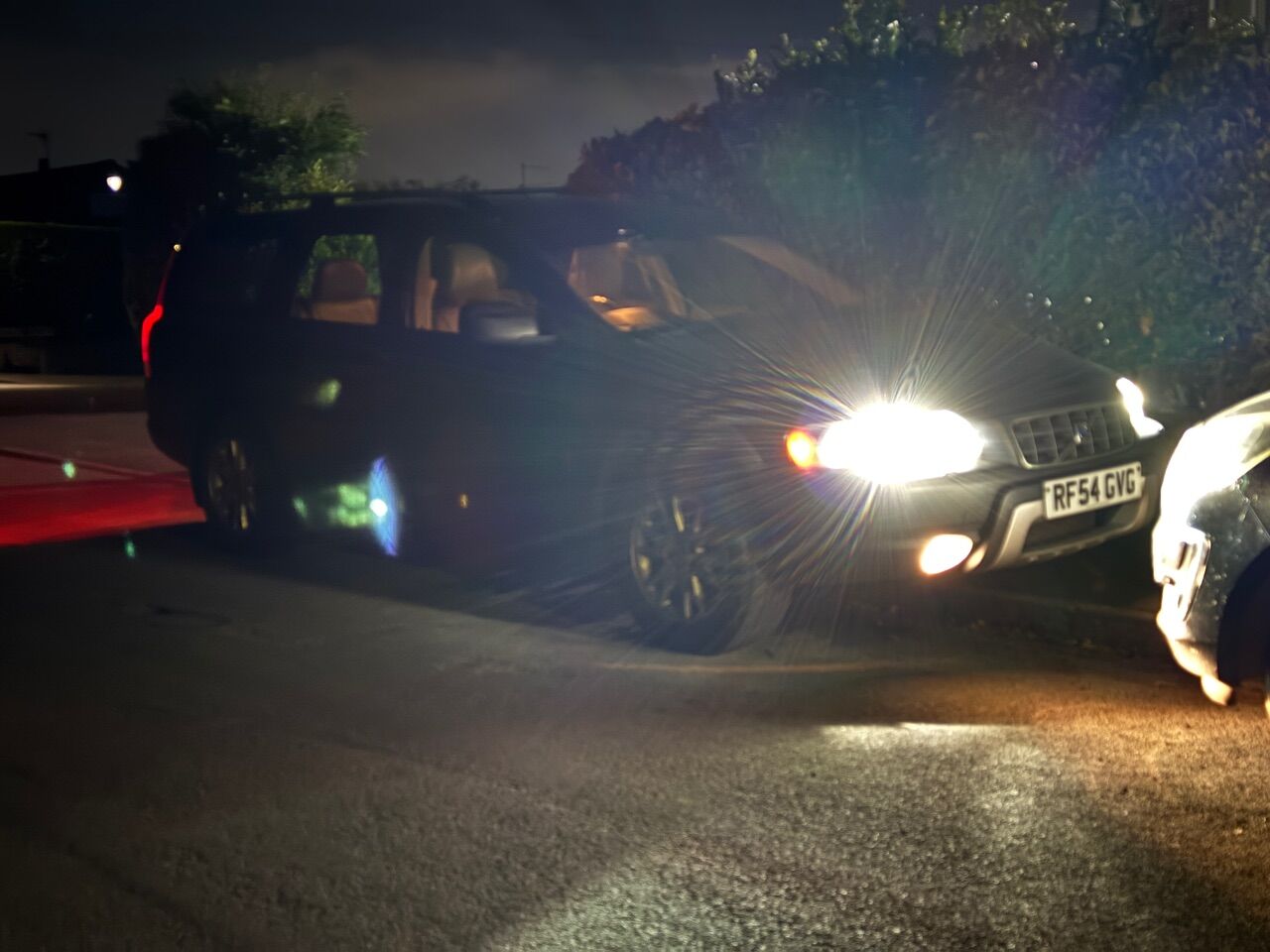

FFS. I hate when companies do this.

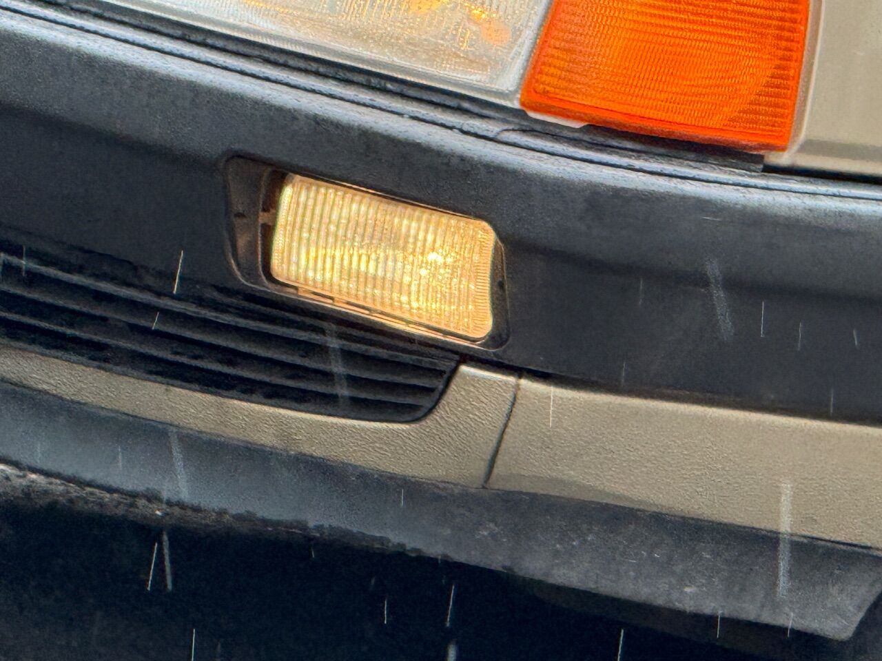

Sorted though. New headlight bulbs and it was done - I had to reconnect a loose headlight adjuster,  very old school.

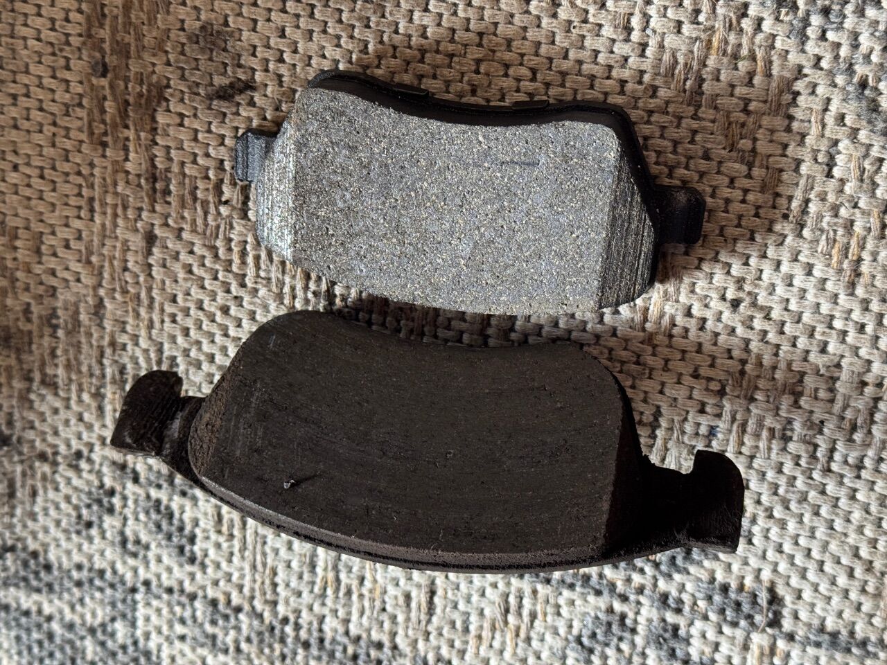

The wires had broken inside the rear pads - I pre-emptively bought Brembo rear pads just in case they were worn, but since I couldn't fit the new wire in used them anyway replacing some Textar pads that had a few miles on.
I think they just disconnect for fun. I hit a pothole once in ours and ended up not being able to see where I was going.
It looks like it's a  emergency "avert your eyes" system 😂

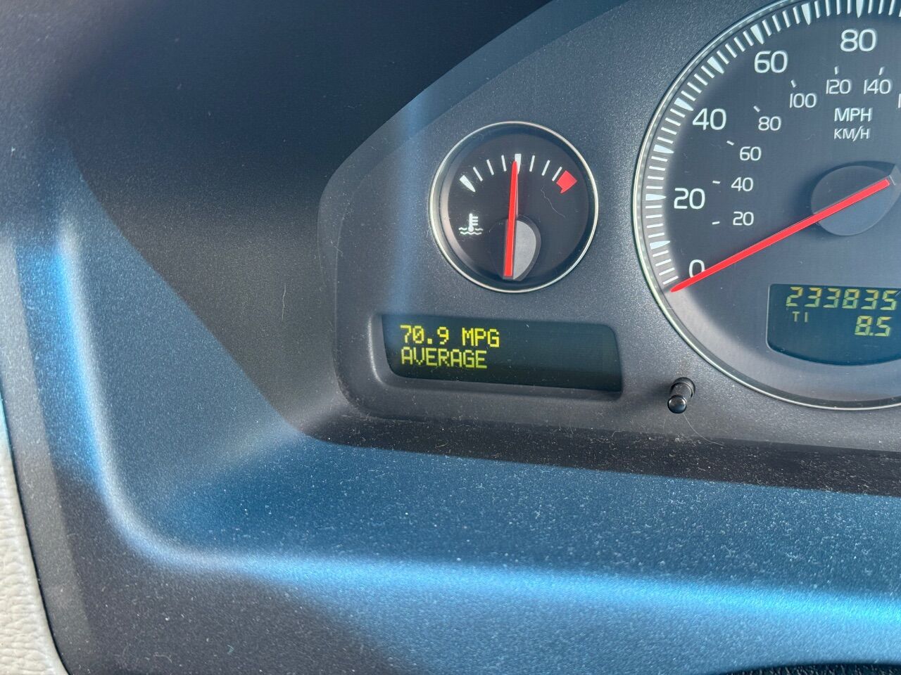

The Volvo did alright:

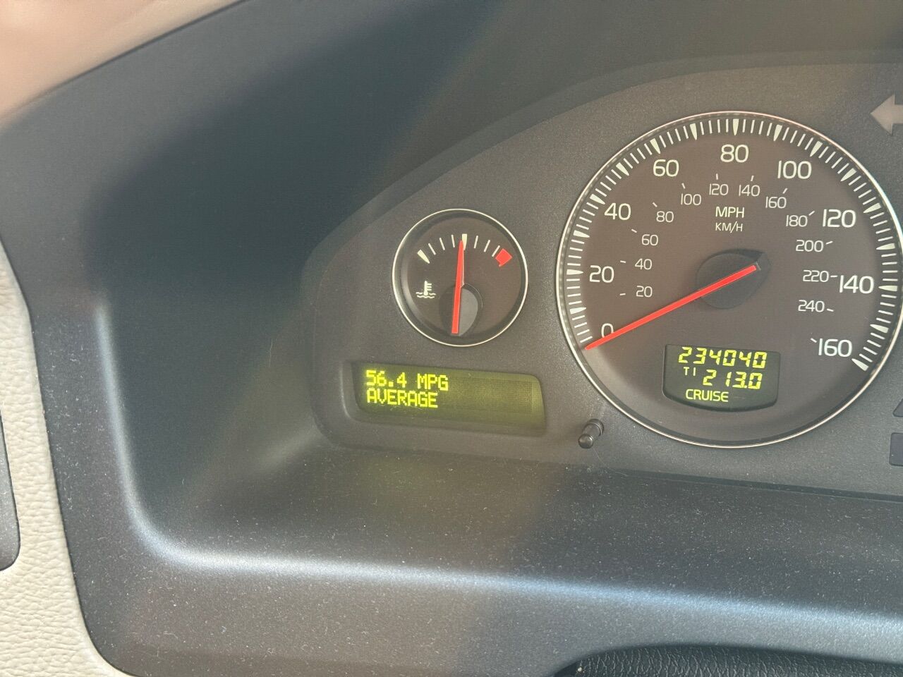

Though the stretch between "I wonder how to reset the the MPG" and "need to stop and check oil because paranoid" is even better.

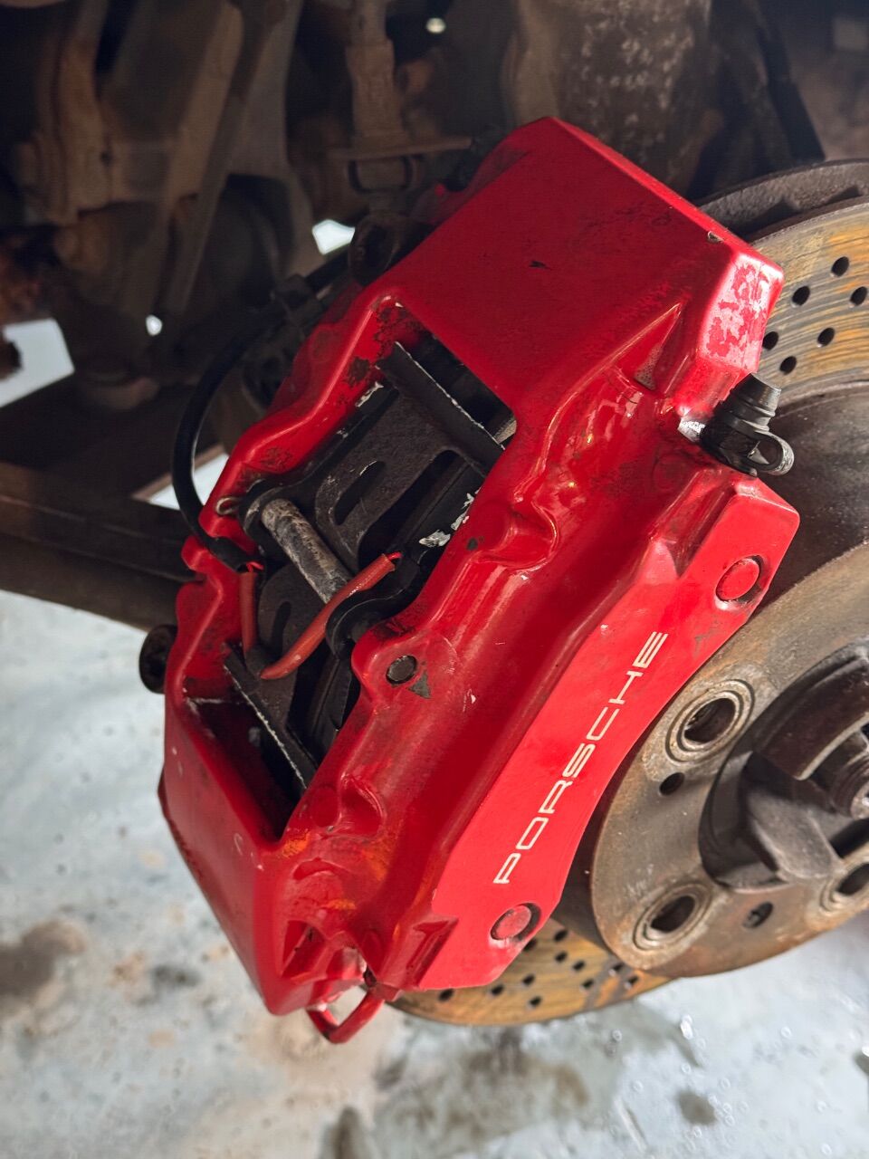

But, not to be outdone, I finished the Porsche brake pads and wires - took it for a drive, and no warning light!
Instead, it's peed about 200ml coolant out of the nearside front. So the radiator leak is still lurking, but... only shows up sometimes.

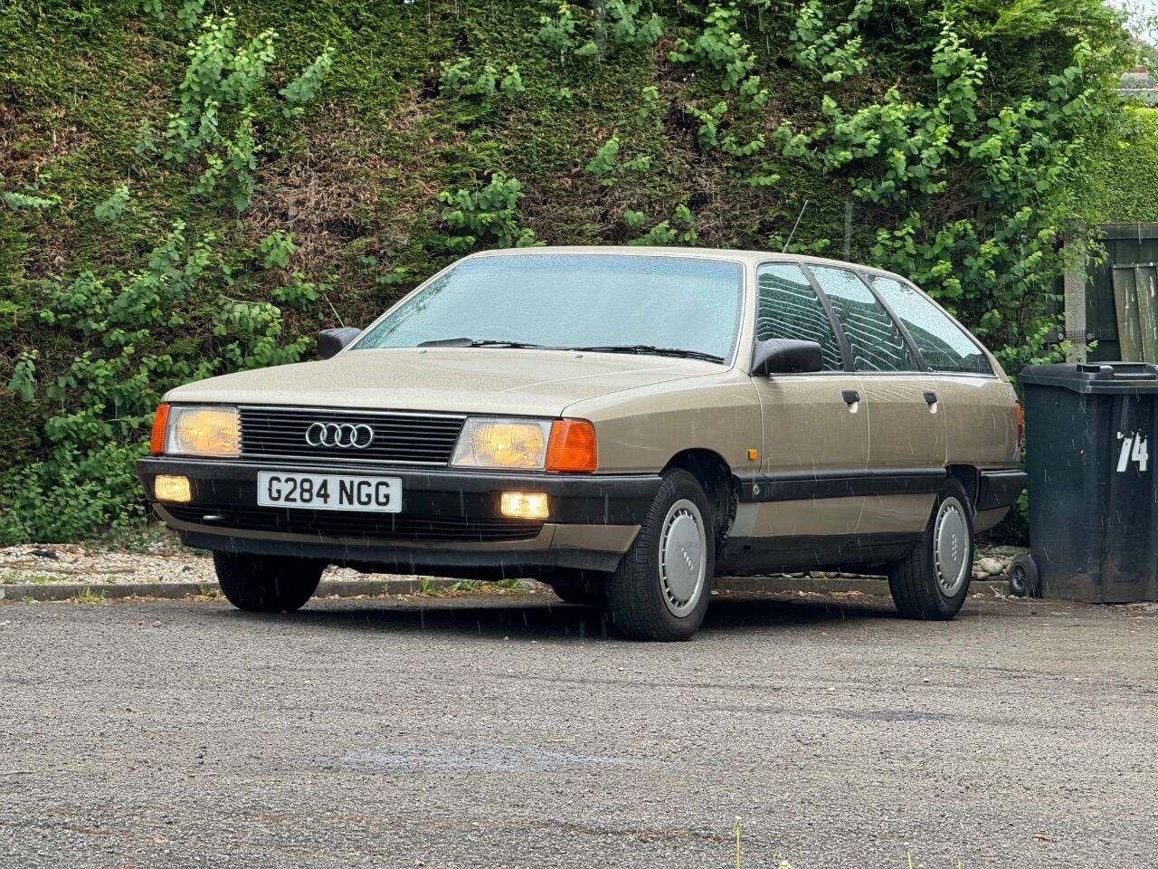

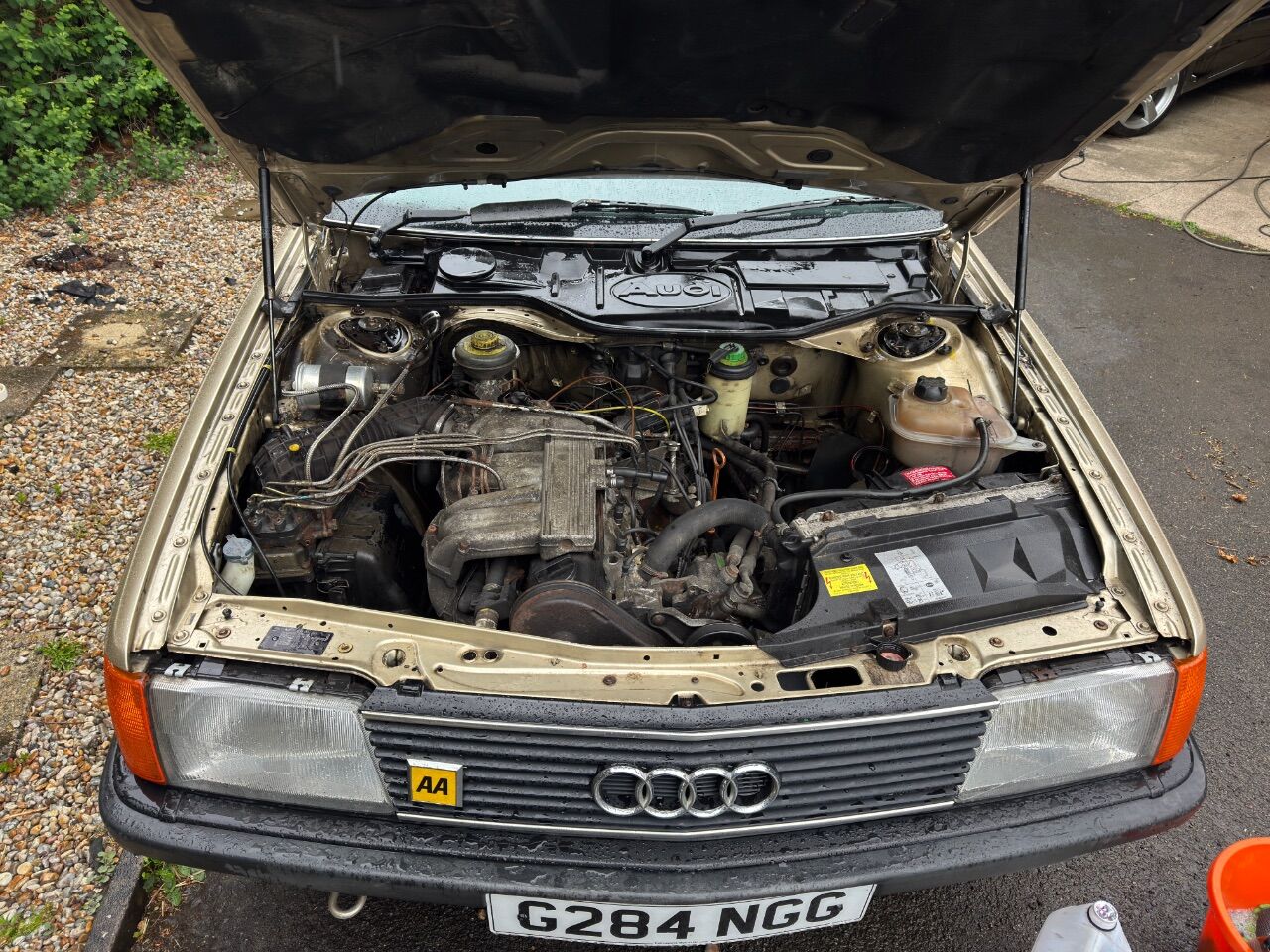

Ooh, I'm getting strong Audi 100 Avant vibes....
Who's the lucky new custodian of the Insight.... And did you pass along the "Al Gore for President" bumper stickers? 😉
Bang on!
Four rings of success...
Getting some shopping
It is not likely to be sticking around, since my mission is the Ampera - I will let the new owner reveal themselves if they wish! And... I can't remember! I did remember all the paperwork bits, but can't remember if I kept the sticker with the other bits or lurking elsewhere...
That Avant is lovely, they got it so right. It still looks so slippery and futuristic (to me anyway).
I did not have an Avant when they were just bangers, so this is exciting as I always wanted one - but badly timed as I was trying to cut the fleet down and the Ampera is supposed to replace two cars with one 😂
But being back behind the wheel of 1980s VW Group is both familiar and amazingly different to modern cars. I kinda want to do all those little detail fixes I do and make this one good, and enjoy it.

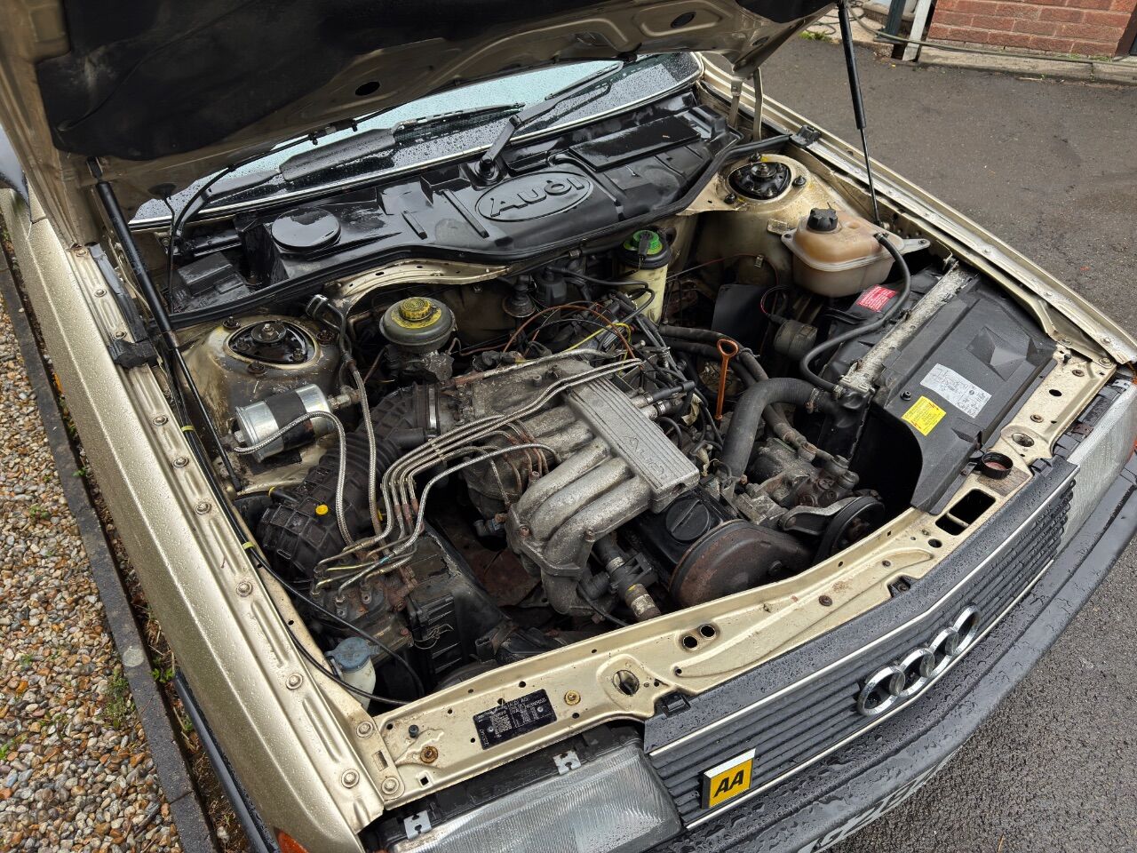

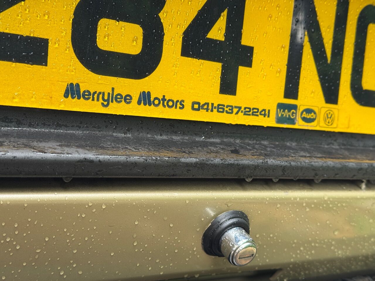

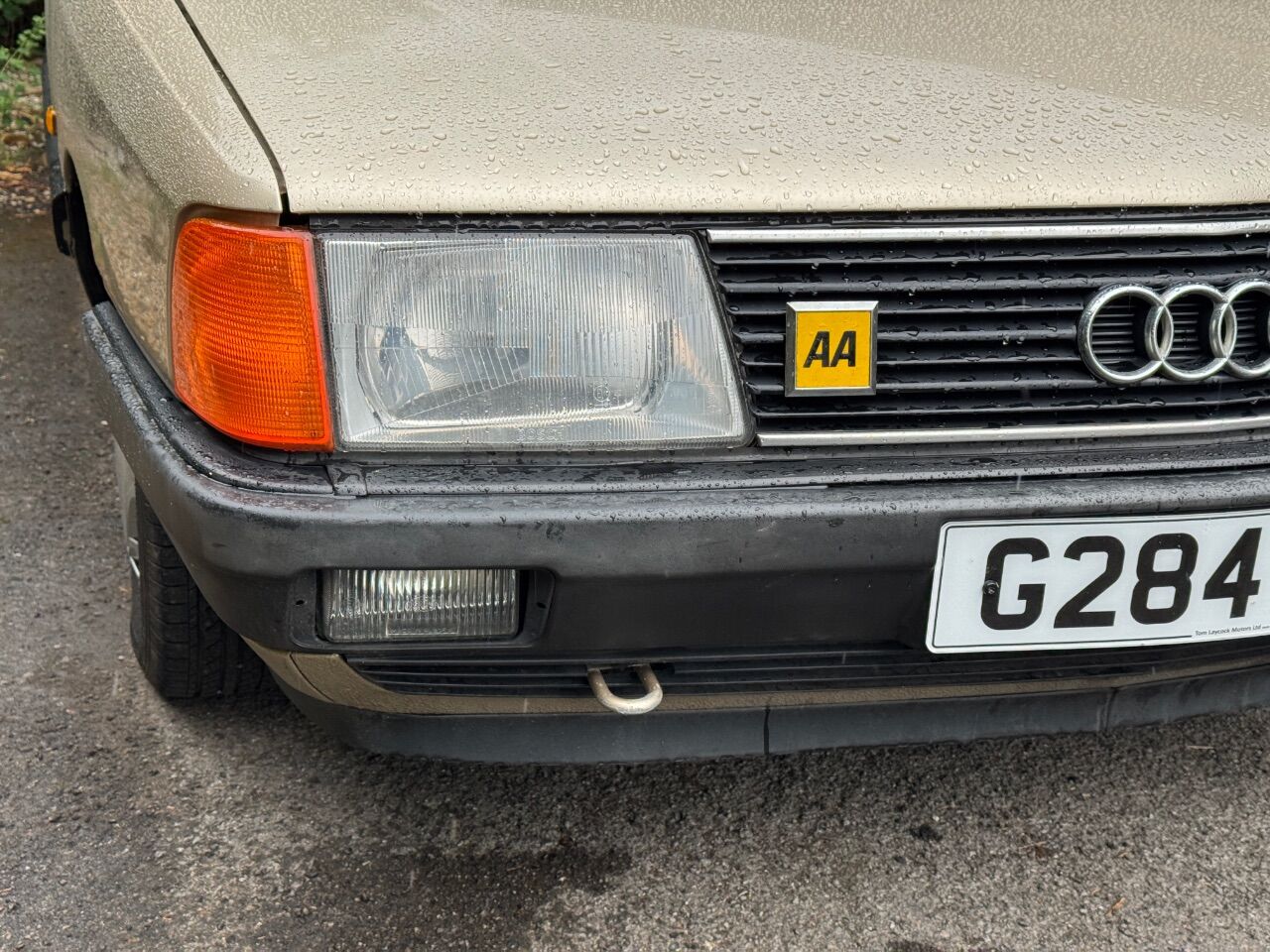

Yes, the plate matched the dealer sticker in the window, but it was a faded sticker. So could it be...
I miss those VW group plate logos. This makes me inordinately happy.
Service history to just 20,000 miles ago, too!
But the radio has been swapped, it should be a Blaupunkt Windsor. I thought missing out on autoreverse was a bit stingy even for Audi on a car like this 😂
