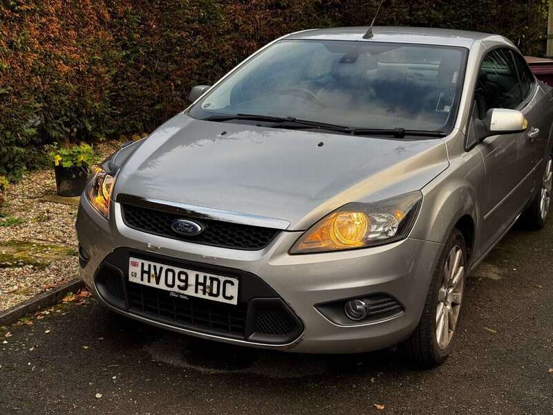

Yes, it does look better with a Zetec lower grille and no chrome ring.
No?
Oh. Oh... Yeah I ordered a Focus CC headlight with a discount from Ford Direct on eBay and... didn't realise there are three styles including "half chrome" - it was listed for a CC specifically so maybe mine was swapped for black. Who knows.
(Turns out Ford have "revised" the original part - and supply half-chrome ones where the originals where all black. At least they aren't all-chrome).
New headlight blends in nicely.

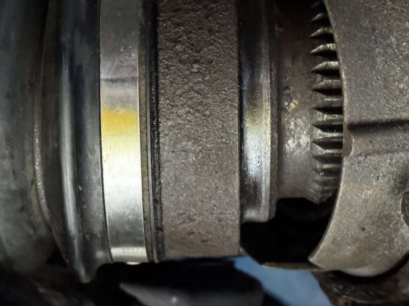

It has an integrated wheel module rather than a bearing. Not bad to change actually.

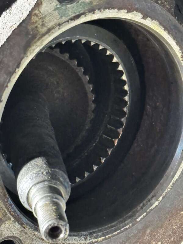

This is the inner roller bearing that supports the driveshaft ahead of the rather delicate 14mm bolt at the far end.
It is rather full of rust, but also conspicuously full of rollers. Greased it moves fine. So.. where's the play?
This end is free-floating - there is a gasket (well, was) but it should be supported by that bearing.
The collar for the locking hub is also free floating. But does that axle look a bit... skinnier in the middle?
Some numbers. Right or not. those are some numbers.
And these are fewer numbers. I have looked at many pictures of old driveshafts for sale and they appear to be thicker here. Not looking like a wirebrushed brake caliper after 35,000 miles.
