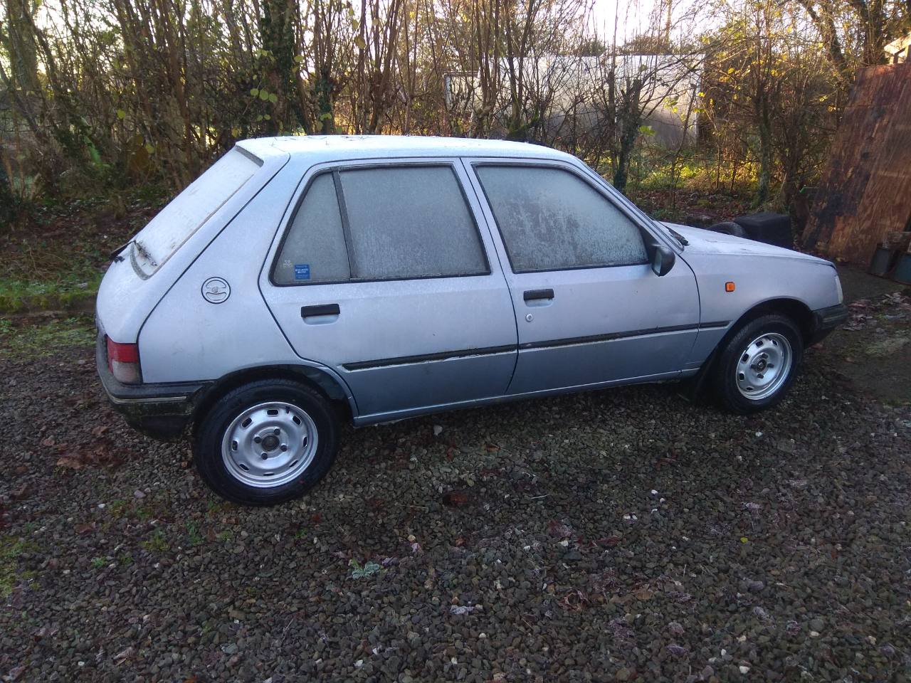

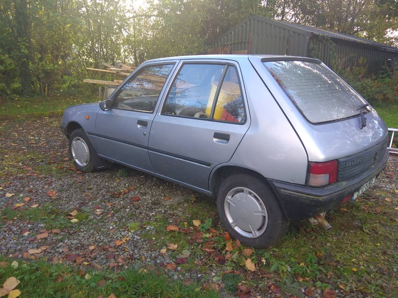

I also own a Peugeot 205 GL 1.1 that I bought in 2015 to play about with.I got it through a test and drove it a little,as I had access to trade insurance then.I didn't want to tax it as it was €330 pa ,so I tried to sell it,but only got low offers.I parked it up for a while and eventually realised that if I kept it until 2021 it would then be classed as vintage under the tax rates.Also I could get cheap insurance.So it's been gracing the back garden for 5 years.
It's 30 years old in about 10 weeks,so this is the time to start work.IMG_20201026_143822.thumb.jpg.78204431f3677865c4d9833903890964.jpg
It was covered in green mould until a fortnight ago, but my wife gave it a rough clean when she was cleaning her own car.IMG_20201026_143847.thumb.jpg.09a14acb2bbd2b47f041d6934f35e450.jpg

I cleaned the worst of the algae off the door seals and shuts then moved it for the first time in a year.IMG_20201026_143809.thumb.jpg.d53036ad396c548c051cd3cb7b9b1637.jpg

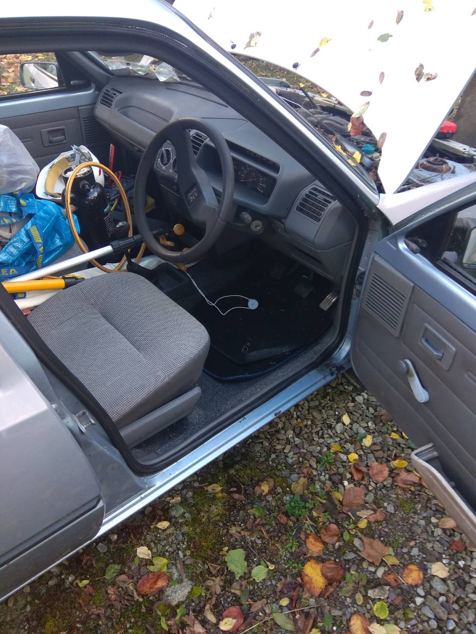

The interior is good,but full up of window cleaning equipment,which will have to be removed at some point.IMG_20201026_144246.thumb.jpg.439a15525615f1b9dff052b21930c087.jpg

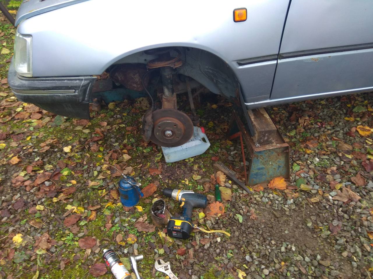

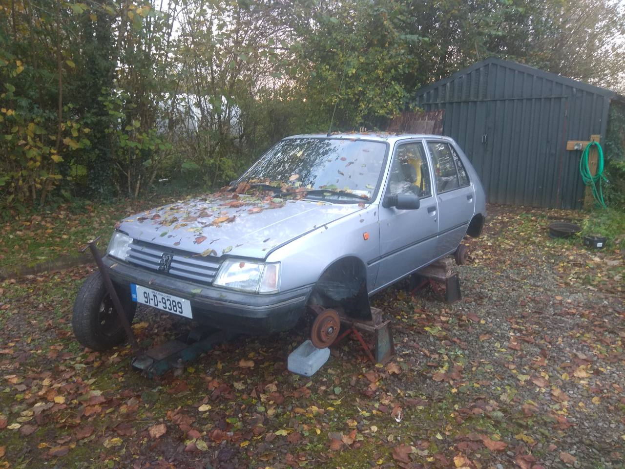

I've been busy getting my work car through the test, which has absorbed all my car energy, but today I started work on this.IMG_20201104_133524.thumb.jpg.6e40fdd8081799b64c87ce467b1c32e4.jpg

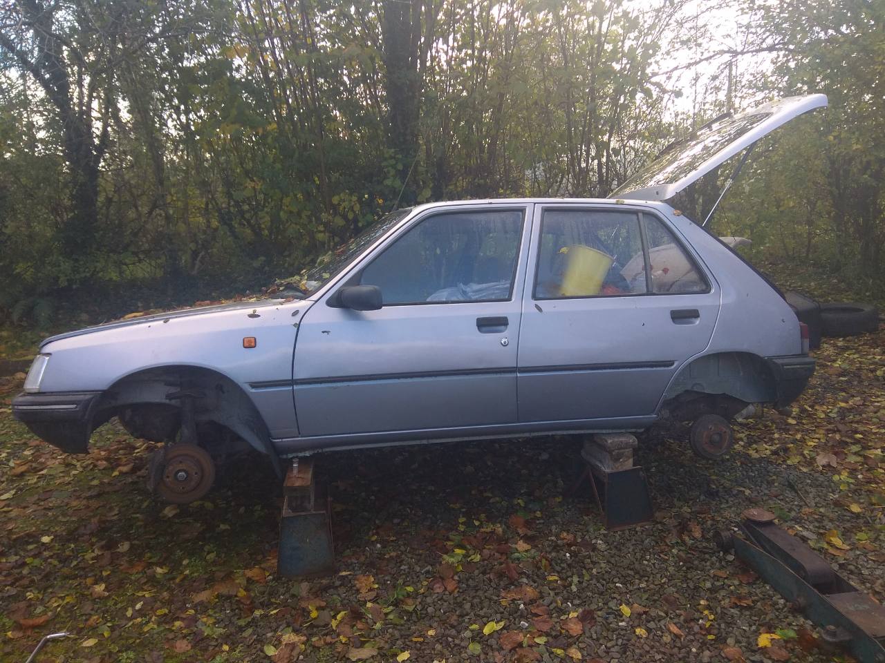

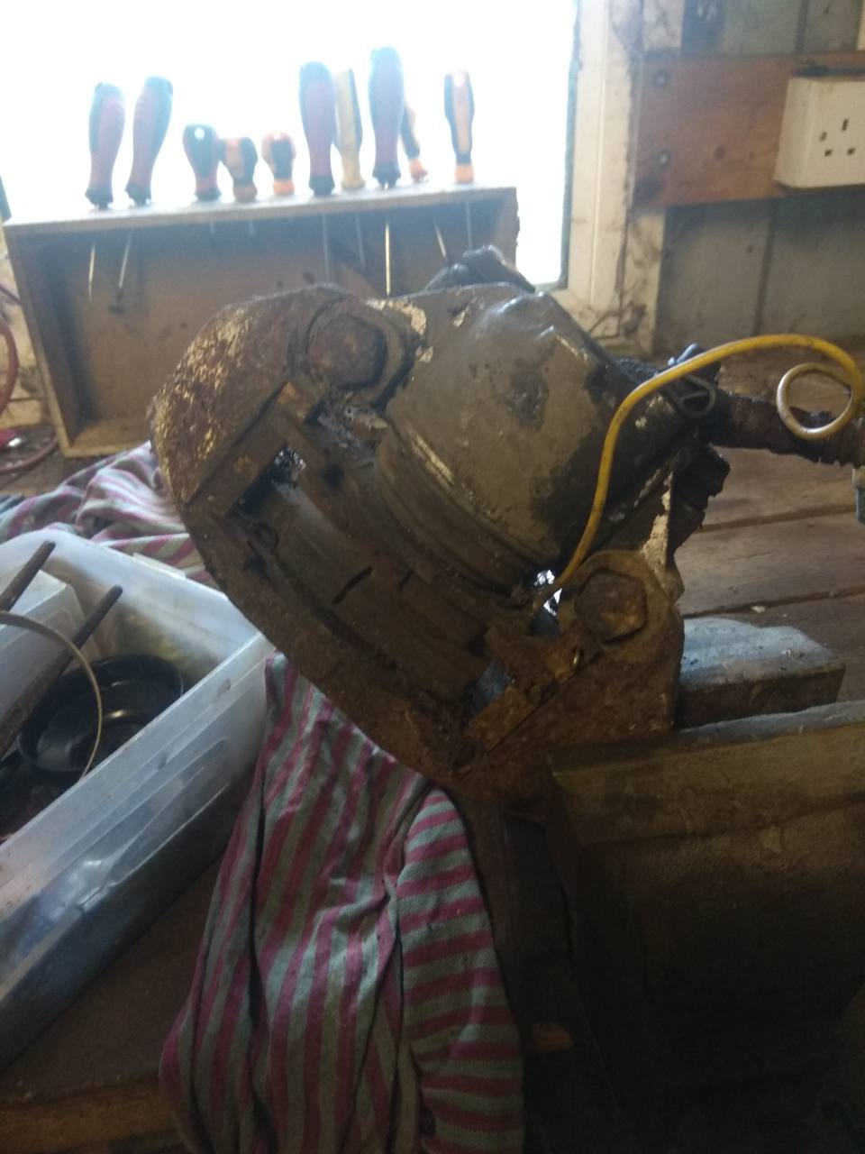

First thing after putting it up on stands was to check those metal brake pipes:-
It looks terrible,but actually cleaned up ok. I took the caliper off to check it, and it turned out to be terrible looking, but completely unseized.

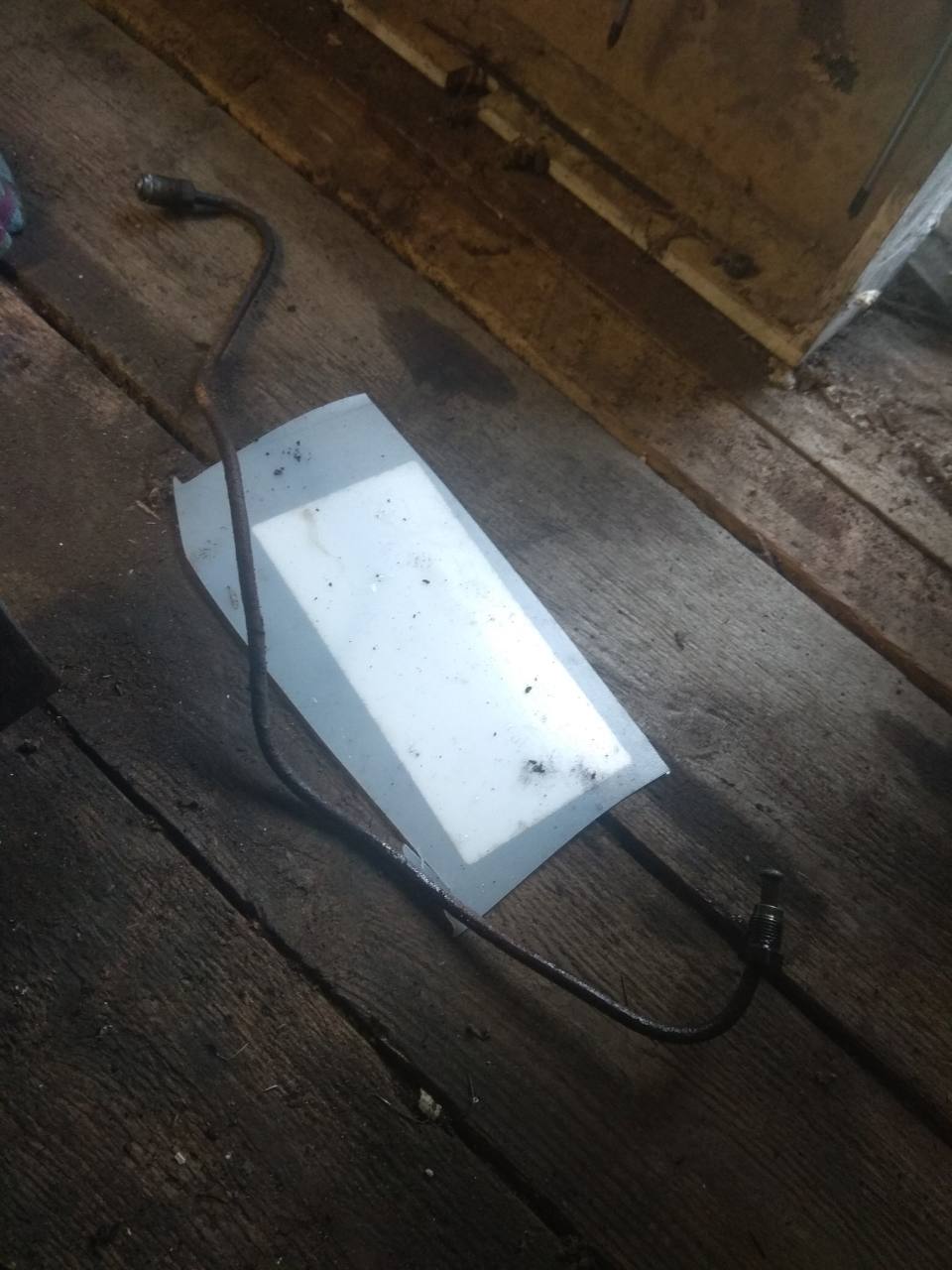

Then looked at the rear left brake pipe.IMG_20201104_133601.thumb.jpg.004c5bd93e8debdf36e69630788f3b8d.jpg
Which was fairly pitted,so that was taken off.
This had to be done carefully, as it has this unusual 12mm union at the wheel cylinder end, which will have to be reused.
Then the o/s/f caliper and the metal pipe from there to the master cylinder came off.
That was the end of play for the day.

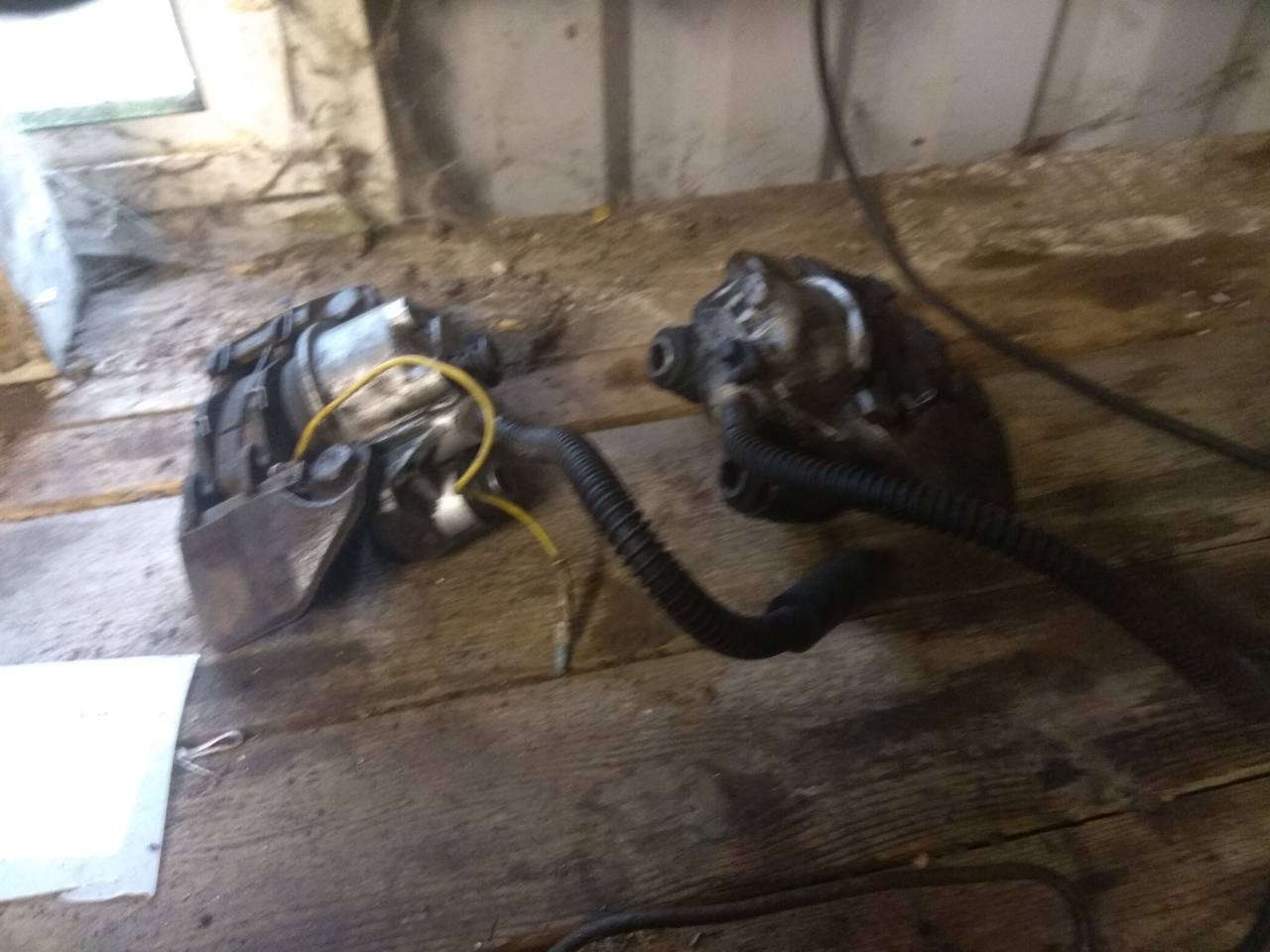

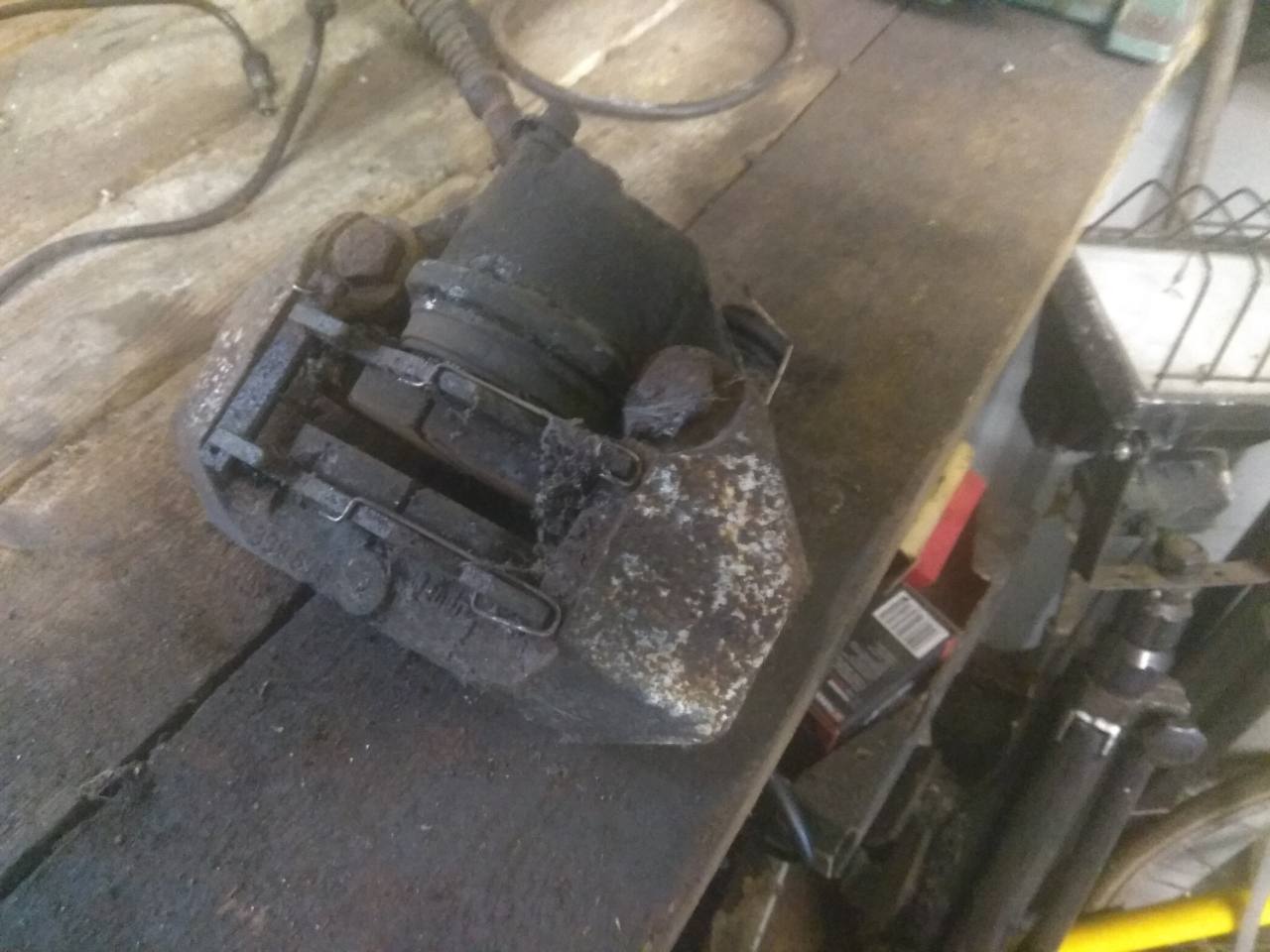

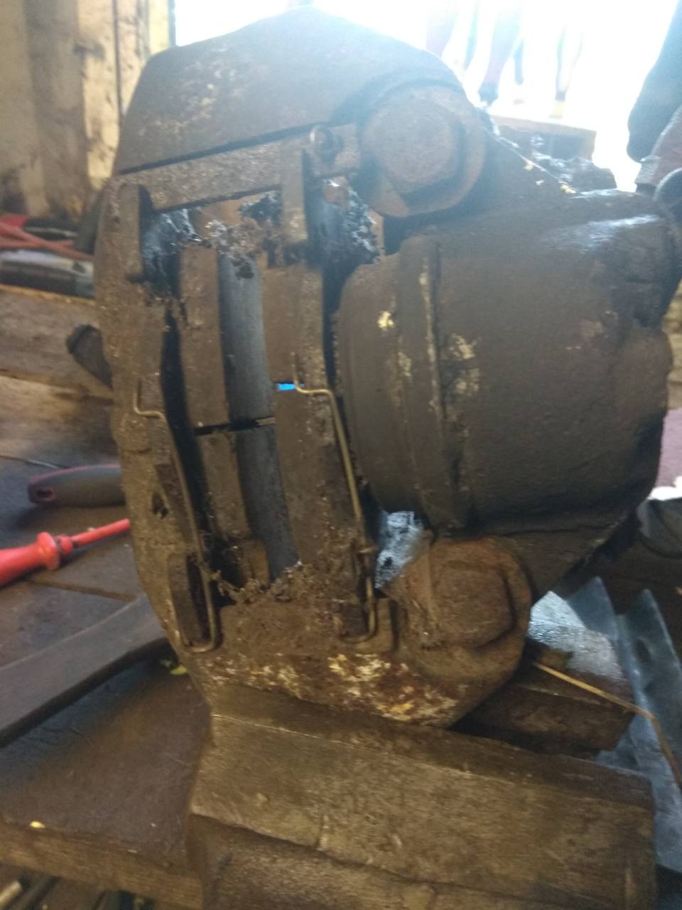

Next I gave both of the calipers a going over.IMG_20201105_132411.thumb.jpg.9fd466b822a4b56c0824c41a96973cce.jpg
They were fairly awful looking. But amazingly, both pistons were completely free. The bleed nipples came out ok, and were cleaned up.IMG_20201105_132049.thumb.jpg.60792469682603ad68d6c1f094e43cdb.jpg
Then the worst of the muck and rust was cleaned off the calipers.
Ready to go back on.
This afternoon, both were bolted back on.

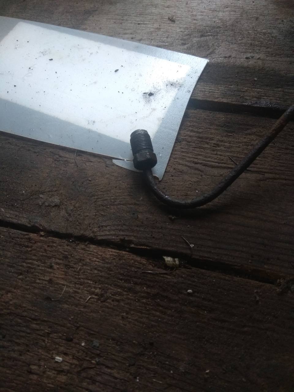

Finally, I made the first brake pipes I've made for decades. They just don't rust much in Ireland, but the front right one to the master cylinder and the l/h rear to the wheel cylinder were badly pitted.
I used to make up sets of pipes when I worked in a factor, but I messed up the first attempt. Then the  knack returned :-
IMG_20201106_173553.thumb.jpg.7e9fe38ac9bcfaefc58a2802e2f0196d.jpgIMG_20201106_180627.thumb.jpg.e15be9ed896bcde51591f6c67ecc5dd1.jpg

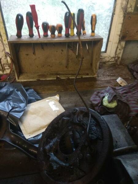

Next is get the drums off and check the rest of the pipes,

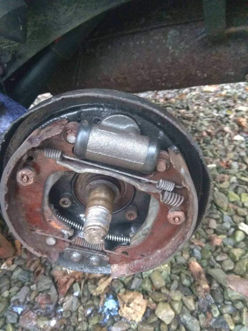

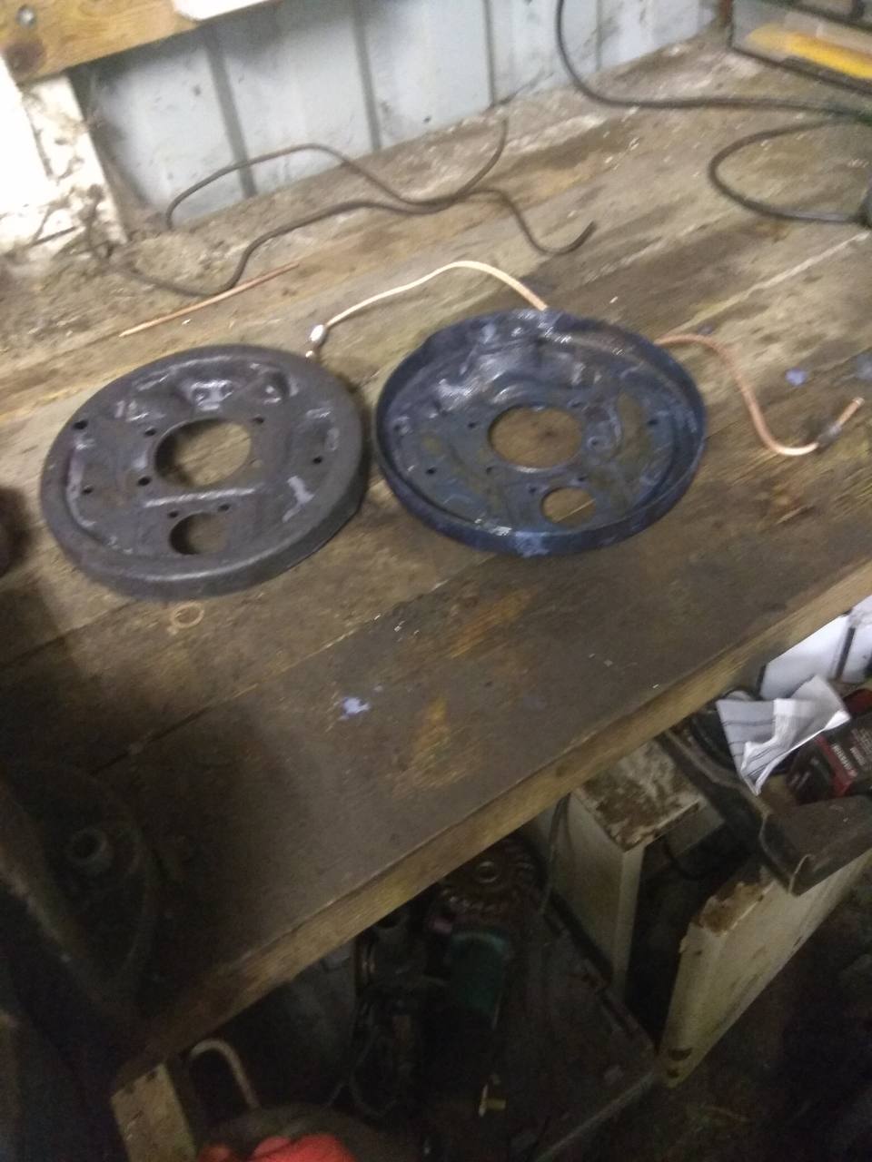

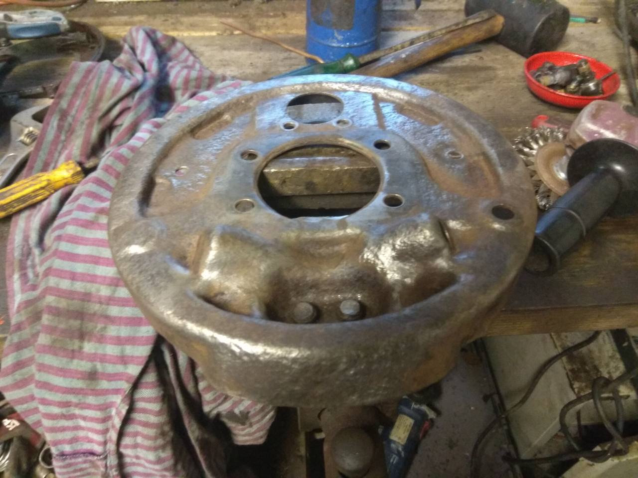

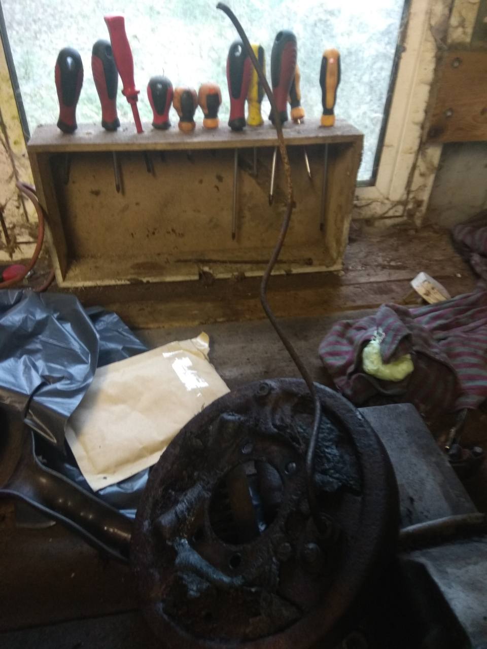

The drums came off ok, but inside them looked dirty, and the backplates look like the rustiest  part of the car.So they both got taken off, which was difficult,as the mounting bolts are Loctited in, but with a lot of working them back and forth all 8 bolts came
So out came the knot wheel.
One wheel cylinder had the bleed nipples broken off, so I've ordered a pair of new ones. They're a bit more expensive than normal, as they have the brake pressure regulators built into the pistons.
I had trouble with the rh metal pipe, it snapped of when being removed from the Flexi, but the union came out ok. I removed the backplate and pipe in one piece.
I managed to get the M12 union out of the wheel cylinder to be reused. One backplate had a tiny rust hole, so that was welded up.IMG_20201110_164417_BURST1.thumb.jpg.9d63ad57199a4572c178e99d922b8d56.jpg

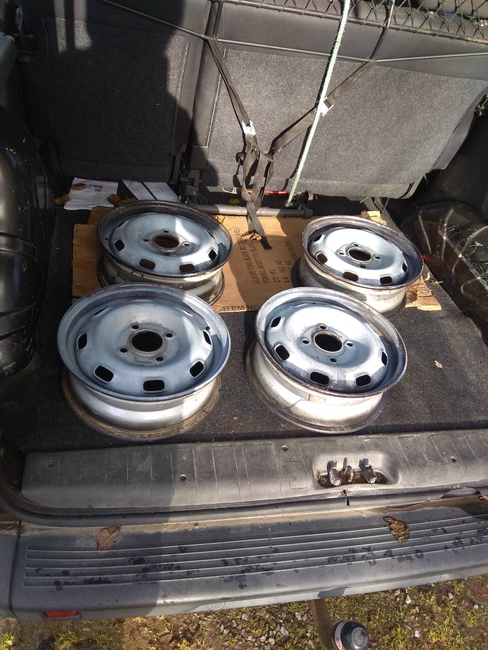

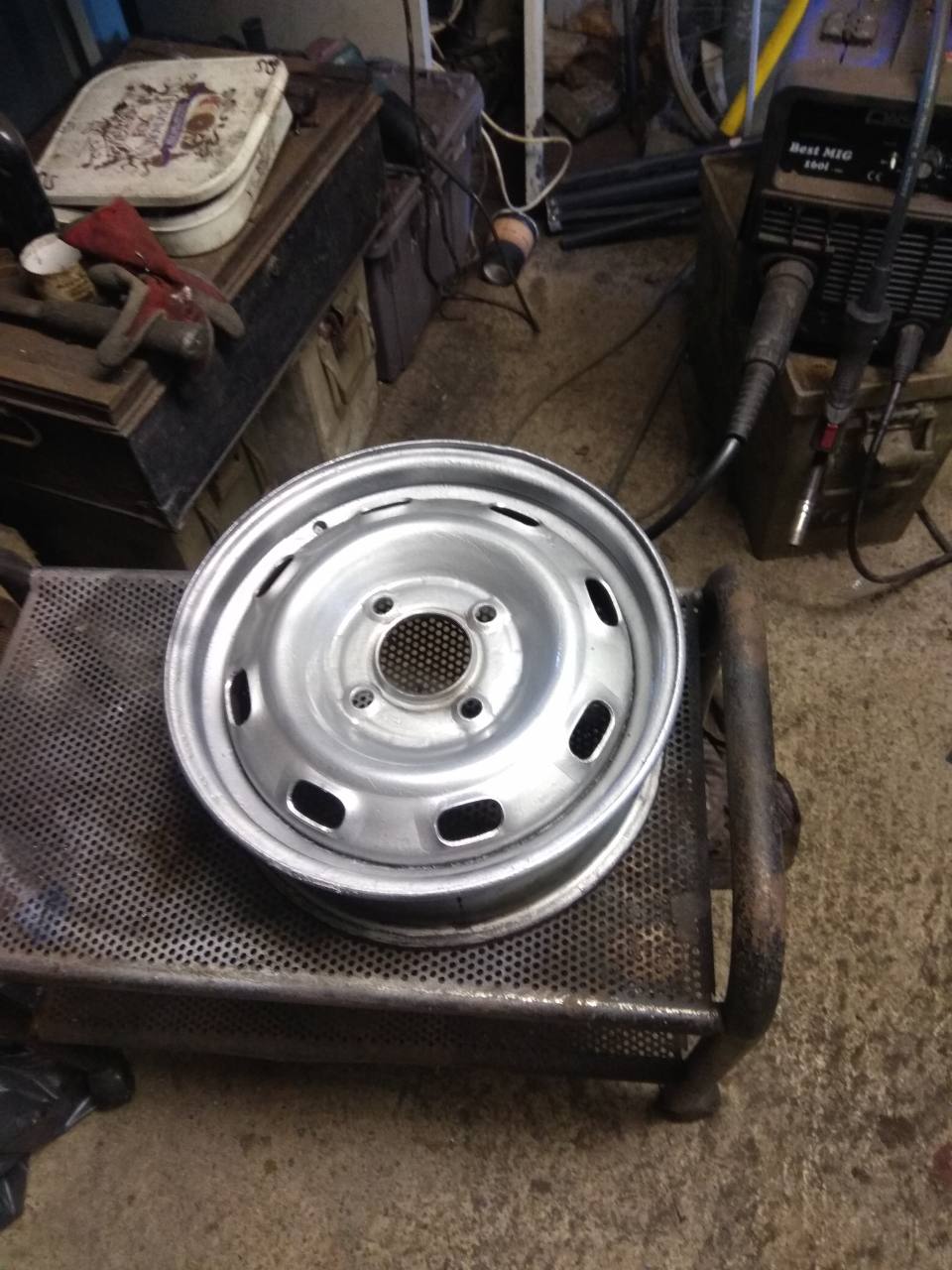

I did derust and prime the wheels.IMG_20201118_115955.thumb.jpg.8fc218ca7bb2d49ab8b85e253c25d0e4.jpgIMG_20201118_143936.thumb.jpg.9a25b5bf898ee9ec346e5b6a8a214c0a.jpg
Followed by a coat of silver.IMG_20201120_140524.thumb.jpg.319537fbfecf8af538a117bad9023ae2.jpg

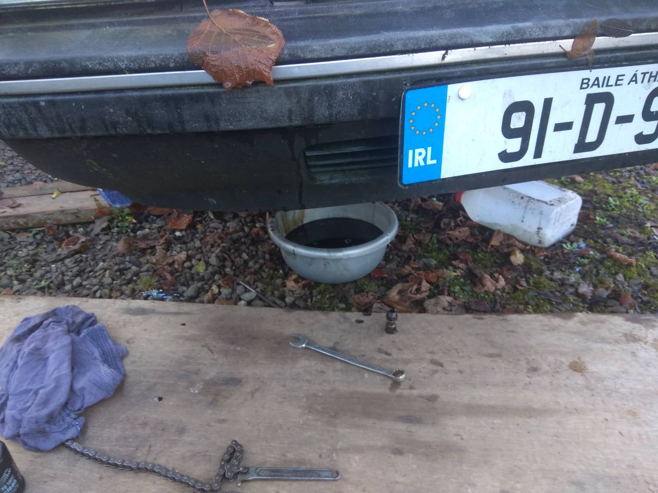

I did a few small jobs today.IMG_20201126_144602.thumb.jpg.dcb291f196c0f646e5f36cd89f88be3e.jpg
First oil change for 6 years.
Distinctly mucky.

As I mentioned earlier, I ordered wheel cylinders for the car on the 9th. Today, they arrived. Unfortunately, instead of sending a pair, they managed to send me 2 left hand cylinders. Someone had put a lh one back in a rh box. Thank you, thank you so much, MAS Autoteile.
Luckily, the rh cylinder I took off was in fairly ok condition, with the bleed nipple free, so I cleaned up the bore and put the pistons from the new cylinder in.
Then reassembled the rear brakes.
Then drums on and they bled out fine.

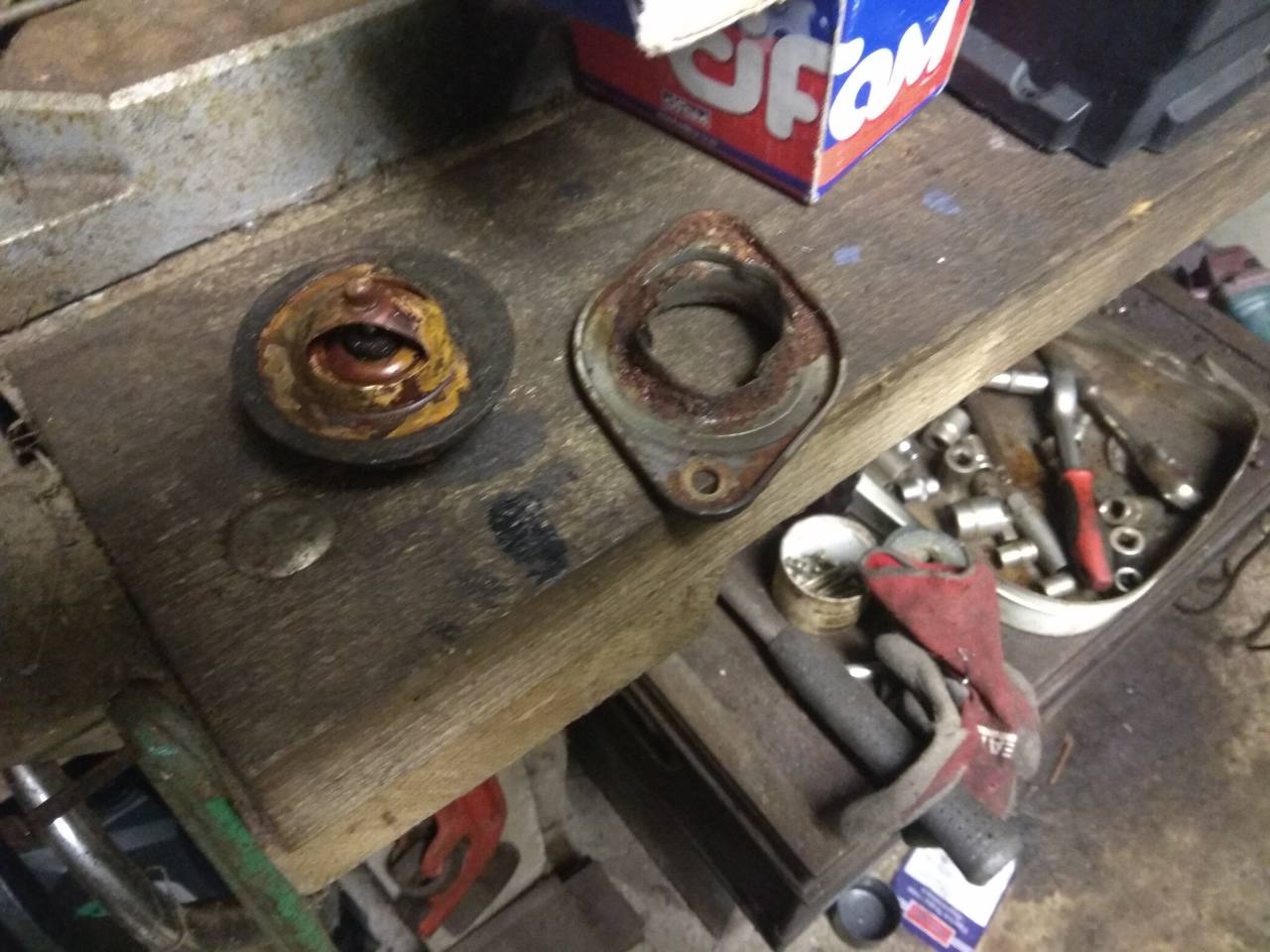

At this point the wheels should have gone back on, but yesterday I attempted to remove a rusty worm drive clip from where the top hose joins the thermostat housing. Unfortunately, the flange that the hose was attached to disintegrated. IMG_20201128_170051.thumb.jpg.61493e807b2802103092c627f671afd0.jpgWhich explains why the water level was going down. The local motor factor are ringing me back about getting a new flange on Monday.
Are those wheel cylinders not available locally, I would have thought they were something a motor factors would carry?
Stuff from Lithuania normally arrives quicker than stuff from the UK. But yes, I've been suffering buyer's remorse for the past 10 days. I doubt if anyone holds stock anymore as these particular cylinders stopped being used just after the car was built, but I'm sure they could have been got in within a day or two. I'm going off buying parts from eBay now, as almost everything from the UK is €8-15 for postage to Ireland, even if it's only something that weighs less than 100g, and a lot of sellers don't seem to combine postage for multiple buys.

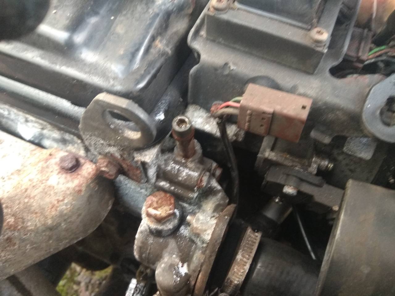

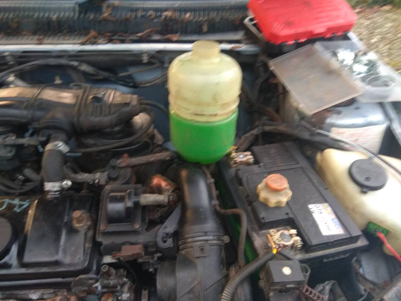

I hopefully sorted out the cooling system on the 205 today. The top hose joins on to a flange that you can see in the picture screwed on to the thermostat housing. It had totally disintegrated, so I borrowed one from a friend's 106, which is at no.4 in his projects list. Next time I get an order from Autodoc I'll order one for him and one for me.IMG_20201205_154401.thumb.jpg.7a7b54d12d769ac31658ff5693b6958c.jpg
On a 205 you fill the cooling system first of all through the radiator. The bleed screws need to be removed. One is the Allen headed screw on the thermostat housing in the first picture above. The second is a plastic cap which fits on the t shaped hose in this picture:- IMG_20201205_154949.thumb.jpg.12a590b52744af996480dbe8720d7584.jpg
So you fill through the radiator until water comes out of the hole on top of the thermostat housing. Then close that screw and put the radiator cap on.
After that unhitch the coolant bottle from its bracket  and make sure the max mark is above the top bleed screw. Fill through the bottle until coolant comes out of the bleed hole then cap that off. Put the bottle back in its bracket and check the water level, topping it up to max if necessary.IMG_20201205_155558.thumb.jpg.80e1050c5eb7a10a4aa50b6c9240b073.jpg
Then run the engine until the thermostat opens, check the level again, and put the expansion cap onto the coolant bottle.

The brakes got a final bleed yesterday. Now back on its wheels waiting for the new indicator stalk. Next stage is a good clean. It's dirtier than it looks in the photo.IMG_20201208_095328.thumb.jpg.5c18f426c58bf619c07aa7de1327a5bd.jpg
