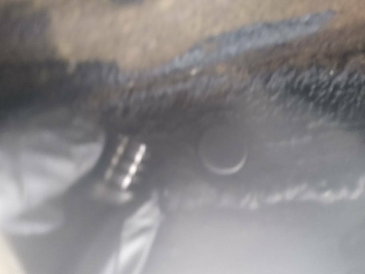

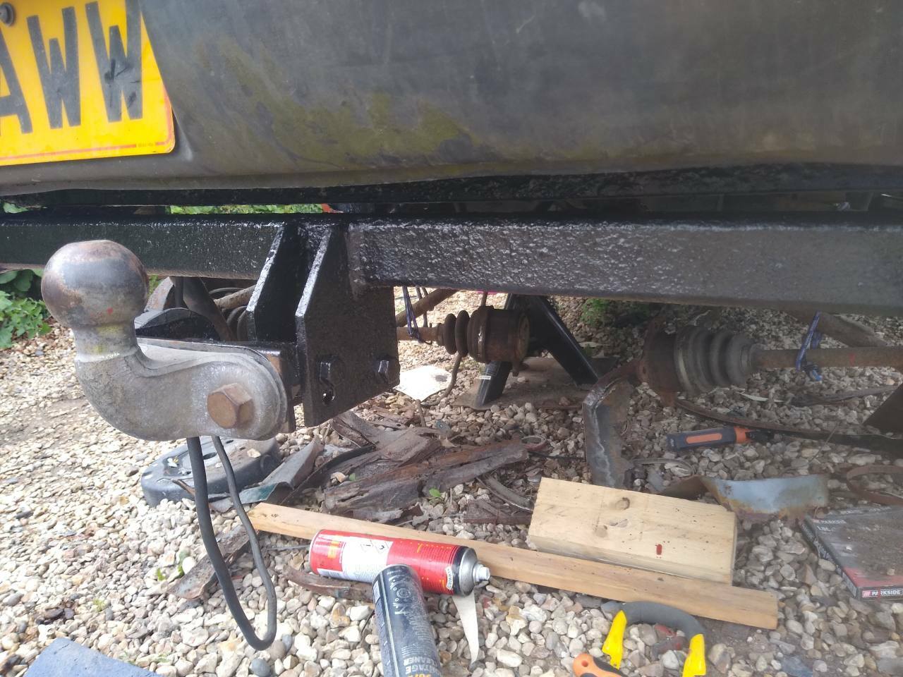

Today the weather was all over the place, but I've put the second coat of underseal on, along with the arches. So that's all done now, shit can be put back together.
I'm also between phones, so the photos are all to cock. I needed grommets, and couldn't seem to get blanking ones for the sills. Ordered what are, essentially, the feet you put on steel tubes chairs. And they're a perfect fit. Slapped a bit of underseal on it, snug fit!
Also threw some of the only tin of Hammerrite paint I've got in the shed. Gives a hammered finish apparently. You can't tell on the tow bar.
Looks so much better even with that.

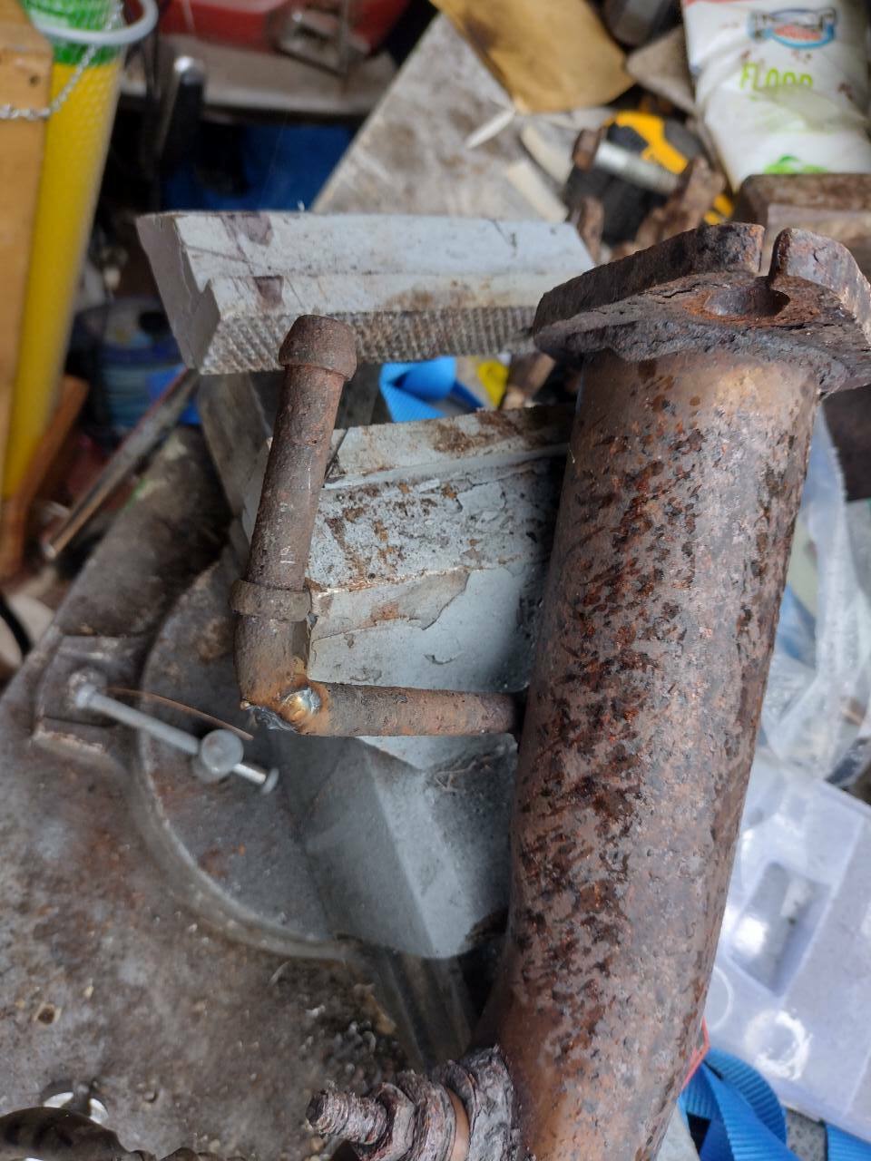

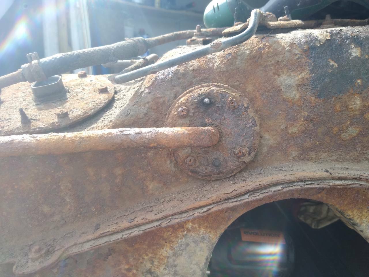

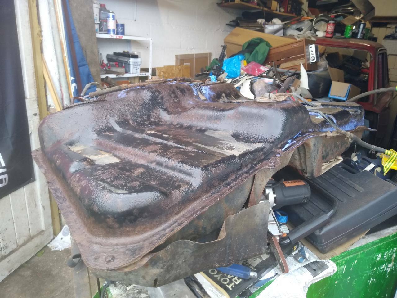

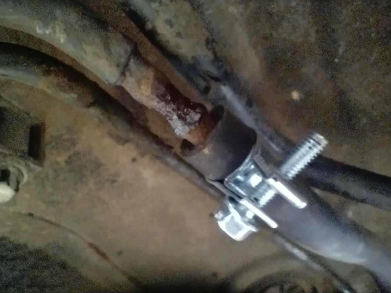

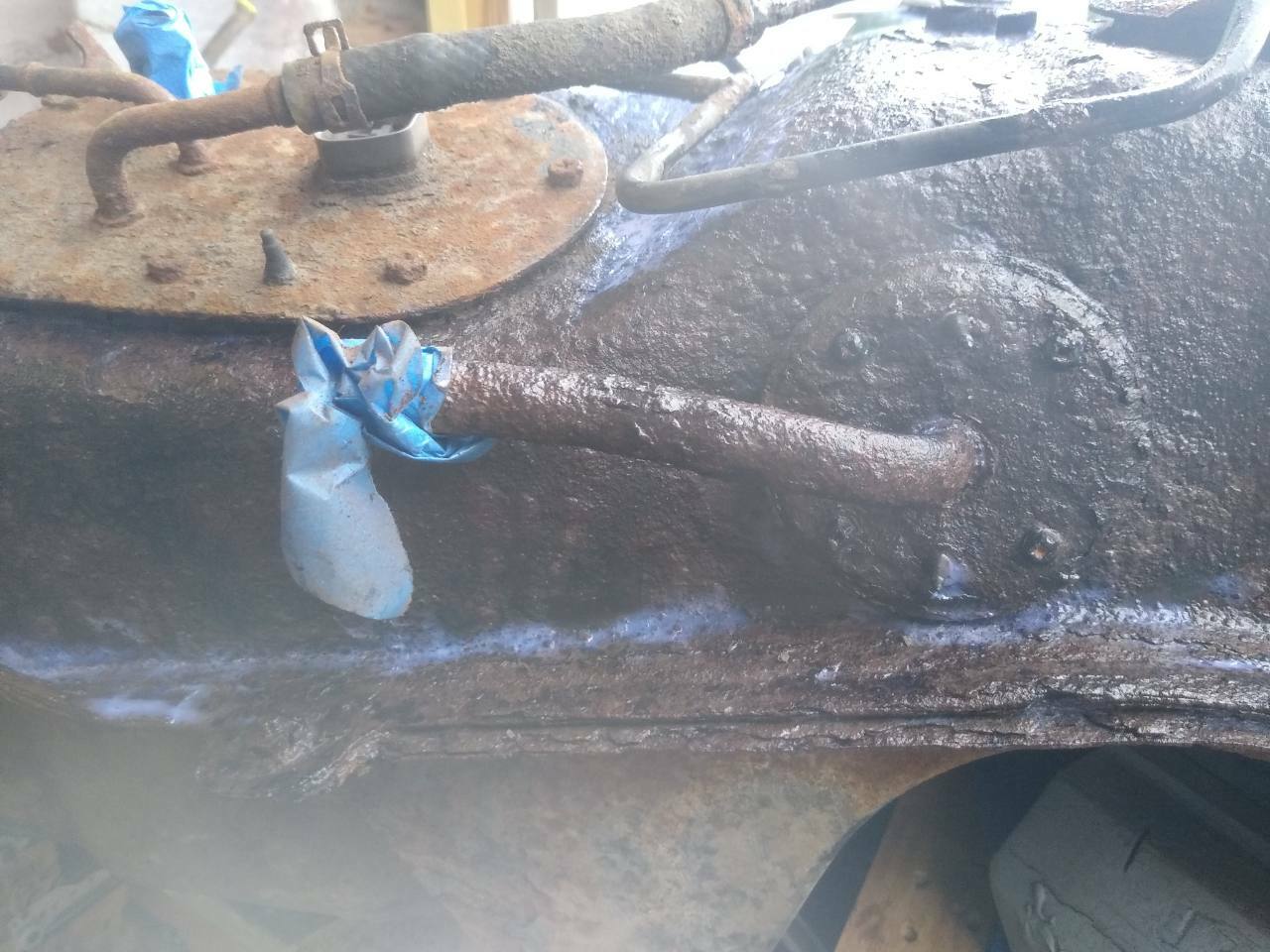

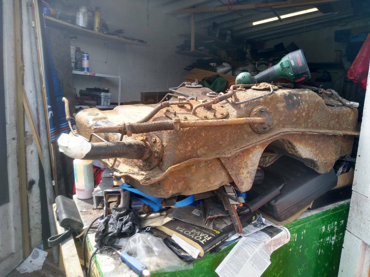

So I turned my attention to the fuel tank. Annoyingly, the vapour thing is just welded on with rust. They're just screws, and they're fragile to the point of being useless. So I'm going to let the next owner suffer that job.
I took a hacksaw to the pipe, just past where the rubber joins. I think the new hose I have is long enough to cope.
Part two!
Cleaned it as best I could, slapped on the rest of the Vactan I've got. Tomorrow I'll give it a coat of black paint as the Vactan already gives it a primer.
The only issues with the fuel tank were the filler neck and vapour pipe. The rest, amazingly, was fine.

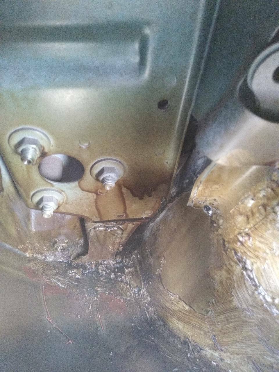

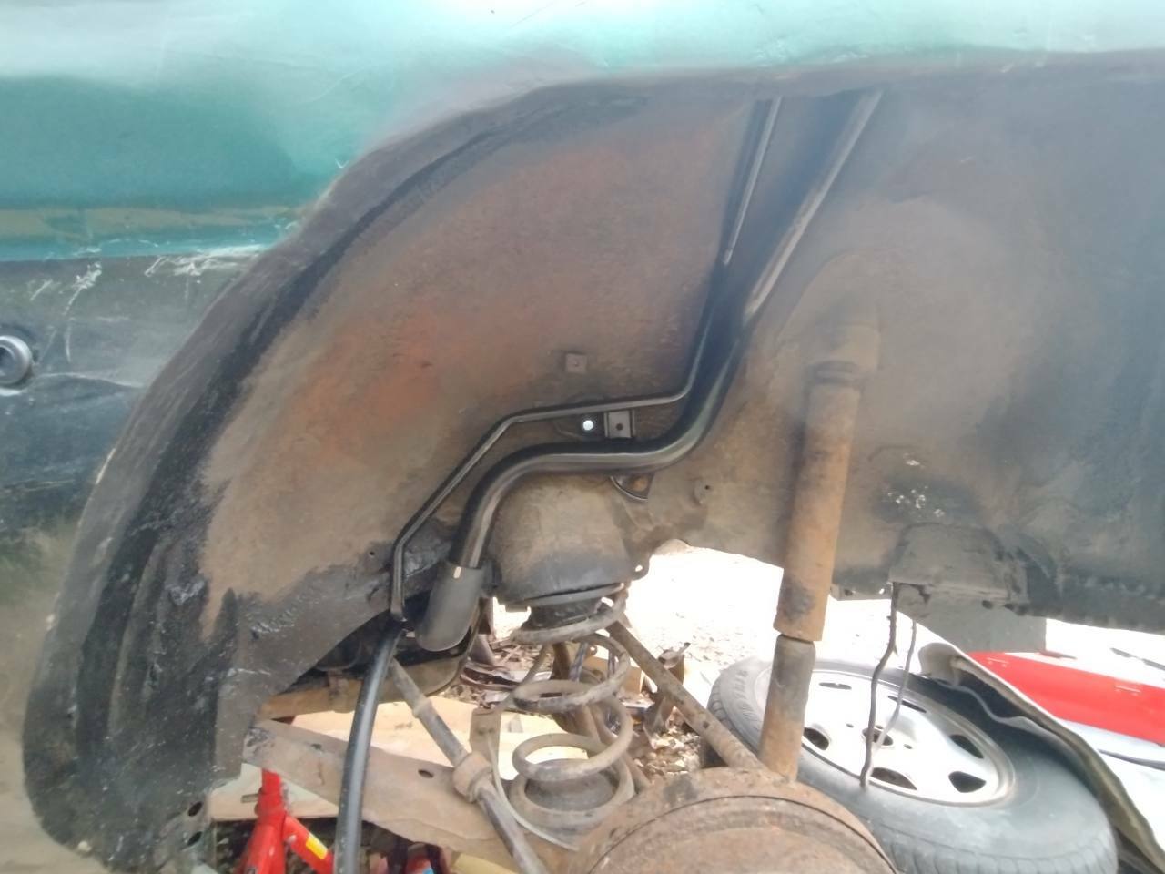

Also, I forgot to mention, I threw a can of the Dynax cavity wax in every cavity of the RAV4. This is what I looks like in situ.
Some came out, but not a lot. This is from the rear right corner of the car.

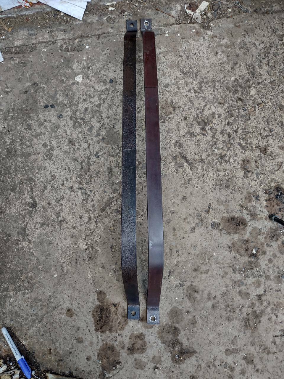

The fuel tank strap (well one of the two) was so flimsy I made one out of 4mm bar I got from B&Q yesterday. Didn't do too bad a job with just a hammer, a vice, and thighs thick as bollards.

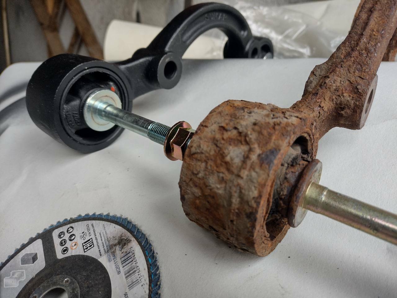

I turned my attention to the differential front mount. This, if you remember, was the thing where the bush just crumpled off the bolt, which is still in the subframe.
Now I've a pair of bushes, but looking at the bolt again that's on the mount, the bolt forms part of the bush.
I've looked online, and Toyota don't sell that bolt on its own. It gets sold as the mount complete. A quick search on eBay has brought up this:
So I'm going to call them tomorrow, as they're only in Birmingham, and see if they'll either do next day delivery (and actually DO next day), and see if they'll take the fuel tank part I got from Toyota as a swap or something. Unlikely, but I gotta do what I gotta do.

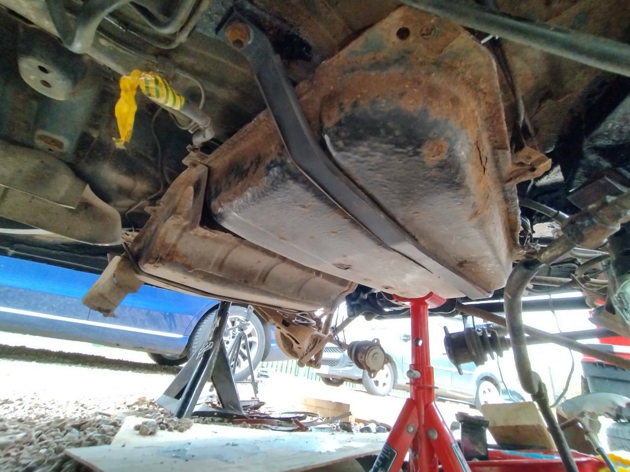

But like a total fool, I struggled and struggled on my own to get the tank back on the car. And I succeeded.
Admiring my handy work - as I just did the one strap - I noticed this:
So, I mean, it'll be tight to get the angle grinder to get that bolt off, but it could be tighter to get a new diff mount in! That'll probably need to come off. Joy.
Very genuinely had a moment where I thought "Shit, it's actually scrap" this morning, when I set about finding that differential mount.
I was googling the part number I thought it was, and nothing was coming up. The one I showed above? Nope. No one sold the part with the number I had.
I my darkest moments, I've always taken to the self flagellation of calling Toyota to see how they could screw me today. I gave him the part number, nothing came up. He asked what it was for, I told him, and he told me sweetest 10 digit code I've ever heard: 52380-42071. For the next sad bastard who has to deal with a problem like this on their Mk1 RAV4. The differential mount you need is 52380-42071
Toyota wouldn't be Toyota if they didn't give me a kick down to earth after the ball tickling: £170 exc. VAT for that particular part. Although, oddly, I could get it by 3pm today if I ordered before 12. Which is odd, given I've had to wait 2 days for a fucking bolt to be made available to me.
Anyway, with that code I re-did the search and the mount I shared above does fit. Called them trying to make sure I could get next day delivery, I couldn't which was shit but I could collect it. So once I clock off at 5pm I'll be doing a mad dash to Balsall Heath before 6pm at rush hour. Gives me the opportunity to try and off load that fuel pipe though!
So remember kids - differential mount part number is 52380-42071!!!!

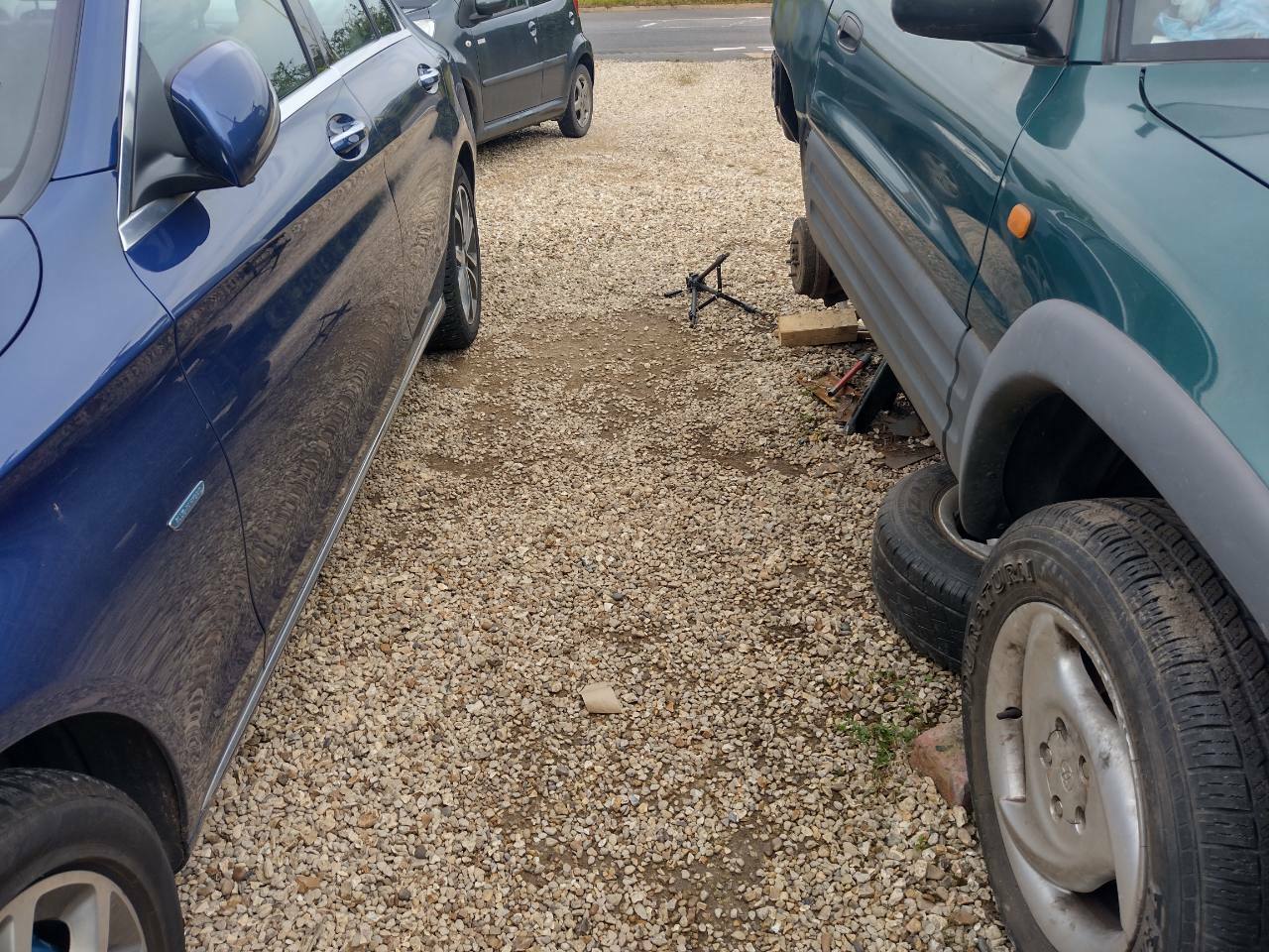

So as I went out, I realised the wife had stuck her car next to the RAV4. No bother, plenty of space - if I were a dwarf. And you know well if something slipped I'd never hear the end of it!
Dropped the front bolt of the strap input on yesterday, pushed it forward just enough to put the rear differential mount on it. Easy enough fit - I hope I put it on right now...
Put the strap I made on, it's just that bit thicker than the old one. Well, twice as thick tbh, it's a snug fit. The tank isn't moving - which I imagine is what we want isn't it?

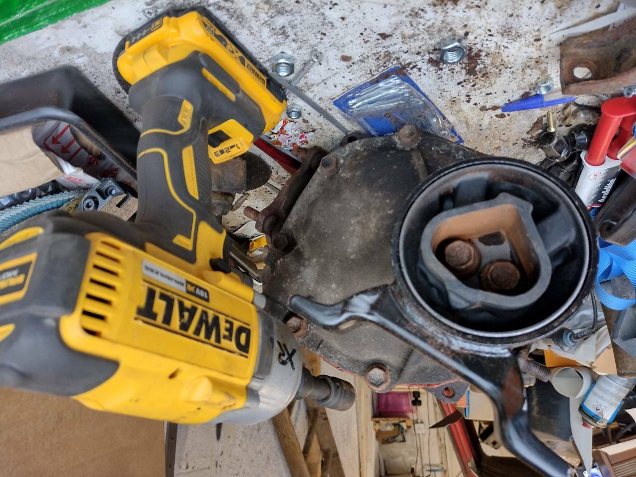

However, I can only find one. And it's not the input shaft seal, it's the pinion seal. I've no idea where the other one has gone. So I decided feck it, neither are leaking but probably will after I put it back but I can just keep it up with oil if it does.
Anyway, I took off the rear diff out of the car, and the rear mount came off. Without too much effort either.
I couldn't be arsed, so I took the gun to it and changed it.

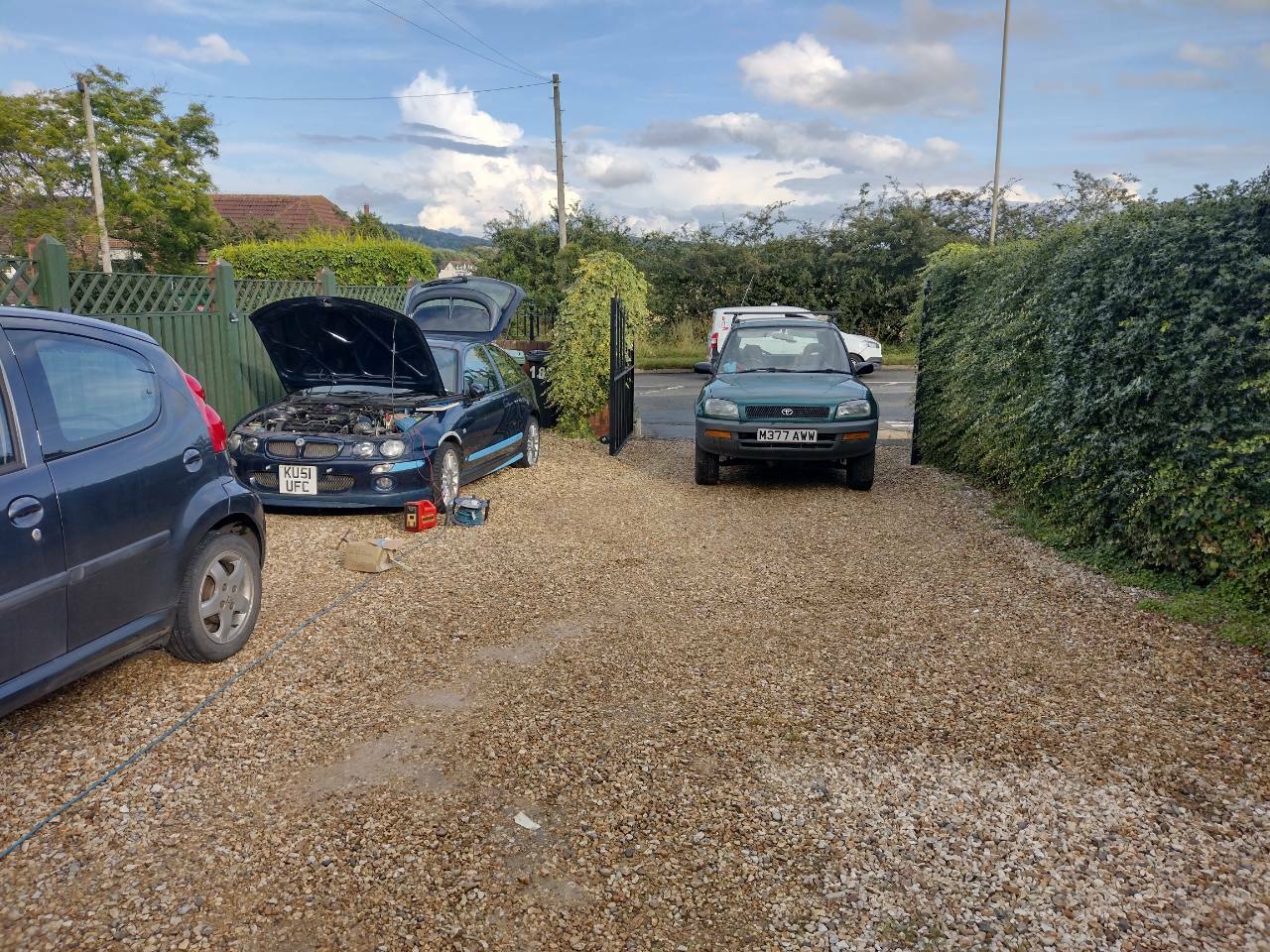

I thought I'm a bolt away from MOT-dom, I moved the cars around. Moved the RAV4 back so I could move the ZR forward as I have to break it up now. I reversed it back, and I thought the brakes were a bit shit. In the time it's been off the road I've been driving the wife's Merc and my own 107, and I remember it being a bit spongy anyway but this was something else.
As I moved the ZR, I went back to the RAV4 and started it up. I saw the (P) light as the handbrake was on, but there was also the (!) On as well. I drove it up, pedal goes right to the floor.
I've looked at the master cylinder, it was low. I topped it up, still nothing. I went under every wheel, I can't see any leaks. I never touched the brakes at any point, so I've no idea where the fluid went and where it's going now - or where the air is coming in.
But I am actually done now. I'm not fucking about with brakes, especially as it's not obvious like a rubber hose and what not.
