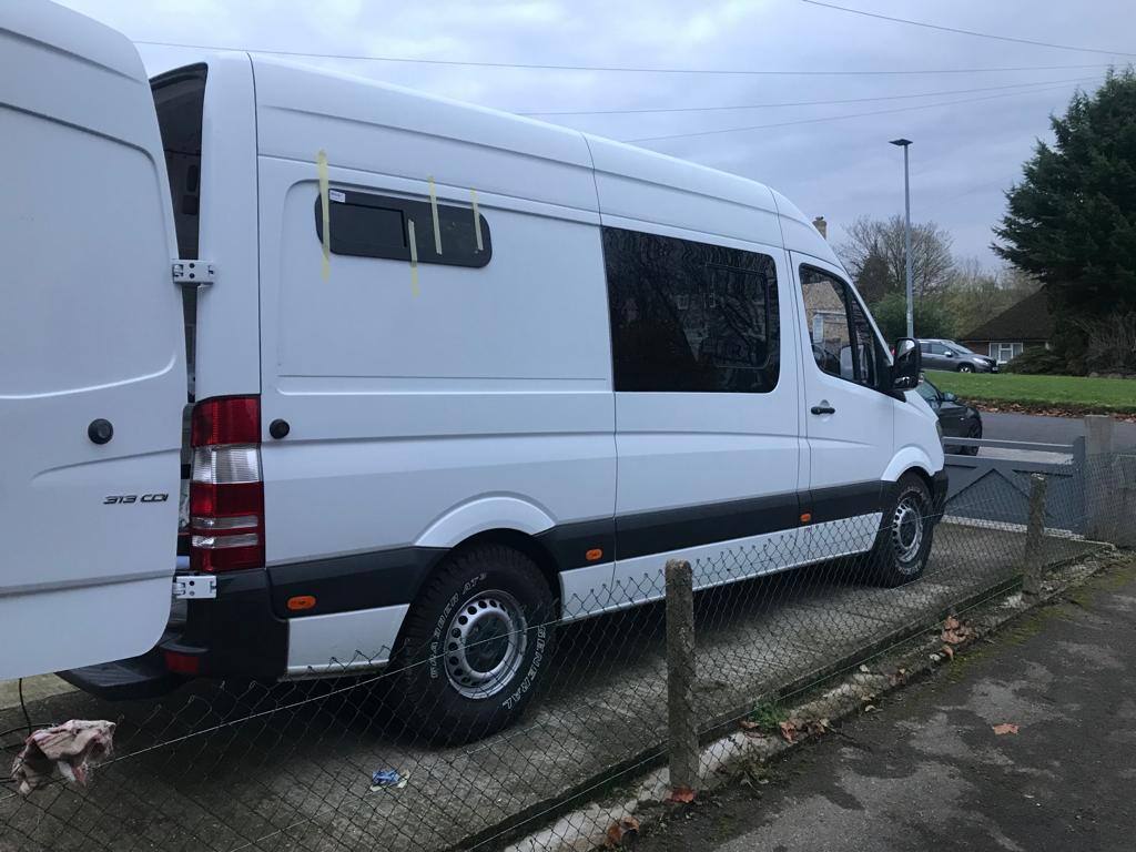

I put up a wanted the other day to see if anyone had any campers for sale, as it turns out, a quick check of FB marketplace turned up this remarckable Van. Not a single spot of rust on it! 2.5 CDTI, Its Blue, and it has 167k on the clock with cam belt change 1000 miles ago  (paperwork to prove) and runs lovely!.  MOT until December so thats not bad!
Its a Medium Wheel Base version and we are going to turn it into a camper, I have already put in a seperate battery and added lights in the back so I can work on it when it gets dark!
No rear windows so I think that will be the first task, to get those fitted to DVLA guidelines and then get the rest of the guideline things done and see if we can re-register it in terms of logbook.
Will be an interesting project thats for sure.
Oh Yeah, forgot to mention... it cost me £1800.
First task has been done today, Bulkhead removed!,
Surprisingly, have gained another 3-4 inches in the back!
Secondly, battery added in the rear (Plonked in for now) LED strip lihts running off of it so I can work on it in the dark if needs be!

The only thing that worries me is the new DVLA guidelines for making it a Camper in regards to its classification....
I need to figure out exactly what this means...
2 or more windows on at least one side of the main body (this does not include windows on the driver or passenger doors) to provide a reasonable amount of daylight into the living accommodation
Possibly we will need to have 2 Windows on one side, so one in side door and one behind it. For it to qualify.

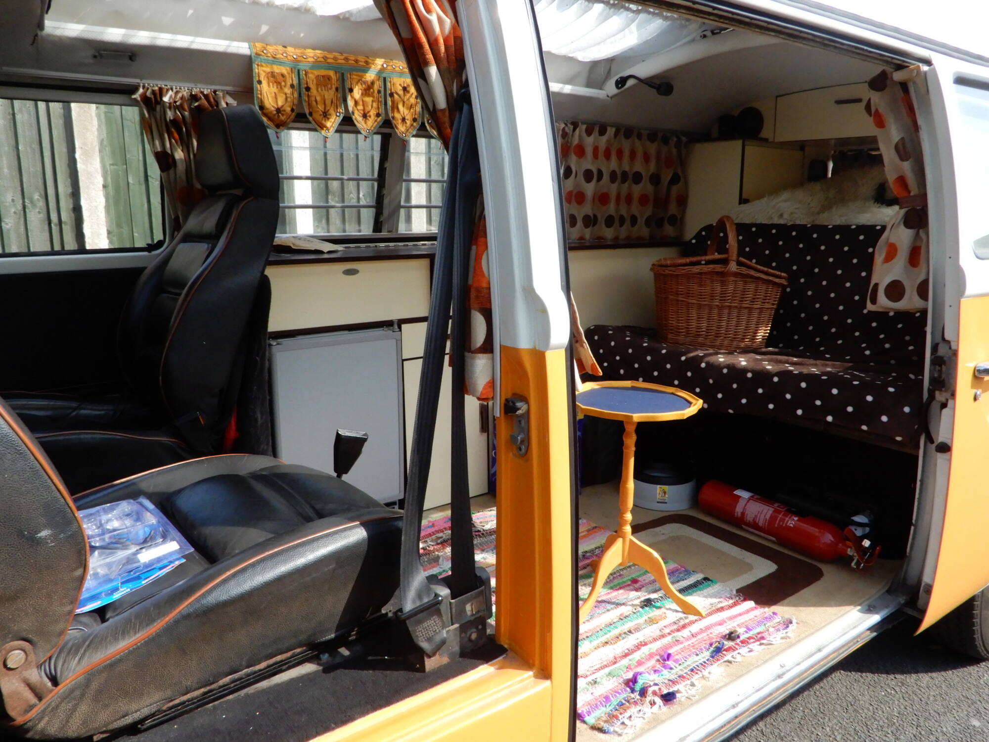

I have Porsche 928 seats in my bay, I bought a base from Bluebird Customs for a T3 & left them with my tame VW bloke.
This is the only pic I have to hand.

SitRep regarding registration/classification etc.
SO with DVLA guidelines and reading on groups/forums, it is easier to register a self build as a van with Windows, but places like AdrainFlux WILL insure you as a camper van, I just got a quote from them for less than £500 for the year... (£427 to be precise) with me and the wife covered. Thats covered as a camper van conversion on the policy.
This may be the route we take to get it registered, just need to figure out how to get it registered as a van with windows, and actaully fit some Windows (on the hunt now).
Follow the thread to see how we get on!
In the rods of Clarkson..... This will be a good one!
Ref van with windows, it seems to be what people get back when they have tried to register as a camper but not met the current, seemingly way stingier guidelines.
Typically this is for lack of high top - a pop top does not count.
So just apply for camper classification and see what you get.

My brother is converting a van into a camper too,  he only wanted one window but had to fit two on one  side . This was the smallest he could get away with, my suggestion of some opera windows or portholes like a dralon lined 70’s Transit, were dismissed.
2 hours ago, cpjitservices said:
This does not mandate two windows, so it may be that your application would be approved (especially if most or all of the other criteria are met) with less.
Interesting, there are people on the forums and FB groups saying they have be classified as Van with Doors as reclass as Camper is hard to get even if you do have the guidelines done.
