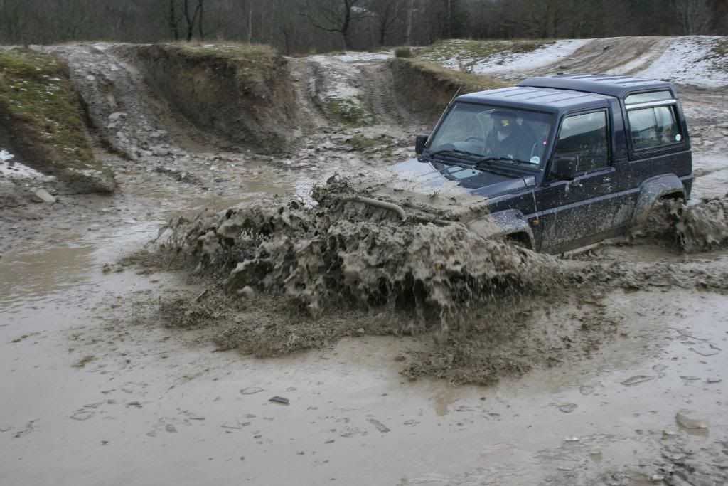

I thought mine had silver arches as well but my memory let me down, they were body colour in blue. And mud.

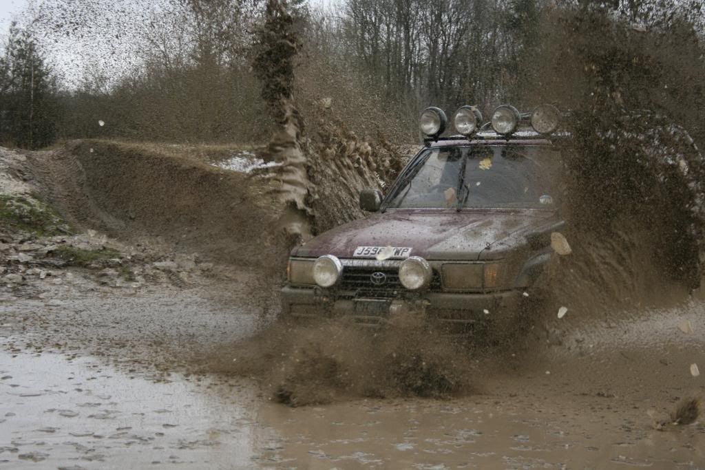

Paintwork was unbelievably tough on it, got loads of bush / tree scratches on it yet a thorough machine polish a few times a year saw it gleaming
My mate had to go one better than me through that mud/water hole though. One of the better pictures I've ever taken, even if I did get showered in muddy water and chunks of ice...
