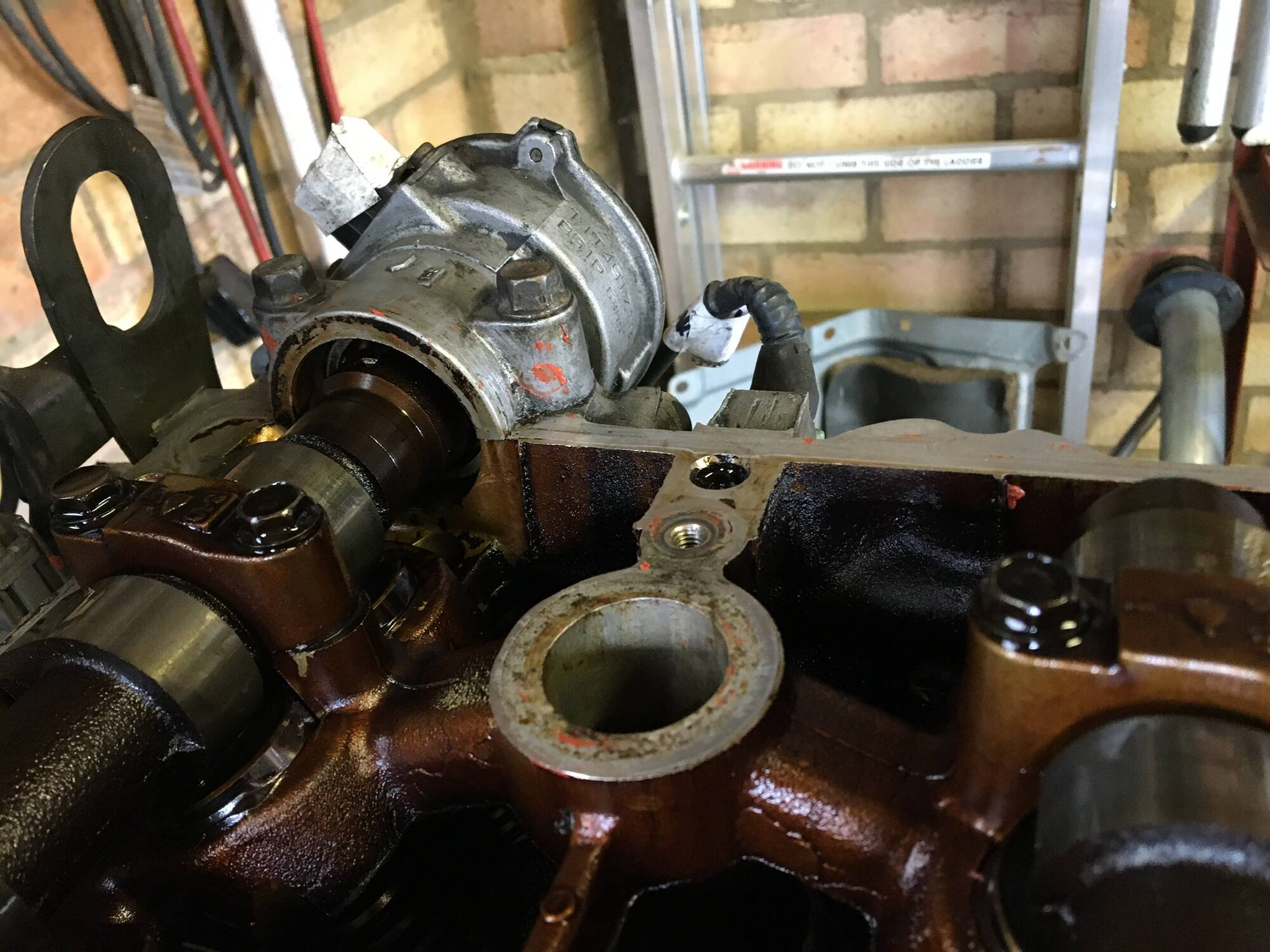

^If it's down the back of things then that's almost certainly the CAS o-ring (The part the learned chap above has linked) Feel the wiring that comes from the back of the cam angle sensor, if it's wet with oil then that's definitely what that's all about.

If it is the CAS seal, get it changed sharpish as it leaks onto a coolant pipe for the heater and rots it causing leaks. BIG leaks...

I reckon it took me about 45 minutes to get the sensor back in place with the new seal, but what a feeling when it finally clicked in! I can remember it vividly about ten years later.
Before you remove the cam angle sensor, mark a line or notch across the join so when you refit it, your timing will be correct.
try not to move the spindle as it only goes back in one way - that bar is slightly off centre so it won’t fit 180o out
Easy enough but if you want to bring it through we can check / adjust the timing at the same time. If your heater pipes are in a bad way, you can have the ones off the donor mx5, they are no use to me anymore :)
