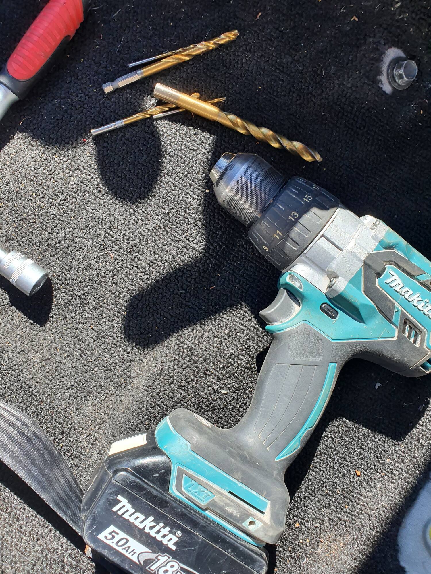

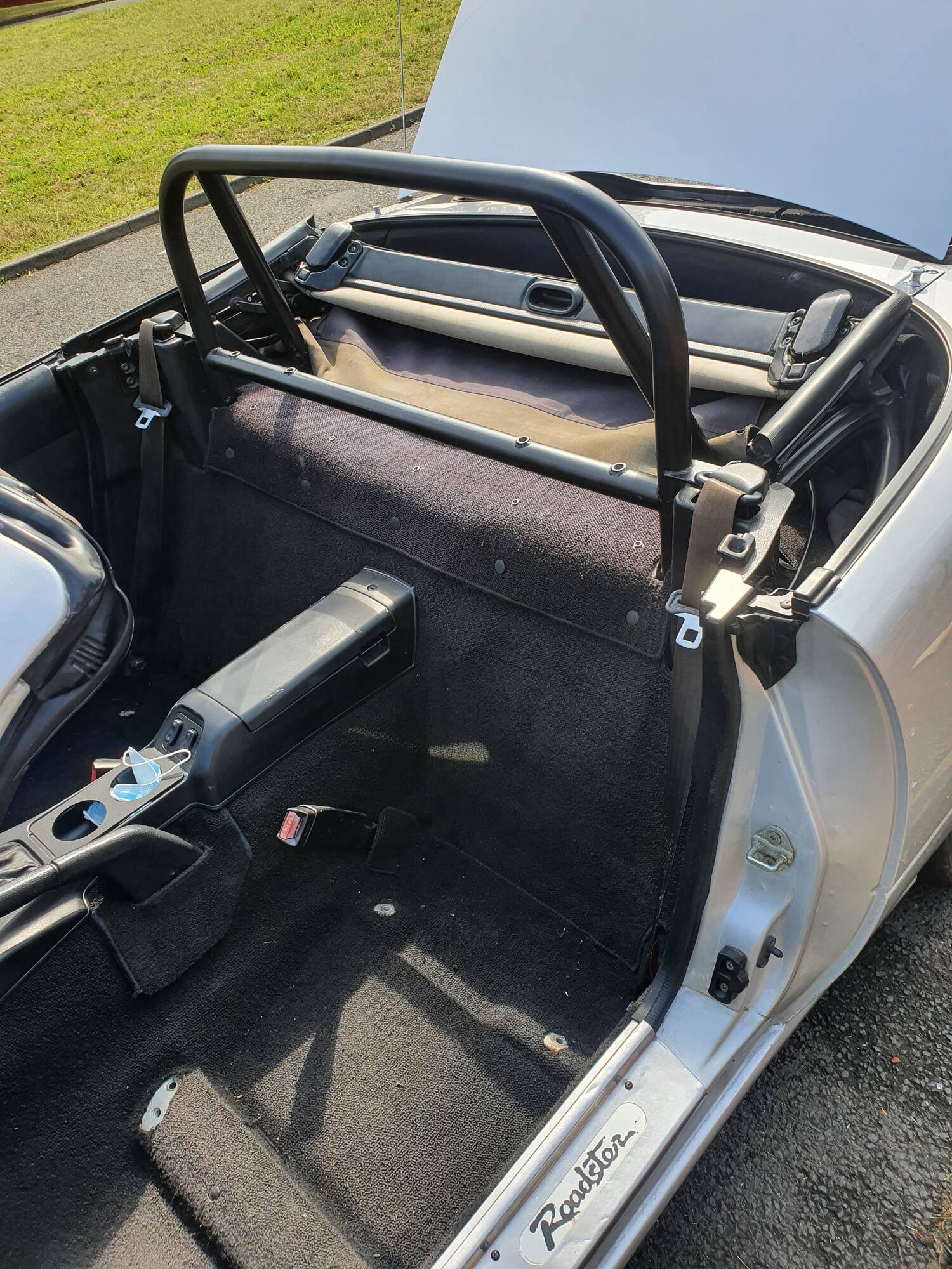

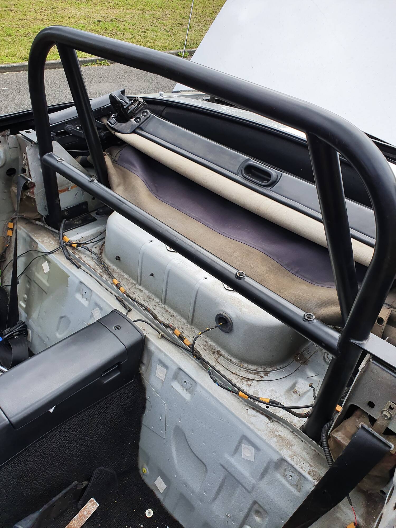

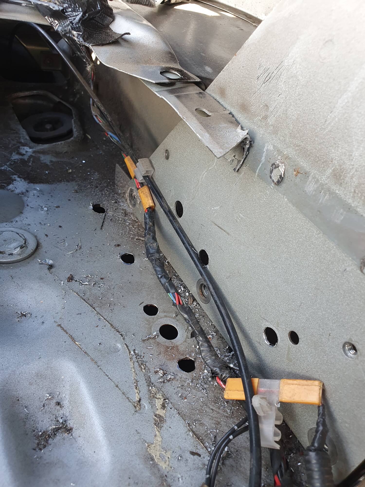

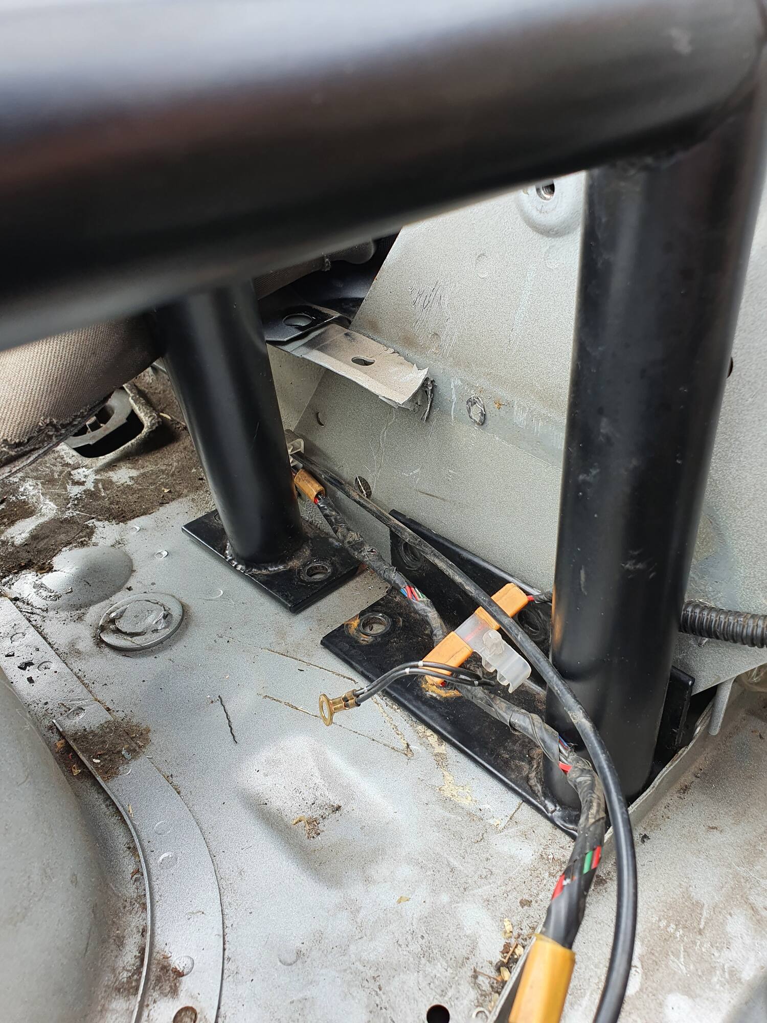

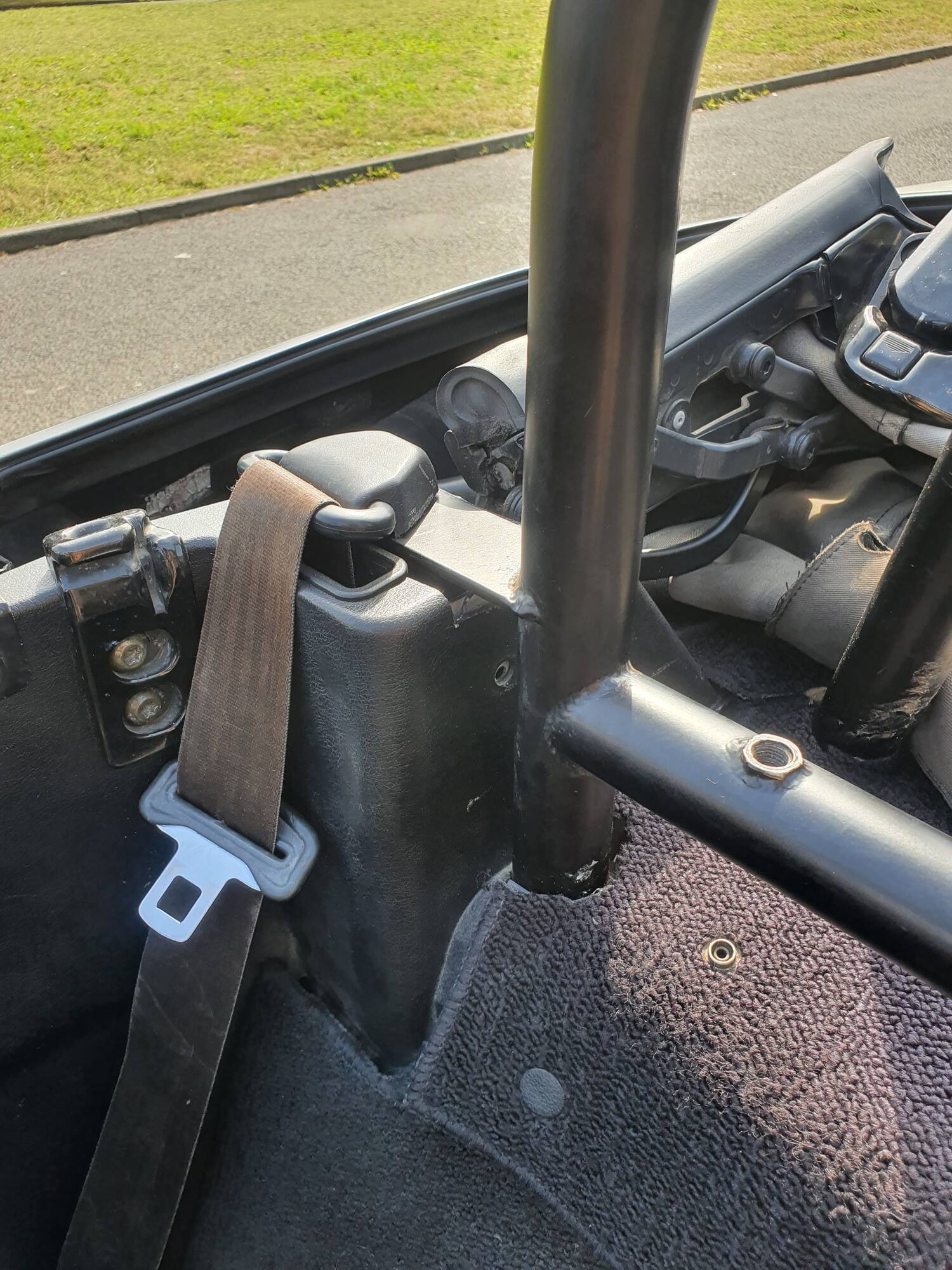

After a bit of a struggle it was finally in. I marked all the holes up and took it out again.
I bought some proper quality bosch hss drill bits in a fancy tin. Like you'd get in a fab shop. That was about a month ago and can I fuck find them.
It looks like I'll need an angle drill to get some of the holes too as the roof/metal panel is in the way.
I've packed in now as it's stupidly hot and the sweat keeps running in my eyes and affecting my vision/making me very angry.
an angle drill would be handy but it can be done without one, just go in from a bit of an angle.

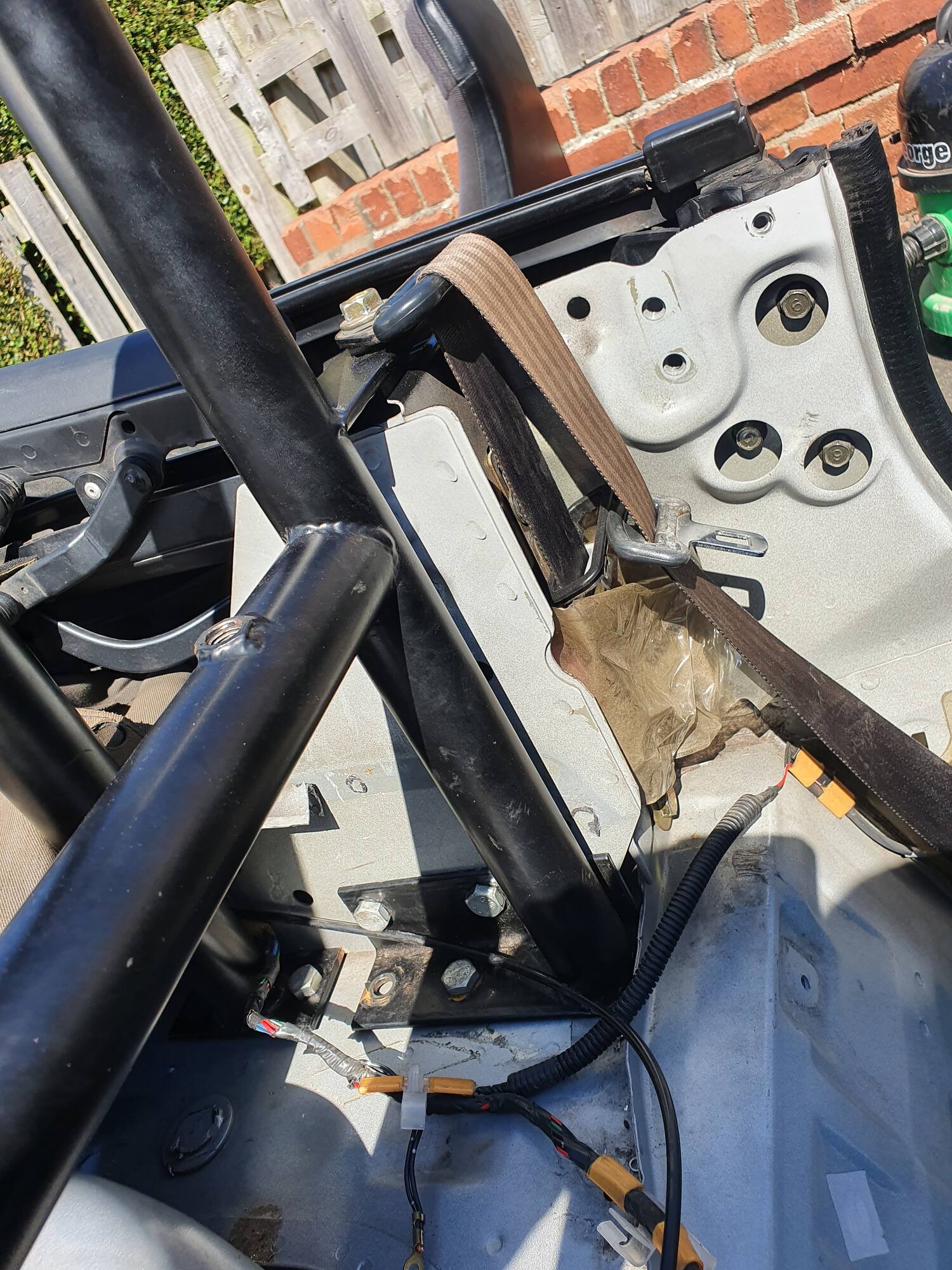

you'll need to remove those seatbelts too, and the wheel arch liners, it’s great fun* trying to hold spanners on both ends of the bolts through the chassis :) have a fun day tomorrow - it’ll all be worth it

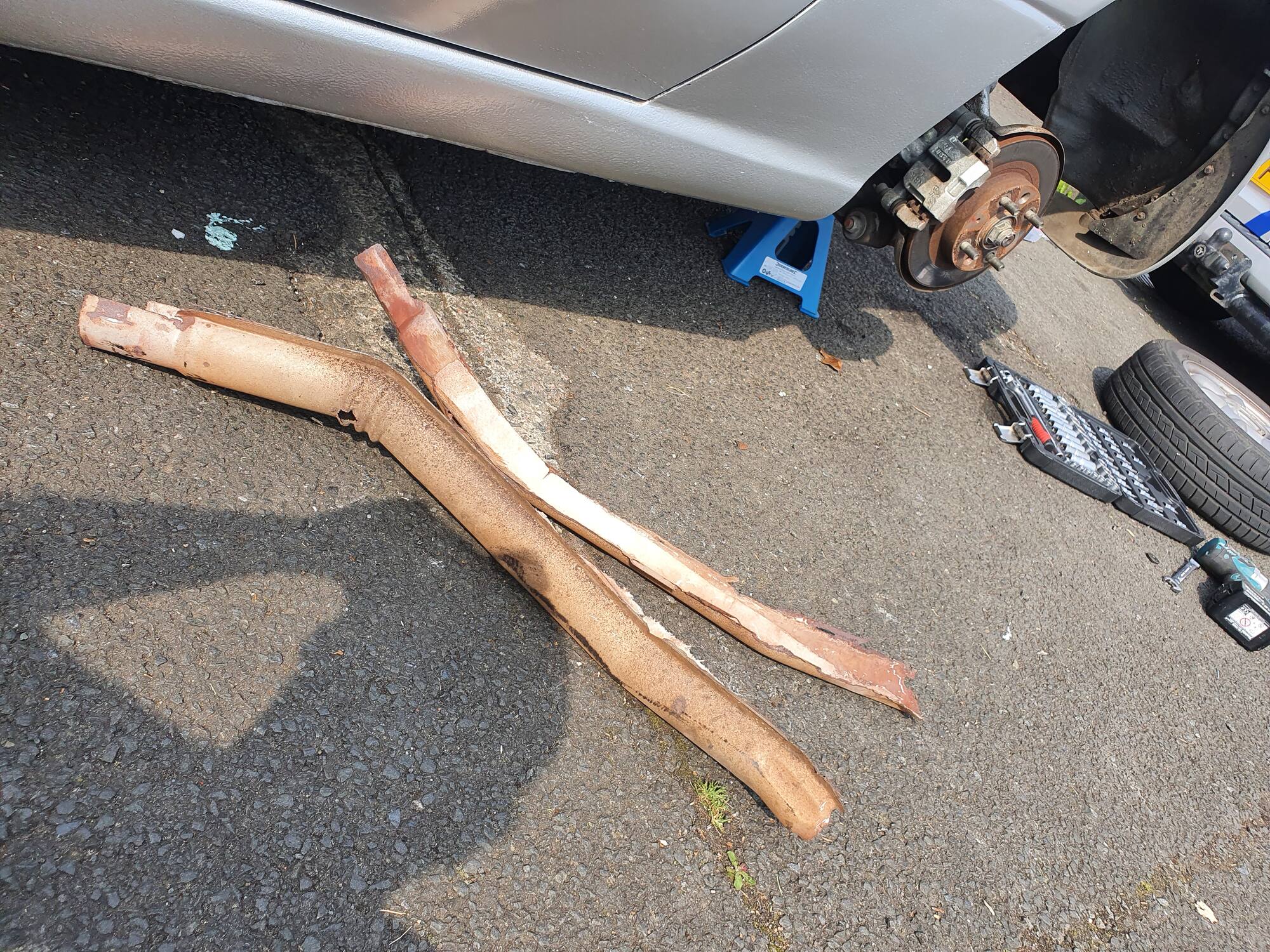

Caucht my bastard finger on a chiseled spot weld ffs.

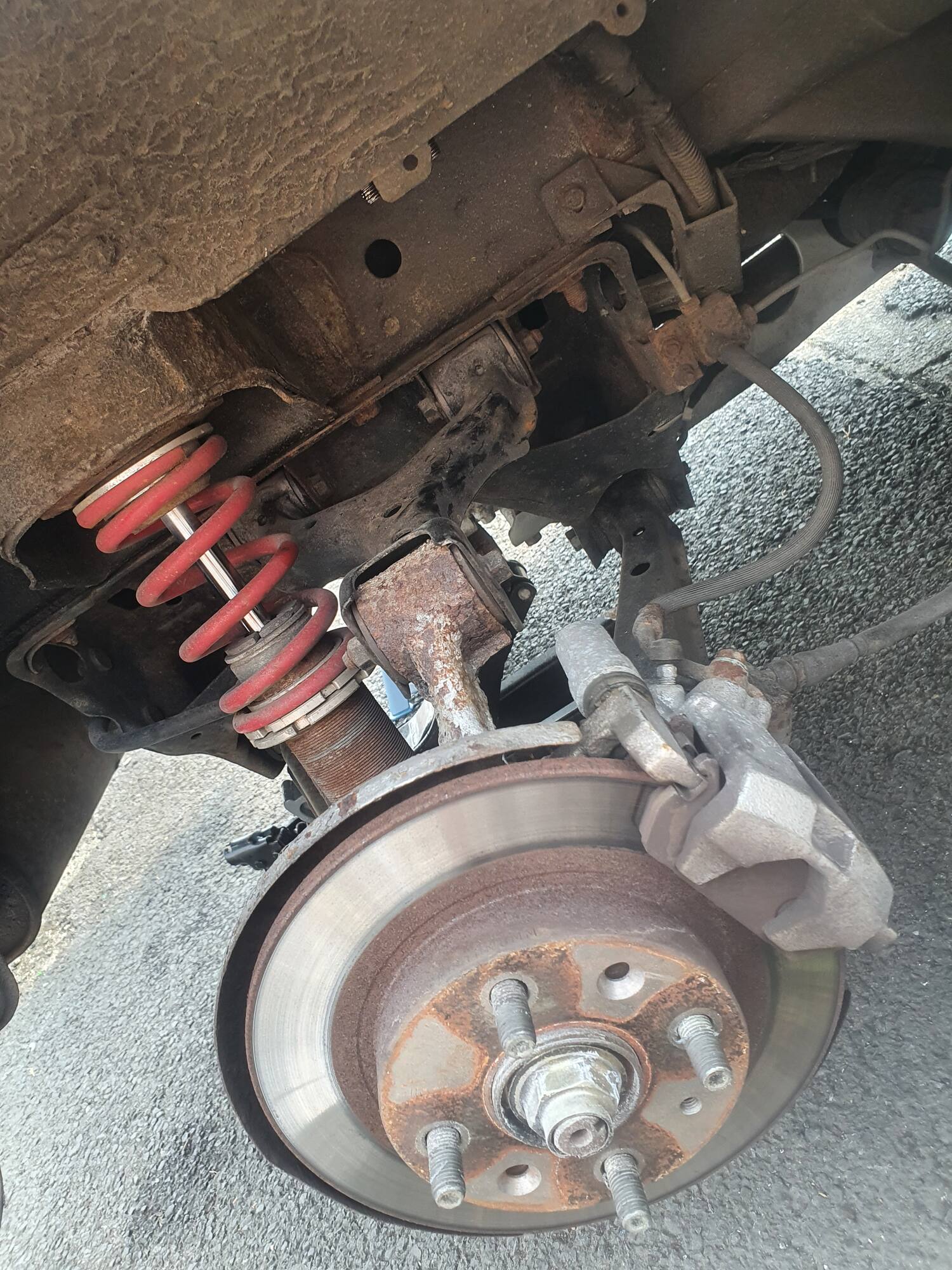

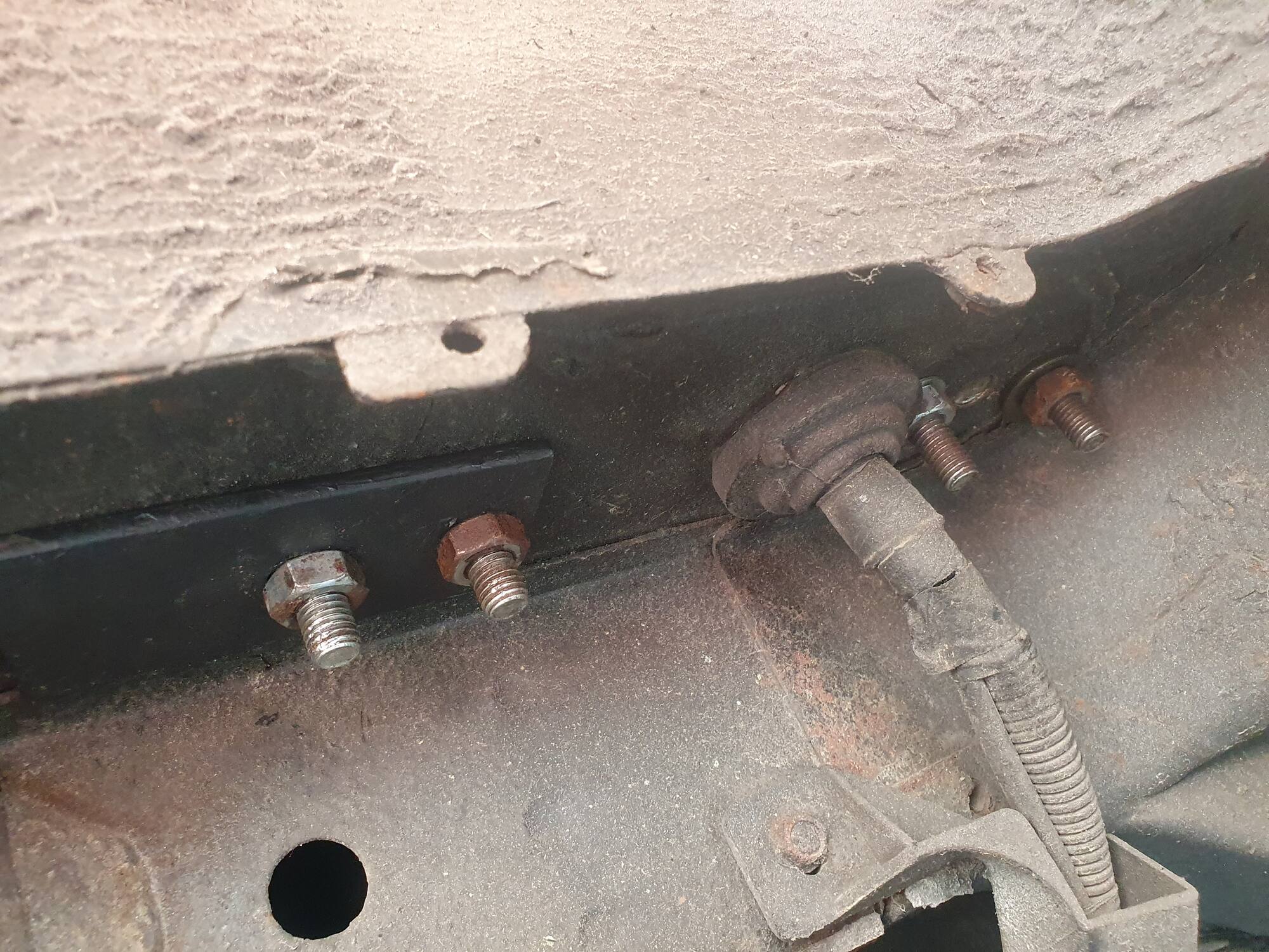

All the bolts accessible from the top have been fitted along with the seat belts. The roll bar is also bolted through them.
Next stage is rear jack up, support and wheels off.

Bolts all done now. Inc SPREADER plates.
I think I've just found the reason for all the annoying drive train rattle. After quite a bit riving, on it fell off.
Wheels back on and I'll have to take in on a test drive now the sun's out.
The roll bar is all finished. I just need an hour or two to put it all back together. Not now though. Now is beer time.

when you refit the seatbelt trim panels, you’ll need to chop a section off to slide between the roll bar and the seatbelt tower - should be easy enough with a dremmel type tool - or if you can’t be arsed, just swap them with the ones on mine that are ready cut
Yes, I found that out. All done now apart from the seats. Took about 6 hours in total and was 4 out of 5 on the bastard scale.

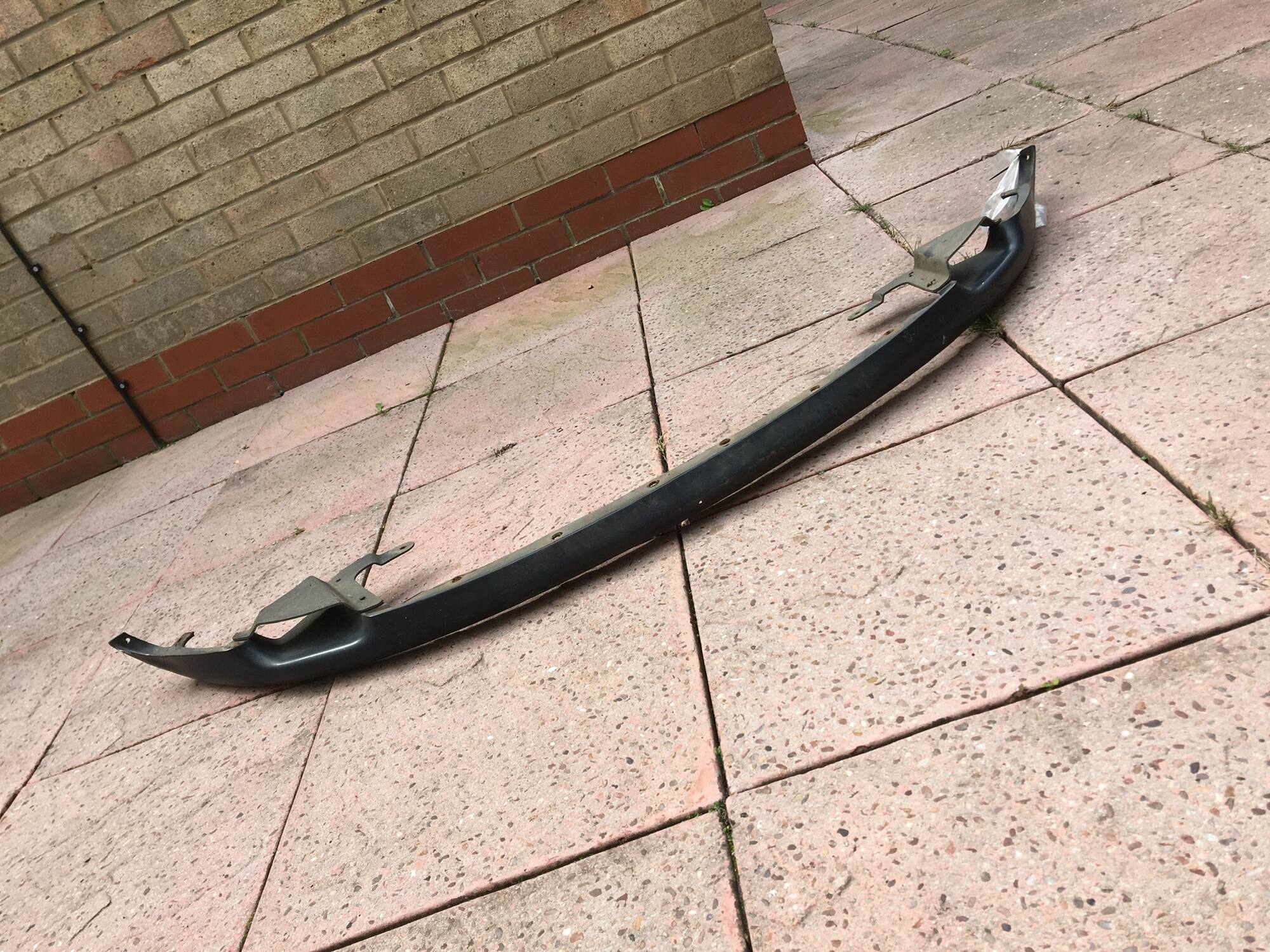

Any mx5 lickers out there looking to smarten up their front end lighting ?
2 x Crystal clear headlights, 2 x clear sidelight / indicator units, 2 x (mildly grubby) reflectors and a single side repeater (the other one went on an adventure and hasn't come back :( )

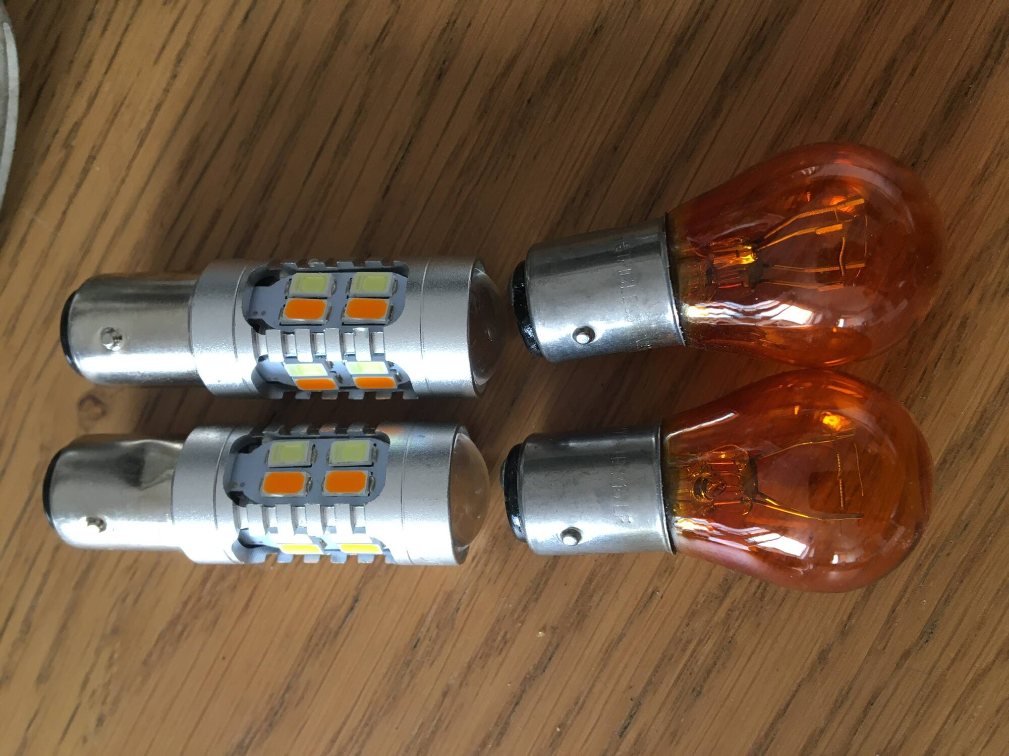

the sidelight units are US spec with twin filament orange bulbs, glow dim orange with sidelights on and flash bright orange when indicating. Or fit the modern, stylish* switchback led bulbs, bright white as a side light but the white goes out and they flash orange to indicate, cheesey but quite smart at the same time. Needs a relay mod but I have one to swap.
the headlights are a good upgrade on the standard lenses, bung in some decent bulbs and night driving is no longer a hazardous activity in the mx5 , I ran them with yellow tinted bulbs which were shit but looked good
the sidelights are (as far as I know) not MOT compliant but I just put my old ones in on test day
£50 for the lot, shiters price

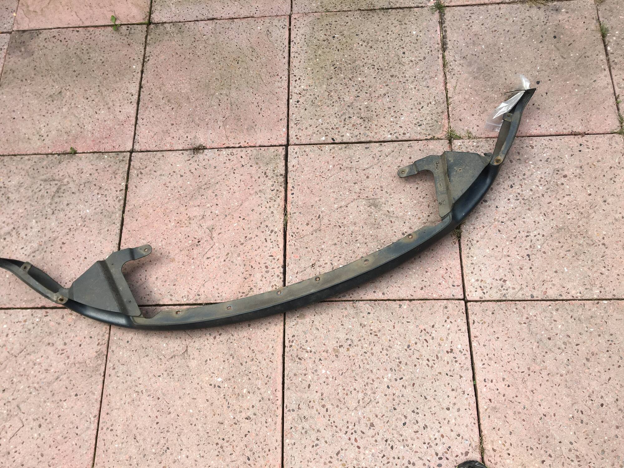

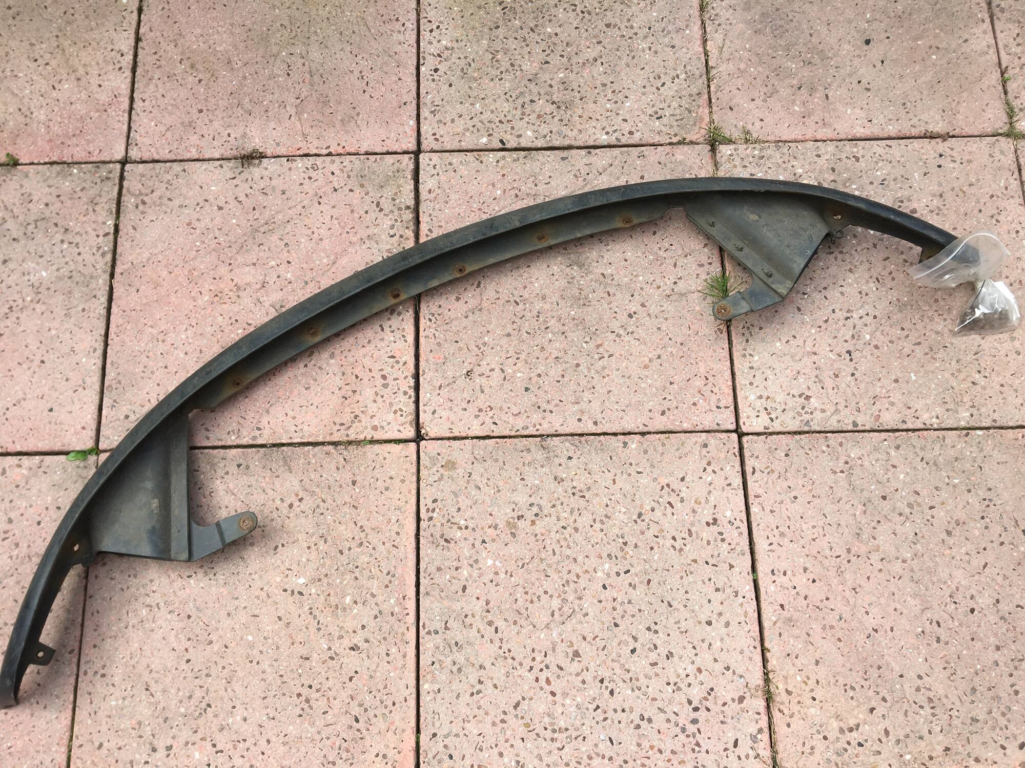

Or how about a chinny, chin, chin, chin spoiler ?
bolts on the bottom of the nose cone and literally* guarantees* better lap times
