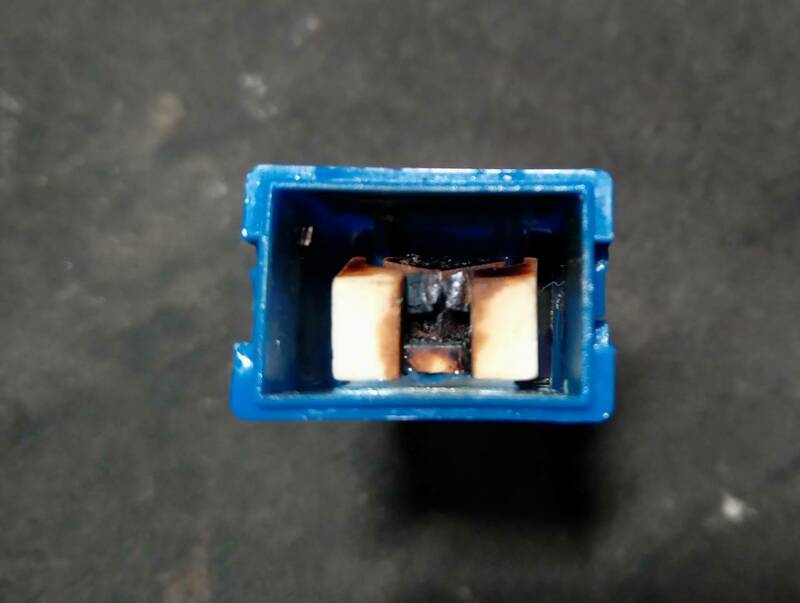

A second FTP.
Another distinct lack of electricity. This time outside Tesco. A quick investigation showed the main 100A fuse has decided it didnt want to play anymore. Fuck it, phone the RAC again. RAC woman said 3-4 hour wait, so I walked home and had dinner while waiting. Went back a while ago and RAC dude promptly appeared. Took him over an hour to swap fuses. He did a quick electrical check and couldnt find any leakage so put it down to "old age". Happily paid the £5.99 for the new fuse. :D

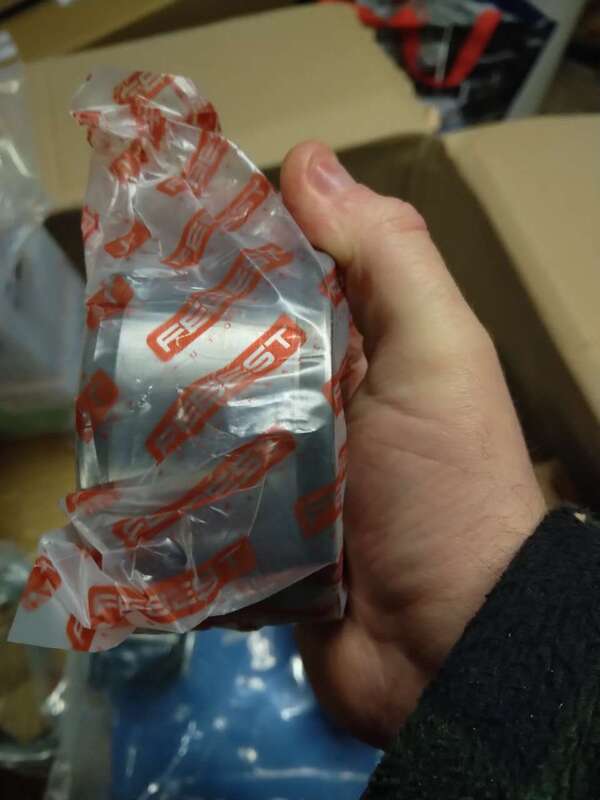

The nice people at Rough Trax have sent me a very heavy box containing lower wishbones, ball joints, inner & outer CV joint boots and a pair of wheel bearings. Dropping it off at the garage this afternoon and hopefully back by the weekend. I have added a box of motivational cakes. :)
The wheel bearings are particularly impressive and very chunky items.
