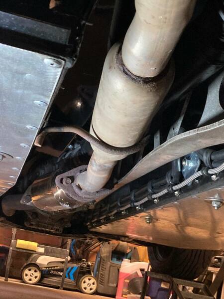

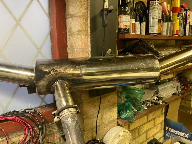

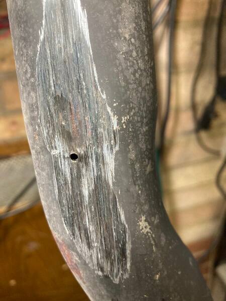

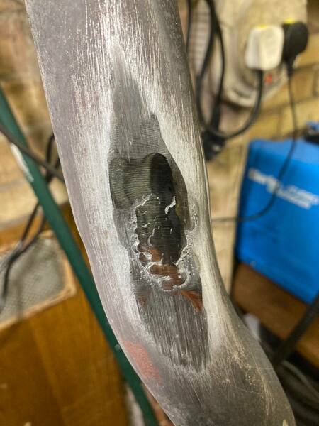

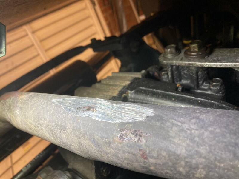

during yesterday’s hooning, i managed to bottom out the Exo a couple of times - so i thought i’d better check underneath for any damage
hmm, bit of a scrape on the exhaust there
i have a decat that i’m planning to fit so might as well take it off the car for a better look
hmm, that’s pretty bad
almost looks like a hole - better give it a prod
bugger
fetch the mig
fetch the grinder
add a sacrificial plate over the top
and then notice the true extent of the damage
yep, that’s fecked !
i’ll see if there’s any kind of warranty as it’s only been in use for a few months, only snag being i bought it off another exo builder, not direct from mev.
if not, i’ve got a lead on a local custom exhaust place that may be able to help.

The Stainless box will weld up easy. Happens all the time with Stainless.
Just needs a couple of triangular plates for extra strength.
My Robin Hood did the same.
Plus one on that. Useless fragile awkward shite. On the plus side its reasonably rot proof (dependant on grade), but other than that little to say for it (I work with it a lot cos paper Mills and wet humid environment. Makes you look like a welding god though!

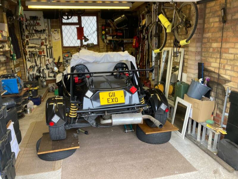

i wanted to keep the exo mobile - desperate times call for desperate action ! this is the standard mx5 exhaust i kept just in case
might need that hanger ‘adjusting’
sorted !
ridiculous and probably not legal but will allow me to drive to the exhaust place without sounding like a bell end
but as it was pissing down, i chucked the broken bits in the boot of the mazda and headed for exhaust mania in bishop auckland
looks like i’m in the right place
do you do repairs, mate ?
yes, very good ones, as it happens

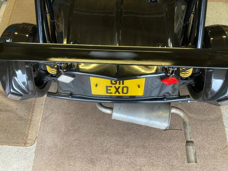

i’m taking it back next week for him to weld in a flexi joint - he wasn’t happy doing it off the car, wants to get it perfect.
i nipped into lidls on the way home and picked up a can of high temp paint, might as well get the centre section looking right before it goes back on
https://m.facebook.com/100057579252971/about/
11 minutes ago, big_al_granvia said:
tig welded??? looks great
certainly is, took him no time to do it, obviously a skilled chap.

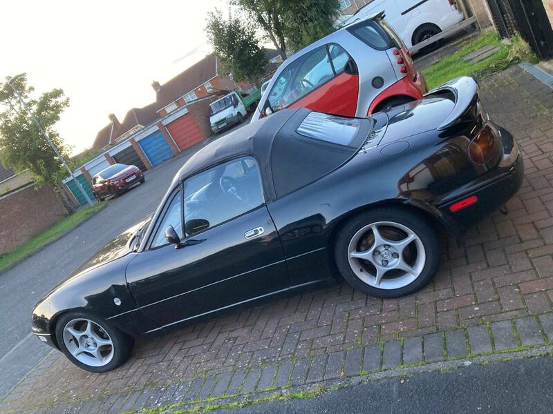

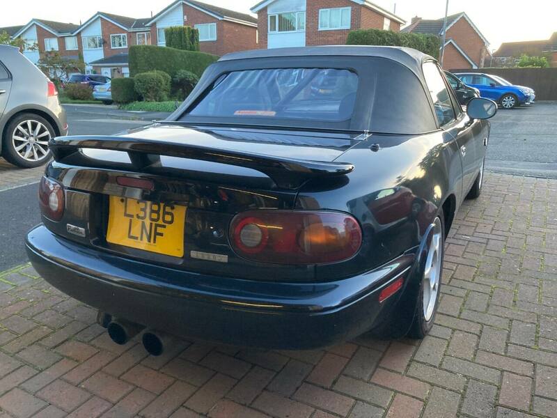

a post appeared on an mx5 group from a lad down south who is restoring a mk1 and wanted a boot lid without a spoiler
i jokingly replied i would swap mine if he didn’t mind a four hour drive :)
turns out, he didn’t mind at all !
much better :)

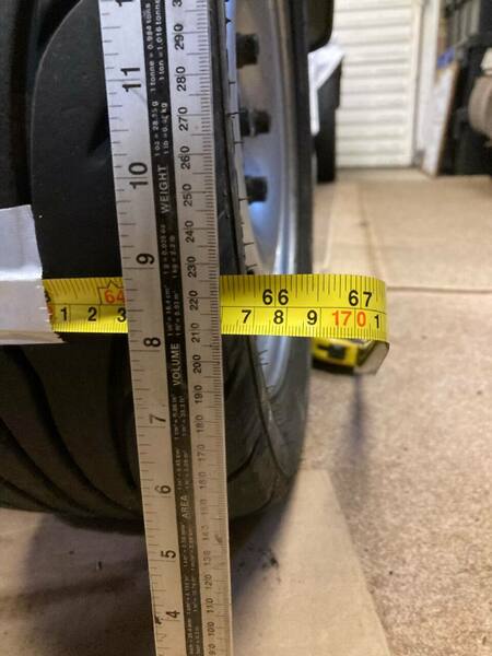

when I first put the Exo together, I fitted a de-powered steering rack. this was fine but then I found a proper manual steering rack and fitted it instead. now I've done a decent amount of miles, curiosity got the better of me and I wondered which I would actually prefer (apparently the racing Exocets have a preference for depowered, slightly fewer turns lock to lock so a bit quicker)

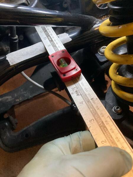

so with some careful measuring
I centred the depowered rack
centred the steering wheel
and 'clamped' it in place (this worked much better than it had any right to)
and whipped off the manual rack
and with a not unreasonable amount of fannying about, got the new rack on and set up with millimetre precision
only one thing left to do...
head for the hills and commence hooning
and the verdict is...
yeah, they're probably right - it's a bit heavier at low speed but it definitely reacts just that little bit quicker when pressing on, especially when the back end goes light on cold track tyres :)
great fun !

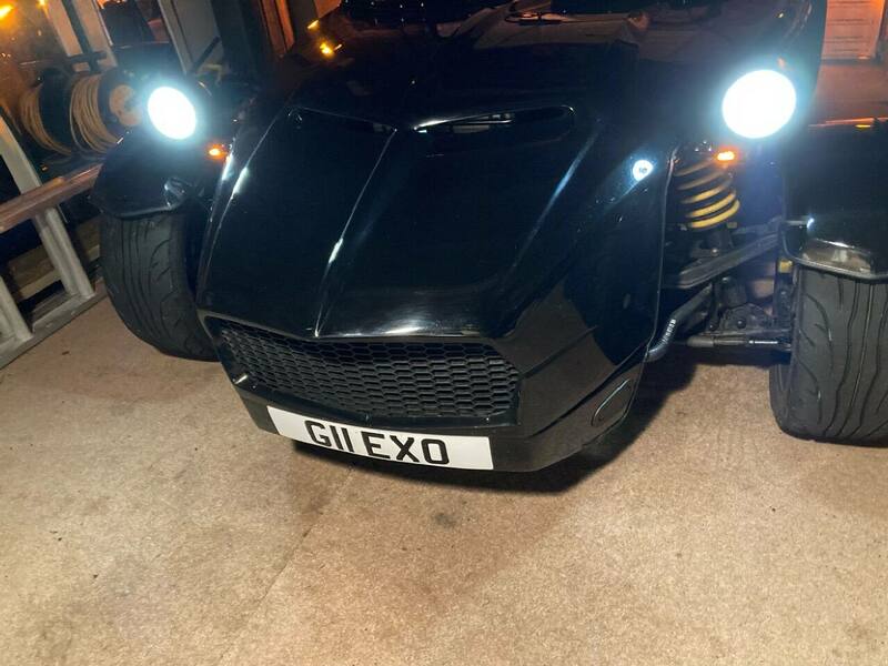

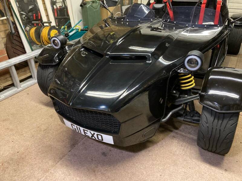

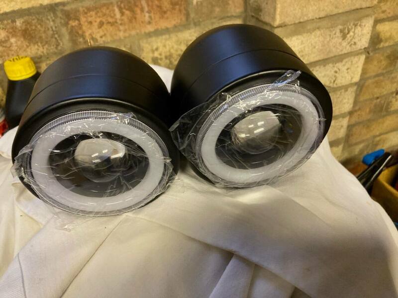

I was out for a drive a few days ago and it got dark earlier than I expected - not a problem in the mx5 with its futuristic led headlights but not so good in the Exo with its piss poor candles in a jar
even with night breaker bulbs, these just aren't much cop - time to find an alternative
look at these and try no to think of the Minions :)  a set of motorbike headlights might work, the bowl looks to be just about the same size as my current set up
1413122550_ScreenShot2022-10-15at17_41_06.thumb.png.976070890255fb041b445e35ef914a7f.png
one week later

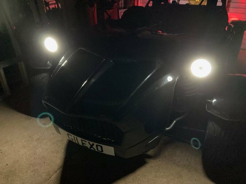

should be a straight swap
not quite a straight swap but with a little bit of fettling
apply volts
more volts

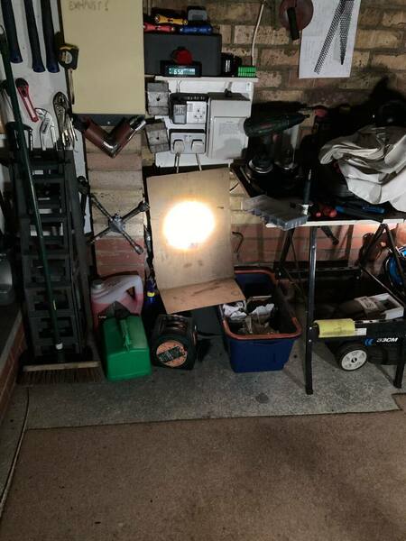

they provide dip and high beam, not by clever optical manipulation or extra banks of leds but by simply driving the full array brighter

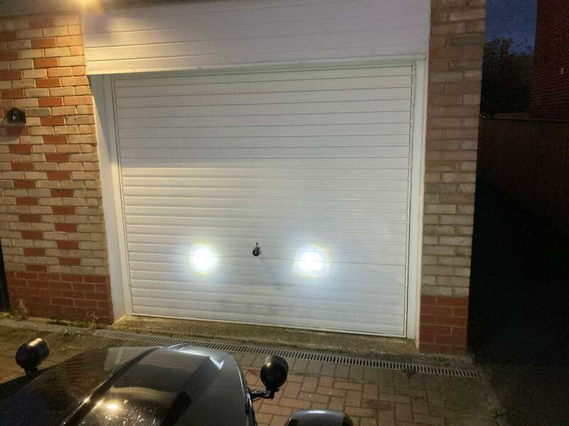

I'll knock the garage lights off and see how they look
pretty good but how about the all important beam pattern that caused so much trouble at the iva ?
hmm, not quite what I was hoping for
I guess I'd better keep hold of those 7" halogens, just in case !
bloody bright though :)
I just need a combination of dark / not at work / not pissing it down and I'll get out there and test them properly
  • gm changed the title to gm's unhealthy obsession with mx5s - cheap ass ebay headlights ftw !

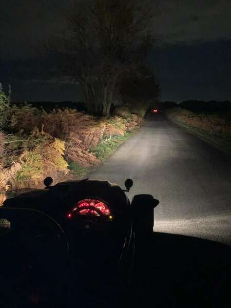

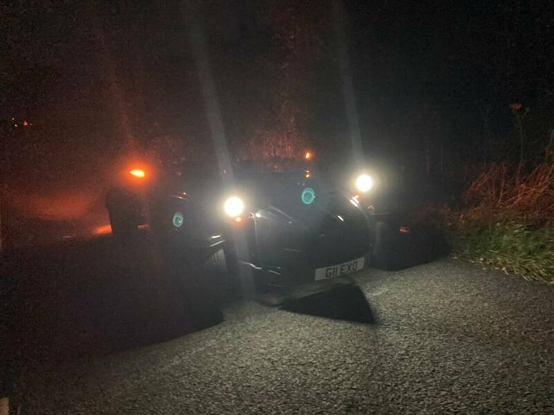

dark / not at work / not pissing down occurred tonight so a night time hoon was hooned :)
a dark section of empty road was obtained and i did my best to adjust the fancy new headlights
and the verdict is : total pish !
they look to be pretty impressive in the pic but on an unlit section of dual carriage way doing 70* mph, they are woefully inadequate :( same story on the back roads, the beam is too narrow so corners are pretty much guesswork.

a blast down the A19 in the dark amply demonstratored just how pish those headlights are - something needs to be done pronto
  • Sad 1
way too narrow beam of light, raid the piggy bank and have a look at tweeks. shite legal halogens for the ministry man and rally lights for driving
i stuck the old ones back on for now, they’re not great but better than the leds

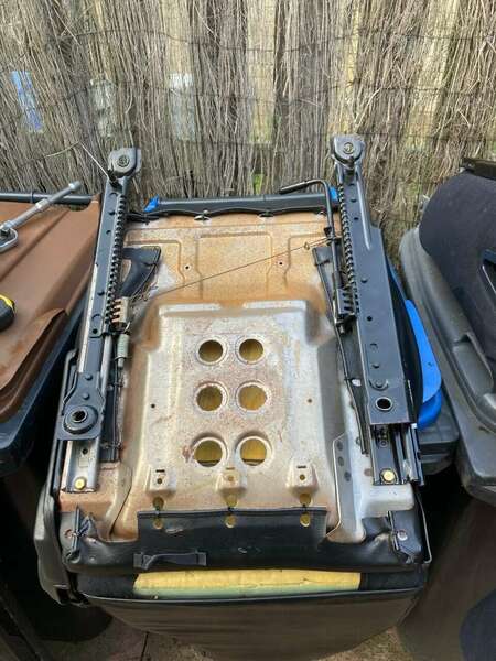

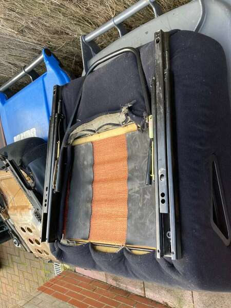

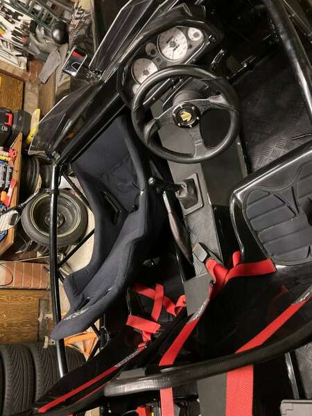

with a track day tomorrow, i bought myself a bucket seat for the mx5
getting it home was fun :)
all i need to do is swap the runners
which was a massive pain in the arse
after several failed attempts, i knocked up some adaptor rails
job’s a good ‘un

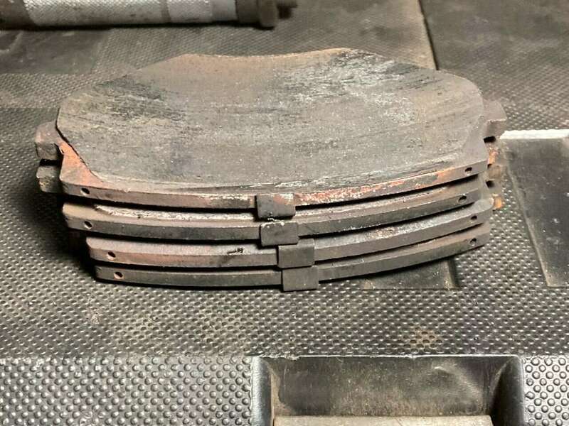

the mx5 performed well, only letting itself down when I ran out of brake pads an hour before the end - left just enough for the drive home
