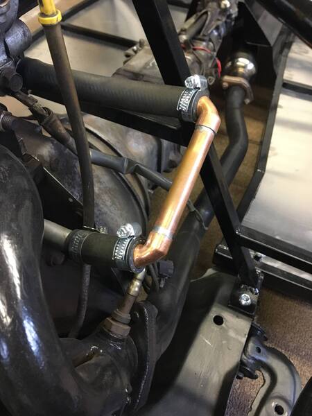

paulplom made me a 'steampunk' coolant bypass, neat but I might need to paint that one

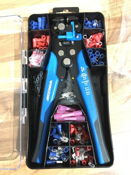

and as I'll be doing a fair bit of wiring in the near future, I picked up a crimp set at aldi's, looks alright for £8
That looks like one of those fancy pants PVC-sheathed cable strippers with a manual crimper built into the handle. A proper ratchet crimper would be much nicer to use.
I prefer to solder but it might come in handy, certainly better than the crappy crimper I've currently got.

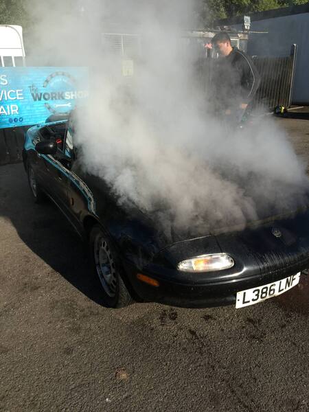

Shit!
Knowing GM though he'll nip home, get a spare radiator out of the kitchen cupboard and be back on track before the session is over.
Hopefully...
Link to comment
Share on other sites

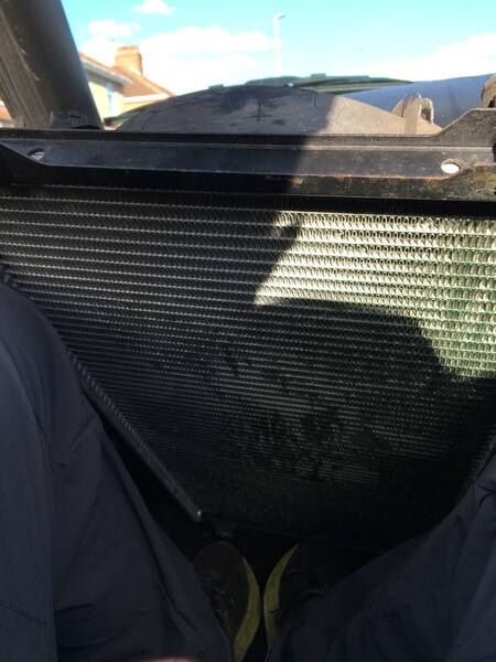

7 minutes ago, big_al_granvia said:
i have heard of things bein fucking fucked but that adds new depth to the phrase

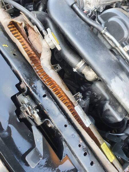

Yes, usually you might get a hairline crack in the radiator or a small split in a header tank that's hard to find when you're losing a bit coolant. This time it was quite obvious where the water had escaped from.
Link to comment

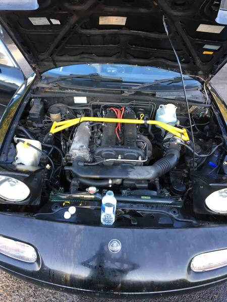

It went with one hell of a bang ! Glad the bonnet was closed or it could have been pretty nasty :(
top marks tonight to Andy? at mazdadudes who stayed late so I could leg it down to Darlington in co-driver michael's car - a new rad was obtained and we fitted it in record time, bled it up, did a lap of the car park and pronounced all to be well and got back on track. Still managed to squeeze in an hour of laps and the little mazda just kept on going  :)
So all in all, another successful tracknight, @paulplom looked to be having a blast, I'm pretty sure paulplom junior was enjoying himself and counting the days until he's old enough to have a go, my codriver was on track for the first time and had a lot of fun, I suspect he'll be taking his own next time now the bug has bitten.
i'll have a rake through the GoPro and see what I can find, sadly the rad explosion wasn't on film, shame it was some sight ! funny how folk react in different ways - @paulplom came running with an extinguisher, I stood back and took a photo !

I had this happen on a Rover 100 on the crest of the Dartford Bridge. I guess a ropey K-series in motorway traffic is a use as strenuous as a track day for a normal car, haha.
Do you think there’s anything underlying with this car or that it’s just a bad part? I guess a bad part because if the system pressure was way up you’d be venting at the cap then maybe  only blowing a hose off as the weakest link, not exploding the rad! Header tanks are normally glass reinforced to stop them splitting like this, was it OEM?
Link to comment
The rads are renowned for doing it on these. When the plastic changes to a brownish colour you're best off changing it sharpish. I need to do mine sooner rather than later.
I shall have to remember this for if my MX-5 ever turns a wheel again! Thanks!
