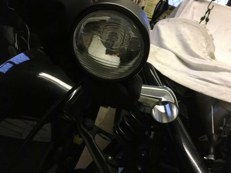

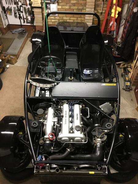

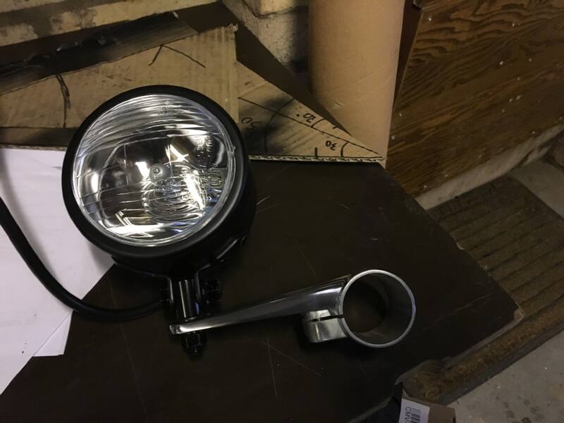

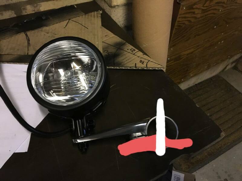

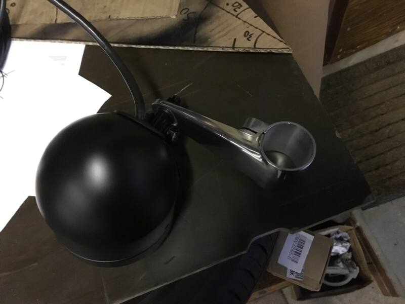

headlights !

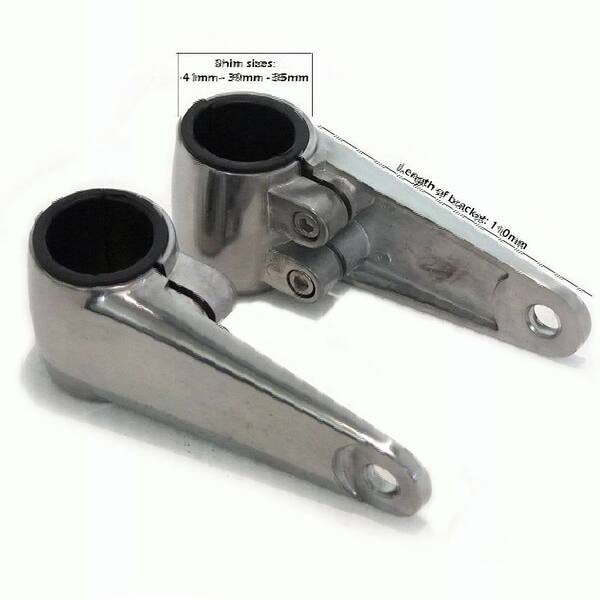

I found a lovely pair of polished aluminium brackets on eBay to fit the headlights
39mm, should be a perfect fit
ordered Sunday, arrived nice and quick today
really good quality, got them bolted straight onto the headlights
all I need to do now is slip it over the end of the frame and tighten up those Allen screws
cock !
cock, cock, cockity cock !
that'll be the frame that is welded at both ends then.
back to the drawing board, you fanny :(

16 minutes ago, Minimad5 said:

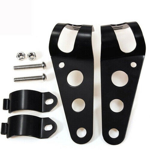

Can you not know know end off and get one of these .2019463854_Screenshot_20210203-214819_SamsungInternet.jpg.64946eb29d74d7a9c3d7f8990c036645.jpg
I could but that is one ugly bit of metal, I'll keep that as a backup plan :)
Or ..
Cut off the red bit.
White = bolts through the frame (obviously counter sunk, so IVA man doesn't have a fit)
on the same listing there were chrome ones but they were twice the dark ones cost 😮
Just now, Minimad5 said:
Or ..
vibration would kill it possibly
Good suggestion but ideally I'd prefer not to be drilling into that part of the frame if I can avoid it - it's a bit structural :(

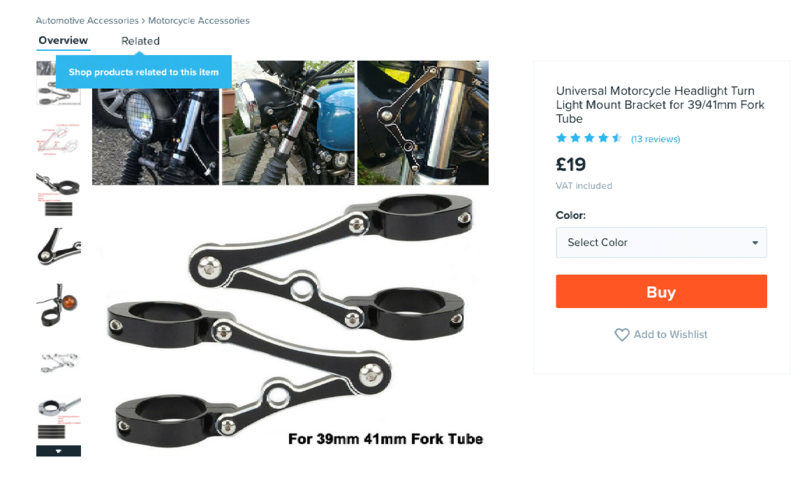

 these ones on eBay look ok
£27 from a uk supplier or £14 on a slow boat from china - like I say, I'm not in a hurry :)

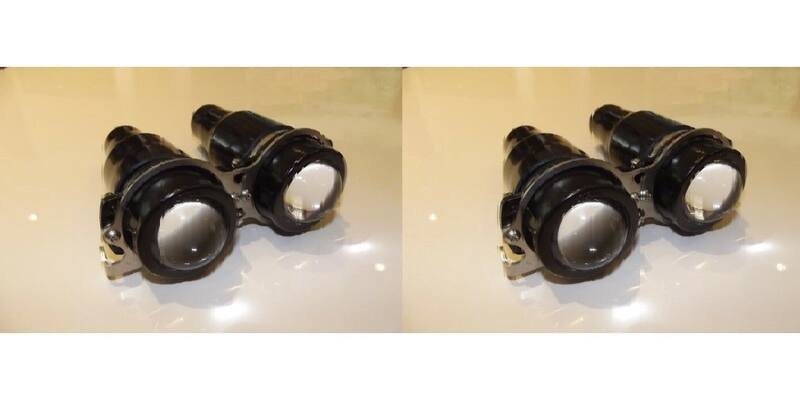

the headlights are reputedly a bit shit anyway - if I ever plan to do any night driving, I would probably need to upgrade
i saw some tiny round projector headlights
they looked good but i saw how much
i closed the page :D
you spend ££££ on things that live on the extremities
guaranteed they last a coupla days before they break or fall off or road debris smashu
these wee fellows are pretty smart but at £250 they will have to wait - there's an exhaust, a set of tyres and an iva all way ahead of them in the queue :(
8 minutes ago, big_al_granvia said:
osram nightingale bulbs do improve things. Used them on both Granvia and almera
I shall be nicking the ones out of the mx5 asap :)

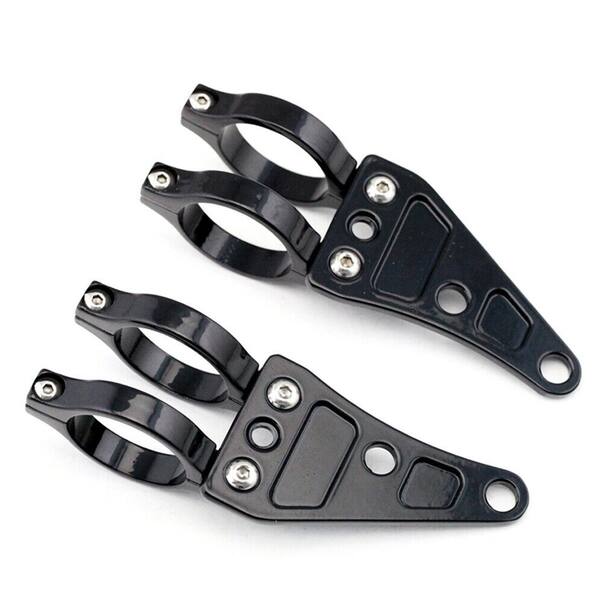

Those black eBay ones look quite good - they’ll match the rest of the chassis too. How is it they’re normally mounted?
some folk use these brackets but they tend to wobble about a bit
so need to be braced with something like this
I'm hoping I might get away without braces using sturdier (looking) brackets - I've ordered them up anyway so will report back in a few weeks time :)

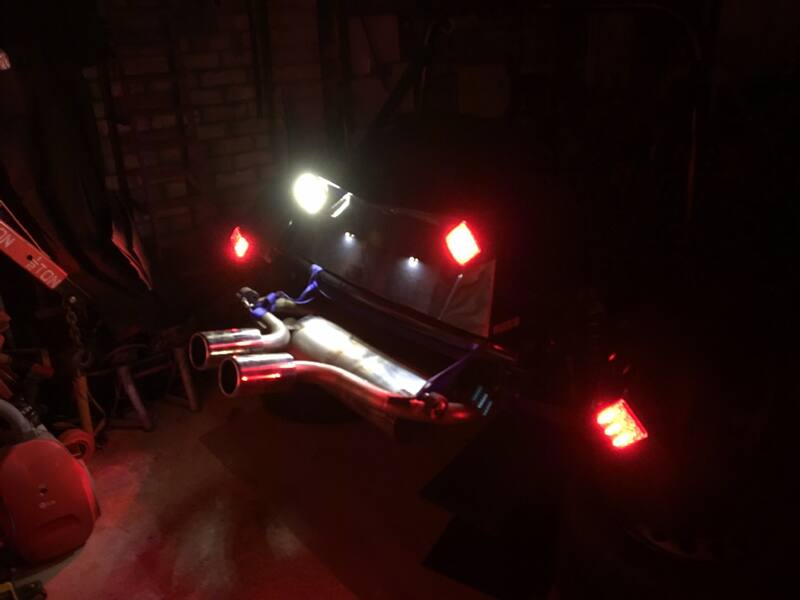

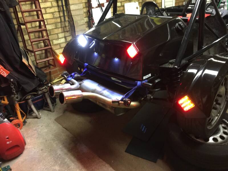

with the headlights on hold, I set about wiring the back lights now that the mudguards are permanently fixed in place
IMG_4653.thumb.JPG.7e3b35f28766d75e28909ef624f765c5.JPG\
hopefully will have some exhaust news in the next few days

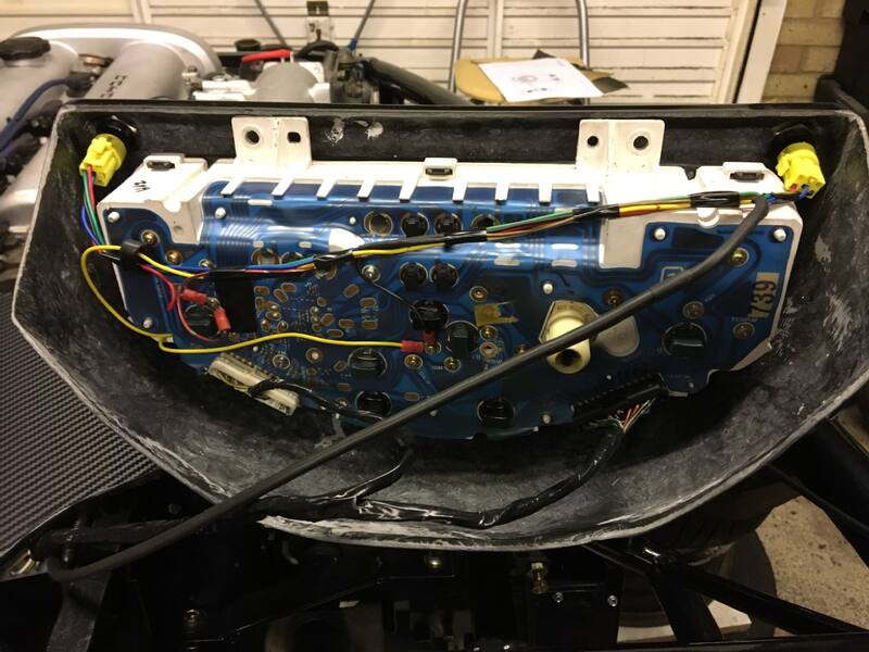

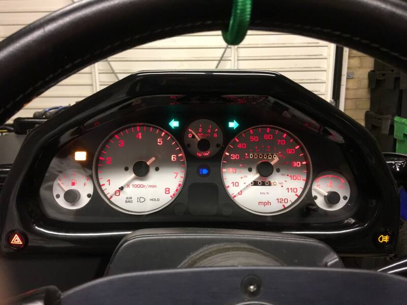

time for more of my favourite pastime - bloody wiring :(

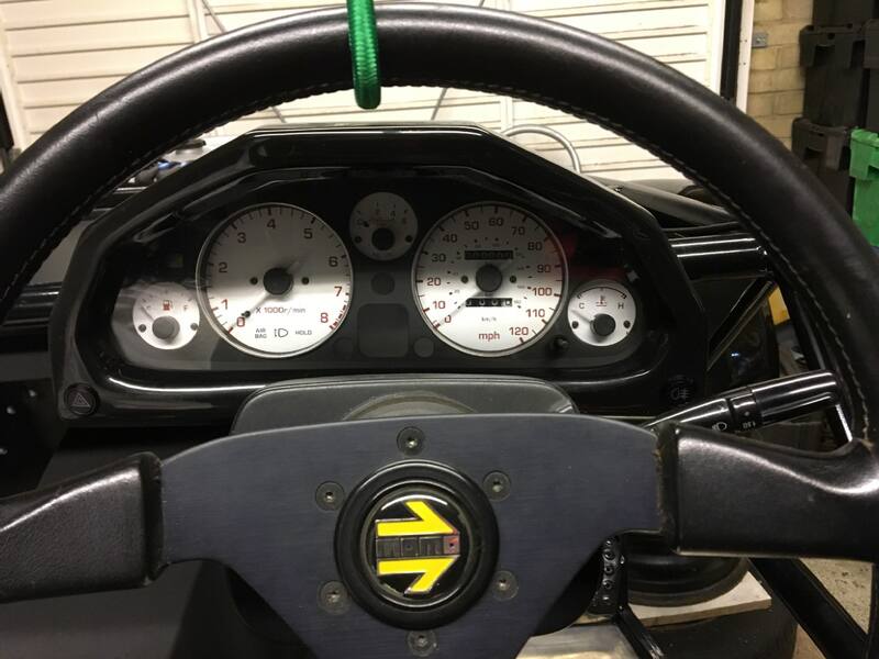

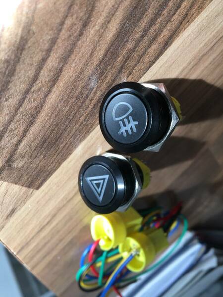

way back when, I bought a pair of fancy dan button switches for the fog light and hazards
which need to be mounted somewhere convenient on the dash (must be within reach when seated with harness fastened)
with a bit of extra careful drilling, they fit very neatly in the corners of the cowel
but of course, they need wiring up :(
not too bad, but took way longer than expected

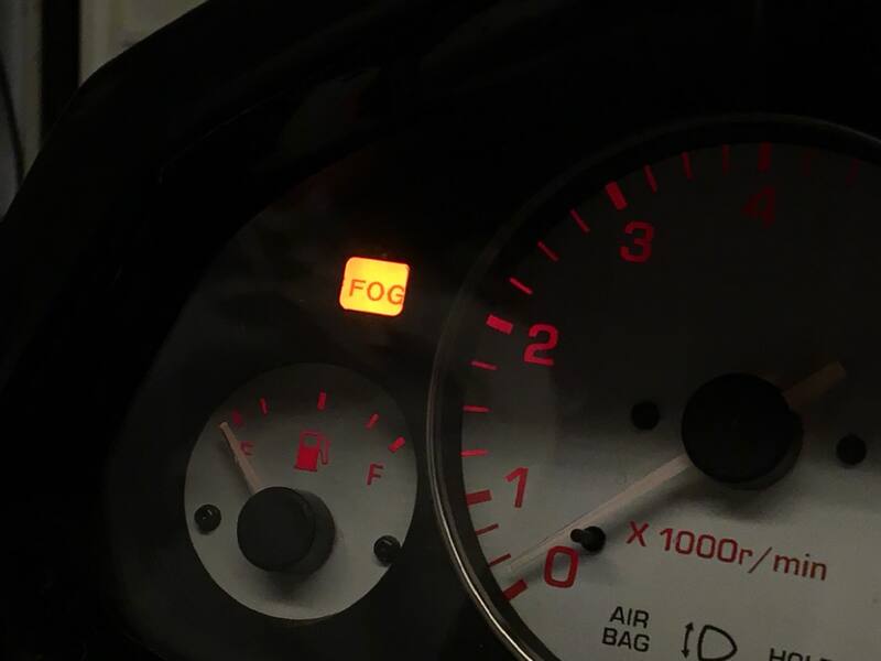

the fog light needs a 'tell tale' so I repurposed the heated rear screen indicator - won't be needing one of those :)
full Christmas tree - I'm happy with that

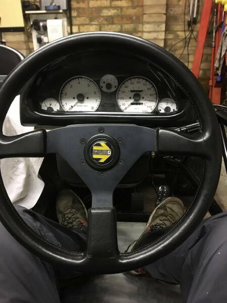

and that steering column is still held up by bungee, a job for tomorrow, I promise !
It will be more interesting when they start moving though :)
Fog switch needs to be on the side of the FOG indication lamp. OCD said so.
In all seriousness, you've smashed this out the bag, we'll done sir.
it was going to be but apparently I can't tell my left from my right :) easy enough to swap them over but I simply can't be arsed !

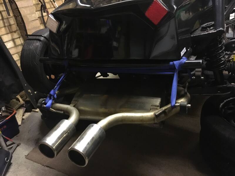

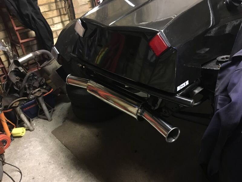

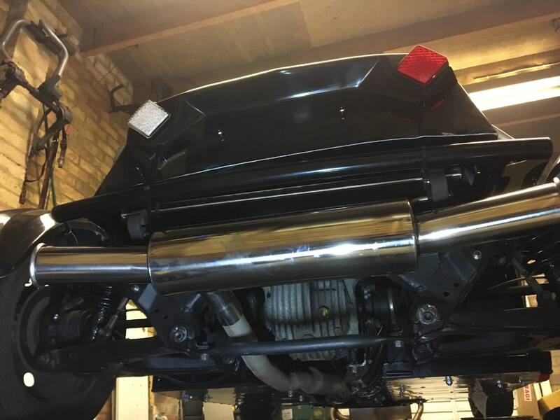

a few weeks back, I posted on the Exocet fb group that I was looking for an exhaust - the official back box is expensive and I don't really like the design so plan to get something fancy once the car is tested and on the road. The current set up is not likely to hasn't got a hope of passing the iva :( shame, it sounds great and looks suitably mental

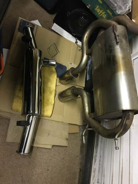

anyway, I did get a message from a chap called Adi who is going full custom on his build so has an unused Exo box sitting in his garage which he is happy to sell on.
slight snag, he lives in Switzerland :(
but, even with OMG postage, there was still a good saving to be had over buying direct from Exo.
so on Monday last week, I sent off my €€€ and settled down for a wait

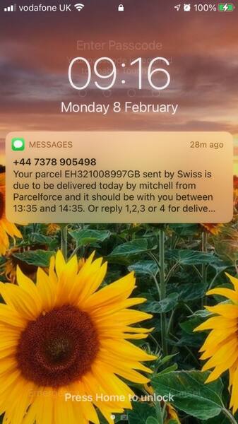

this morning I received this message
bloody hell, it can't be here already ?
bang on time, the man in the big red van arrived
economy service in less than a week, even with covid and omgsnokaos to contend with, and no extra taxes to pay :)
behold shiney goodness !
definitely a weight saving here

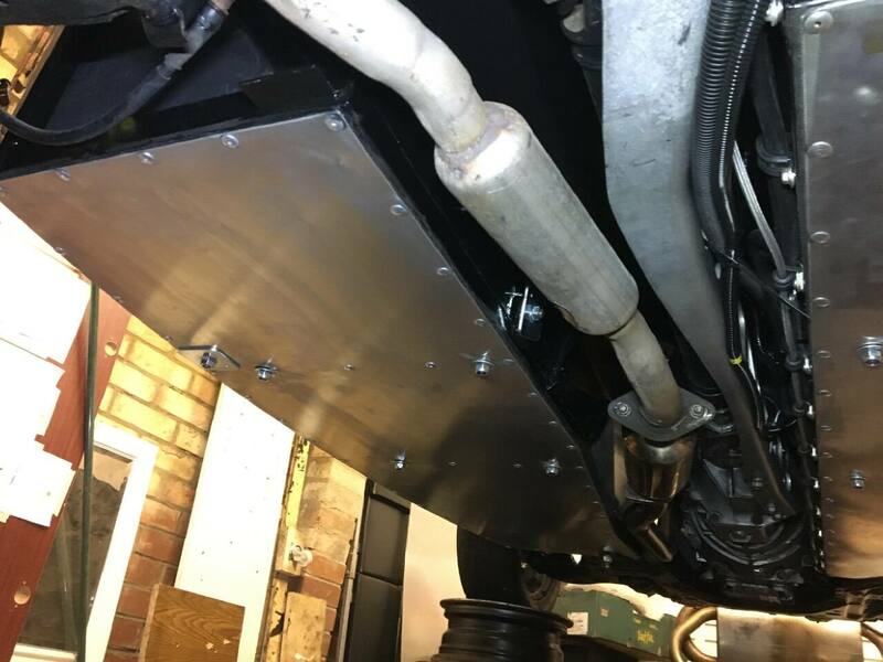

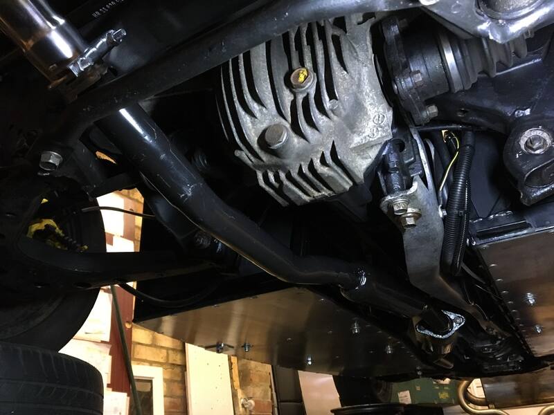

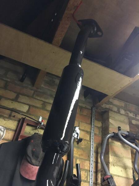

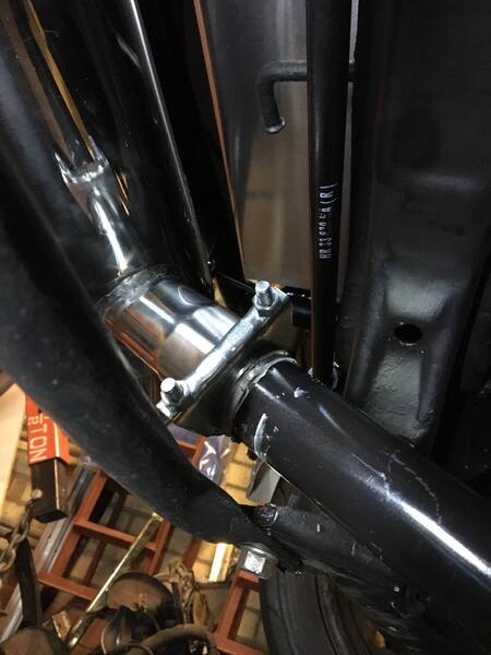

I'm reusing the centre section from a scabby old exhaust that @paulplom was going to chuck in a skip
the back box was utterly fecked but it was being chopped off anyway
the middle bit came up ok with a bit of a wire brush
might need a bit of a shim though
cut to the right length and test fitted
rubbed down and given a nice thick coat of engine paint
that looks pretty good, I might keep it after all.
of course the big question is : what does it sound like ?
well, you'll have to wait until tomorrow for that one - it was getting a bit late to try it tonight :(

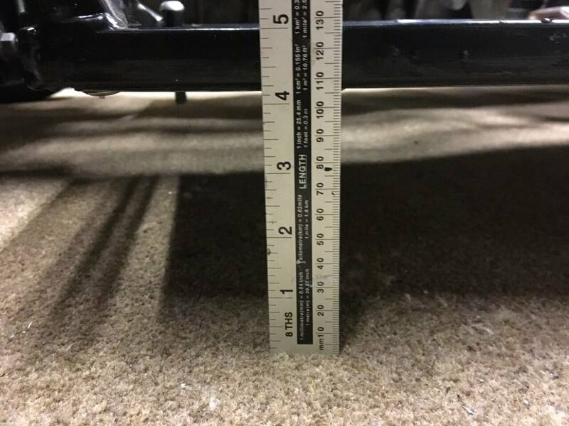

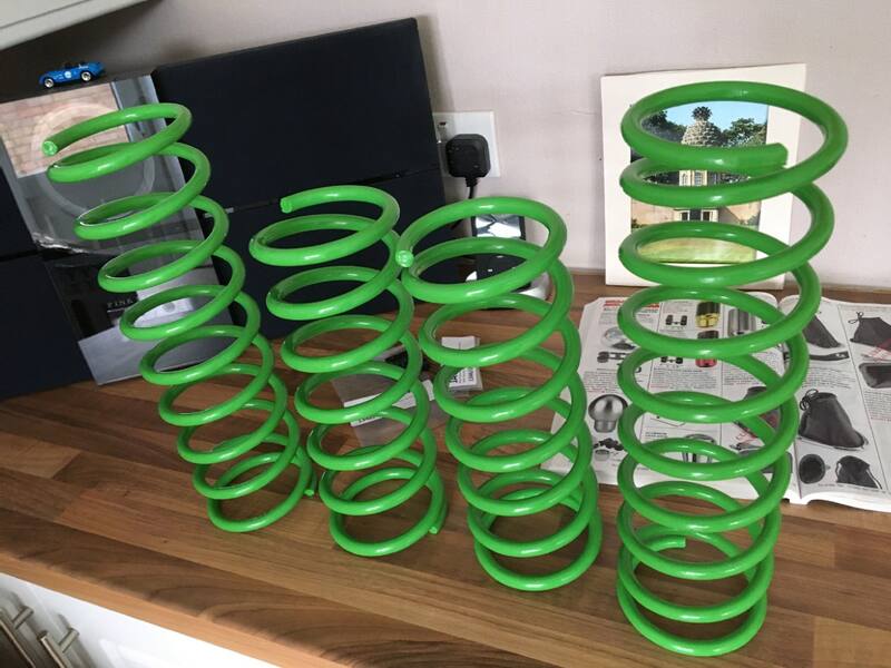

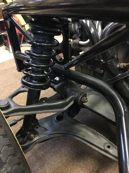

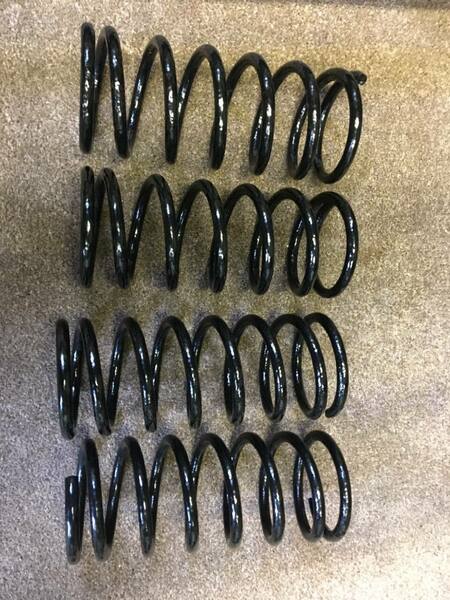

also on the Exocet fb group, a fellow builder had a set of standard road springs available - he powder coated them then changed his mind and bought coilovers instead.
my current set up is eibach lowering springs on kyb shocks :
which is rather low
4 inches low, in fact
so it seemed sensible to grab these keep in reserve
the powder coat has been really well done, they look as good as new
not sure on the colour though !

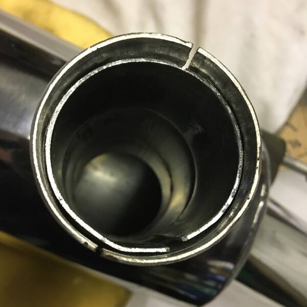

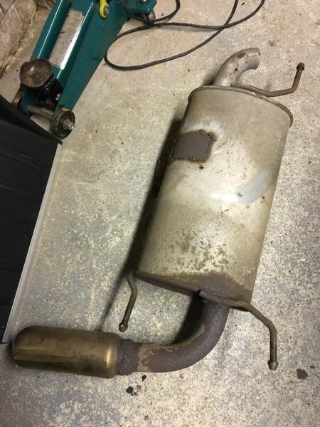

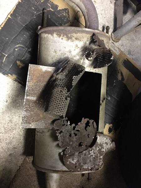

That old back box was a bit rattley so i chopped it open to have a look
that's the lot - no wonder it sounded rough ! The wadding all blew out back in July while paulplom was hooning it round the track :)
Clamps and paste have been purchased

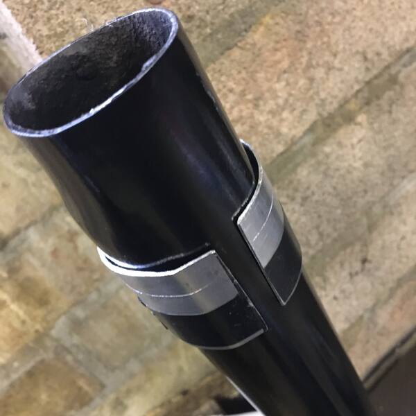

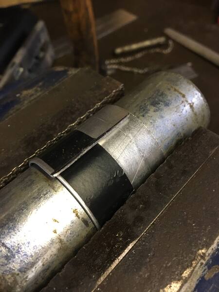

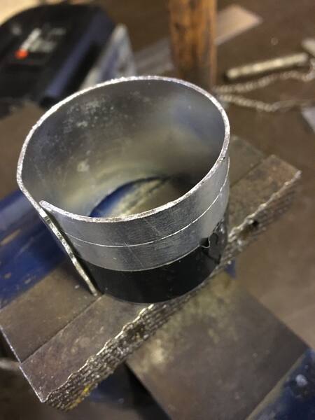

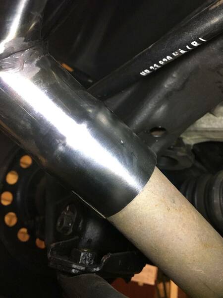

i folded a thin slice of aluminium round an axle stand to make a shim
not a bad fit
slathered with paste and clamped in place
centre section looks pretty good painted
