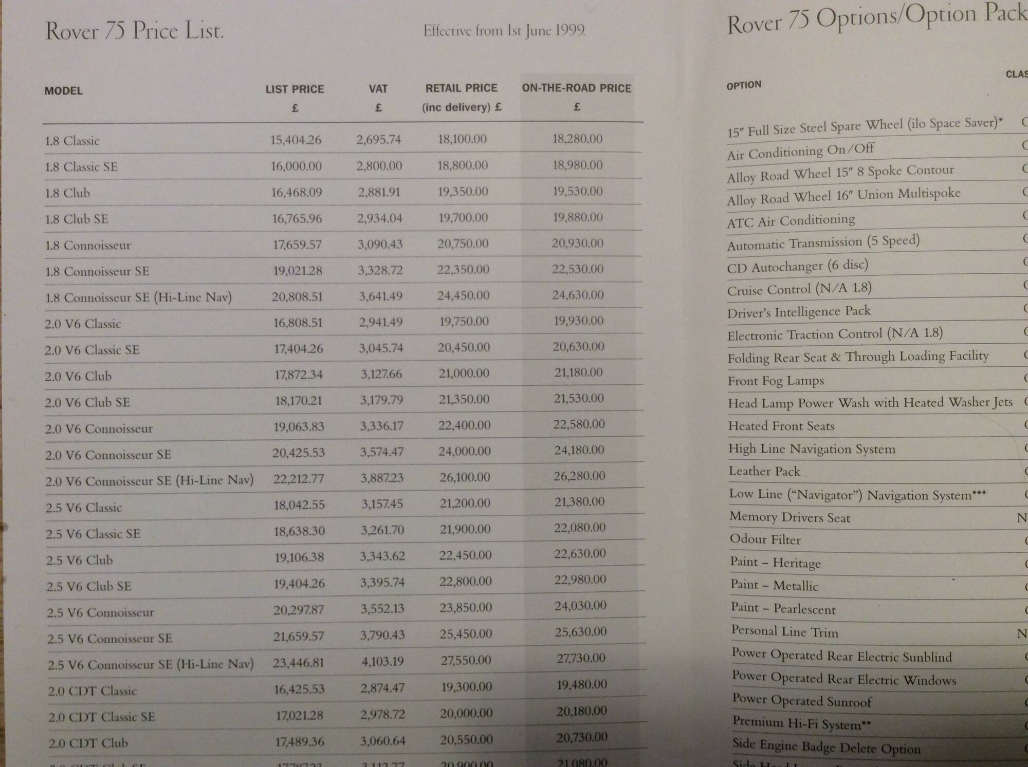

22 hours ago, Heinzy said:
That’s great l would be interested if it’s for sale as a spare. ?
Yep, I have no use for it - as I said though, can't guarantee it works...

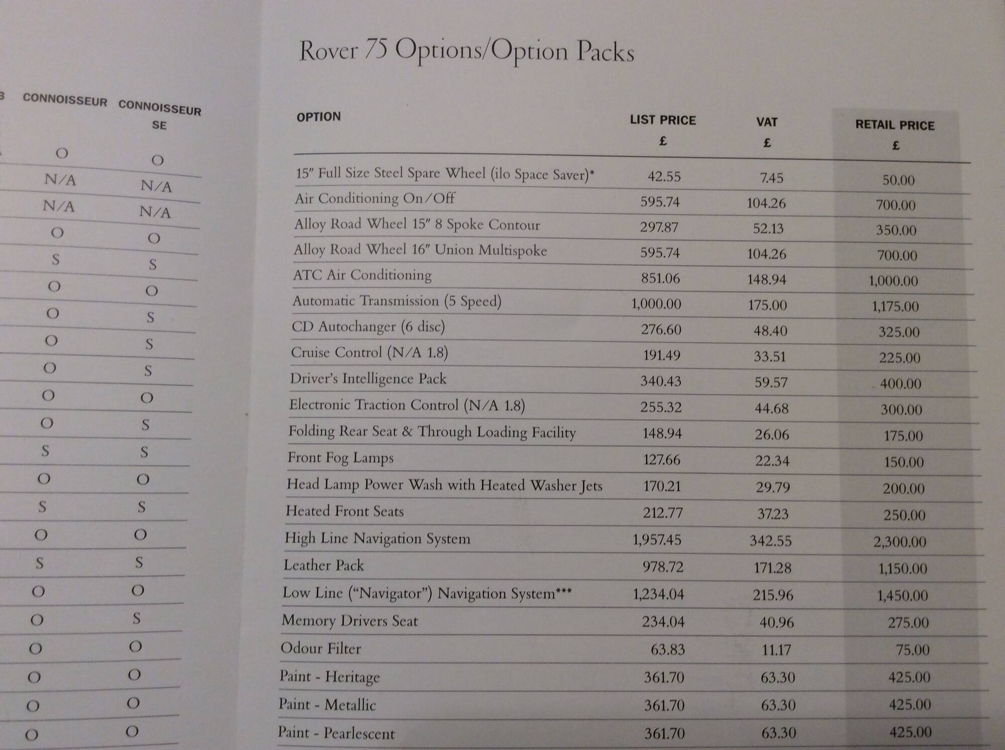

Yes I believe  a lot of BMW owners have bought the Alpine board monitors and the other from  scrap 75s for their cars, tbh l don’t think there was that many rovers overall had them fitted. All the Launch’s cars did but the cost as an option to all others including the Connie Se was an eye watering £2300.00 in 1999.
2 hours ago, wuvvum said:
What was the "Low Line" Nav then?
Single DIN I think? Maybe I’m wrong.
Edit: I think it just gave you text directions on the display rather than a map.
Yes the low line I think gave instructions on the IPK screen between the speedo clocks The functions for it were on the top right of the radio  It still had the boot mounted cd (early) and dvd disc computer. Personal Line trim was £250.00
Good job mine isn't the Lowline system then - my IPK screen is pretty much knackered!
Interesting to see those price lists.  I have the original bill of sale for mine - total price was £28,185.01.  Curiously that includes £127.66 for power folding door mirrors which the car doesn't have.
