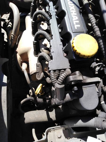

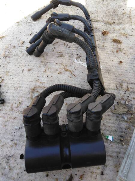

15899860049141550069866780082315.thumb.jpg.fa18d7ccd7dd255babfe1875774258fc.jpgIs it the same as this one?
Donor car reg is EN02RUV
1.6 club

Its a Delphi one
Got  it off, hopefully it's the right one.
Can you get an endoscope camera thingy to check your piston condition?
Crikey, that looks very different. Buggeration. Mine is the 1.4.
Let me get a piccie, which I should have done first of all really.
Thank you for making a huge effort, vastly appreciated :)
Am getting very good at taking the pack off.
Part check your reg and the donor car reg and hopefully will show the same part number.... But I doubt it ??
