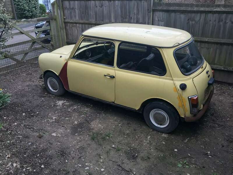

And then because I’d flattened the battery looking for a duff earth on the Mini I had to jump the Volvo into being from one of the (many) carcases littering my property.
I made it to work. What an achievement. EDIT: when saving the pics, I’ve just remembered that this all happened on my Birthday, ha.

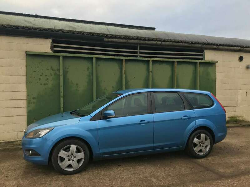

Harrison’s History #58 - Ford Focus
What is better than one Focus Estate..? Dual wielding Focii, baby!
When our blue mk2 Focus estate lost its clutch a few months ago I was offered a blue mk2 Focus estate as a potential replacement. Naturally I said yes (as it’s a little difficult to say no to more cars), but I still had the original Focus fixed regardless.
Now my exceptional life choices have led me to an ensemble as complimentary as dual wielding the pistol and plasma pistol in Halo 2 (the ultimate combo). The petrol for high damage rapid attack and the diesel for long range Brute domination. I guess in this extended metaphor the old Mini is the plasma grenade. Some sort of grenade at least.
The “new” older same age ‘08 Focus is a 1.8 diesel Style, pre facelift. It runs and drives but has some problems.
Most notably a rough idle when warm. But also there’s no heater and a water leak in the boot.

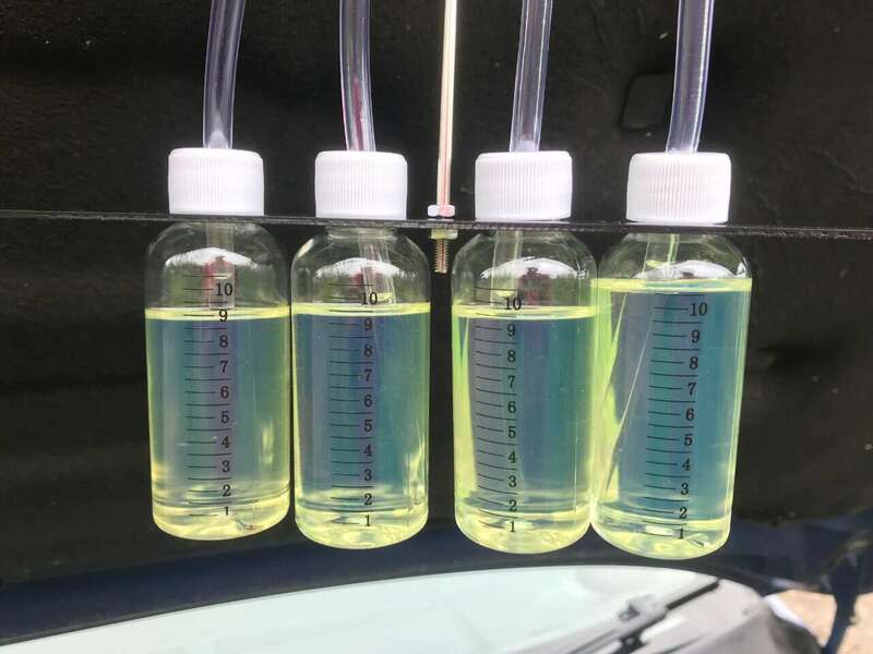

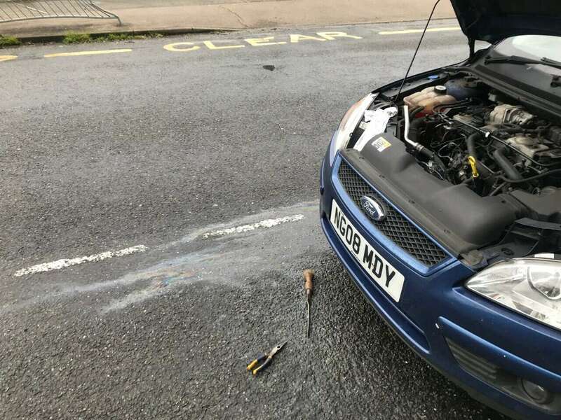

Next against the injectors was a leak-off test. I’ve not done one before so I was keen to give it a go. Armed with Amazon’s cheapest leak-off kit and a procedure from Google (I’ve since found out that might be for 2.0L Mondeos…) I set off to a remote carpark due to the anti-social 30 second stints at 3800 rpm.
”Good injectors should not leak more than 25ml”
Hmm. 110ml is kinda like 25ml... On the plus side, at least they’re all equally borked in a balanced kind of way. I think the take-away here is that it could do with four new injectors, or I did the wrong procedure (warmed up 2 min idle, then x3 30 seconds 3800rpm and 30 seconds idle).
It has then lead to a crisis of understanding that if this is return line diesel, then why is my trip computer MPG reading 34 and my sump full of diesel. Surely if it’s dumping buckets of diesel in the engine there is less being returned, not more?
(unless it’s all to do with trying to maintain certain pressures so all the flow rates are up for baggy injectors - to and from the injector. Don’t know)
I’m going to put all that diagnostic to one side in a “try and forget about it” box because the injectors look pricy and live for hope that this lumpy hot idle is all to do with the EGR and a can of Wynne’s EGR cleaner can make the car mint.
TL:DR - Timing belts overdue, cba to replace them. Injectors are trash, cba to replace them

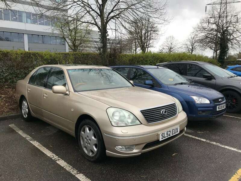

Harrison’s History #59 - Lexus LS430
I woke up today expecting a perfectly normal day. Little did I realise I’d end the day with a LS430.
  • rob88h changed the title to Harrison's Garage - Lexus LS430

How much at idle were the injectors chucking out in ml per minute at idle?
Hard to say really, I didn’t measure it that way, sorry. In about the 10 seconds it took me to start it up and saunter round to the front to see if it was leaking, I’d say the diesel had made it 10-15cm down the pipework for the leak-off kit.
A problem of my own making now: the injector return line fittings seem to be single use… one popped off on the way home.
I’ve tightened up the clip by bending it closed a little tighter, but I’ll see if I can get some new ones and some little seals for the return lines.

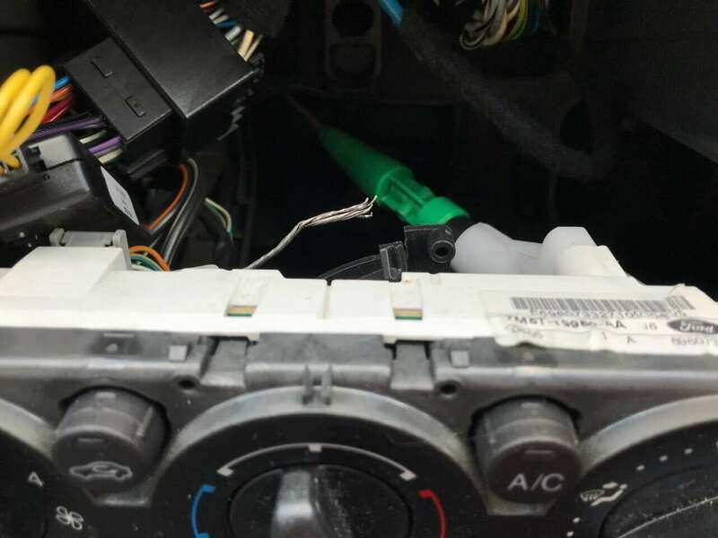

Replacing the heater control cable on the diesel Focus “NGOB” (silent G) was possibly one of the worst jobs I’ve ever had to do on a car.
The secret to its frustration is the simplicity of its intended procedure: two push in clips, two peg and hoop connections. The reality is there is so much the-rest-of-the-car in the way.
The entire dash I think is supposed to come out, but my level of commitment wasn’t that bold and I didn’t want to mess with the airbags, steering column, binnacle etc etc.
With a head torch donned, I lay in the footwell with my back breakingly arched diagonally over the sill and used a pick to tease out that white block. Over about an hour of experimenting with contortionist hand and forearm shapes whilst dropping various tools on my face there was really only one way onto the b@stard and eventually… it was out.
Putting the new one in was just as hard. Quite probably another hour of being in a horrible position elbow deep in the sharp plastics side of the dashboard. I could either get good alignment or go pushing force, never both, until I summoned all my inner thumb phalange strength and sent it home.
The other three connections were a doddle. Thank God.
I can now request heat of whatever temperature I want! Finally everything I had to strip out went back in the dash. Great success.

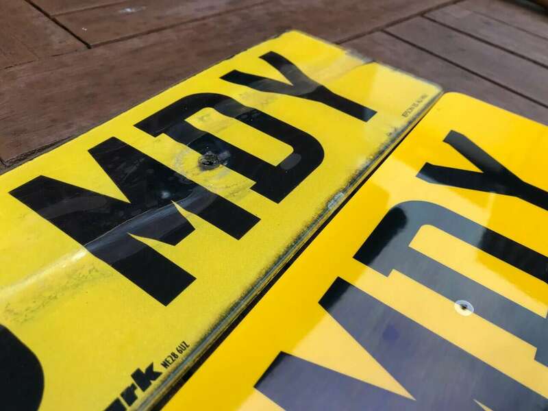

To wind down from the heater control debacle I addressed one of its long standing MOT advisories by replaced the rear plate.
There’s a lot of satisfaction in a tidy plate.

With the new old same age Focus OUT, the Lexus is IN (after a brief period of getting in the way at work).
I also realised the reg SL52 EUX is an anagram of LEXUS (and if you really stretch it, LS [25]. 2 as an L is a bit iffy…)
