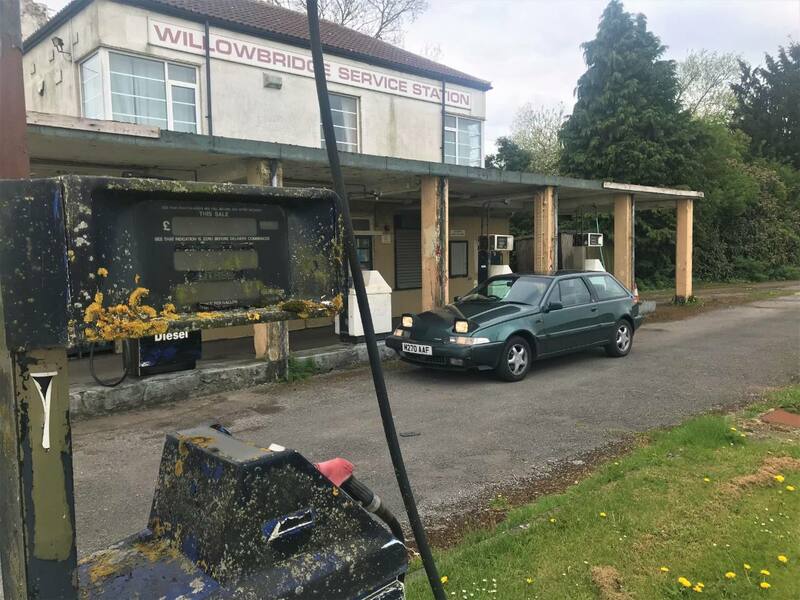

Mission completed for stage 1! It was strange to turn up to the visitor centre and there actually be people there unlike the cold December mornings we're used to, but hey-ho.
The 480 is running nicely. Everything making it trustworthy is performing as it should, but oh my days the dash does like to rattle...

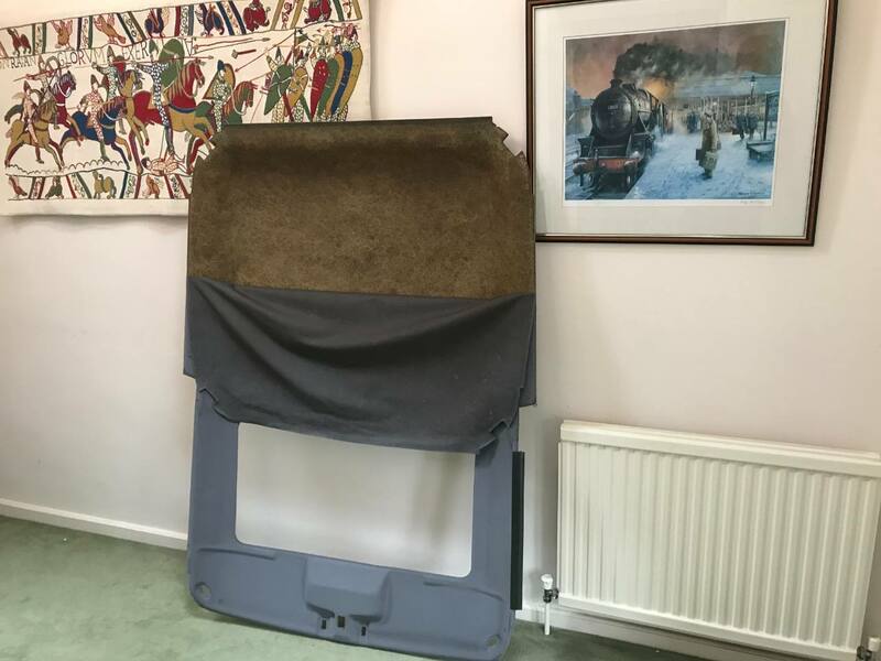

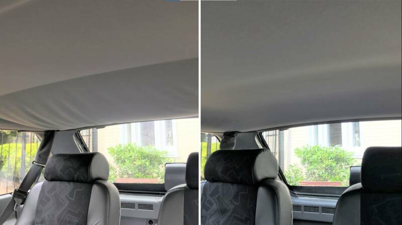

There’s not much left I want to do with the 480, but one of those things has been addressing the Bedouin Tent in the back behind the sunroof pocket.
My wife was away yesterday so I spotted my window of opportunity to bring the headlining inside for a bit of a re-glue with some high temp trim adhesive.
It had been raining on Friday and the boot seal is a bit weepy so I also took the opportunity to use her Vidal Sassoon to dry things out before gluing. I only got caught because I put it away properly, haha. It cleaned up easily with a stiff brush and gluing it back together was without drama – only now I’m wondering if I applied enough glue.  Hmm, I guess time will tell, but it was easy enough to remove and re-fit so I’m not against doing it again should I need another go at it. Also I'm not losing sleep over the leak - I intend to make hunting that someone else's problem, with full disclosure, but it seems like all 480's leak or have leaked at some point.
No "action" shots, I wanted to act quickly once the glue was down! While in there though, I got a bonus superglue fix of the interior light, which I didn’t know was broken but now I know is fixed. :D.
Pleased with the results

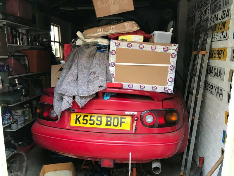

5) Project #3, the MX-5. Always bottom of the pile, both metaphorically and literally. Needs exhuming before any work can continue.

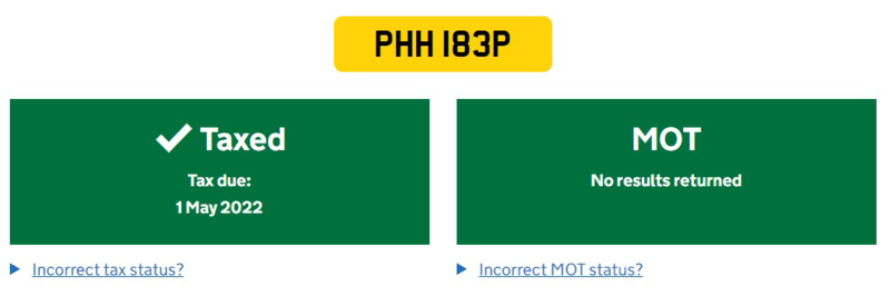

The rego has been allocated to the Granada, huzzah.
Internets tell me HH is Carlisle? I thought age related imports had their own “block” with the DVLA that fell outside previously issued area codes? Maybe a plate expert/superhero like @LightBulbFunwould know. HK would have been good, an Essex Granada!
The question is: Is it pronounced P-hibep or Fibep?

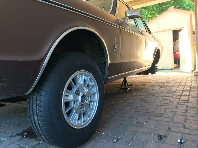

Another small chunk of progress occurred today. Having not been on the road in decades, the tyres were toast on the ol’ Grandiddle.
Plan A (not followed) was to scrap the tyres, give the wheels a tidy-up at home with my short attention span and some aerosol paint and slap on some mid-range ditch teasers (not quite ditch finders), all in an attempt to not get too precious and to save some money for areas that need it more.
Once I got started, what I discovered was that all 5 wheels were supporting Innertubed tyres in 185 HR14 flavour.
This is the oldest car I’ve had, so I didn’t know what the deal was between tubeless and tubed rims, and whether I could even put a tubeless tyre on (Ask a Shitter to the rescue).
General consensus was that these wheels should have started life tubeless anyway and I’d be fine, but a good refurb, i.e. better than I was planning, should see them sorted around the valve seat and not porous. It probably wouldn’t have been a problem, but I like a good wheel and I knew a place who did a nice job on my Mini 10” steelies. Here is an example of the before:
Meanwhile I sourced my own tyres. Not too much choice on a 185 HR14. Michelin Historics at £250 a go, fitted, or a Hancook or a Maxxis offering at £50. I’m sure the internet wants to see me spend for “only the best”, but I’m trying to not let things escalate here and the refurb plus the Michelins was heading towards a modest chunk of the price of the car! I’ve gone for the bicycle brand tyres to match my pushbike – mostly because of the debacle ordering the Hancooks multiple times from different suppliers only to be told each time that they can’t get them…
The results however are quite pleasing:

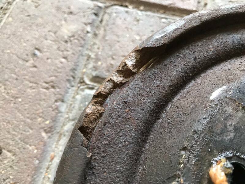

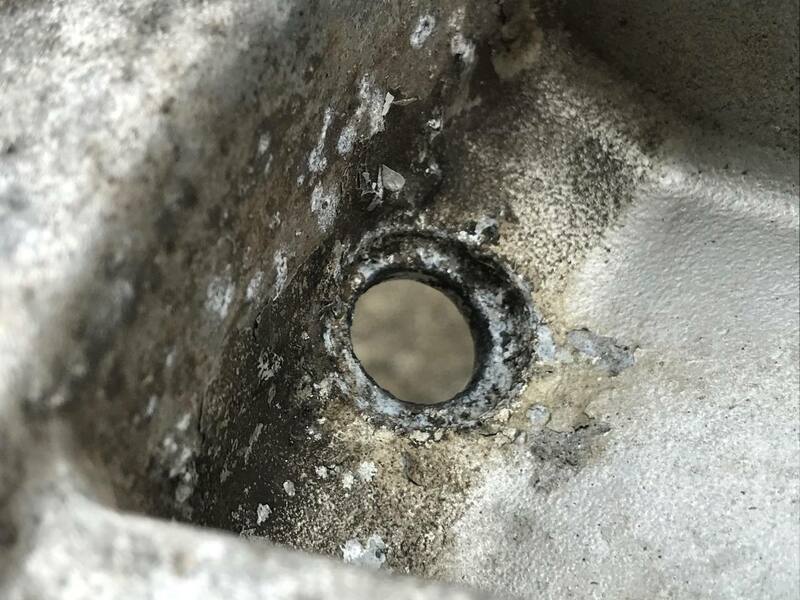

There’s a slow rear brake rebuild going on at the moment. Both drums had been stripped before I got it (I’m guessing previously seized) and some chisel action has taken place on the drums.
I have all* the mechanisms in a Pringles tube that came with the car - and now I have new shoes, springs, wheel cylinders and replacement refurbished drums to add to it. The only bit I seem to be missing is a handbrake adjust plunger (it uses a spring plunger type thing instead of screw) for one of the sides.
All I had to do was remove the old wheel cylinders. Pain in the arse, obviously, but soaking, tapping and heating saw it out in the end. Easy to type… but that was two weekends work 🤷‍♂️. I still have the other side to do. One casualty was the brake line. The fitting loosened in the wheel cylinder but wasn’t free on the line itself and sheared. It was marked for replacement so not too much heartache. Y tho?
Anyway, a pretty standard affair for work on an old car. Some unobtanium to find, the actual re-assembly still to do and then doing all again on the other side. Whoop.

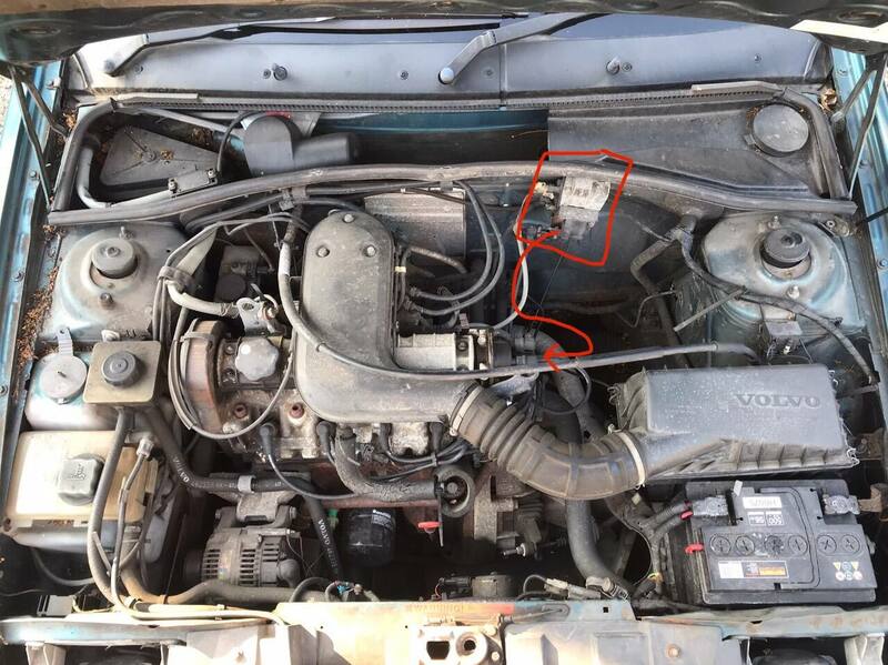

The hesitation at low rpm has become a complete out-and-out misfire under any kind of load. It happened all of of a sudden when joining a final dual carriage way at the end of a recent trip, so luckily I was close enough to home to make it back un-assisted. I've tried contact cleaner and water dispersant first (along with checking for obvious loose HT connections), though owing to warm weather Pina Colada consumption, I've snookered myself for test driving it for today. It's idling ok, but then again it did even when it was doing its Volvo approved breakdown (i.e. a breakdown where you can still drive home). If no good I'll check the plugs next, but there are internet points up for grabs for any other suggestions. In summary, it idles fine, revs up fine in neutral, but apply load to drive away and it misfires.
The intention is to get this thing to FOTU, the only time I've considered taking it anywhere specifically on it's own merit in the years since I've had it, so it'd be a shame if this is the one time it lets me down!
Also here are some pictures of the developing rust 😬. I tried to take one as a close up panorama and created this monstrosity. 440 limousine anyone?
  • rob88h changed the title to Harrison's Garage - 440/Focus/Granada/Mini/MX-5
I had something similar on my Cortina back in the day and it turned out to be the coil
To corroborate this idea, my Capri had the same symptoms and it was breaking down mostly when it got hot. That was fixed with a replacement coil.
This recent Volvo escapade was after about 100 miles on a busy A12 yesterday in the baking midday heat…
However, the Volvo doesn’t have what I’d consider your traditional basic cylindrical coil system. It’s still a king lead into a distributor type setup, albeit with a load more low voltage control wires doing I don’t know what, but I guess it’s principally the same and can fail in the same way.
That looks a bit like the setup in my Favorit.  At launch it was a mechanical dizzy but for the later ones they left the mechanical bits of the dizzy including rotor arm but have a coil unit which looks pretty similar to that which just keeps firing high voltage pulses and lets the rotor arm figure out the distribution. So in effect a crude electronic ignition which doesn't run from the ECU
wires in are usually the power and the input from the crank position sensor
I had a 340 with that same engine (mounted longitudinal - RWD) and it developed a similar issue. On mine it was a heavily corroded HT lead terminal on the dizzy cap. Worth checking the leads, cap and rotor arm.
M_CEC - Volvo 440
One new ignition coil later and the 440 is reet again [after a sub 1 mile test drive from cold. Next journey is the 250 miles to and from Festival of the Unexceptional, what could possibly go wrong?!]
(No, there’s not supposed to be a screw there, it locates on a pin on that casting)
