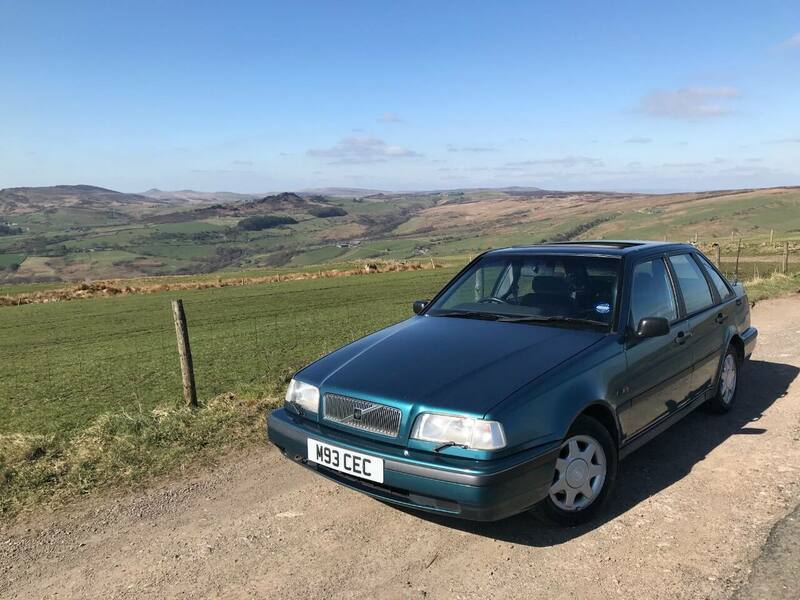

The Volvo let itself down this evening. I may not have completely* fixed things.
A bouncy jaunt down a puddled farm track resulted in a complete lack of ignition. A restart was possible, though not swift nor stable when running.
Out with the WD40, off with the HT leads and everything got a good dousing. It started, it idled, so I shut the bonnet… and it died. I tried the same again (expecting different results obviously), but instead of slamming the bonnet I edged forward gently… and it died. I wiggled everything again and widened the net to the earths as  they’re in the wheel splash zone, so, maybe. Now though, it would not start at all! A couple of coughs and that was about it.
With no tools other than the WD40 in the car at the moment , the RAC were called and I walked off to the cafe to charge my phone and have a drink. Apparently it’s busy times for the RAC right now! They started sending out messages with suggestions - nice intentions, but mildly infuriating: “We think you might have a problem with your battery. So here’s some info to read before your patrol arrives”.
After sufficient charging (phone) I got a message saying Charlie was on his way so I wandered back to the car. I tried all the same things again (expecting different results obviously) and then it started up and idled ok! This time I decided to be more systematic and poke things to try and make it cut out. Huzzah, wiggling the coil elicited the cut out.
Fiddled with it a bit more, fed it a load more WD40 and started it up again. This time I couldn’t get it to cut out again. I moved it down the track to test it under driving load with great success. Then the RAC arrived 😂
He was quite pleased it was fixed actually, and he did follow me for a few miles to check it was all ok. Looks like it’s back on for FOTU!
I’m not 100% sure which coil connection it was...  but it is work for now.

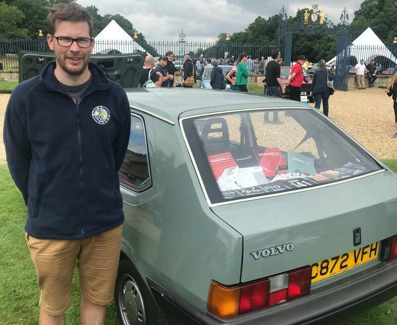

M_CEC - Festival Of The Unexceptional 2021
What a brilliant show. It's the first time I have been and it really was my sort of car show. The Volvo had let me down for the first time ever just days before, so I was a bit worried about the trip, but it made it, and it sat happily in the queue to get in with no drama. An unexceptional journey. This signifies the first show this car has been in too, which is nice. I had a good mooch around and I think* it was the only 440 there; mild pride. I saw 480's were there and a 460 phase 1 was there, but I didn't see another 440 or any 440/460 phase 2 specifically. What I did learn was that there are still plenty of 205's out there, so no need to rush out and get one before they're all gone, haha. I also learned that I have an above average tolerance for viewing chod, as I couldn't get around the show before most of the stuff was leaving.
Pick of the show for me: the three door 340 DL in the concourse section. It reminded me of the good old days with E880 SOM and H135 HDO, that personality defining moment in my life where at 19 I had two knackered grey 340's 🤣. I think this 340 was also spec-for-spec the closest to any one from "Harrison's History" that I found during the day.

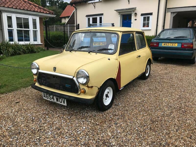

A_WOV - Exhumation
I don't know how this happened, but I've done a mere 173 miles in the Mini since 12th July 2019. I mean, I know why, the Mini is a piece of shit, but I don't know where all the time has gone. I'm trying to remember what went wrong and when, but essentially in July 2019 it had just passed an MOT and  I did pretty  much all those measly miles going nowhere in particular that summer as I was mainly using the S123 and XJS. I put the Mini in a friends garage over winter, acknowledging that I wasn't really using it and then by Feb 2020... well we all know what happened. In April 2020 I recovered it, so I had it to play with at my house in the garden during lockdown 1.0 and a wheel cylinder popped on the way home! I remember limping it home on the deserted roads as I didn't want to meet an RAC man and catch the dreaded virus. Pretty dumb in hindsight.
On 6/15/2020 at 9:18 PM, rob88h said:
Other than the stupendous rampant corrosion this Mini has not been too bad and mechanically I’ve only had complete clutch failure and complete brake failure.
During lockdown 1.0 I rebuilt the brakes just by throwing parts at it...
On 8/30/2020 at 7:47 PM, rob88h said:
I didn’t get the adjustment quite right and they’re binding too much. Damn.
Then, for just under a year it sat at the bottom of the pile. Looking back I rebuilt the crashed Focus, got and "restored" the 480, had the Baleno twice, including quite a bit of work, sold the S123 and XJS, did various things with the 440 and bought the Granada, so I'm not giving myself a hard time about being lazy, but it is a shame I did nothing. Part of the out of sight out of mind attitude with the Mini was that I booked it in with MiniCraft for a renovation of the upper parts of the body once the 18 month MOT had expired, so it just hung around waiting for that. With the bodywork repairs officially cancelled recently (unfortunately) I thought it was time to see if I could get out in it for the summer, then find someone else to do the body work over winter, or next year.
As I left it, the front brakes were binding and I couldn't do anything easily as the adjusters were seized, which meant going back into them, stripping them, exercising the adjusters from inside rather than mangling the spanner attachments and rebuilding them again.
While in there I took Mr. TidyBeard's advice and chamfered the leading edge of the shoe to make them less grabby and then went about re-assembling them and adjusting them properly once the adjusters were free. The offside was ok, but the nearside could not be setup and it was becoming obvious that the drum circularity was...erm... not circular. After having ordered parts for the Granada I found £11 for a drum for the Mini an absolute boon, so just got new ones. This probably explains why the Mini used to pull left on hard breaking and had a tendency to lock that nearside wheel.
While I waited for delivery I addressed some rust because it's a Mini. Not bad rust, just some peelage from a recent repair cleaned up and repainted.
With the new drums and the ability to tweak the four shoe adjusters the brakes are now bellissimo. I treated it to a wash because I think a washed car presents better to an MOT tester. I wish I hadn't - the paint on the nearside A-pillar fell off in one sheet with just some gentle sponge action. Incredible, never seen that before and left me laughing.
With that the car was driveable again, yet with 24 months having passed since it's last MOT, I decided to put it in for one to get a better idea of the immediate "to-do" list. Today I can report that it has pretty much passed. That's a result in the AutoShite world. It hasn't actually passed, but it's as good as!
The dipswitch thing is from a period correct theft attempt, where the steering column cowling now moves around with the indicators, so if you indicate left then go for main beam the cowling is in the way. Part of the charm, lol. I'm not sure the hazards not working is a flippant thing with an old vehicle - of the four switches on this car that's probably the most important 🤣
Regardless, the major defects are going to be repaired immediately and the Mini will be driven. The target: 174 miles before the next major setback. I'll report back on how that goes, 50:50 it does it.

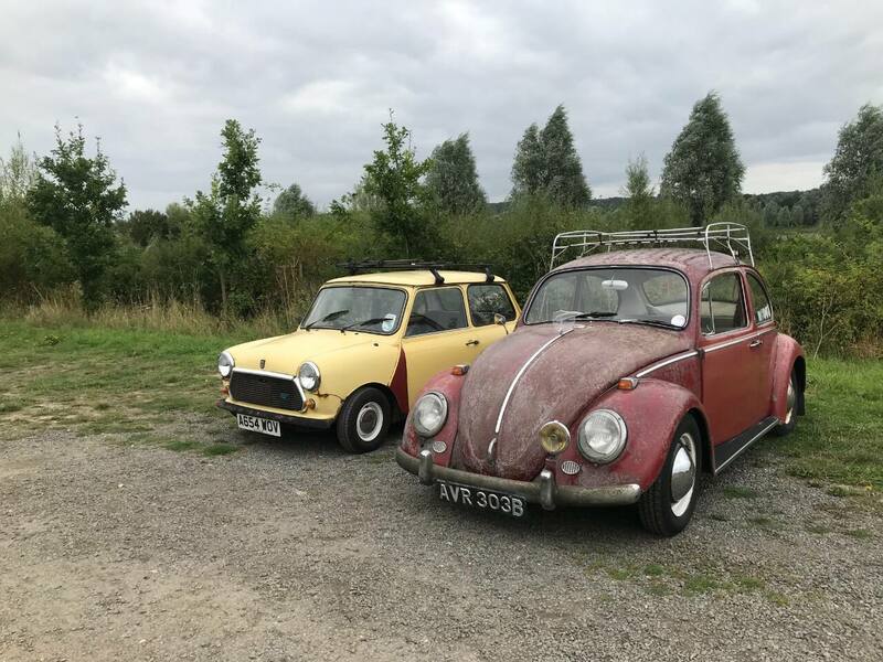

Another impromptu Mini car show. 😀
I’ve had to fit some adapters to get the drivers seat further back in the Mini, as the last 500 miles has started to hurt my feet in a way complacent little me was beginning to complain about. I was beginning to think of using the Volvo for trips instead of the Mini. Bad thoughts! Drive the Mini everywhere while it’s still working!

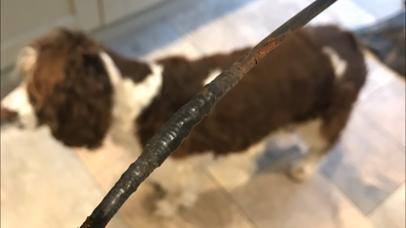

I got the heater cable out and replaced at least. The old one was quite corroded (like everything, lol) and now it’s out I can see it was unlikely to ever free off in its housing.

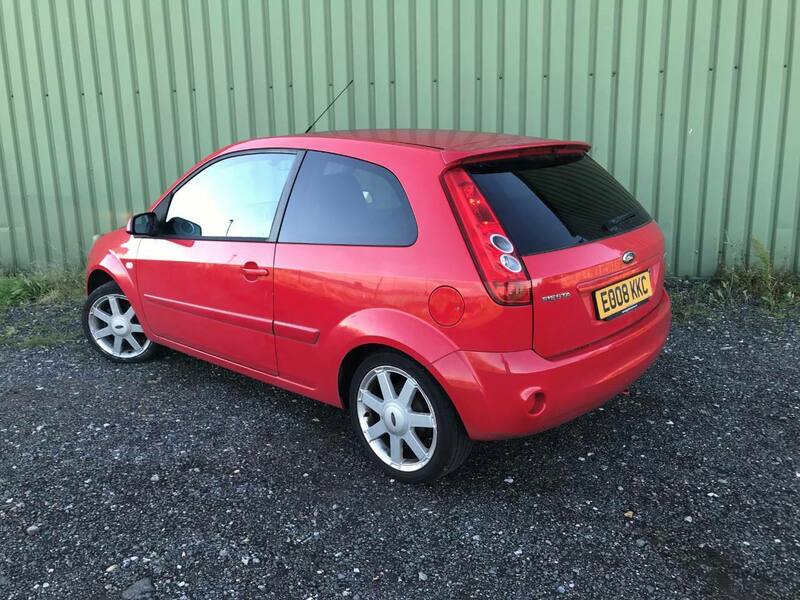

Harrison’s History #50 – Ford Fiesta EO08 KKC
Since I joined AutoShite at the beginning of Lockdown-one.A I’ve really slowed down my car acquisition rate, partly by travel restrictions, partly by habit-breaking due to travel restrictions, partly by watching others going through car caper hassles instead of living it myself, and partly having settled now on a few cars that I actually want to keep longer term.
However, every now and again some opportunity comes along where you really can’t say no. So, for my 50th car celebration bonanza I’ve marked the milestone with this suitably exotic Fiesta. I’ve known this car since 2014. It’s had a decent non-car-guy owner, not the kind that washes it every Sunday, but the kind that gets anything looked at and repaired and serviced when it needs it.
I’m impressed with it so far – it’s a really similar feel to our ’08 Focus, with better gokarty handling but at the cost of a much harsher ride. It’s quite affected by road surface, being pretty loud on a poor road but alright on smooth tarmac. I’m not planning on keeping it too long, but it’s nice to add a 6th Fiesta to my history (first of this generation) and an Essex reg to my quest to have a reg from every area. The plan so far is to experience it for a bit, get it a new MOT and then sell it on to make way for another car I’ve agreed to buy...

Things that seriously impress me about the Fiesta compared with my other cars:
  • The car can be unlocked (and locked) without putting the key in the door.
  • All the doors unlock and lock together.
  • There is one key for everything, not separate keys for different doors and an odd key that seemingly does nothing.
  • (It starts, haha, that’s unfair to the Volvo and Focus, they start)
  • It has a cup holder (game changer)
  • The radio a). works b). can pick up more than just Radio 4.
  • My phone plugs in for tunes (Millennial credentials +1 level up)
