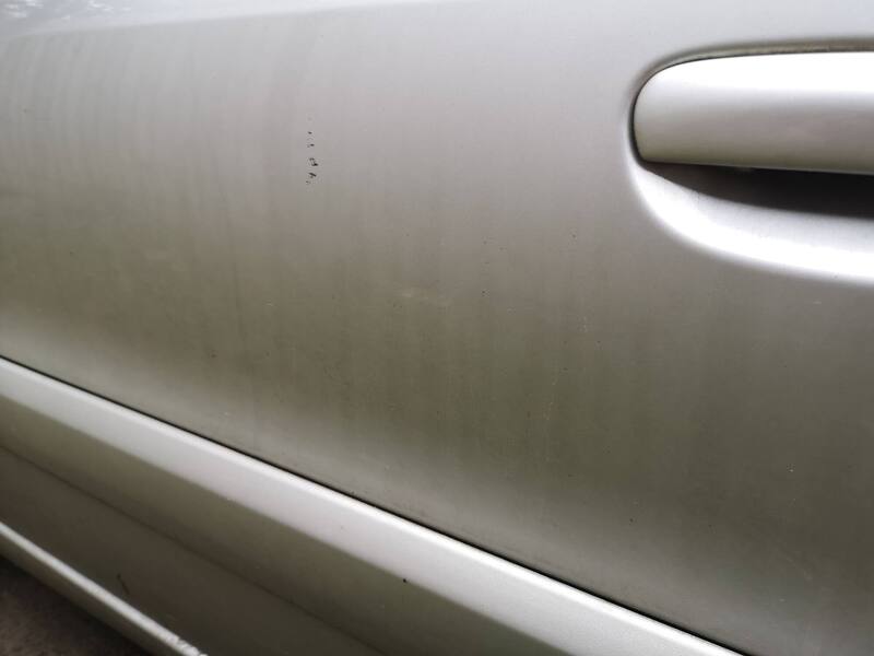

so gave the entire car a good claying! So much shit came off, the entire car was covered in yellow

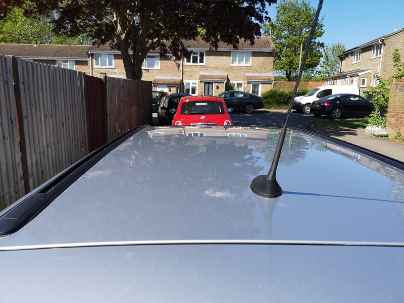

One thing that always bugged me was the state of the roof and bonnet. Scratches everywhere, the roof has had egg or bird shit on it for a long time too as the paint is fucked in places, but we're just after a quick smarten up, so with the last of my menzerna...
I got rid of stuff like this
and made the whole thing very respectable again

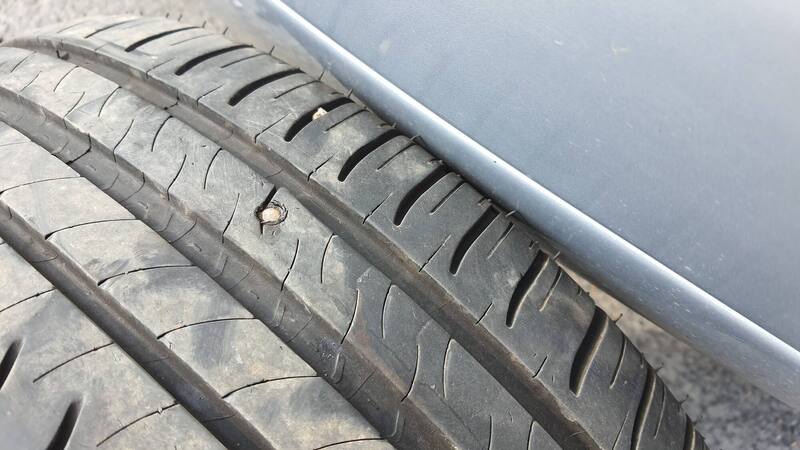

Started by swapping wheels, 2 tyres are a bit fucked, so I went to put the 2 good ones on the front, and the others on the back.
Could also check the brakes, and their fine for now, but could do with changing all round. Enough meat on the pads for me to not be worried yet. I also copped a glance at the spare for the first time

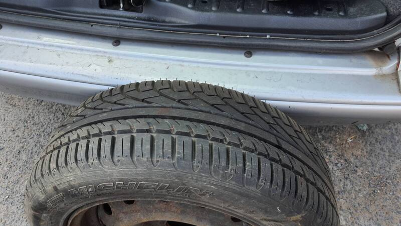

Etc. Then I had the spare down and fuck me it's the original to the car...
I mean it's lovely, but I REALLY do not like it...  18 years old and never been used. I would swap for another steel that fits if anyone wants an original 2002 Michelin vintage retro OMGUNUSED tyre for reasons... Doesn't need to have a good tyre on it either as I want to replace this at the nearest opportunity
Toolkit is new and unused too
Anyway, onto the passenger side and BASTARD
Shame really as I wanted it on the front to replace this
But I've left it on the back where at least it'll be less horrible if it goes down on the back. It's shown no sign of going down ever, and look to have been there a while (I checked all the pressures the other week after 3 months of the car just sitting, all still fine!) But sods law if I stick it on the front ill turn the wheel over it and rip it sideways and byebye air

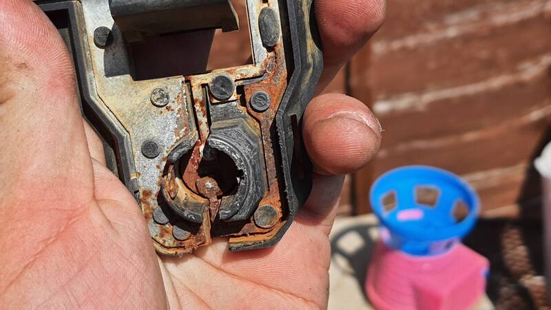

I then turned to the non working rear drivers sidelight. And the corrosion fairies have been here
The bulb glass was not connected to the metal base, pliers got it all off in the end
And yea, it all crumbled away a bit more when I tried to clean it up
And my bodge did not work.

also is that an underslung spare wheel carrier on a french car that isn't siezed absolutely solid! my god that's amazing
There's even grease on the carrier bolt! I'd almost trust the spare it looks so clean.

It was seized, and fairly solidly.  One of the very few wins I had with this was to be able to un-seize it and copper grease it.
