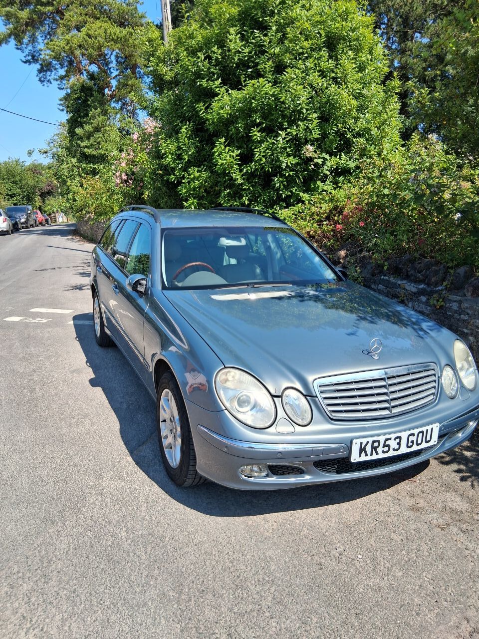

The Mercedes has decided it wants a trip back to the garage.
A tinkling sound followed by an exhaust blow from the front.
Does sound good mind.
Managed to get it in on Weds this week.

BFG is back.
Broken exhaust hanger and small split in exhaust where the CAT is.
Couple of bits of welding. 90 quid. Job done. BFG is now back to being quiet.
