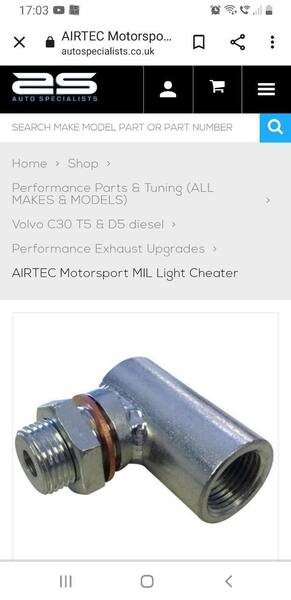

Aftermarket cat (no biggy), plus an emissions cheat device found attached to exhaust.

The excellent* after market cat fitted to the car, is not up to the job iro emissions, so one of these (or a generic version) has been fitted to con the EML.
Garage verdict, is car will need a new cat as old one clearly not up to job originally, plus the amount of unburnt fuel being throw down the exhaust system will be doing it no favours.

What does that little gadget do?
No idea on the cost of a cat but they're not hard to fit generally. I would suggest 2nd hand but they're probably a) stolen or 2) weighed in as soon as they arrive at the yard
The device moves the lambda sensor into cleaner air, so ECU thinks emissions are ok.

The exact thing has been fitted to my Beetle as well. As well as an aftermarket cat.It passed it MOT last year with it fitted. The mot is up in December so fingers crossed.
Sent from my SM-A127F using Tapatalk
Unfortunately on mine, the price for getting the emissions ok, is it running very rich.

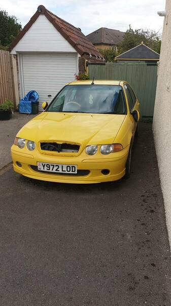

I probably should restore her ZS180, but I fear the cost would be prohibitive.
What she use to look like
How she looks now after 4 yrs off the road

Good investment that ZS180, especially in that yellow. Seems amazing cars like that are being restored now, I still think of them as "new" cars, but they're 21 years old now!
I suspect she's worth more than I paid for her 4 yrs ago, but she does need a lot of work.
If I keep her on the drive for long enough, she might be worth restoring.
Her bonnet latches are rusted solid, so I can't get into the bay, to charge / replace battery, to at least get her running :)

7 minutes ago, Split_Pin said:
That ZS is worth a bit due to it being a very early one. Not many MG Zs on a Y plate.
118th ZS off the production line
105th ZS180 off the line
72nd Trophy Yellow off the line.
So yep, a pretty early one.
Which is why I haven't had the heart to bridge it.
5 minutes ago, KitKat said:
What's actually wrong the ZS, besides bonnet hinges being rusted and the flat battery?
From memory
Shocks are knackered. New ones NLA but I've got a good set of used ones.
Drivers seat base loose, probably due to rust. Also slide mechanism broken.
One key, that only fits in ignition barrel, so ideally needs a new lock set.
Well past its cambelt / pump interval.
All 4 alloys don't hold air and need refurb or replacement.
Probably a few other minor things I've forgotten, plus 4 yrs of rusting to be dealt with.
All in all, not a big list. Just never seem to have the time and I spend all my spare cash on chod :)
